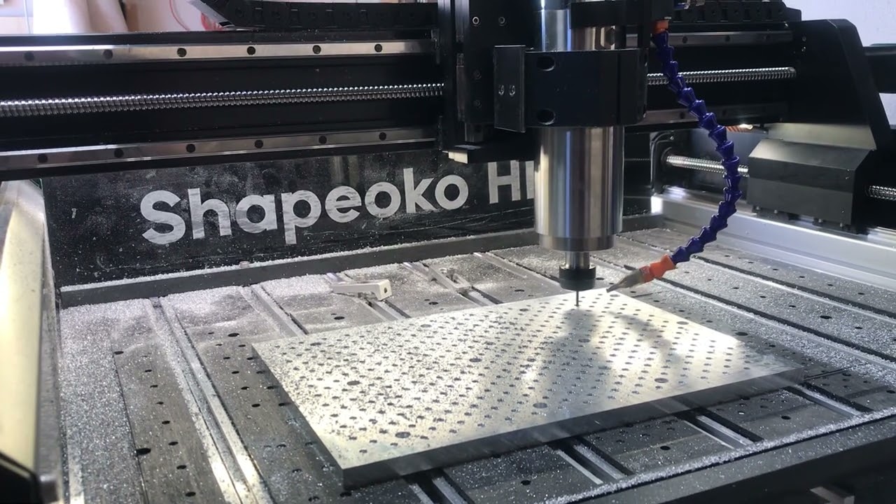

Still plugging away on the HDM fixture plates when time permits.
Finishing up number 3 thread-milling at present. 10k, 715mm/min, ~380 holes in 44 minutes. Only have one thread mill so not pushing. Mister not set up yet so I just squeegee a load of WD40 across all the holes.

Wow! @Griff Those look amazing!! What size and threads are they? I never thread milled before, its on the top of my list of things to learn.
Could you please link the thread mill you are using, and where to get the aluminum plates?
Also could you send me an example Fusion file to study?
Thank you!
Thanks. For some twisted reason I decided to go metric, the holes are 6mm on 20mm centers to enable use of Saunders mod vise. Finished plates are 340mmx240mm. Doubled up on holes because, why not?
ATP (5083) plates from Midwest Steel, .005” flatness spec if I recall correctly.
Thread mill from here. 1/4" Solid Carbide Single Form Thread Mill 20-56 TPI x 1" Reach USA I24 — CarbideToolSource.com
I’ll send you a Fusion file as long as you promise not to laugh. F360 is very much a tertiary interest to me, I keep trying to get serious about it but…
And…boring 400 holes doesn’t compare to the creativity of your work.
Will be very happy just to see how it is done, no laughing here! Do you know will that thread mill do 1/4-20 or 5/16-18 threads?
^Ahh I see 20-56 threads per inch, so I will need a different one for 5/16-18’s
Thank you, I can’t wait to try this.

Looking awesome! Its nice starting with known flat plates instead of 6061 bananas.
Haha, I came across a 12x12 .75” piece that had 0.03 waves!
Not cut on the HDM, but I finished the enclosure for it today. My next addition will be mist air blast.
