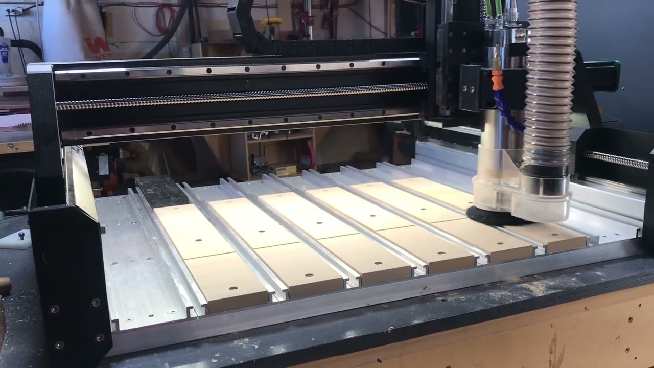

Facing, almost as boring as sanding…until HDM!
Bumped max feeds to 7000 to try to add some excitement to facing. And yes, I know C3D, I’ve most likely voided my warranty. Don’t try this at home kids!
7000 mm/min, 1 mm DOC, 3 flute indexible 1” surfacing cutter. YMMV.
Back down to recommended 5k max now.

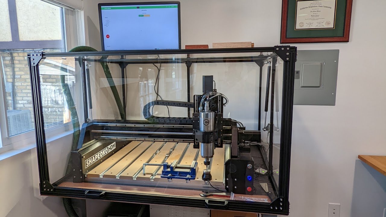

Timelapse of my HDM enclosure build.
