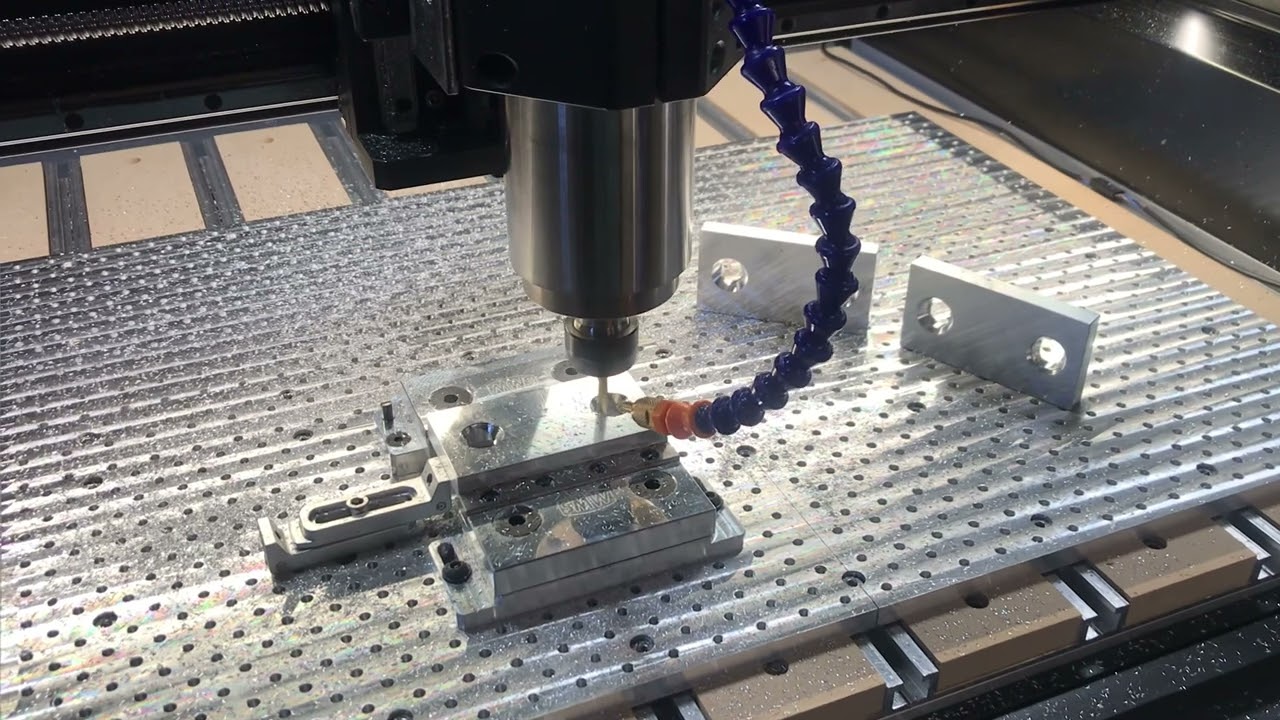

In this case, soft jaws. SMW sells ‘em for about $16 + shipping for two so I’m not saving much by doing it myself…but. Good learning experience for me. Like SMW they are two sided so a total of 4 opportunities on each jaw to screw up before recycling.
