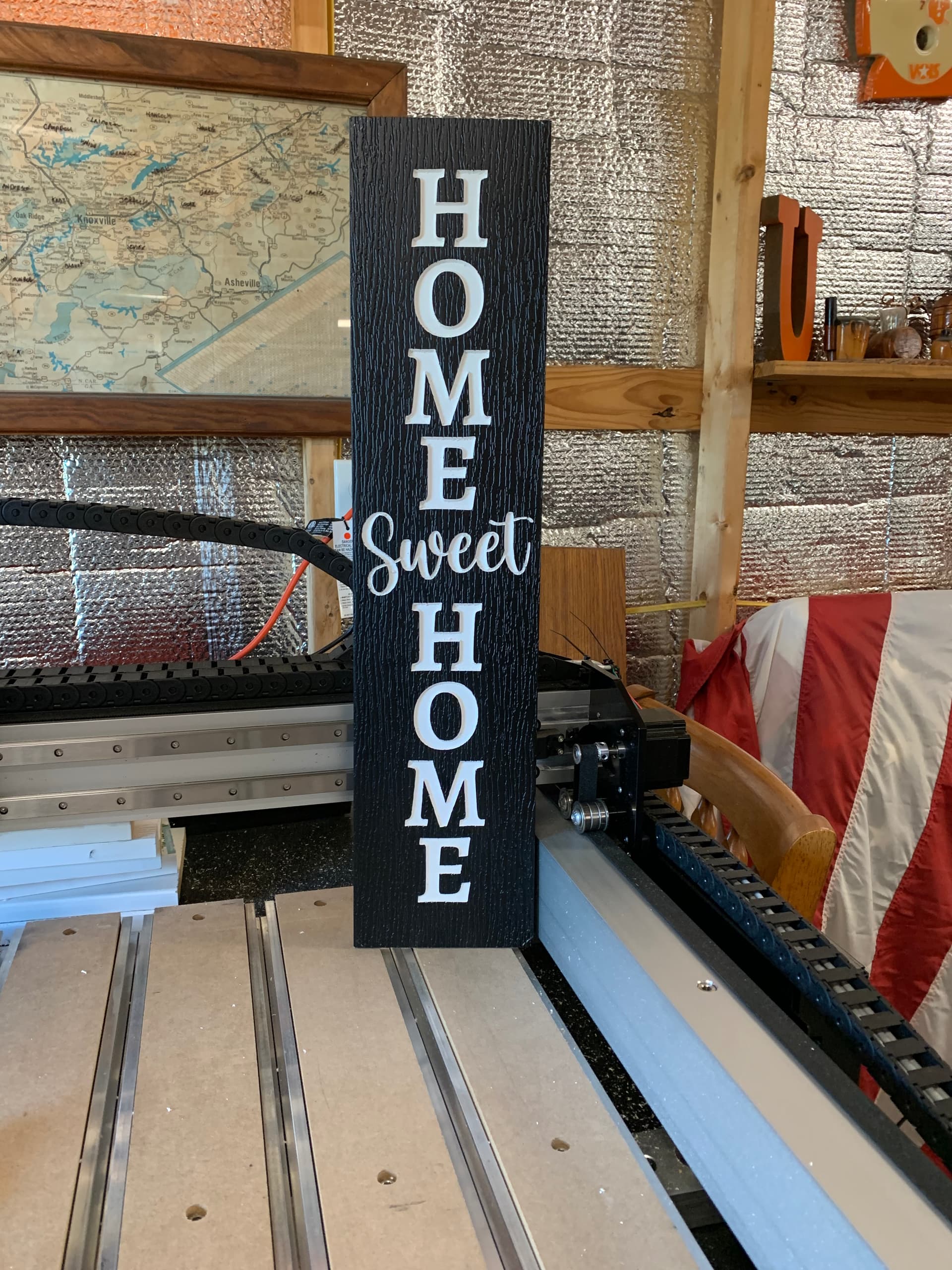

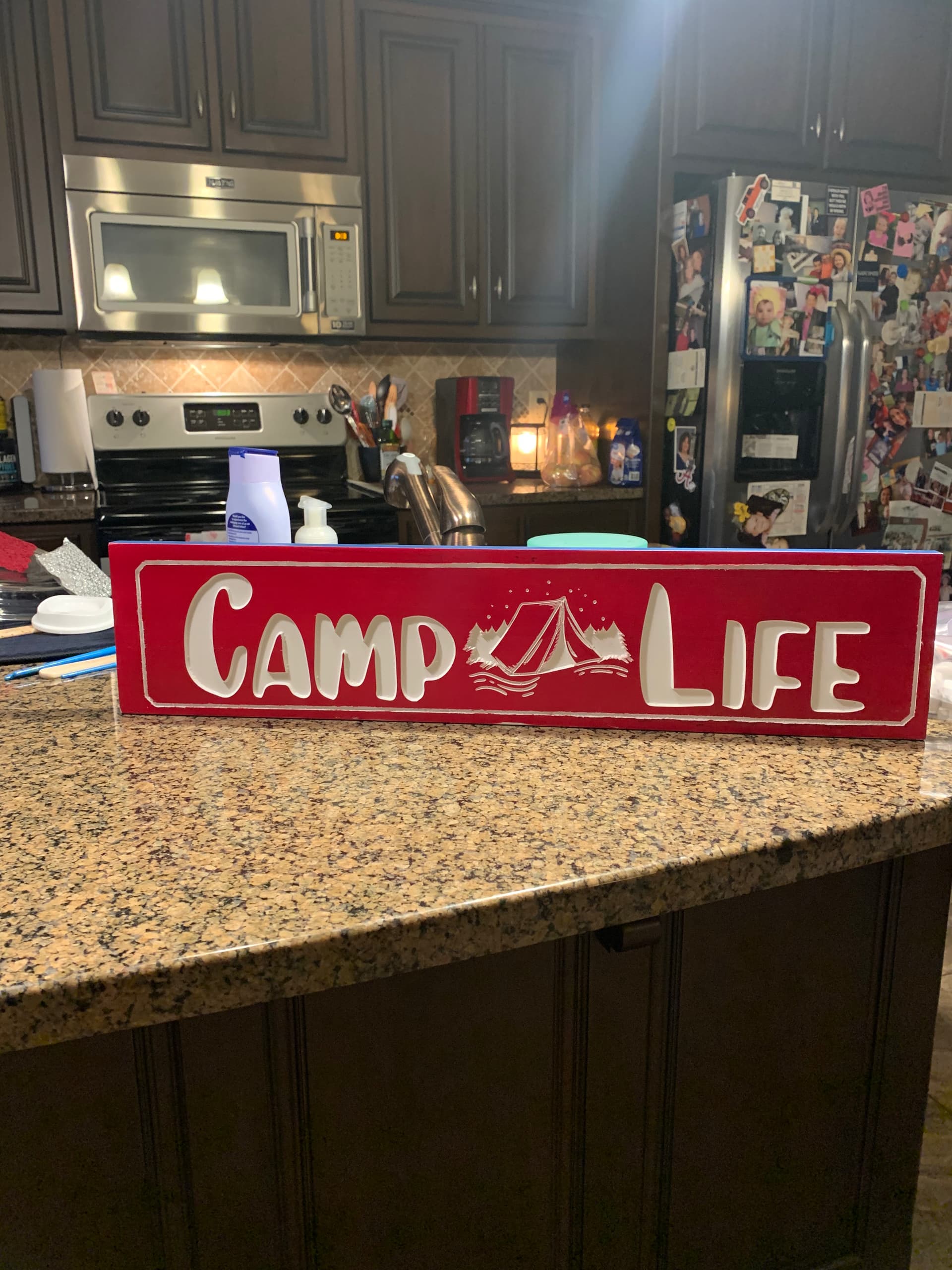

These are my first cuts using pvc board . I’m loving it … less clean up and much neater turn out … limited colors … but it’s a fave
So is the PVC colored or are you painting it? If you are painting what kind of paint are you using? Nice signs
Thank you . Yes I paint the pvc prior to making my cut . I use krylon from lowes … I use advanced V carve with whatever design I may be using at the time . The last step with the 60 degree endmill … #302 I think … cleans it up nicely . Afterwards I take my tweezers and pull any lingering frays away from the piece . I’ve since learned it might be beneficial to slightly sand the pvc before prior painting and cutting . I’ll be trying that next week
Hope that helps . Have a good day

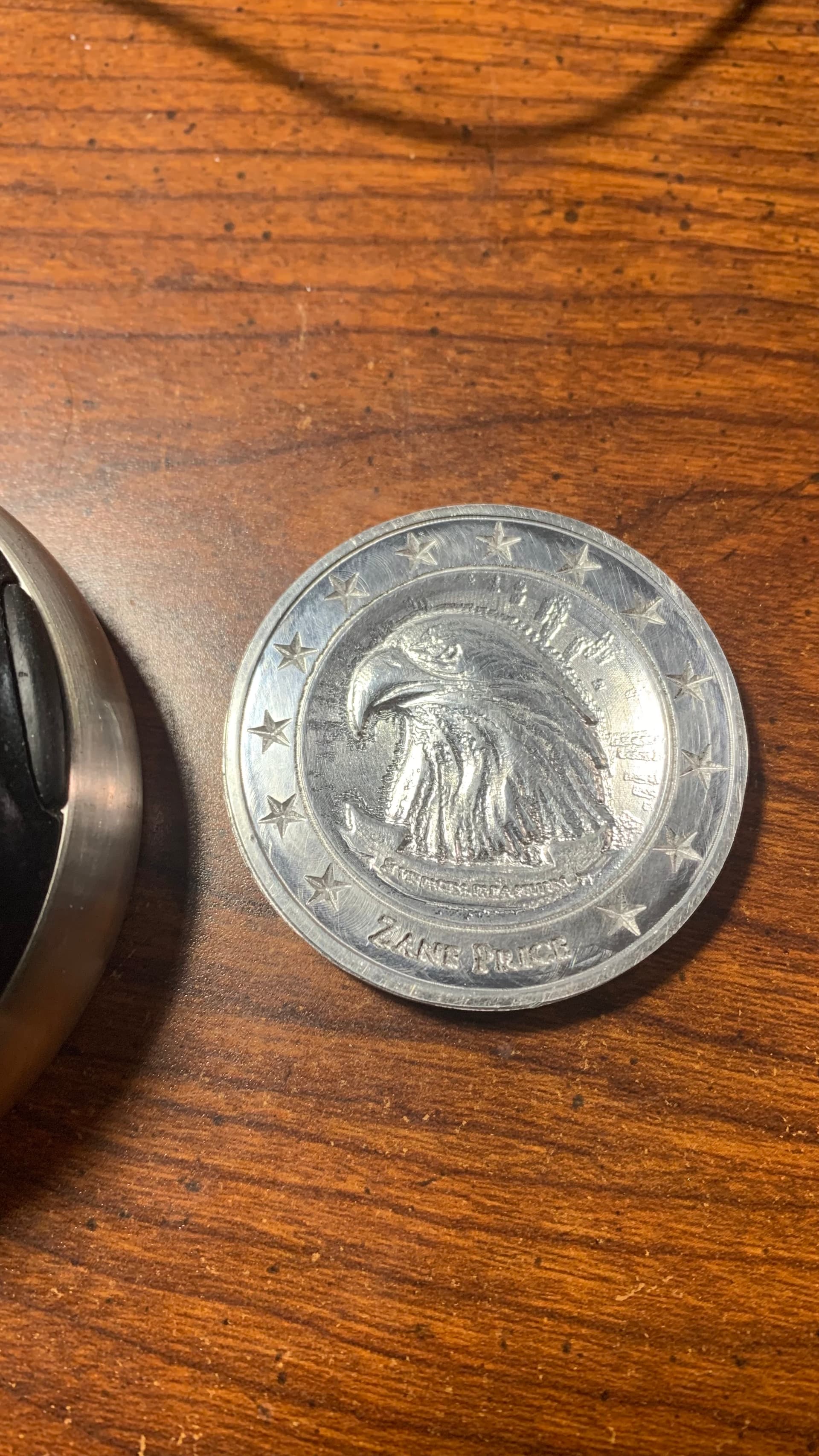

First try in aluminum on the ol shapeoko. these were practice before i make them in brass. Its for my son who is serving over seas. On the snake side i tried to make a 3d model and do a 3d path in v-carve. I think ill re do that to be done with a v bit instead of a ball mill.

Wow! @Aklimaj, how did you model this?
Hi! I just used an ⅛" bit, I think it was a #102
