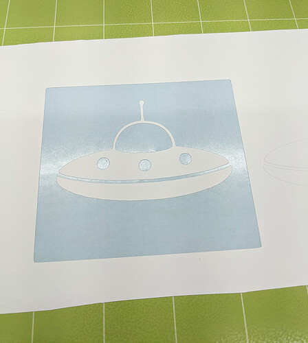

Tried cutting some vinyl decals.
Did you use a drag knife setup for this? What software did you use for this?
I used this vinyl cutter kit. Comes with everything needed. I’m using CC, just a simple contour path with a max depth of 0.001" and no offset.
That kit looks pretty good. I would like one but I have not cut vinyl and most likely wont. However if I had one I might. Should I or Shouldnt I. What a shinny new toy.
