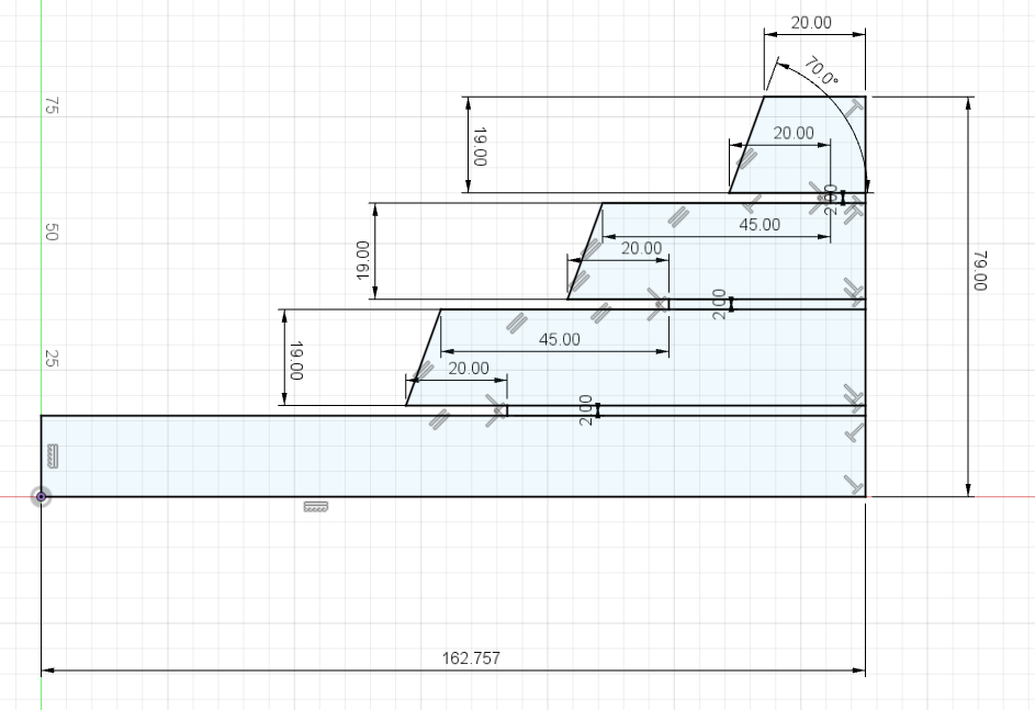

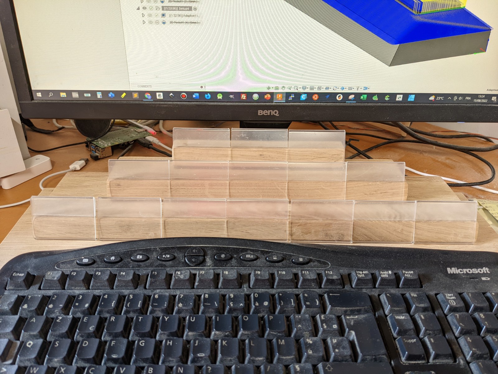

My week-end project was making a weird todo list item holder. I have tried every solution out there when it comes to managing my tasks/priorities, and try as I might I keep coming back to using post-it notes slapped in the front of my screen, which is the only way that works for me so I thought I might as well embrace it. The thing is, post-it notes don’t stick for long periods of time, and it’s also not practical to move them around to adjust priorities in my list of things to do. So I figured that while I would not get away from scribbling my tasks on yellow pieces of paper, I could make something that would allow me to rearrange them easily, manage different priority tiers, not lose any of them because they would fly away.
I bought a 40-set of those mini card holders on Amazon,

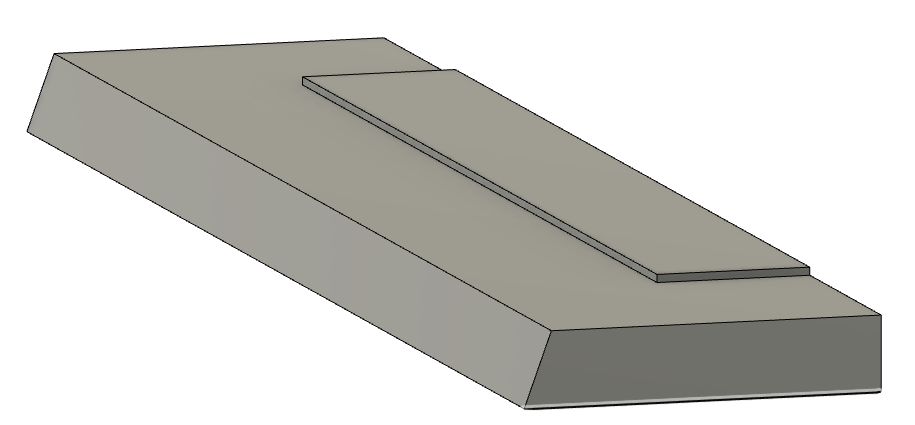

and designed a kind of post-it-pyramid-holder-thing that has three levels (low/long-term priority tasks at the bottom, middle-term tasks in the middle, and the matter at hand on the top row)
And I could then easily move the plastic holders from one row to the next when my priorities change. Or possibly order tasks on a given row by priority and shift them all to the left.

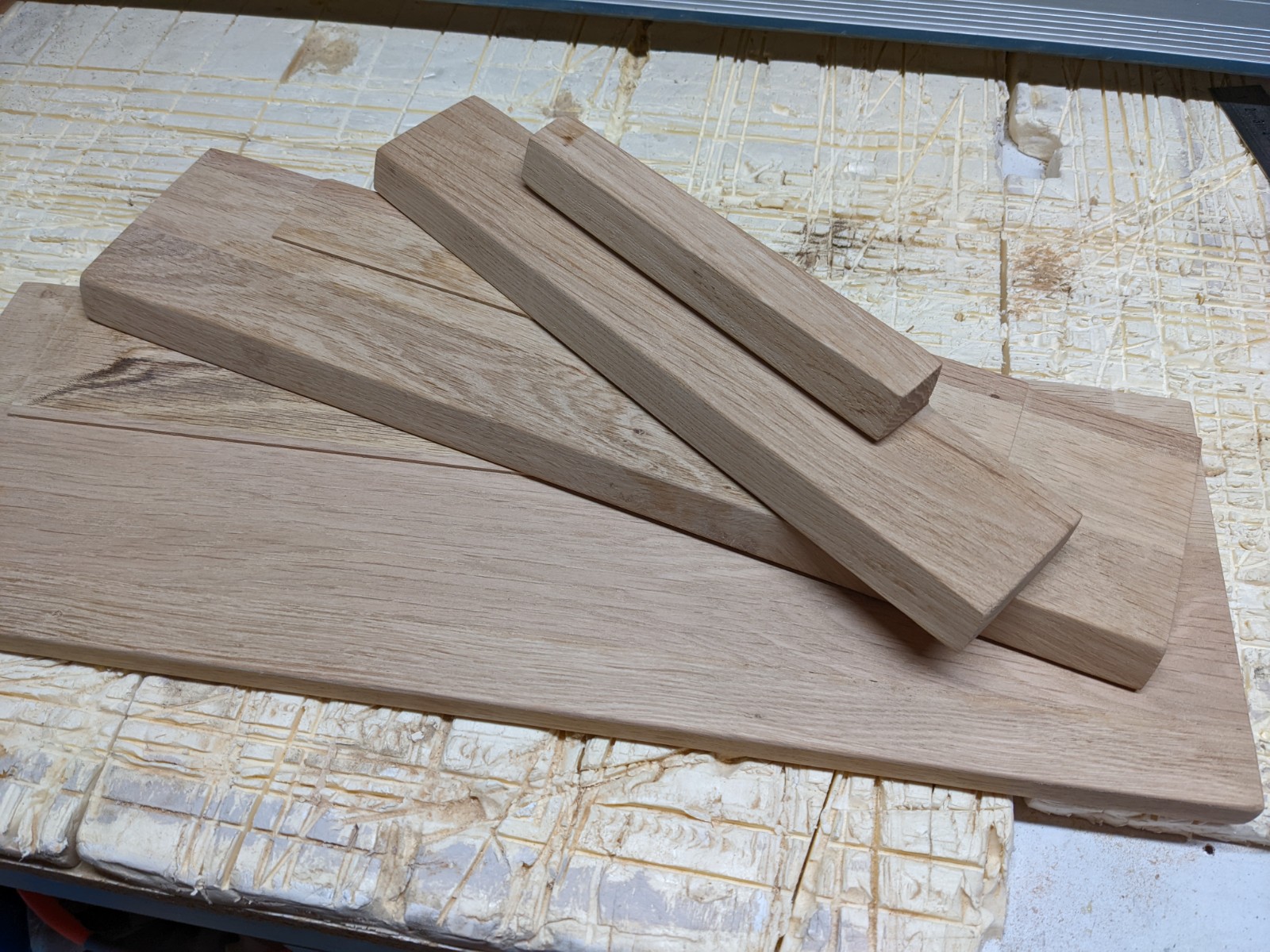

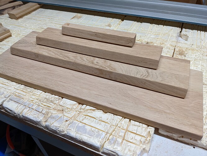

Anyways, to make the tall bulky pyramid I sliced the model into 4 levels, using regular woodworking tools to cut them to size and cut the 70° bevel, and finally used my Shapeoko to cut them to the final thickness and cut the embedded 2mm spacer between each layer and the next.
Nothing to say about the CAM, very simple 3D adaptive clearing using a 6mm three-flute downcut I had on hand. Everytime I generate a toolpath with lots of rapids like that I’m thankful to @fenrus for coming up with the gcode optimizer that circumvents Fusion360 limitation on rapids for hobby users.
Uneventful (albeit long)cuts later,
I glued the four layers
And voilà, majestic bulky post-it holder holder, ready to be used.
If I know one thing, is that one can never tell in advance whether such a thing is actually going to be useful, or end up in the bin after a few days/weeks. Time will tell !

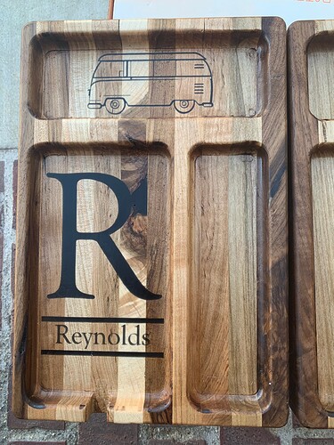

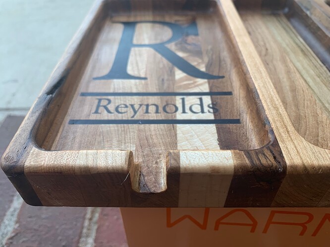

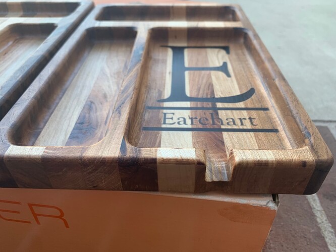

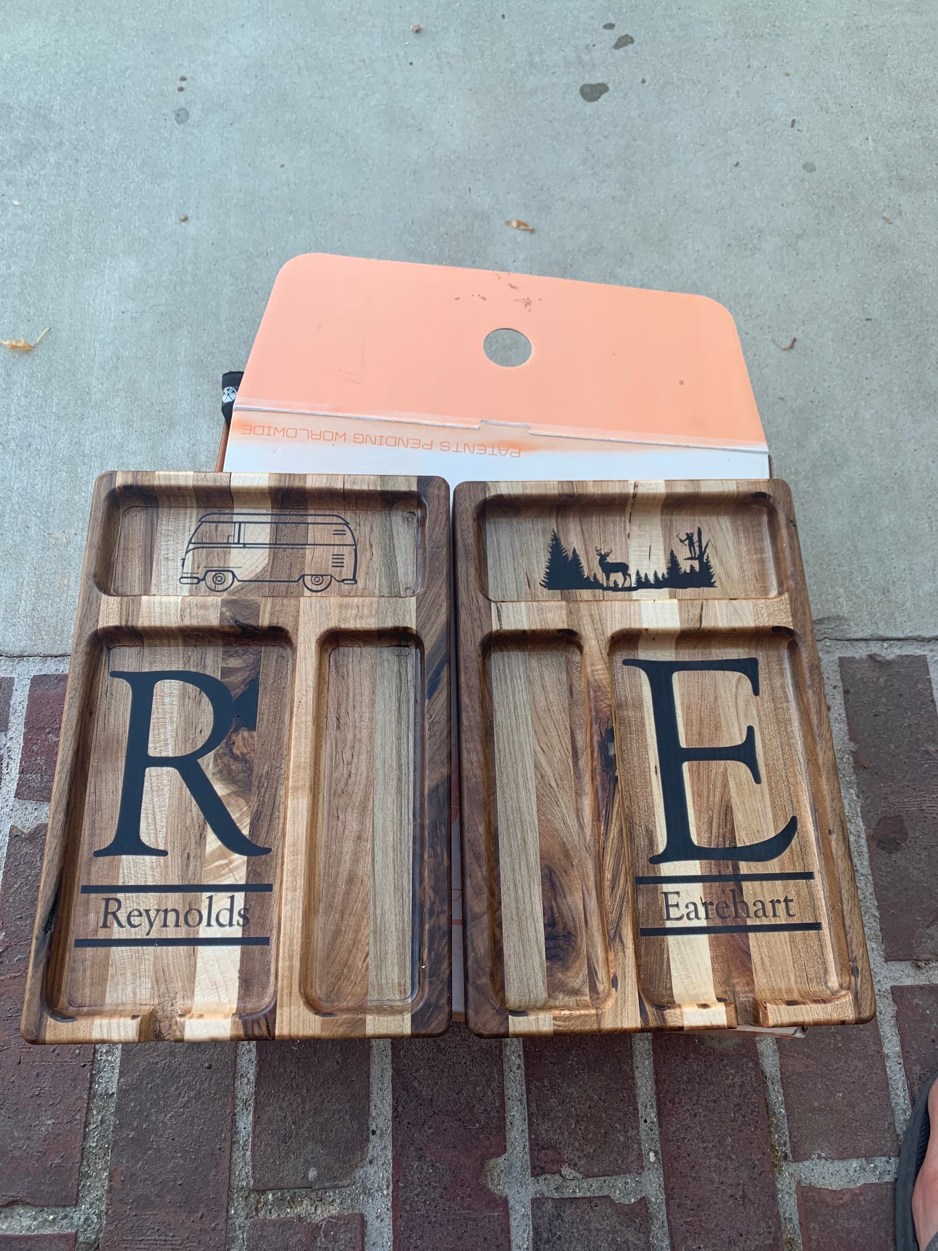

Over the weekend I made two Men’s Valet/Catchall’s for my buddies.
I used 3 hardwoods, epoxy, Vcarve, and my Shapeoko.
A few minor “custom features” that only I will notice, but my buddies are stoked and impressed.
My skills are definitely coming along.
Wood is;
Walnut, Cherry, and Maple.
The finish is Cutting Board Oil.

Guessing you used a laser for the print, what type was it that allowed the distance from the optics to the board? I have a diode, but it has to get right up on the material, wouldn’t be able to do this at all with it.
(Anthony mentioned this is an epoxy inlay, not a laser job, you are correct that this would be difficult to do with a laser due to the focal distance and no clearance for the laser shroud, and removing the shroud is not a great idea)

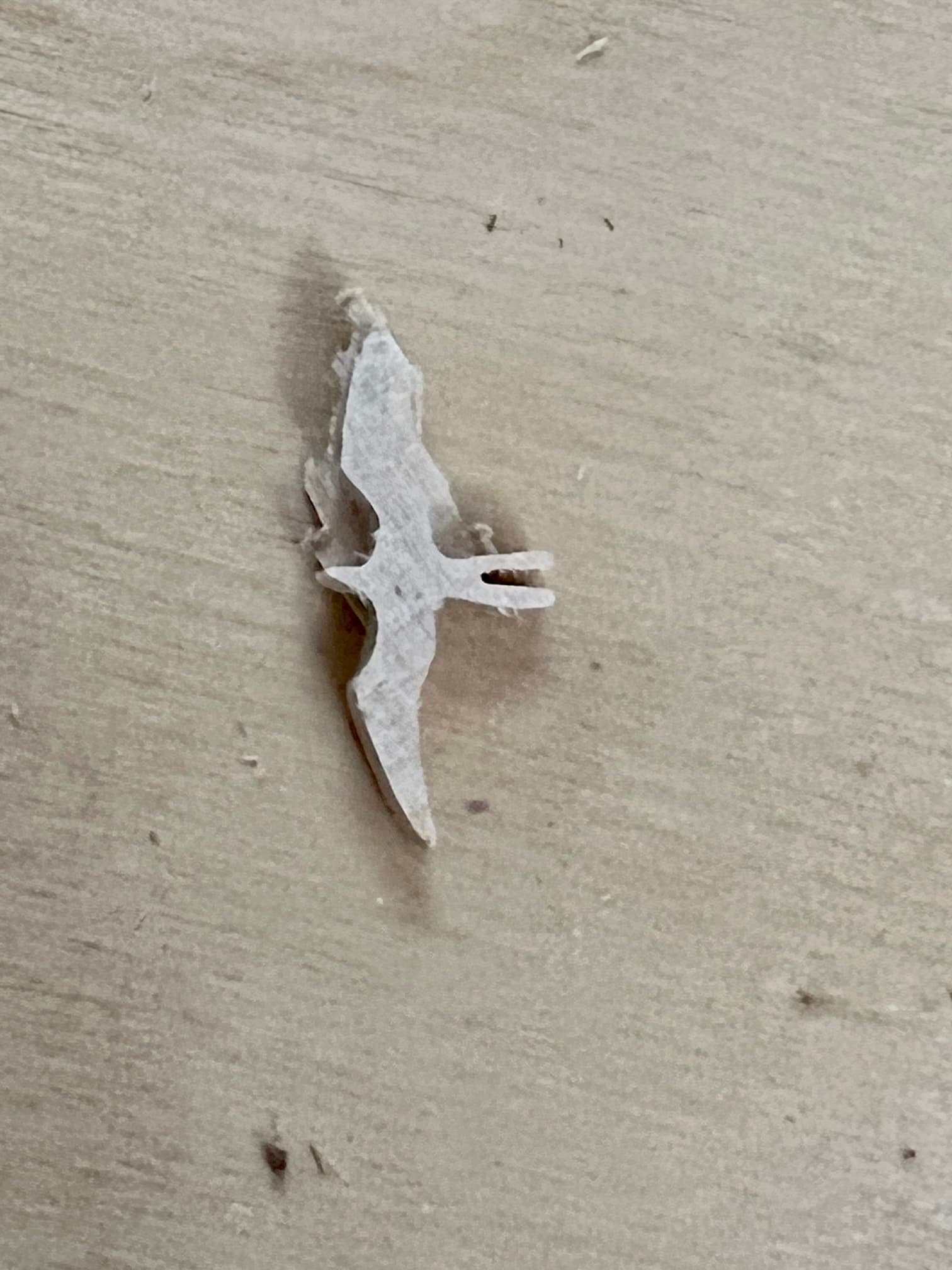

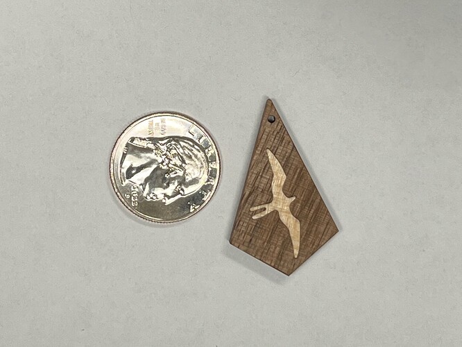

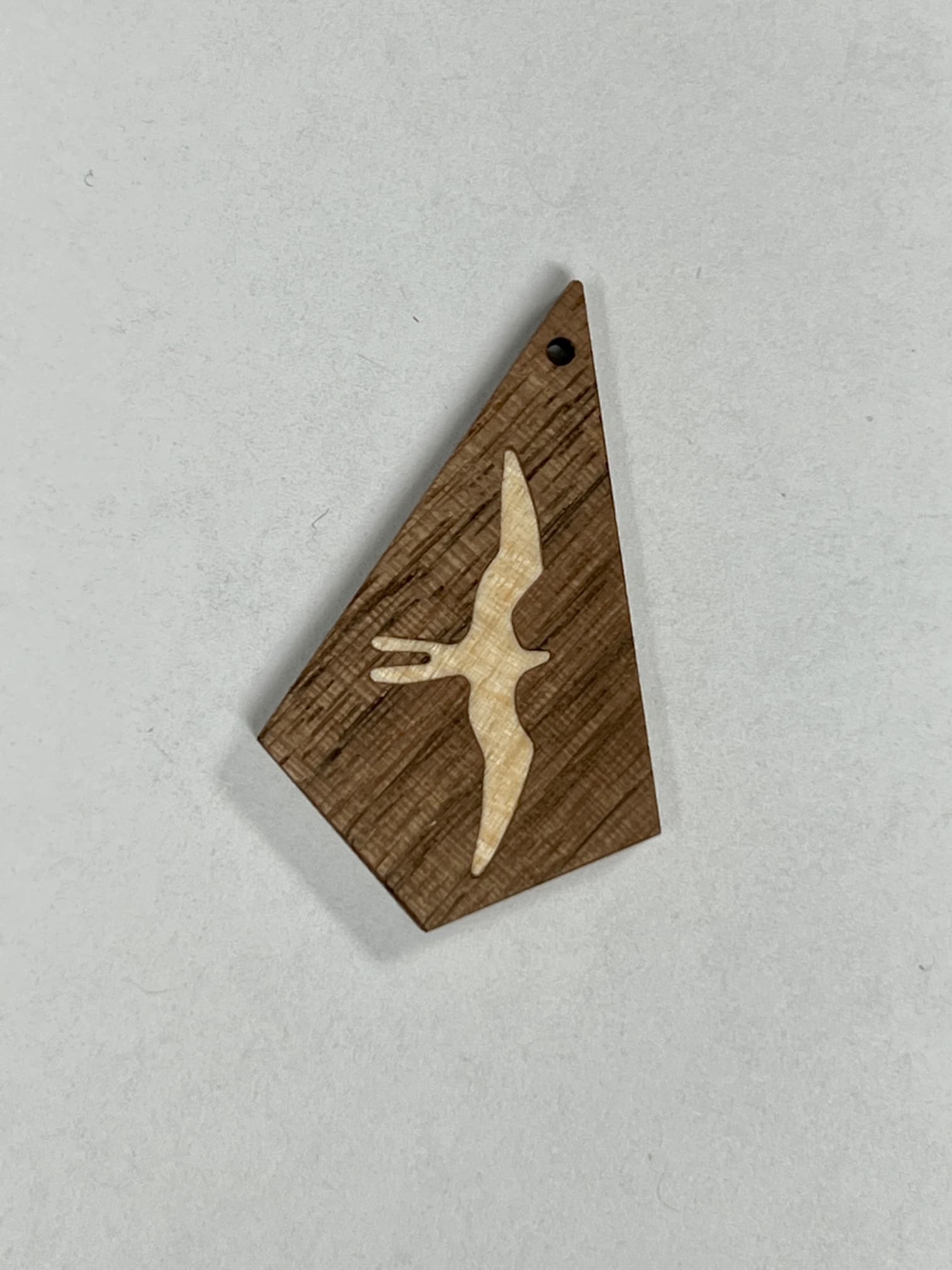

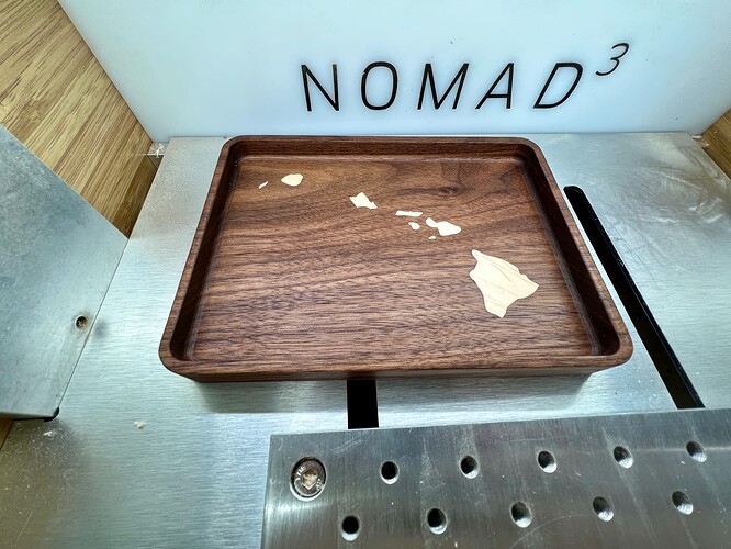

Tried out making inlays for the first time on the nomad 3.
maple and walnut wood. For both I cut the pocket 0.05" deep and for the inlay I reduced the size by 1%. I used CA glue and then faced off the inlay in the nomad for the islands and hand sanded for the Iwa bird.

I used a 20° v-bit. (the trick to get the ° symbol is to hold down the ALT button and press 0176)
The start depth is .5" to match the pocket cut. Flat depth set at .75"
I should have let the epoxy cure a little longer but I got too excited. I redid the pocket cut with a start depth of .45" and a max depth of .5".
What I learned.
I am making another set for my brothers. I will set the start depth of the V-Carve at .51", then fill with Epoxy. Then when I recut the pockets, I will set the new max depth to .51".
Also on the first pocket cut, I used a raster tool path. On the second pocket cut, to clear the epoxy, I will use an offset tool path. The reason for this is on the Raster tool path I get a little bit of tool marking on the ends of each pocket. I think the offset tool path will clean that up.
I will post the next batch when completed. I am letting the epoxy set a little longer.

Love the Hawaii islands inlay. I’ve been trying to do a 3d wall hanging of islands but so far have not felt what i have created is good enough to hang yet.
Thanks! Me too I’ve been trying to get a 3d model that shows the topography of the islands and then cut it out of koa wood but haven’t found a good model yet.
