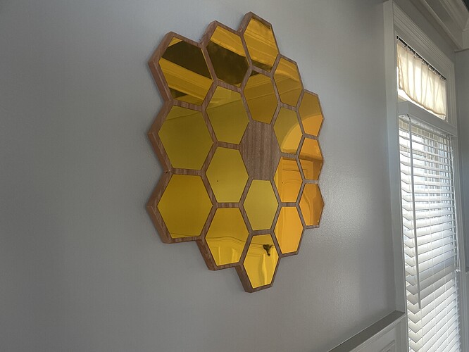

cutting the acrylic mirrors was a bit fun. makes me want a 24w laser upgrade but the wife says no more toys
Wow. JWST coolness + another evidence that hexagons are the bestagons!
OK, we need a JAG (Julien Acronym Glossary)
That’s the acronym for that new space telescope thingie we just put up.
