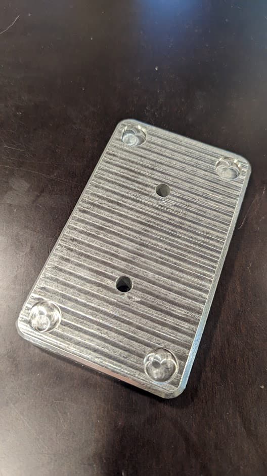

tested some 1/4" single flute toolpaths on this piece of scrap aluminum I had kicking about.
facing recipe: 1016mm/min | 0.2m DOC | 2.5mm WOC | 22k RPM on my Nomad 3
the helix ramp for those holes sounded pretty terrible, (not using the same recipe for facing dont do that, it will probably be awful) but left a good surface finish in the end. in all honesty, I probably will just switch to a 1/8" endmill in the future for operations like that anyways.
this will end up being an ashtray for my father-in-law who enjoys cigars. probably save it for a christmas present or birthday present or something.

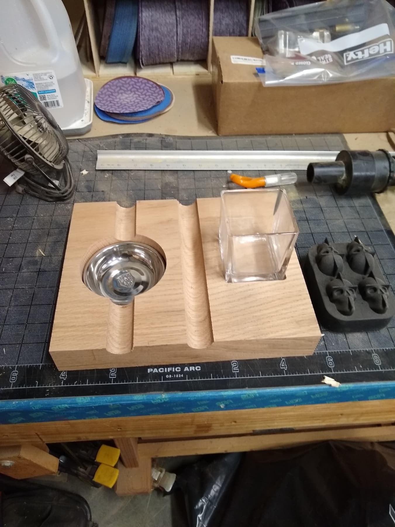

I made a prototype to sell to a cigar store in Nacgodoches. I used a big hunk of oak. The cigar stand has a place for a nice whiskey glass. A half pipe to put your new cigar and an ash tray and a place to lay a burning cigar. Maybe your father inlaw would like some thing like this. The ritual of sitting down pouring an adult beverage and smoke a cigar is a great one. I know it is bad for you but nobody gets out alive in the end. Enjoy the ride.
I modeled the half pipes in Carbide Create Pro. I need to go back and refine the tool path. I have enough to make 4 of these out of thick cherry. I just need to get to it. I guess I am lucky that I have more ideas than time.
Edit: In the top picture the black square are ice cube trays to make the skulls to put in your adult beverage.

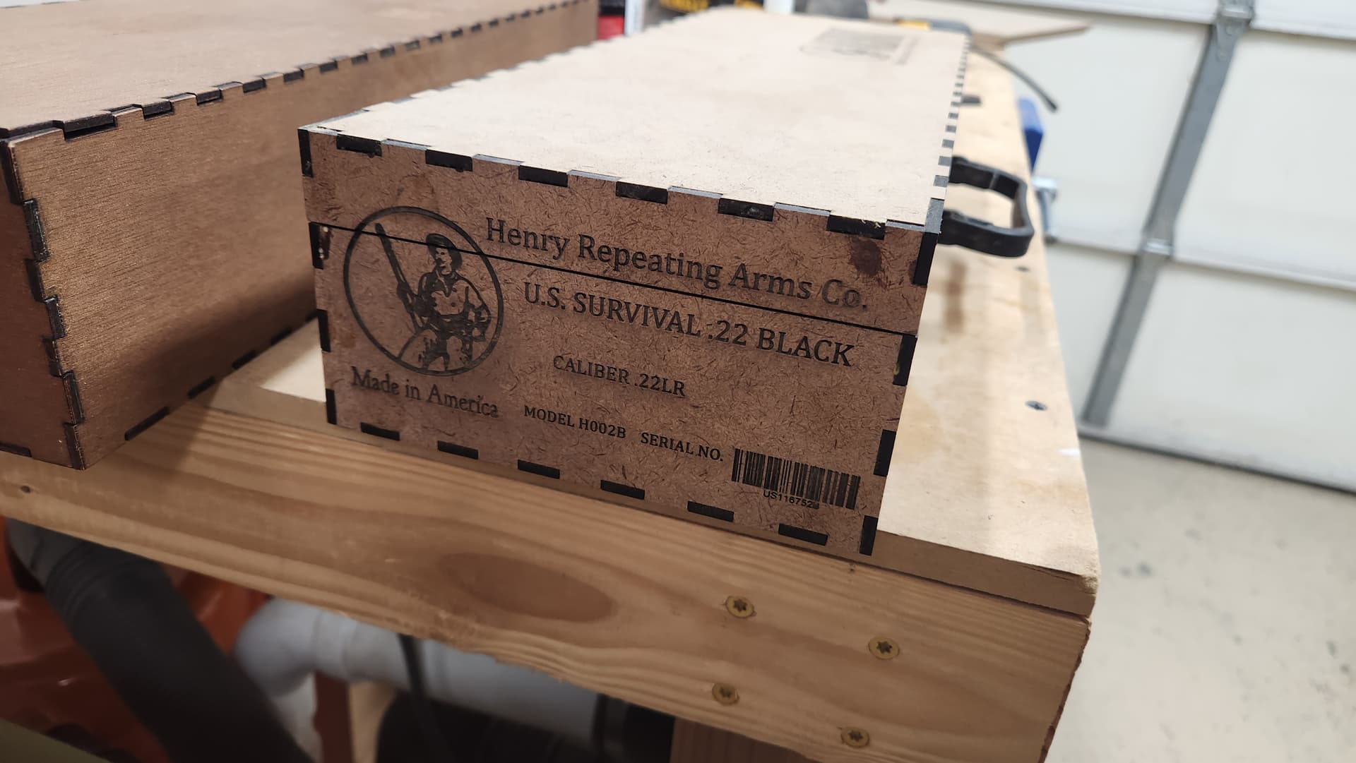

I cut a box for a Henry Survival Rifle with the HDM and Jtech 24w. Still needs finished and foam inserts after glue dries

Would you share your file. I have one and need a case. Looks quite thick are you storing ammo inside. Is the gun assembled or disassembled? Do you have a scope on it?
It’s not mine but rather my father’s. I used .125" Eucaboard. The box was generated online and I did the art. I’ll post the dxf later tonight.

Henry Gun Box.dxf (2.6 MB)
Thanks for the file. The inside corners are going to be round. Did you use a chisel to square them up or was there enough room to assemble. I made a toolpath with 1/16" bit so the round will be small. I assume the blue line is the cut off line to remove the top of the box from the bottom?
What application did you generate the dxf file with?
I just bought a used JTech 7W laser and will try the Henry Logo with that.
It is laser cut so no worries for me about inside corners. I used one of the online box creators to make the box then edited in vcarve pro.

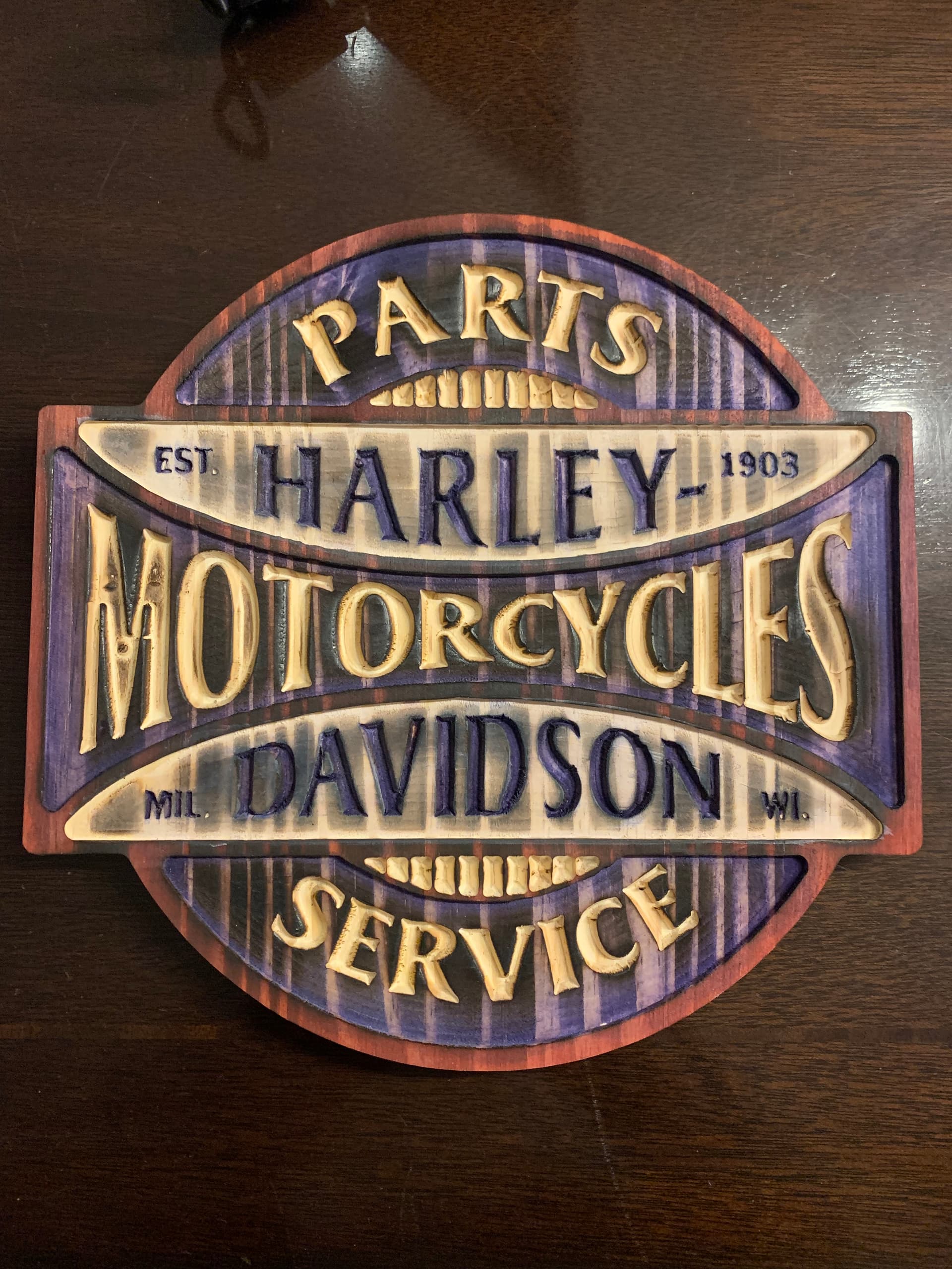

PXL_20230205_225828444-removebg-preview~2
Waiting for the paint to dry before putting on some finish, what would be the best thing to put over this as a good finish that doesn’t change color or anything
Since you have multi levels I would use spray poly acrylic from Minwax. There are other brands. Just do light coats. The Minwax dries quickly and you can put multiple coats on in a day. Just dont spray too much at once or it will run and pool. Spray in one direction on coat 1, then the opposite direction on coat 2. If it required coat 3 and 4 do those from the ends. Just do light coats and I use a 3m white finishing pad to remove dust nibs between each coat.
