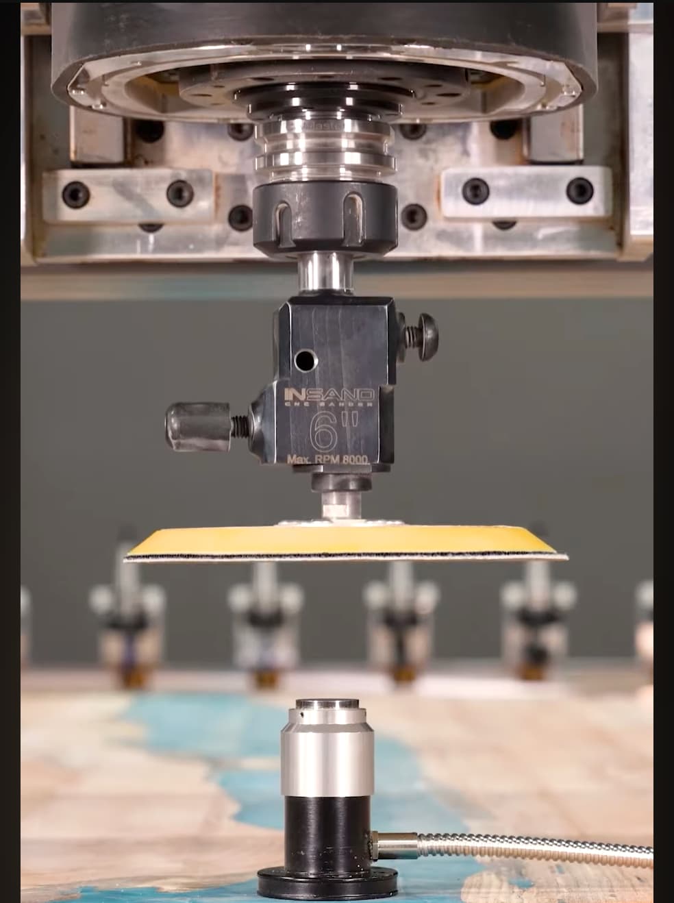

I’m looking at the potential to use a sanding attachment on my shapeoko 5 Pro 4x4 with water cooled 80mm water spindle. My process requires sanding which I have various other methods I can use but I’m wondering how I can try to remove the manual aspect to it where possible.
The main one that I can see online is this one linked below:
  • Can it work with the carbide 3D 80mm spindle?
  • Anyone done this and have feedback?
https://www.youtube.com/watch?v=beTd8VsV2Hg
@Tod1d given your experience with CNC sanding, I’d be interested in your thoughts on that monster of a sanding attachment :slightly_smiling_face:
Lol it doesn’t need to be this specific one if people got better alternatives. It’s just so we have a product to centre around so you know what I’m talking about :slight_smile:

Doesn’t look balanced to me. I would be pretty nervous trying to spin that thing 8000 RPMs.
Might shake the machine off the table, if not worse.

In the video they said it’s balanced from factory, no adjustment necessary…now, how long will it stay balanced without adjustment…well that’s another question :stuck_out_tongue_winking_eye:
Just keep in mind that the minimum RPM of the VFD spindle is the maximum RPM of the sander attachment. If there’s too much friction and you heating up the pad, you’ve got no options other than taking a lighter pass and going faster to make sure you don’t linger too long in a spot. This is right at the edge of what’s safe and sane for this particular combination.

By the way, the linked is a RANDOM orbit which is why it’s got that big block half way down the shaft and it talks about being balanced at the factory.
However, the things I’m trying to sand are 100x100mm and there are many of them. I’ve got a new random orbit 6inch sanding setup as my go-to, and a drum sander to test a jig idea for it as a half way automated idea between manual sanding and the CNC sanding;
but I wanted to see what ya’ll thought of this CNC sander attachment considering, in theory, something like this would work well for these small items as I have a CNC surfacing jig for them already to clamp each individually and flatten them before I sand, and something like this would reduce my workload by simply switching out the attachment to then sand them.

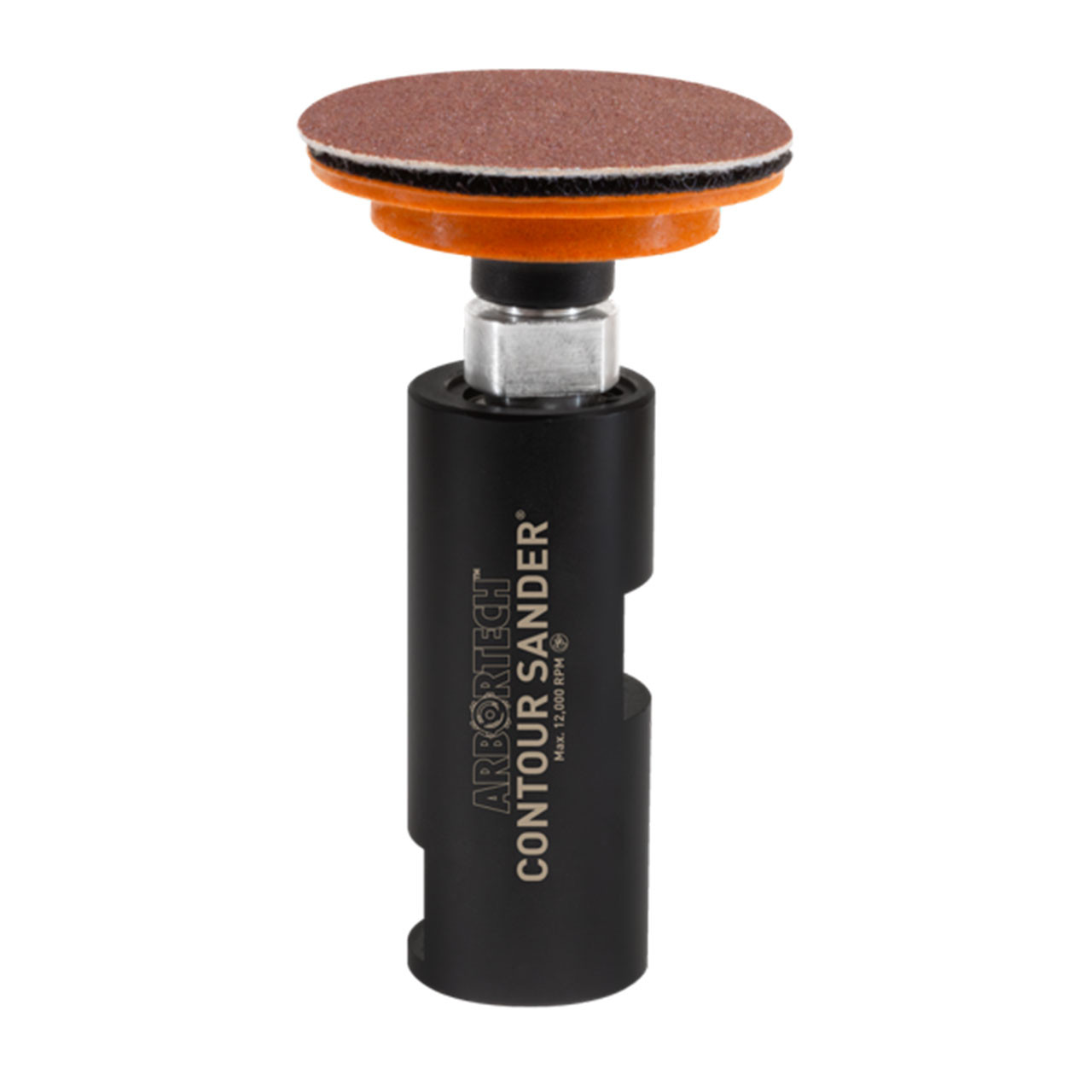

I’ve wondered about using this Arbortech RO sanding attachment made for an angle grinder. It’s good to 12K rpm. I have one already for sanding turned bowls, so that makes it an attractive option for me.
https://www.woodworkingshop.com/product/AK21020/?gad_source=1&gad_campaignid=20359803750&gbraid=0AAAAAD_WAOiBIfdjfUcjAYn48_UhhhgR4&gclid=Cj0KCQiAr5nKBhCpARIsACa_NiOp0pfffrbjTvTdz04tzgctTJiyE9Cc2SjclKDTtdoQK226xUMd6IYaAuttEALw_wcB
I’ve been thinking about an application where I’d want to sand inside a recess, so a small diameter sanding disk might be appropriate.
