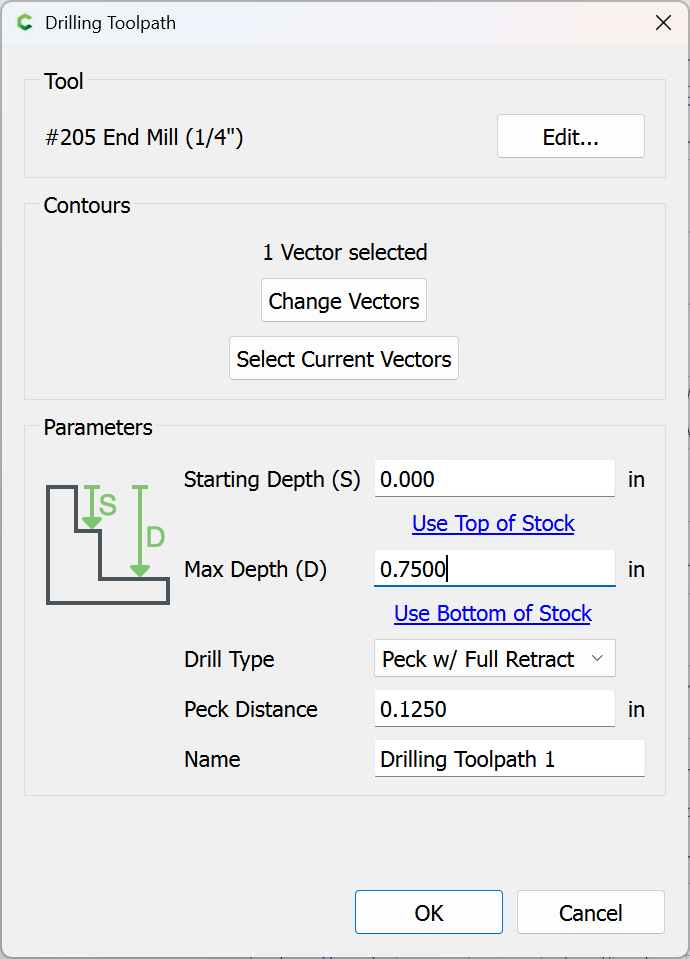

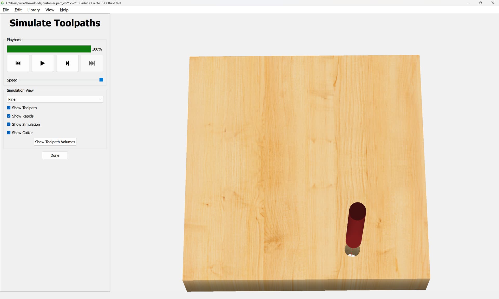

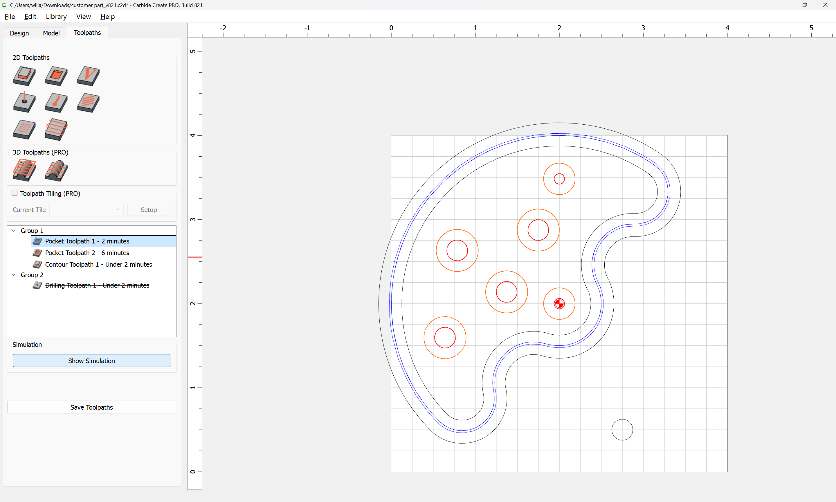

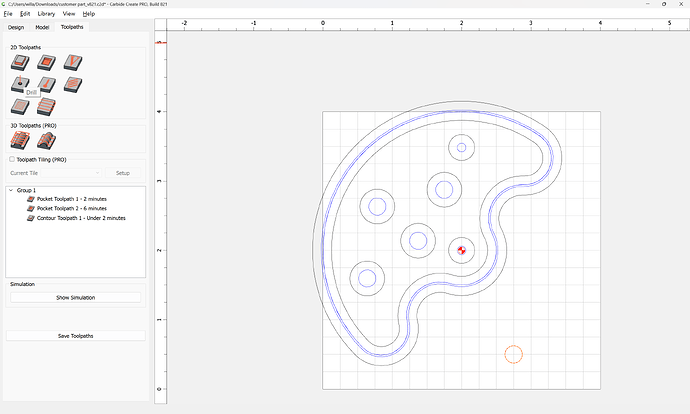

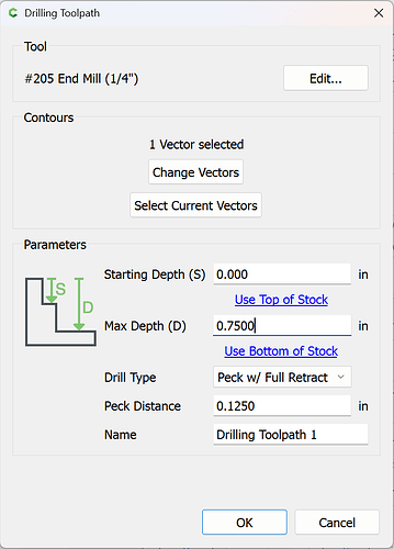

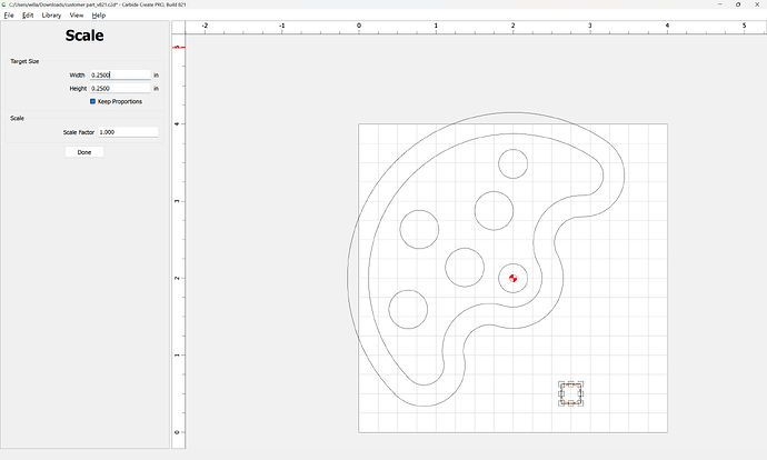

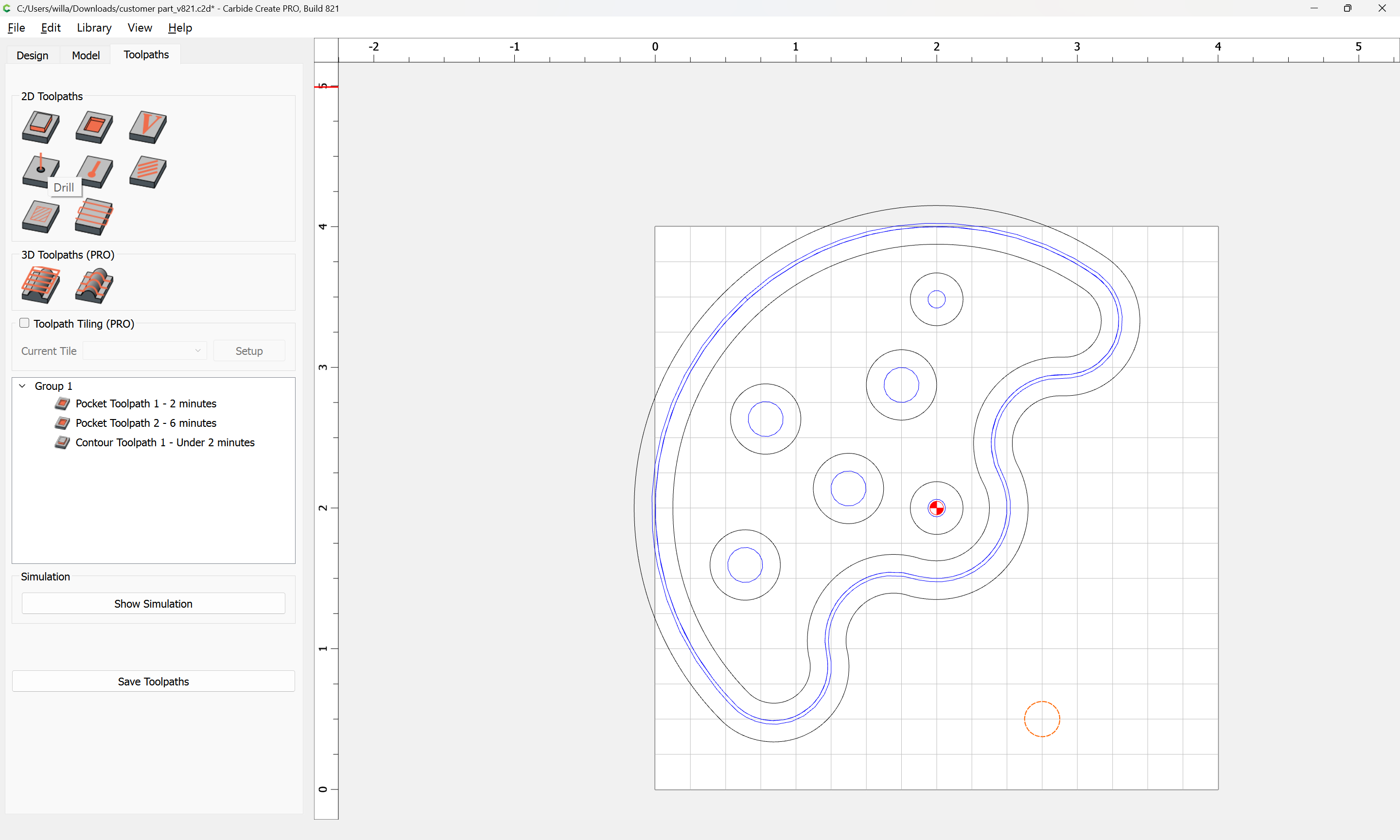

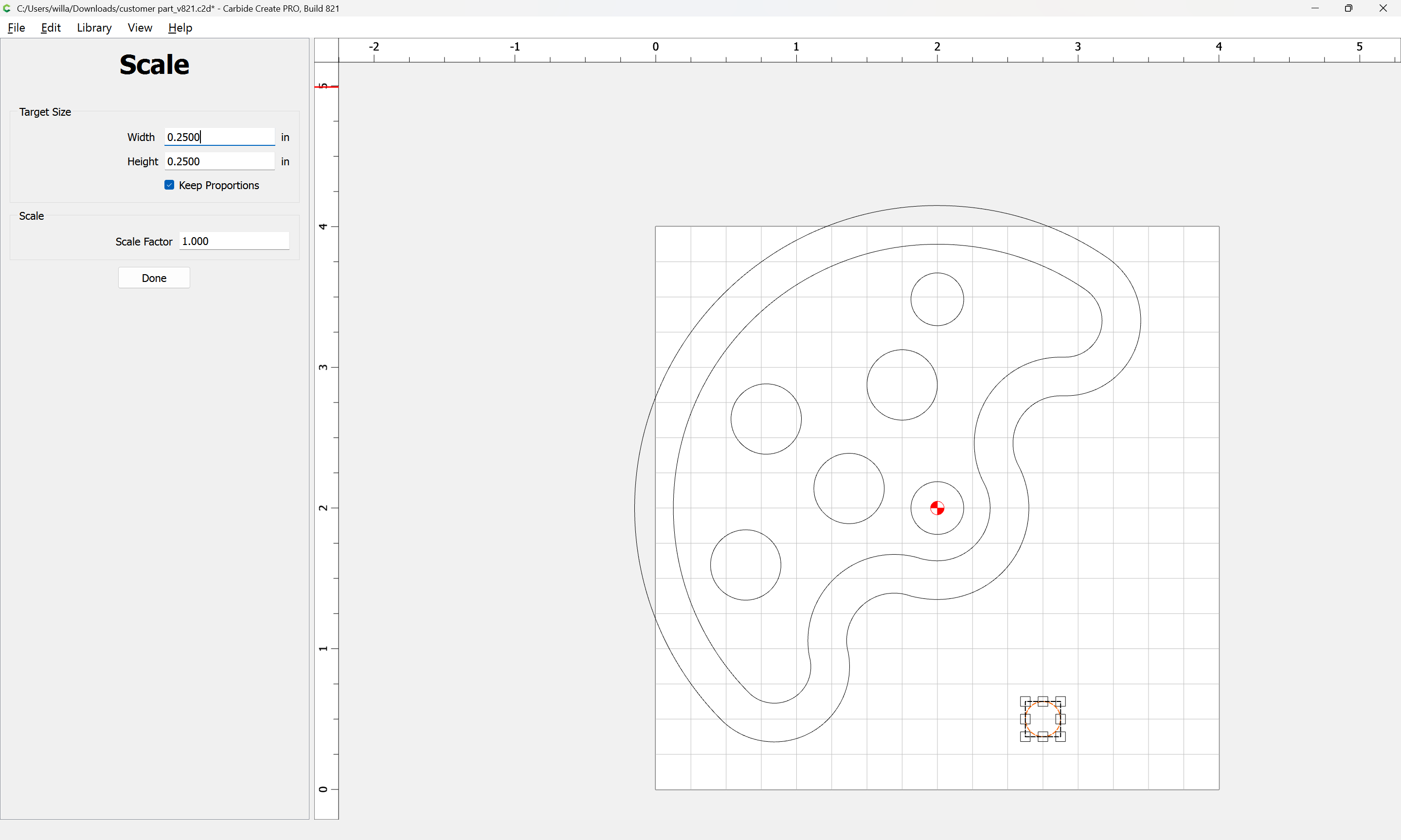

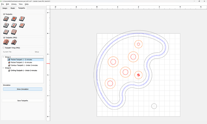

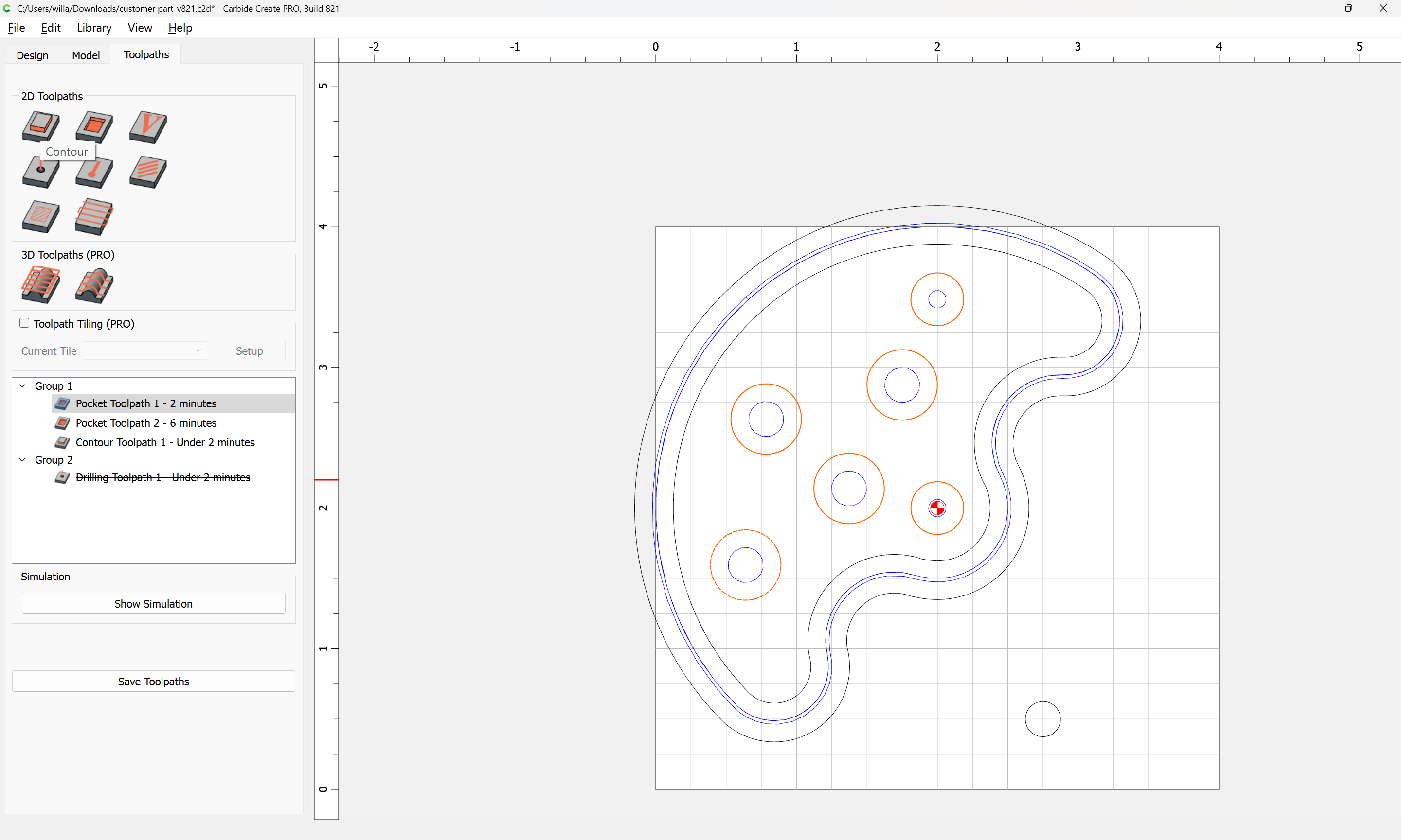

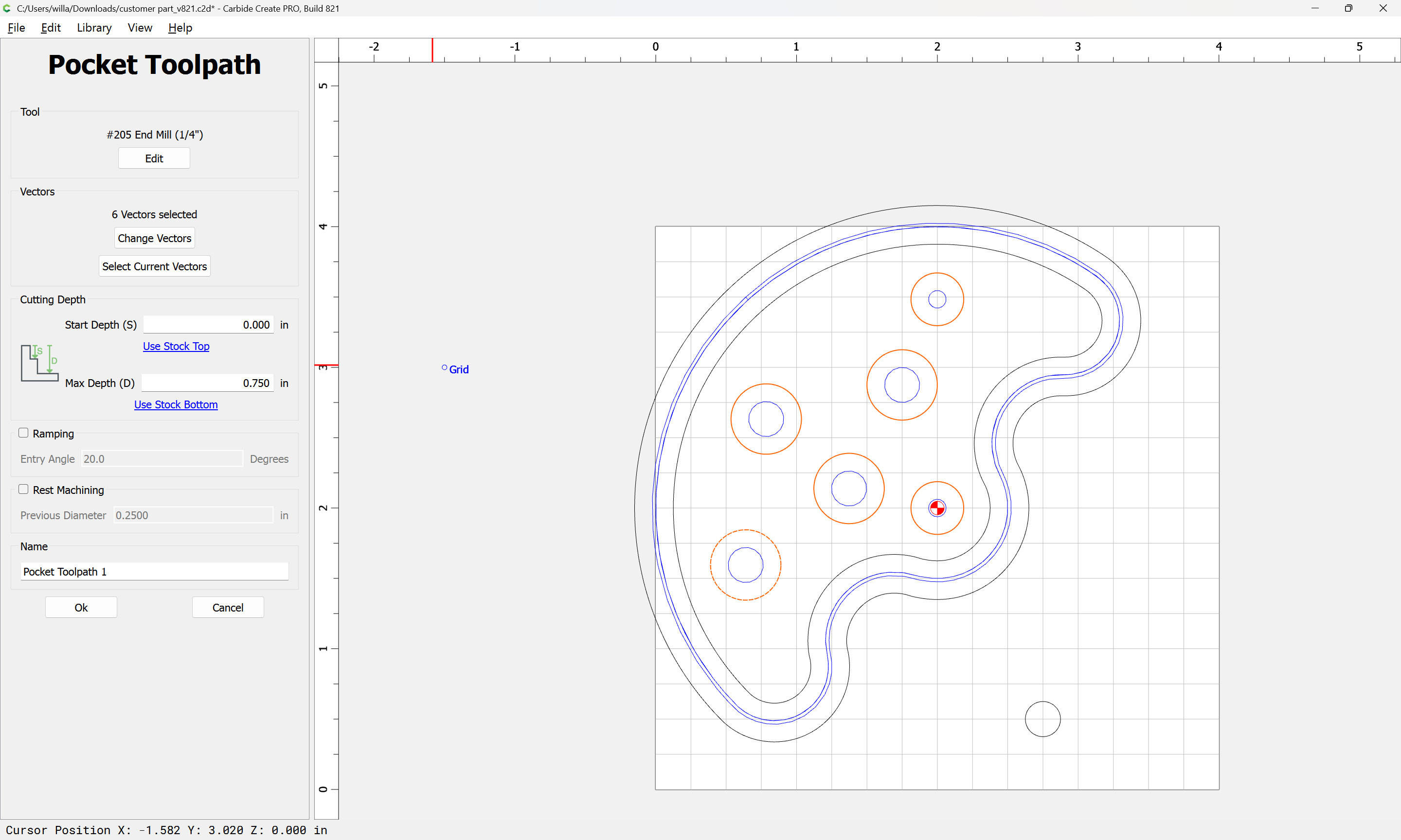

There are two approaches for making holes:
a “Drill” toolpath — this requires a tool which will cut the desired hole dimension, and is vulnerable to issues of tool/machine deflection:

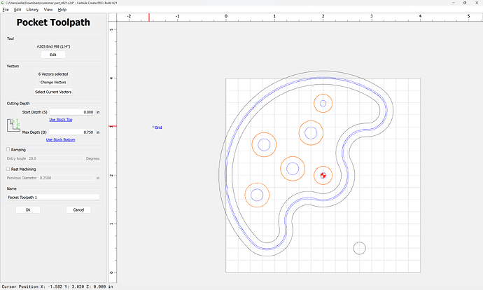

a “Pocket” toolpath as was shown above:
Select round geometry:
assign a Pocket toolpath:
Note that this allows the option of drawing the hole smaller, cutting it, doing a test fit, then adjusting the size and re-running the toolpath.

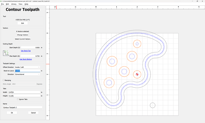

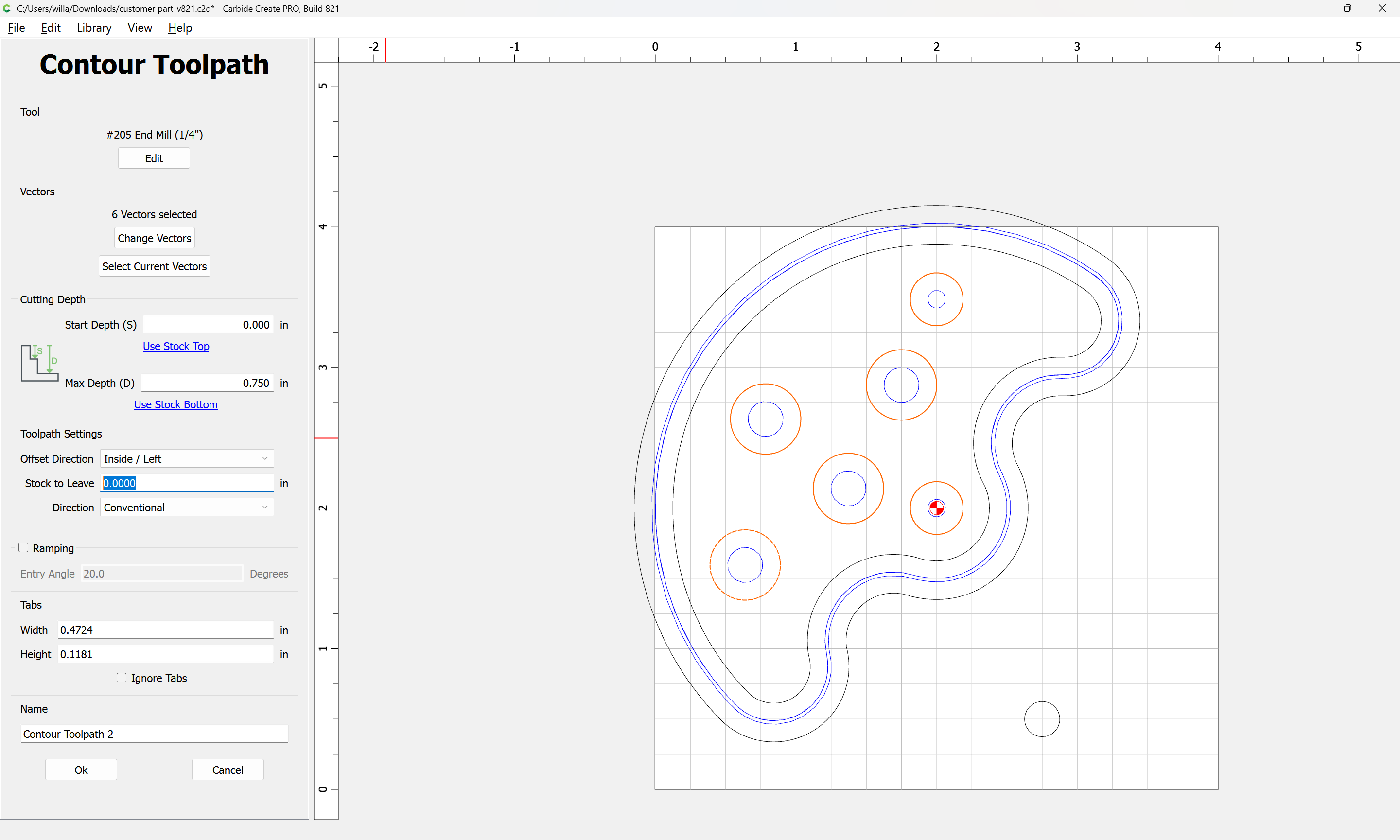

Alternately, if you have Carbide Create Pro, then if the hole is smaller than twice the endmill diameter you can use an Inside Contour toolpath
and adjust the “Stock to Leave” parameter:
and then make the cut and do a test fit as described above.
Alternately, this can be used so as to allow a full-depth finishing pass as discussed in:
