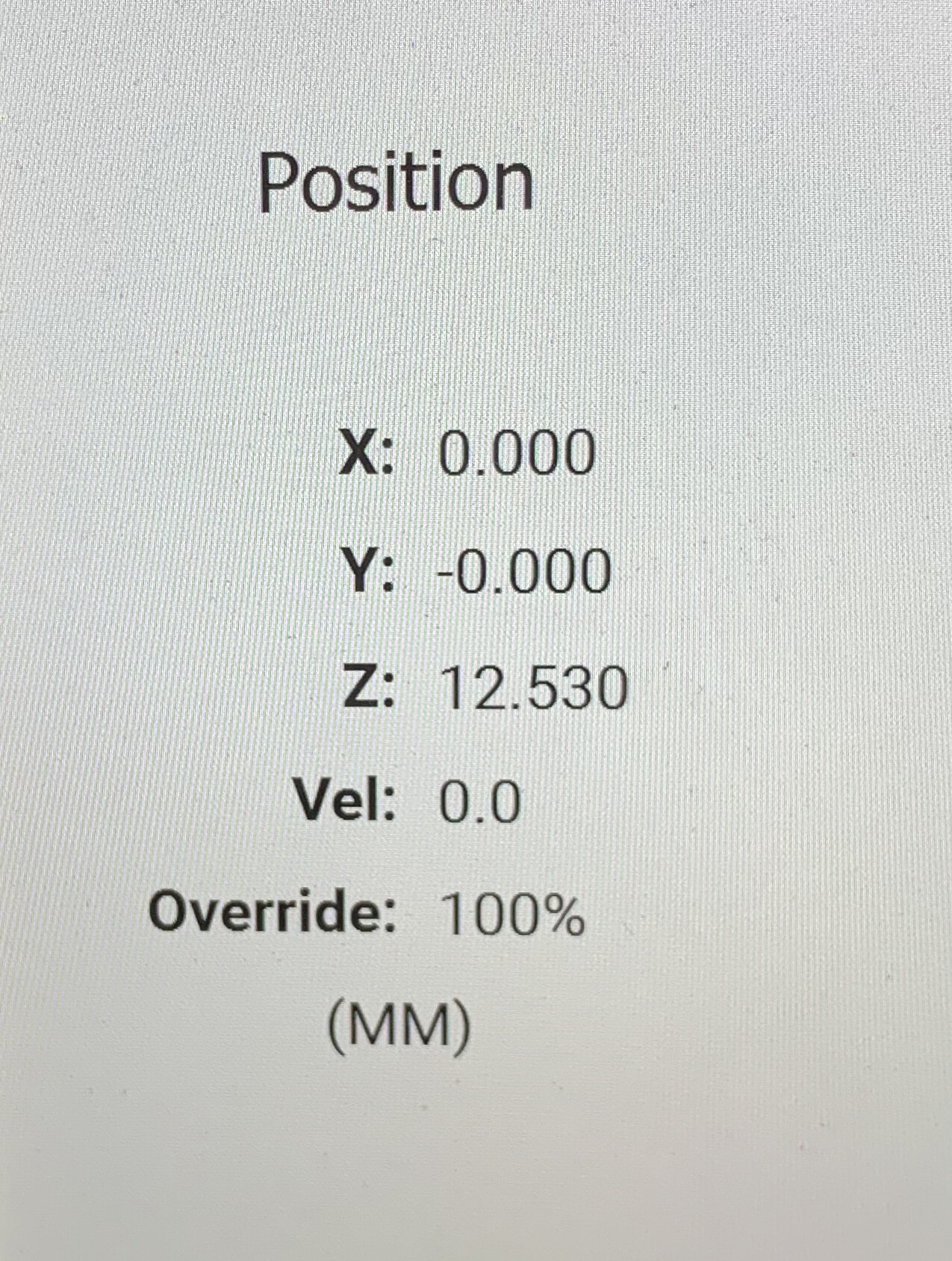

The first time I ran the project yesterday, resulting in the 9mm hole, I did exactly that.
I returned the spindle to X=0, Y=0 and manually jogged the Z down to the top of the stock, like this…
…so CM should show the X, Y and Z values as 0. However, these were the actual values:
I repeated this exercise with after the second attempt, but the first cut was ‘only’ 5.15mm. This time the Z reading was 4.295mm.
Also, I measured the stick-out when I ran the project earlier today, and it’s 43mm from the bottom of the collet nut to the bottom of the cutter. The top part of the cutter is just visible in the locking pin hole of the Makita spindle. This is how I ensure the cutter is held by the whole length of the collet (without there being a depth mark engraved on the shaft of the cutter).

I think @Julien has some reasonable suggestions. Measuring the tool protrusion is probably wise, otherwise it’s just going to be by eye.
Another interesting observation would be the active numbers for the Z value when a cut is too deep, but before you stop it (which will change the Z). This would let us know if CM is telling it to go to (say) -9mm, or CM is telling it to go to -1.016mm (your DOC).

Is 12.53mm the thickness of that material and “Z” 0 would be at the stock bottom/table surface?
I do not have a bitsetter, but could it be that in this instance you had the “Z” zero set as the bottom/table surface?

I appreciate all the help and guidance offered by everyone for this very frustrating, random event, that I can’t seem to get to the bottom of, but I’m also worried things may be going ‘off track’ a little, so I’m going to summarise everything as best I can, with what I know as fact, with a conclusion that may be considered controversial.
Things I know:
  1. The XXL is flat, square and level, and has a 25mm MDF waste board installed on top of the baseboard.
  2. The spindle (a Makita) is vertical.
  3. All the nuts, bolts pulleys and wheels are tight, the belts are reasonably tensioned and the machine moves in all directions without issue.
  4. A BitRunner, BitSetter and a BitZero v2 are installed, but everything else is ‘as provided’.
  5. I’m currently using Carbide Create Build 530, Built on: 2021-06-01 on my Mac and Carbide Motion Build 536 (I’ll upgrade to 537) on my Windows PC. Both devices use a shared folder on a NAS to share files.
  6. The routine from starting the machine to running the project is correct.
  7. Connecting to, initialising and homing the spindle works as designed with or without the BitSetter enabled, but under normal circumstances the BitSetter is enabled.
  8. The BitZero v2 works as expected when zeroing to the corner of the stock, parking itself at X=10, Y=10 and Z=19 when completed, and before starting a project. I would always use a probe to do this, not a cutter.
  9. After loading the .nc file and pressing Run, the spindle moves to front and centre, prompts for a new cutter, completes the BitSetter routine, and returns to front and centre to start the project.
  10. When it’s at front and centre, the BitRunner starts the spindle, (although CM prompts the user to start the spindle), prompts to set the speed, then goes off to start the project.
  11. It will start the cut at the correct X and Y axes, but this is when the Z starts at the correct height or cuts too deep. It does not ‘change’ the Z height mid-cut.
  12. The cutter (and the probe) are held securely and do not move.
Conclusions:
As all mechanical parts appear to be sound and the steps from starting the machine to running the project are considered to be correct, then either the BitSetter is mechanically changing the Z zero set by the BitZero, or there is a flaw in the software causing that effect, but it is not user error.
