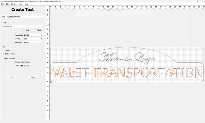

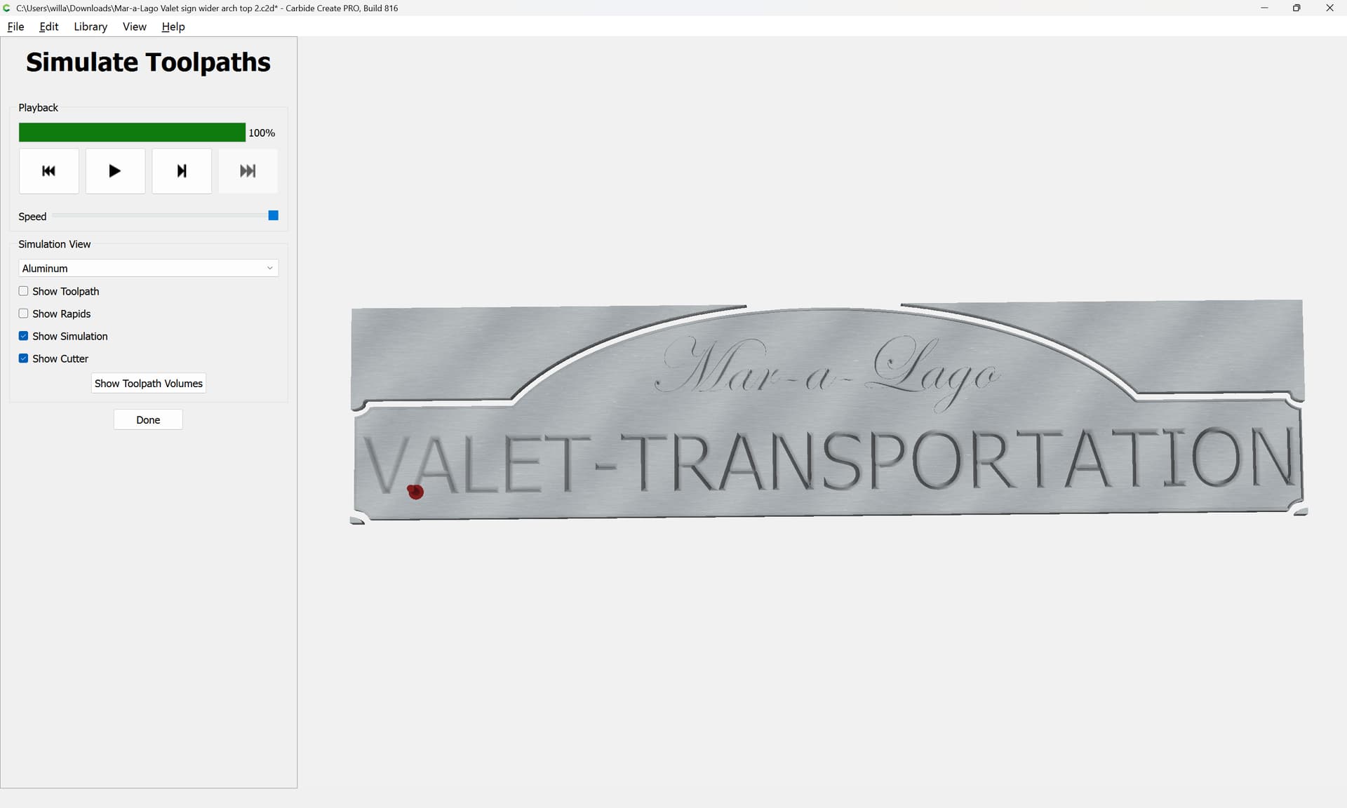

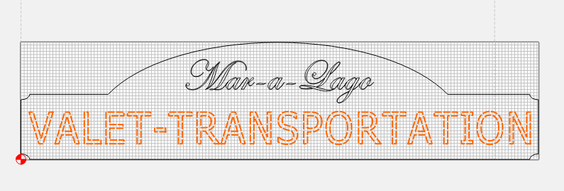

I am doing another sign, using the same toolpaths and bits as a very similar sign.

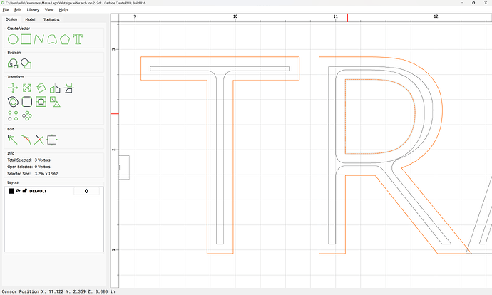

When I run the simulation, the letters are not fully cut out, it skips parts of the letters that don’t make sense (to me).
I did change the font size (smaller) than the previous sign and I am afraid that might be the issue. But I need the full letters to cut out… obviously.
Please help… And Thank you.
Mar-a-Lago Valet sign wider arch top 2.c2d (400 KB)

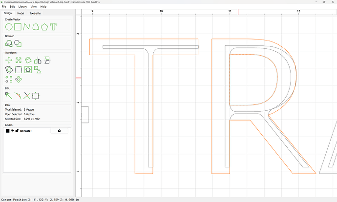

You will need to use a tool small enough to fit in the narrowest area of the recess w/ a bit of room to spare.
If you’re using V carving for part of it, why not use that for everything?
Alternately, for a work-around see:

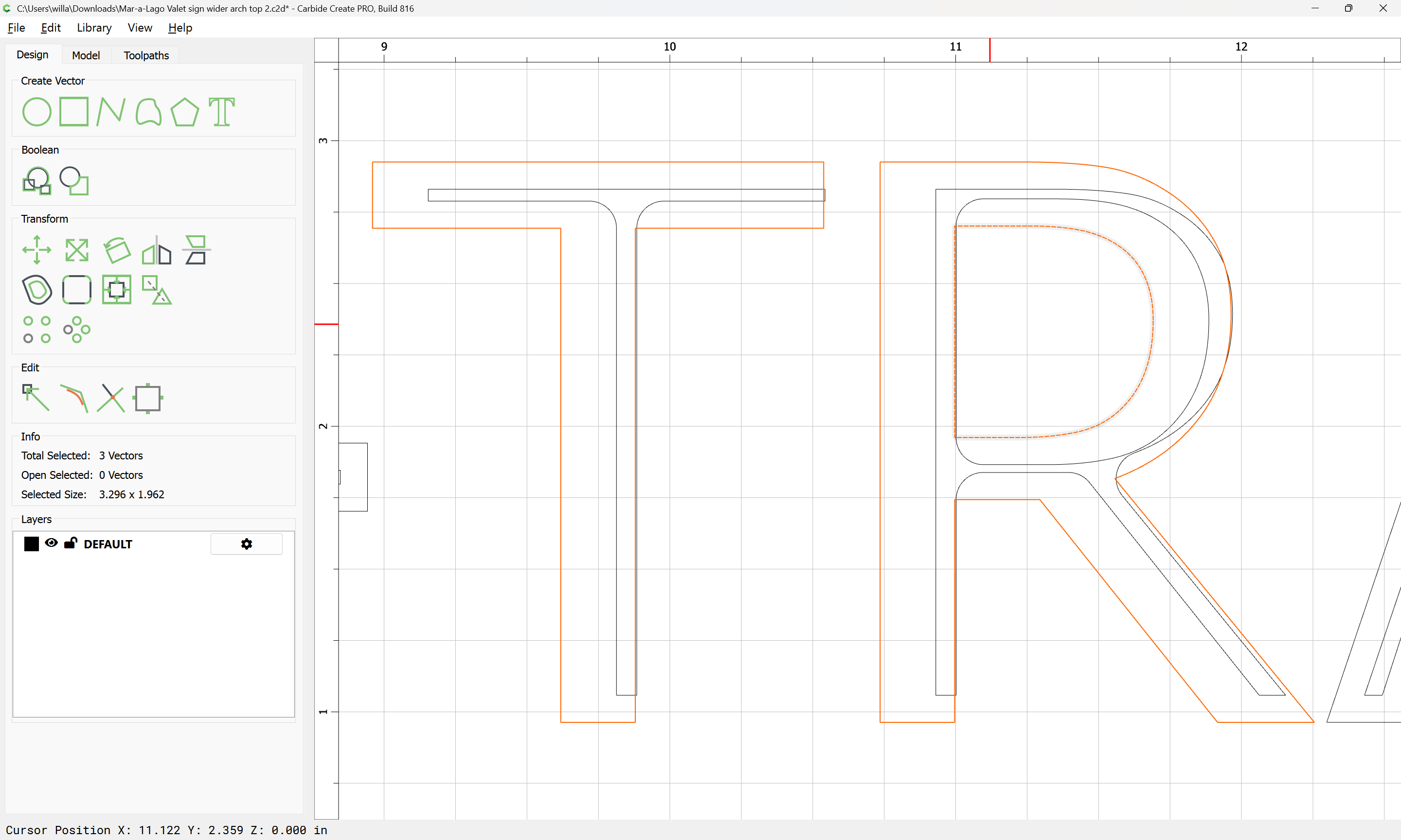

Then apply a No Offset Contour:
Note for the outside/perimeter, where possible avoid slotting and add geometry and cut as a pocket
and/or

Would you personally use the V carving, or the single-line? I tried setting it up with V carving, but couldn’t get it to look right. Also, is there a way to put a tiny bit of space between the R and A so that they don’t overlap?
Thank you!
Appearance is an aesthetic consideration and a matter of taste for which each person will need to be guided by their own sense and conscience.
The “correct” way to get spacing there would be to set the type in a tool which allows discrete control over that — any decent drawing/page layout tool would allow that, then convert to curves and save as an SVG and import. Alternately, you could select a font which spaces that pair by default as you want it to appear (probably Helvetica would not touch).

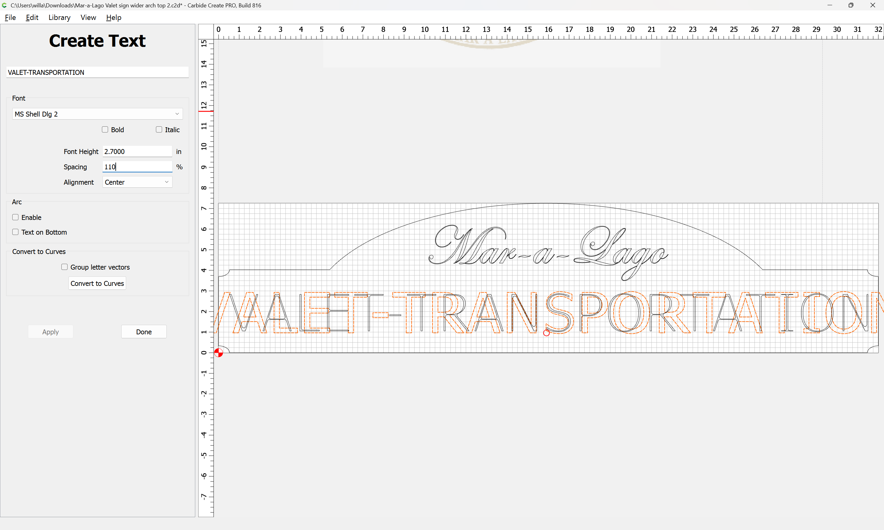

In Carbide Create the controls for this are:
Spacing:
or Convert to Curves which then allows selecting letter outlines and their counters:
and shifting them by either dragging, or nudging w/ the arrow keys (holding down shift while doing so will result in a 1/10th step movement).

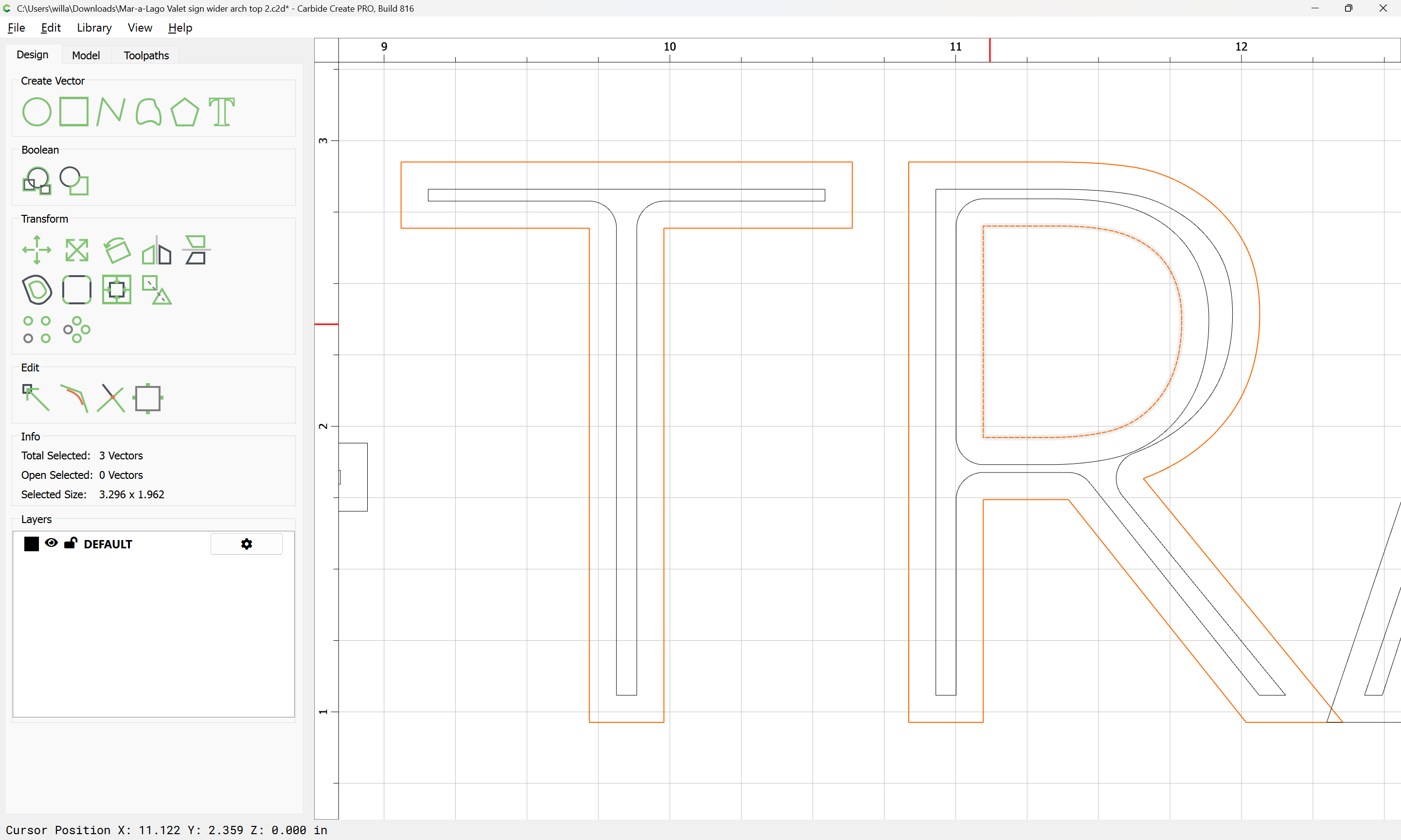

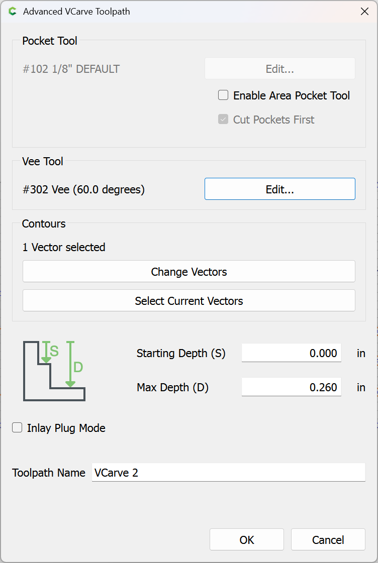

That said, a V carving toolpath w/ a #302:
seems fine:
Yeah… Definitely a cleaner look.
Good call. Thank you for the advice. I was stuck trying to match the other signs, but they had less wording, so it wasn’t as busy. With all of these words, it looks too busy in the same style.
Yeah, definitely going this route. 1 less tool change. About 4 minutes more in time (no big deal) once I changed the plunge depth to 1/2 the .260 max depth.

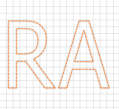

Another way to add space between the R and A is to adjust the spacing.
The select the text again and use the scale tool to move the left and right side of the text to the position that you like.
zoomed in.
