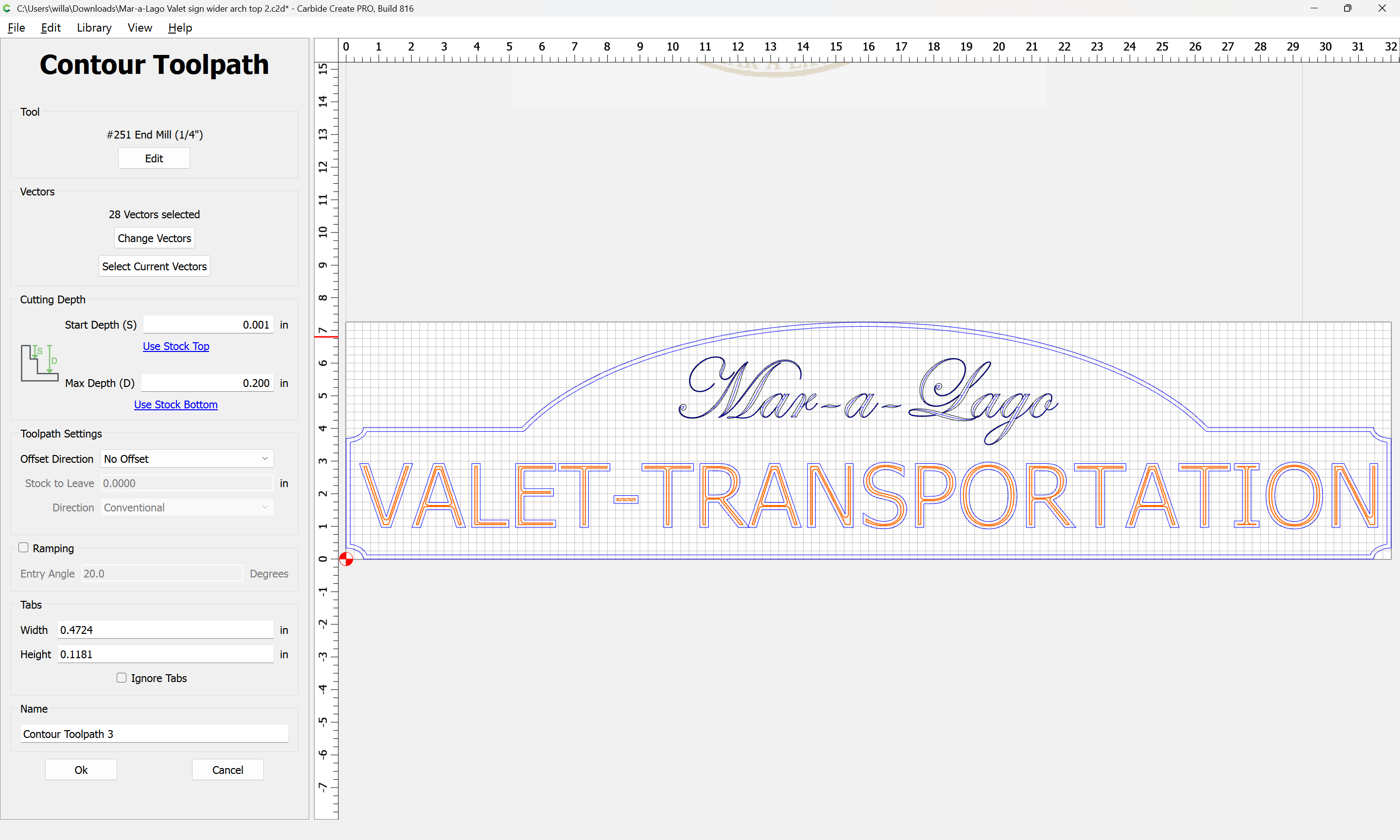

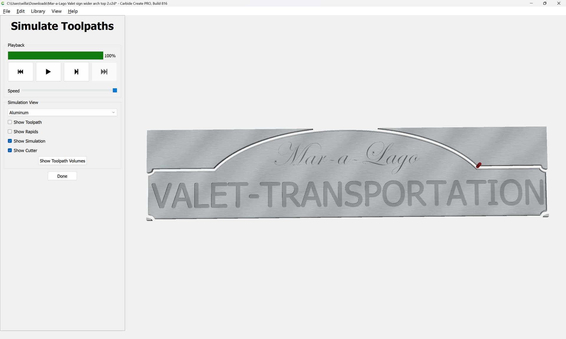

You will need to use a tool small enough to fit in the narrowest area of the recess w/ a bit of room to spare.
If you’re using V carving for part of it, why not use that for everything?

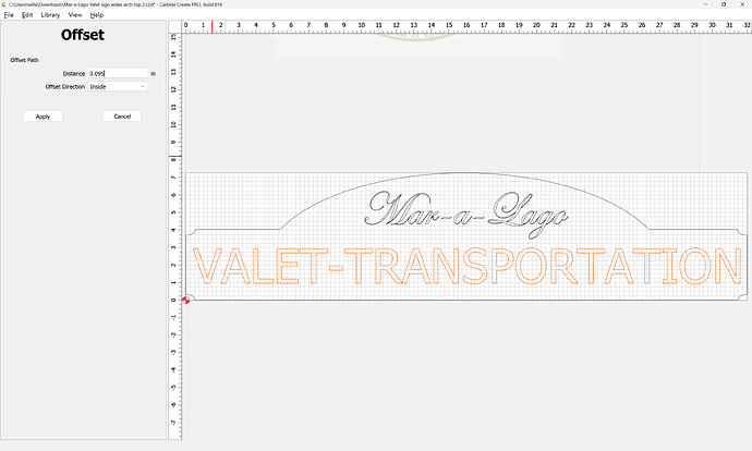

Alternately, for a work-around see:
Then apply a No Offset Contour:
Note for the outside/perimeter, where possible avoid slotting and add geometry and cut as a pocket
and/or
