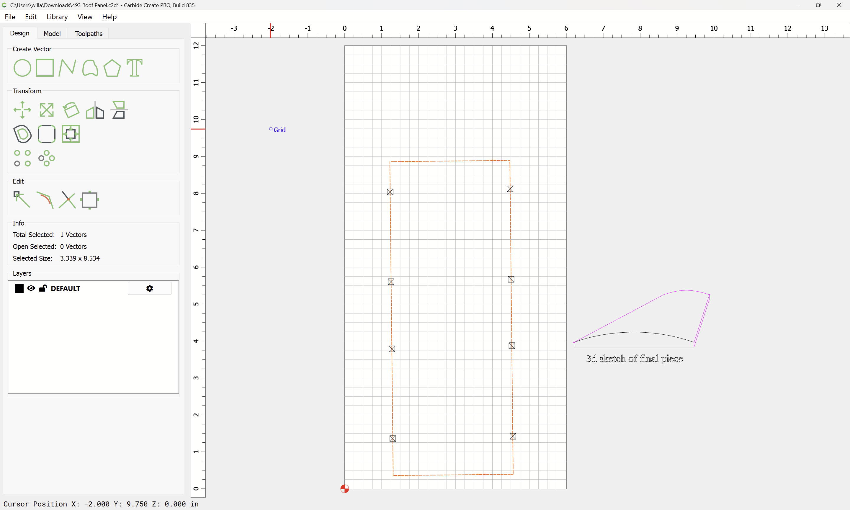

This should not be too big a challenge in CC Pro. Can you describe with dimensions, or draw up a side/section view of the curve you want?
Sorry, forgot to mention I have CC Pro.

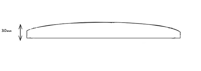

I’ll try and knock up some sort of drawing, just note that drawing things isn;t my best skill :rofl:
Doesn’t matter, as long as you accurately describe what you want.

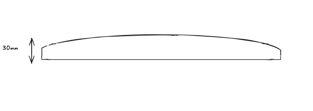

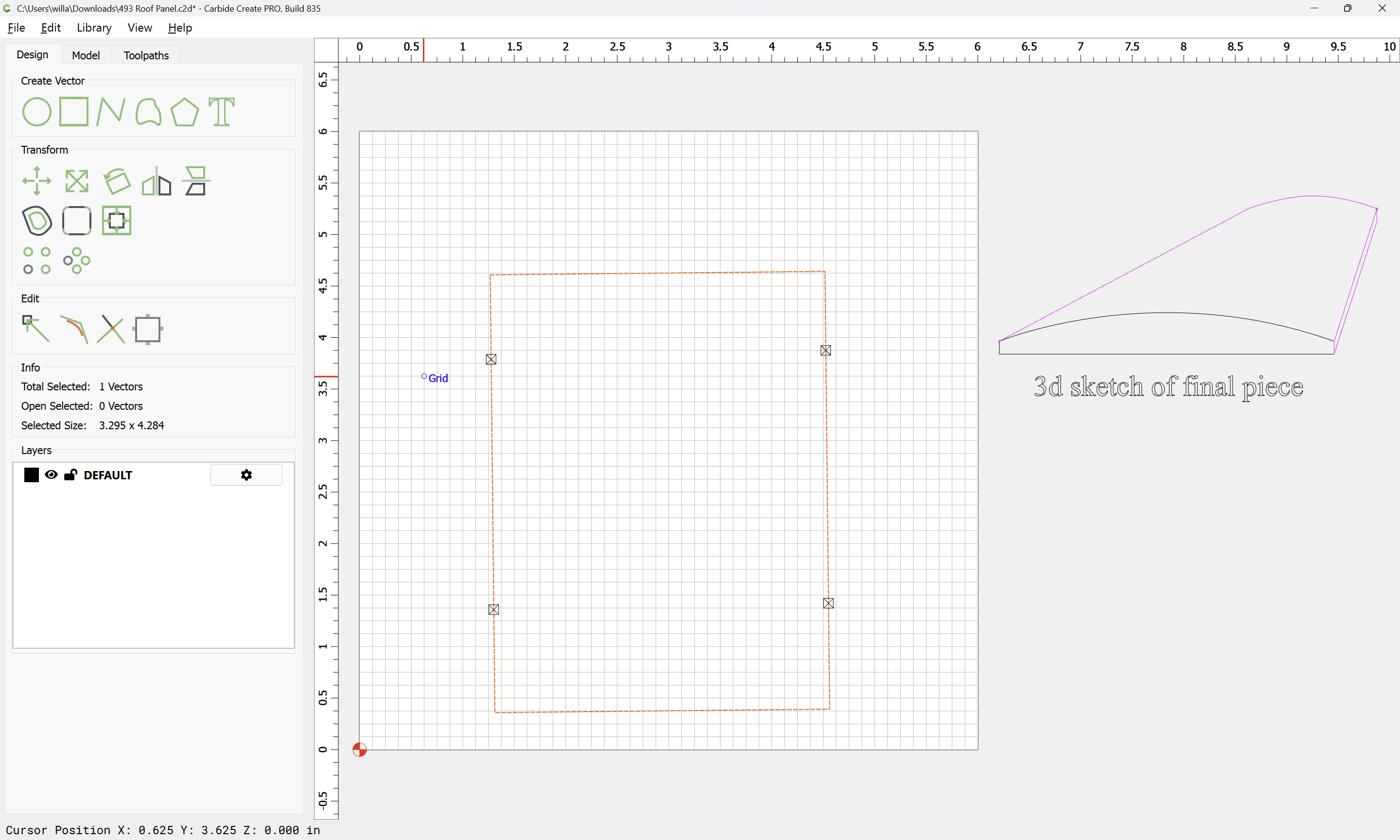

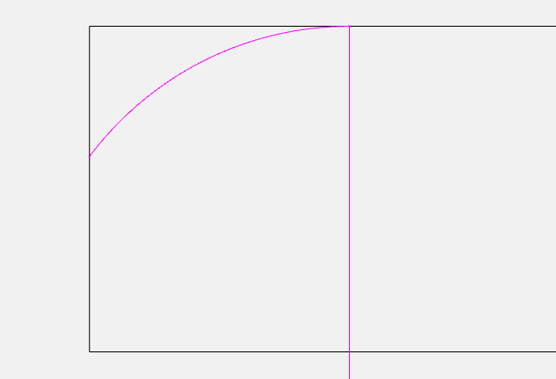

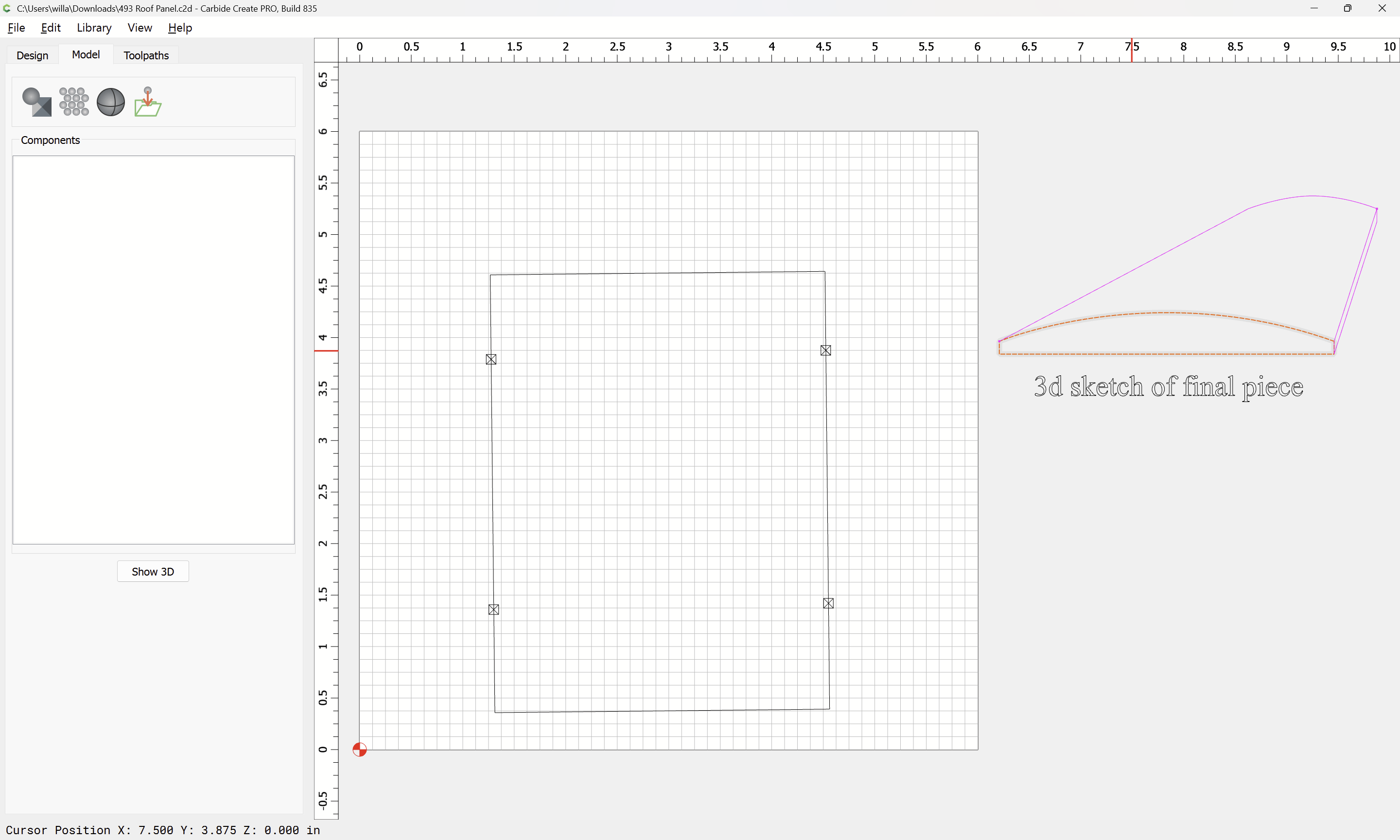

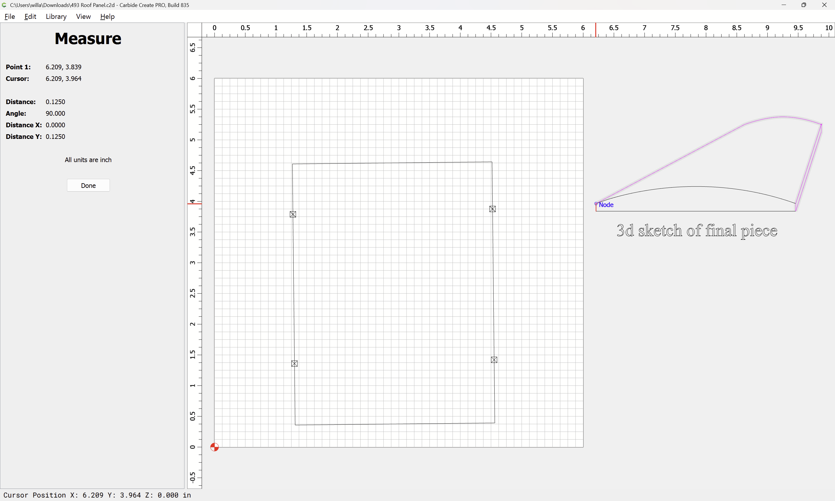

Something like this, an arc that starts tangent to the face 16mm in, and crosses the edge at 8mm deep… That will mathematically describe the shape you want. It can be constructed to those specs.
More gentle than that, but I don’t know how to describe it other than the entire surface is curved…
I’d intend to create rabbets on the flat side to joing to the drawer box - but I haven’t drawn those, I’d expect to do that bit first then shape the face, or what would be the surface.

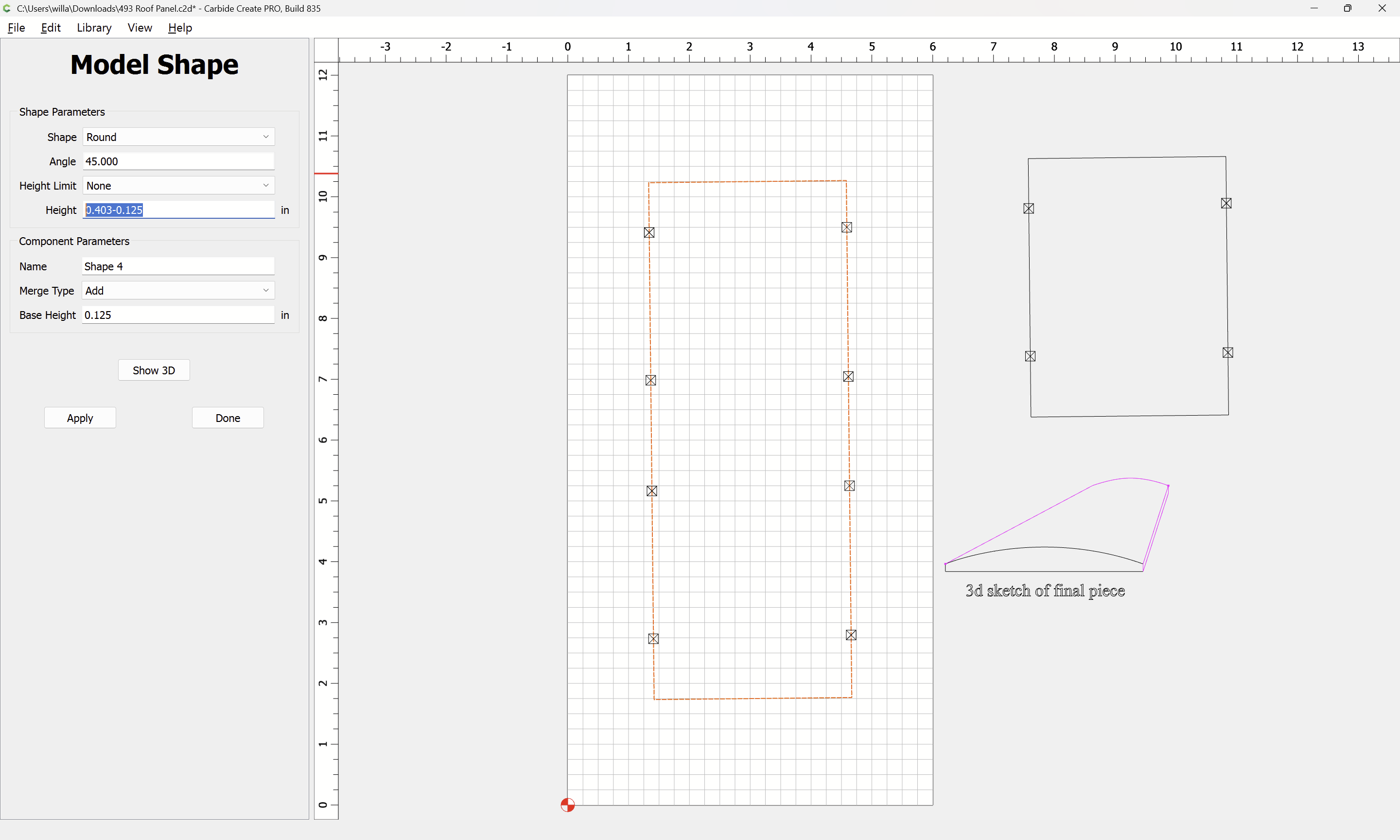

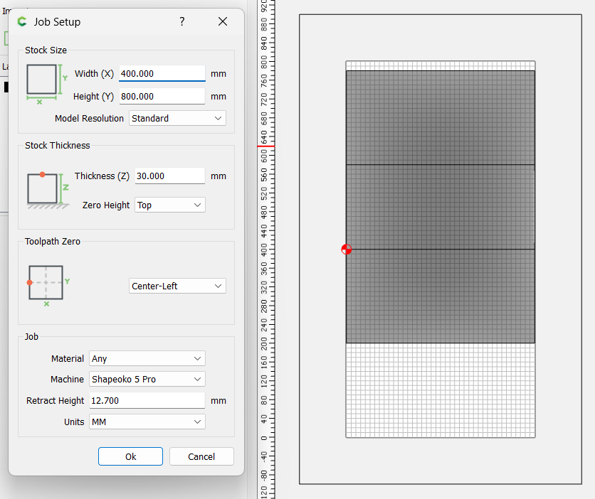

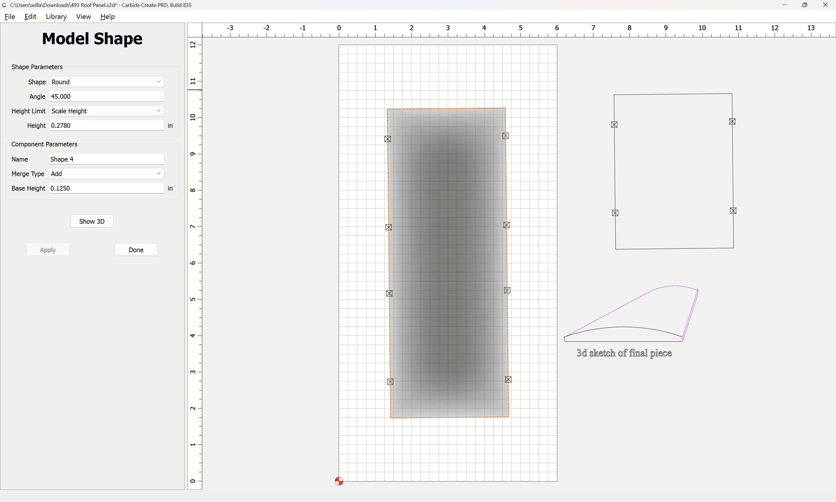

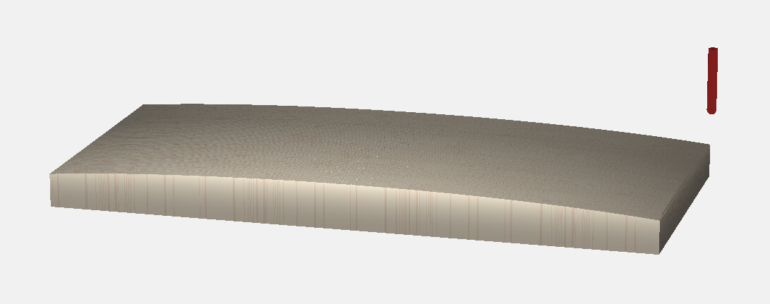

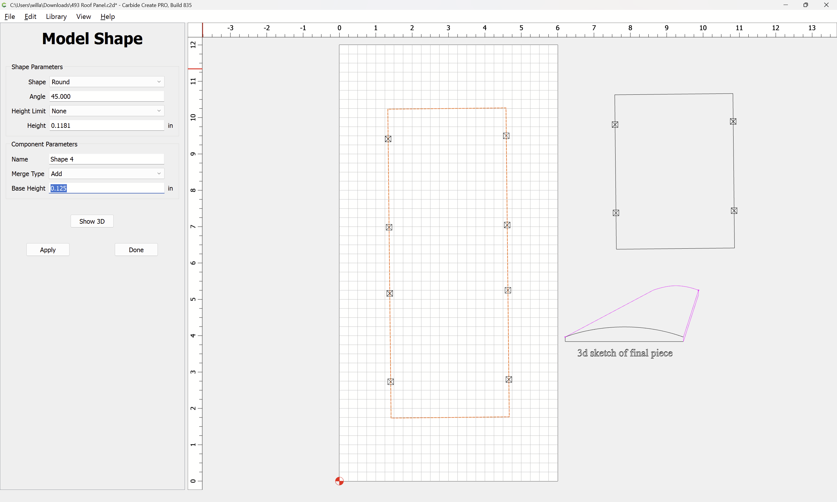

OK, so let’s make some assumptions. It’s 30mm thick stock (your example was 20)
Your curve is 30mm in the center, and you used 8mm depth on the example, so we’ll go with that at the edge.

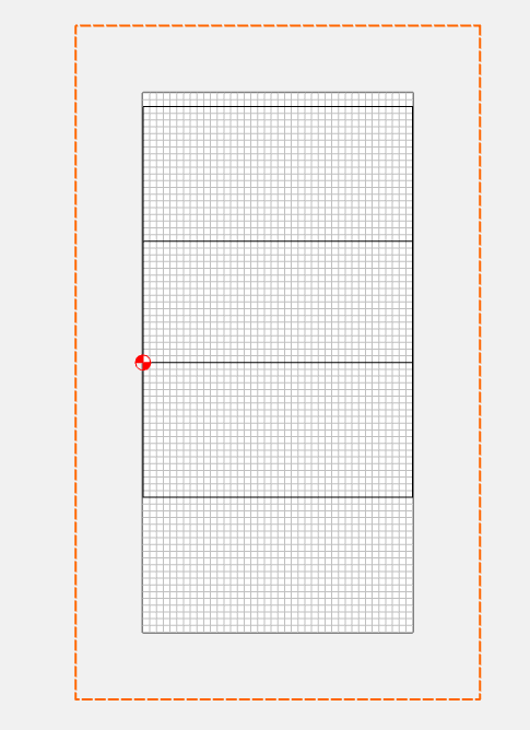

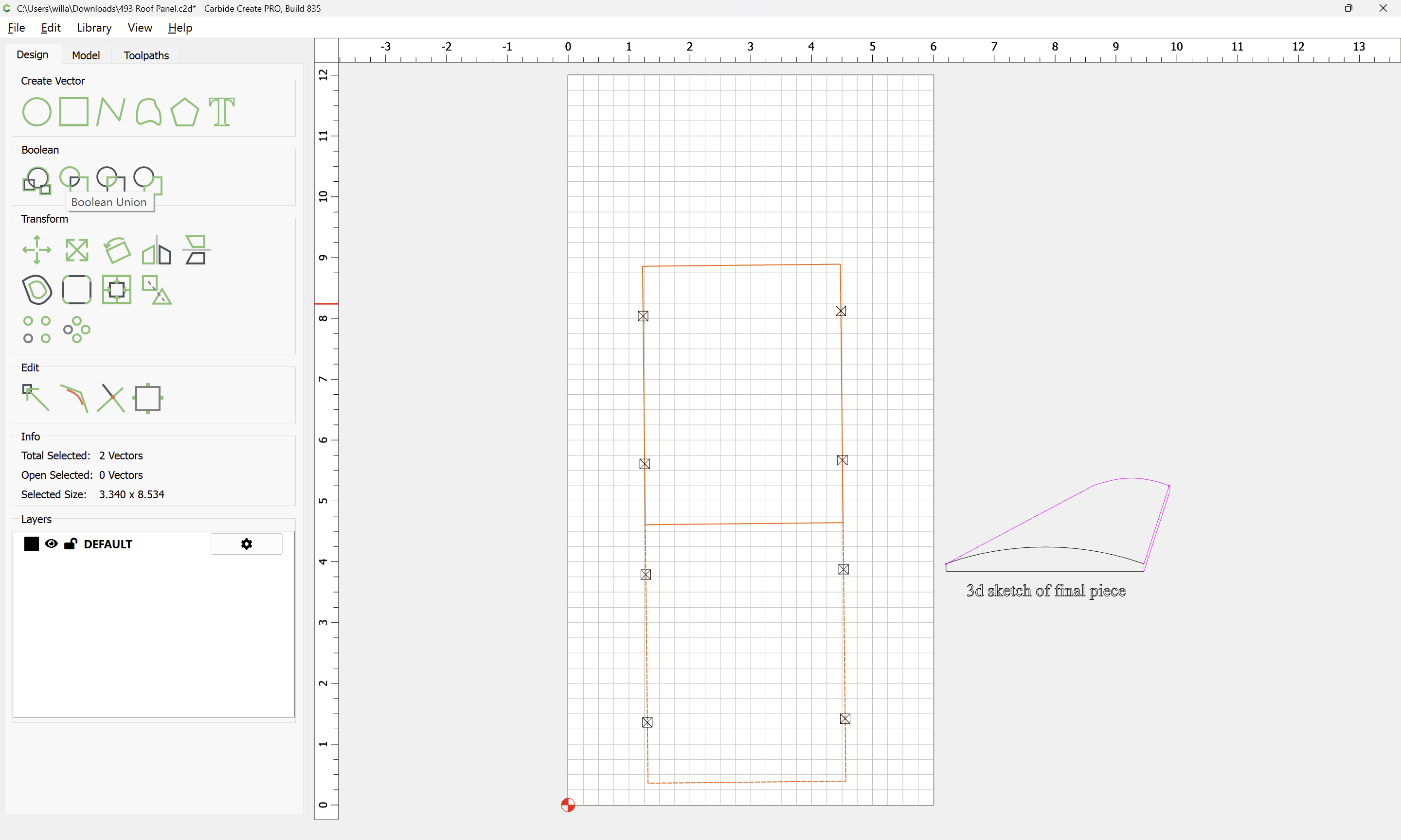

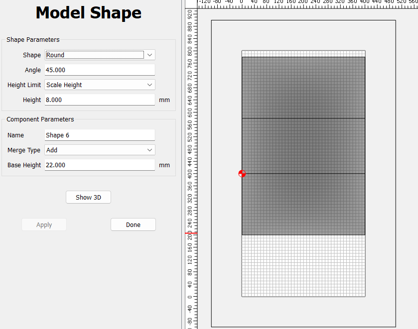

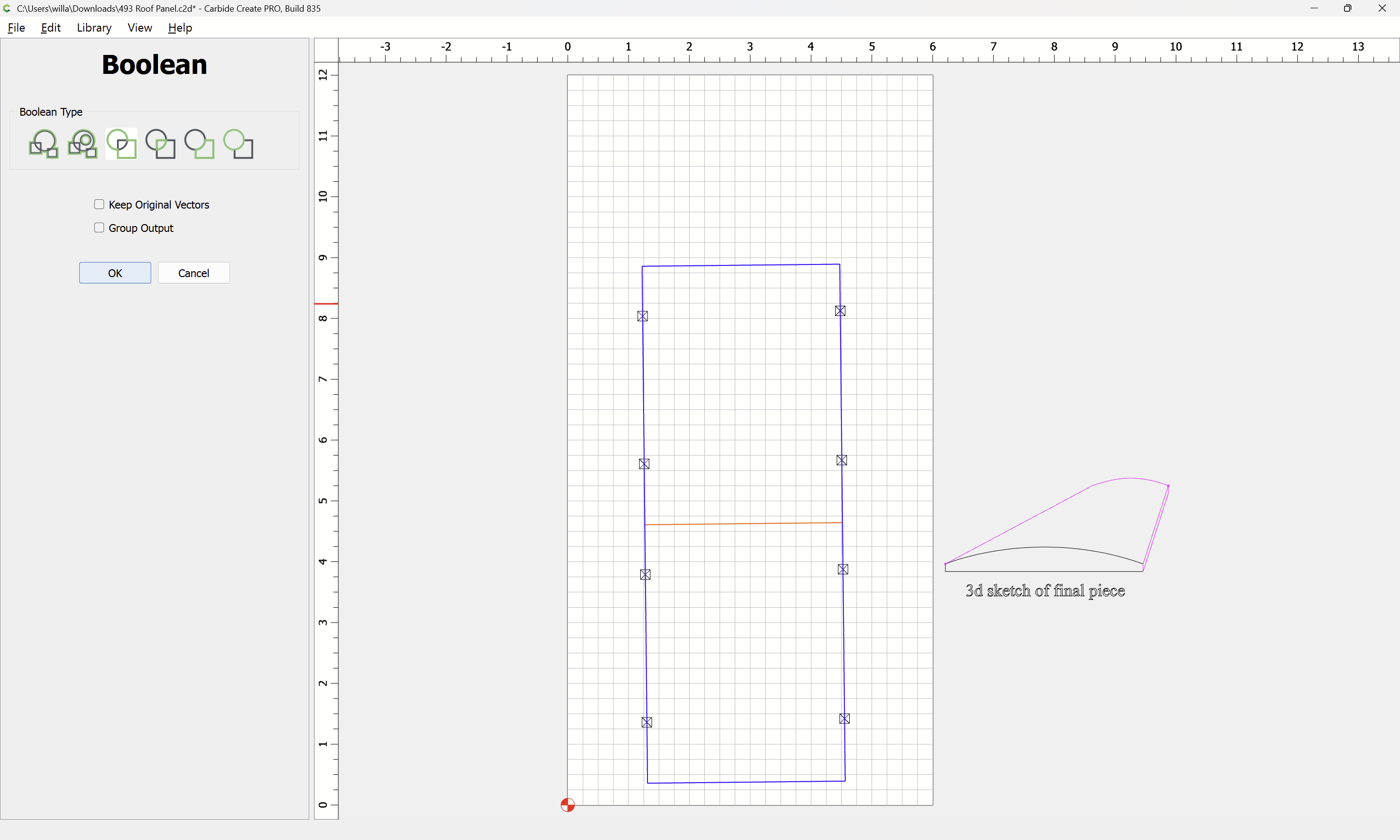

When you model you need to make the stock much larger to allow the shape to develop all around the chosen vector. Since this is 400mm wide, we need to add at least 200mm to the top & bottom to leave a face that’s only curved in one direction.
And if you want the zero point at the lower left corner of the actual stock, we’ll have to cheat. Use the Center-Left zero origin, and make the workpiece 400x800
Move your workpiece rectangle so the front left corner is at the zero point.
Make another rectangle that is 400mm taller, so 400 x 580
I’ll make another rectangle 600 x 1000 to use as a boundary to remove the excess workpiece just for display purposes. We’ll disable or delete when we post.

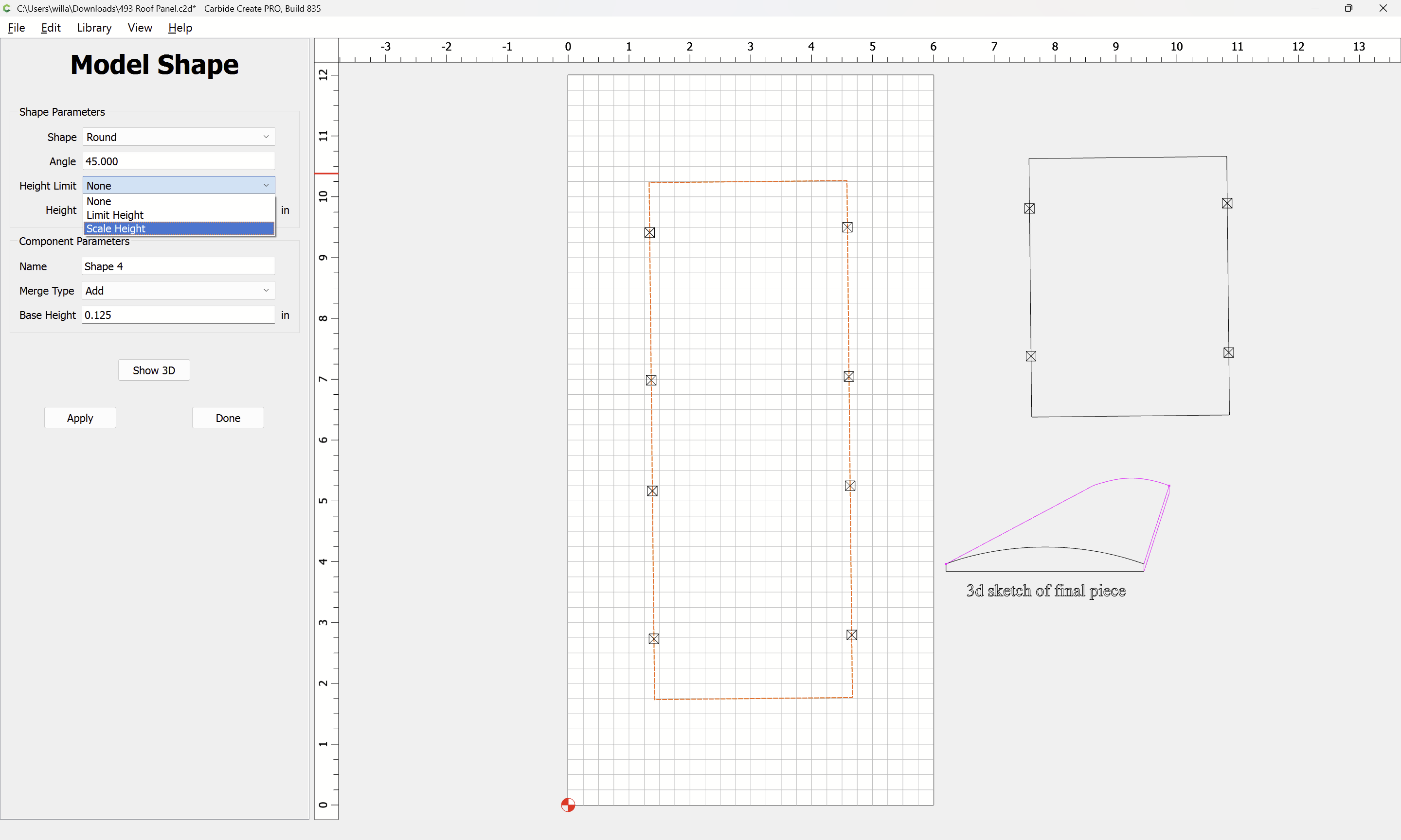

Select the 400 x 580 rectangle and make a solid component that is Round, Scale Height, Height: 8mm, with a base height of 22mm

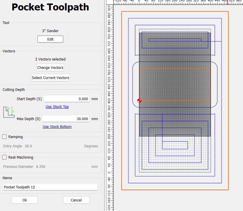

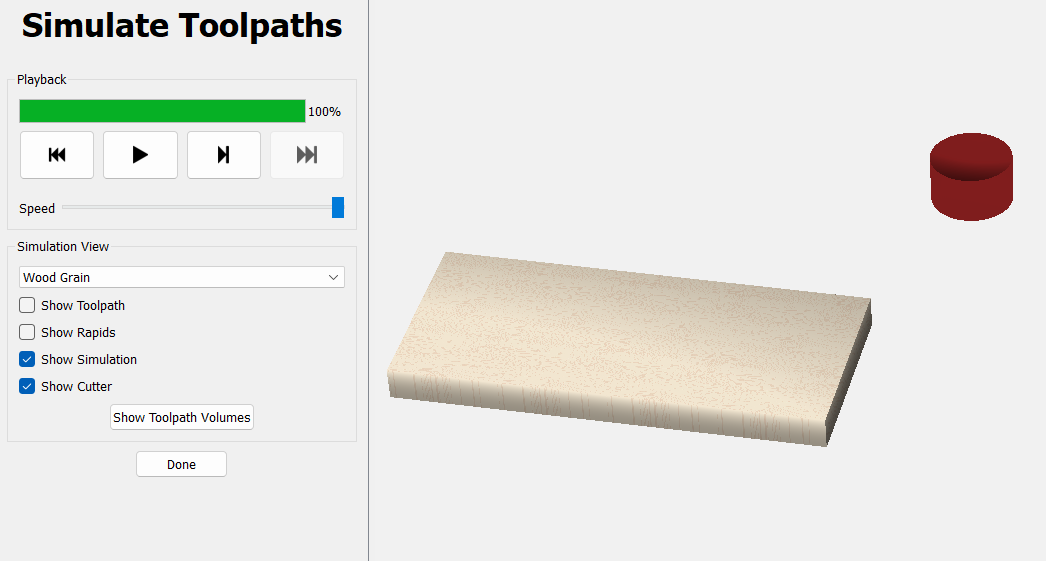

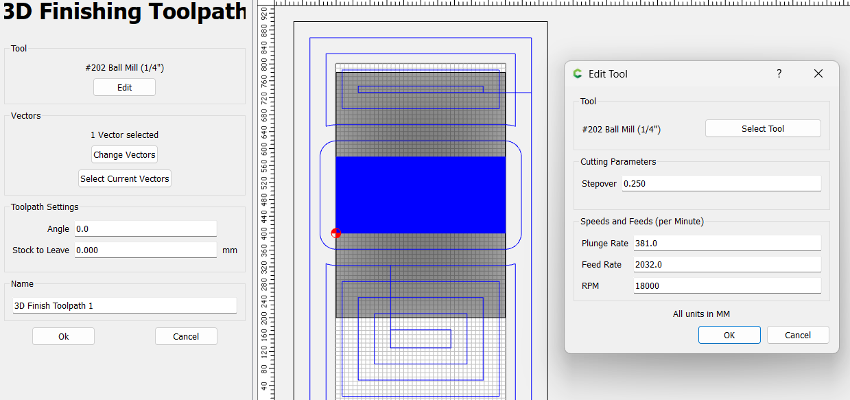

Now for the toolpaths, I have a 3" end mill that I use to program my 3" sander, but it will also work for the extra material removal. Select the outside rectangle 600x1000, and the workpiece rectangle 400x180, and do a pocket path with depth of cut 30mm, and max depth 30mm
If we simulate, it looks like our starting workpiece.

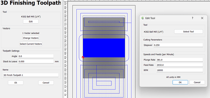

Now create a finish 3D path. I’ll use a 1/4" ball with a 0.25mm stepover. Path angle 0.0°
You could add in a roughing path if you think it’s needed.
And simulated…
curved-front.c2d (1.3 MB)
