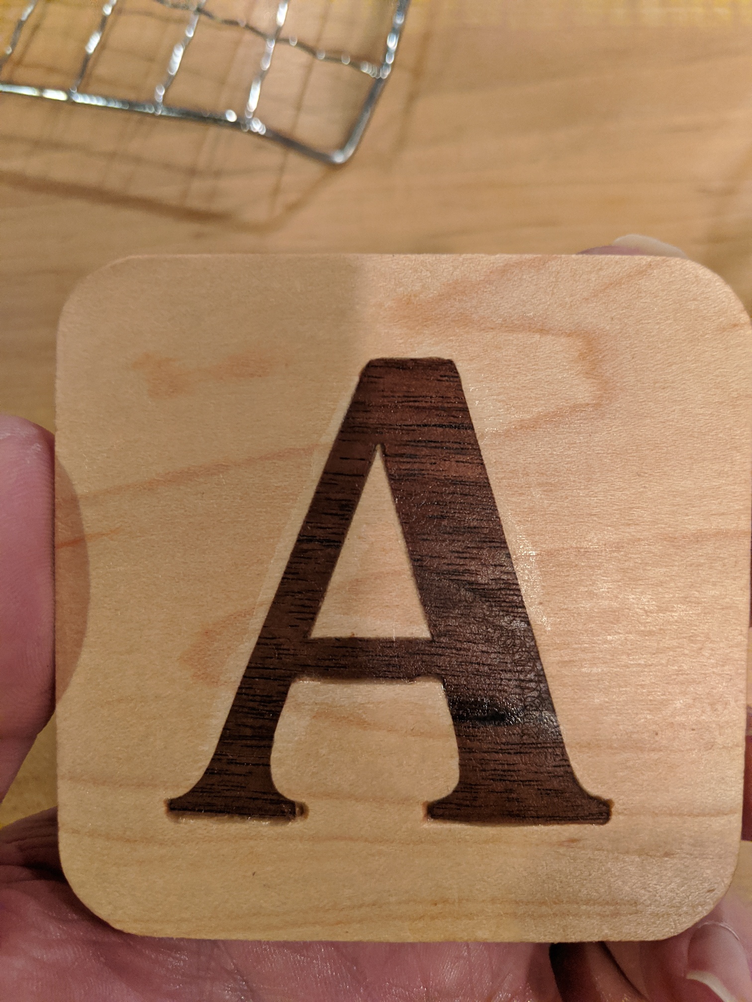

Any idea where the bug is?
I’m not sure, but it looks like you need to offset the depth of the plug. You want the vectors to match below the surface. Software like V-carve has you do this by offsetting your Z zero down by the desired depth of your inlay. The problem with that method is that you’re taking an extra few mm on your first pass.
That’s why I set on doing this in Fusion.
I’ll have to give F-engrave another look too.
I do not know where the bug is happening yet, will be poking at that next.
the depth offsetting I can do, and I can make sure the depth side of things goes ok … that’s the nice part of the tool knowing what the intent is
the result is aweful, the glue up did not work well, I could not get the walnut part to go in deep enough, so step one to fix is @neilferreri 's “need to cut different depth” comment
There are a few crucial depths to get right:
The depth of the pocket (D1) - self explanatory
The plug “start depth” (D2) - this is the offset below the surface that acts as your Z-zero for the plug. This is the depth the plug will go in, below the surface of the inlay, until the walls meet up.
The overall depth of the plug (D3) - distance below D2 you want the flat part of the plug to be.
D3-D2 gives the space above the surface of the inlay. This would be where you fit a band saw if you have one. This should always be greater than zero.
D1-D2 gives the space beneath the plug to leave somewhere for glue to go. This should always be greater than zero.
re-watched the youtube video I watched many times, and fixed the depth thing also based on your description. Had to also fix a math bug (inside angle vs outside angle kind of trig) and an algorithm bug.
It seems to fit nicer, the glue is drying so will know tomorrow after I use my spoilboard leveling bit to get the top off (ha bandsaw)
That’s how I do it too. Handsaw too messy. Table saw was a bit scary. And my bandsaw doesn’t exist yet.
that got a LOT closer, will need to check in the toolpaths what happened to the lower left “leg” of the A
output.nc (25.7 KB) plug.nc (54.3 KB)
one off-by-one fixed that made the corners not as sharp.
I’m seeing another bug but that one is a bit more of a puzzle so far
update: found the geometry bug, testing a fix now
fix worked
also implemented the V-bit depth of cut. This works different than carbide create.
In carbide create, the V bit always travels the center of the “V channel” for “not final depth” paths, while in this tool the vbit will hit the side walls of the channel on each side. This allows you to cut a deeper V carve than your bit is high, which is common for the 1/4" bits that just have a sharp point
plug.nc (85.1 KB) output.nc (33.1 KB)
