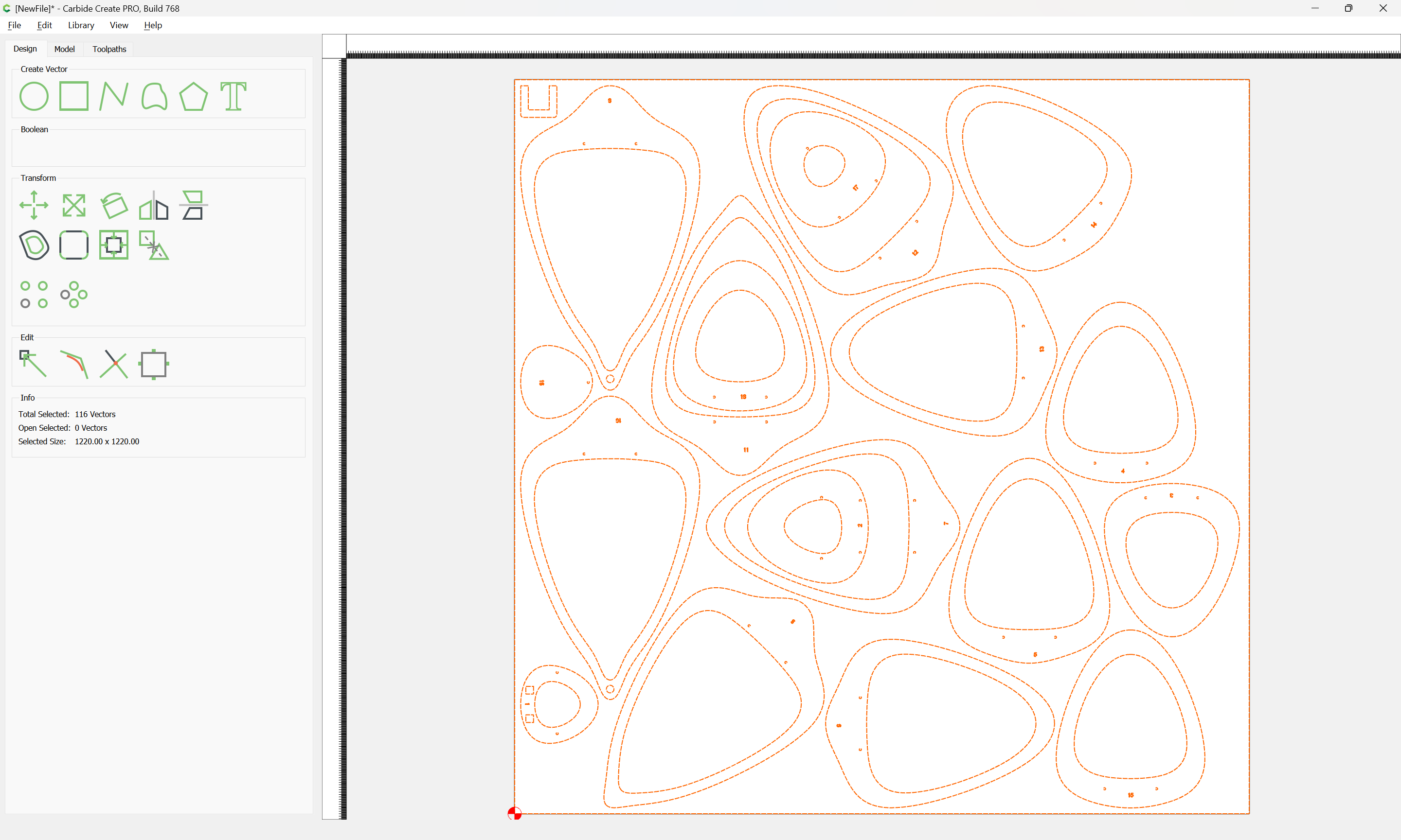

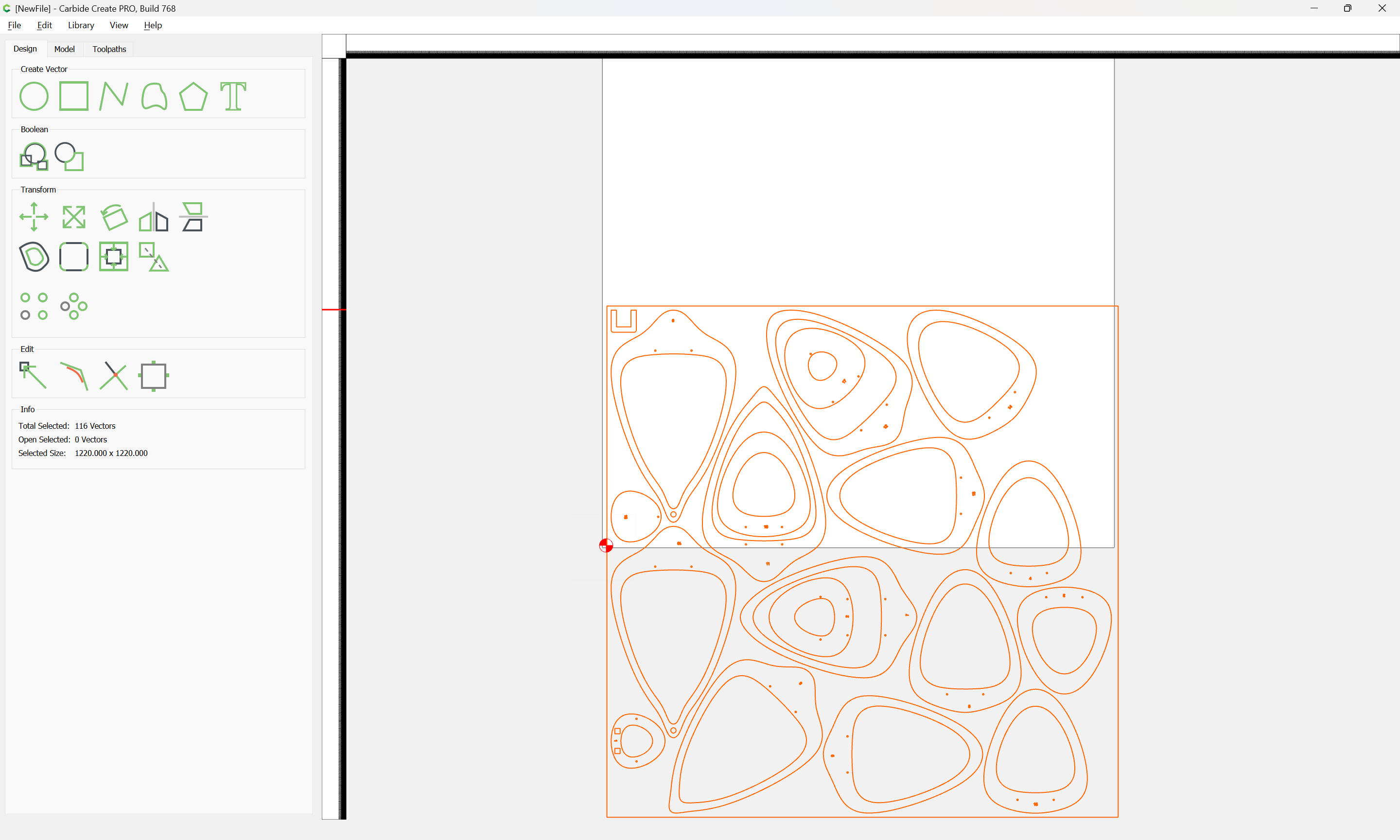

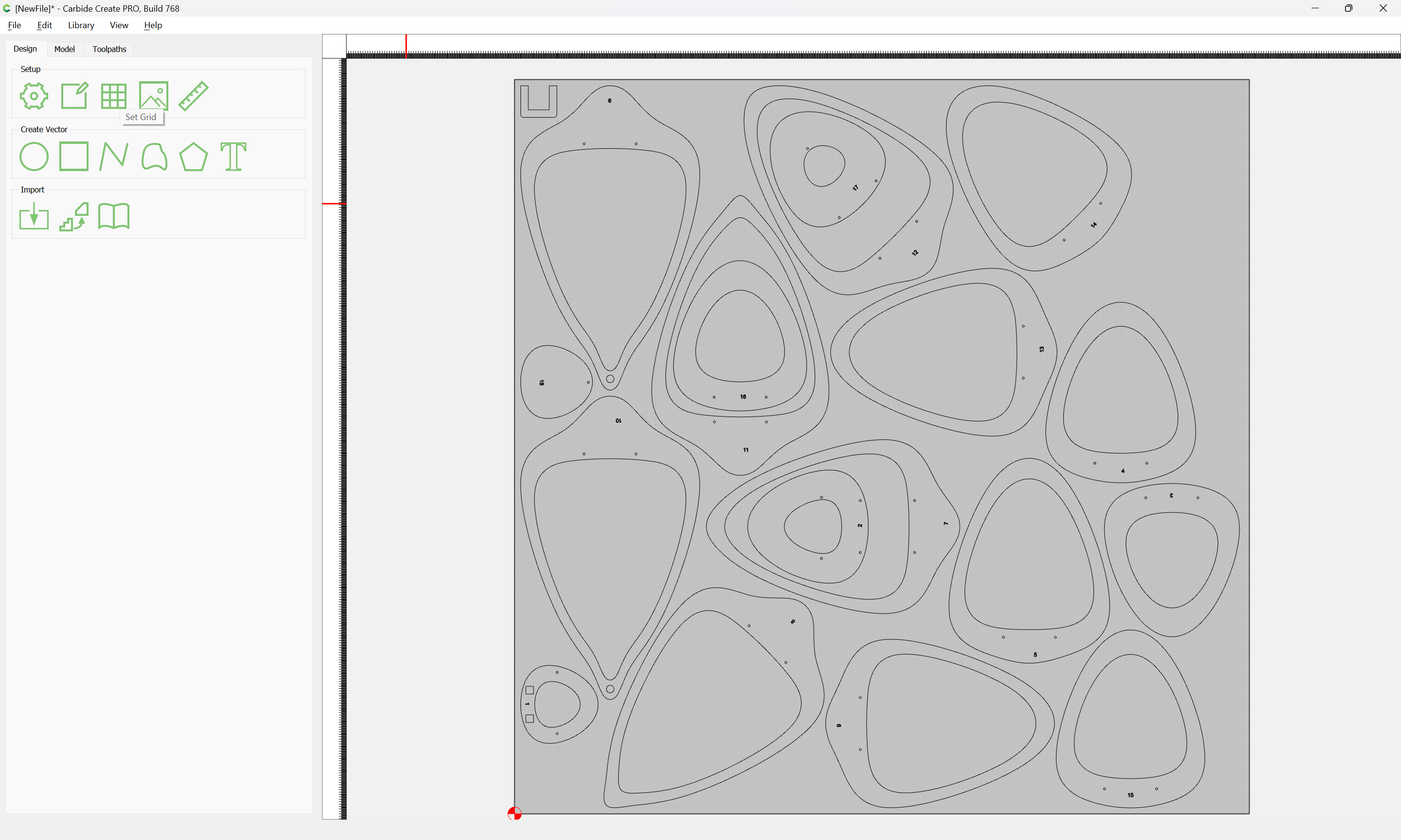

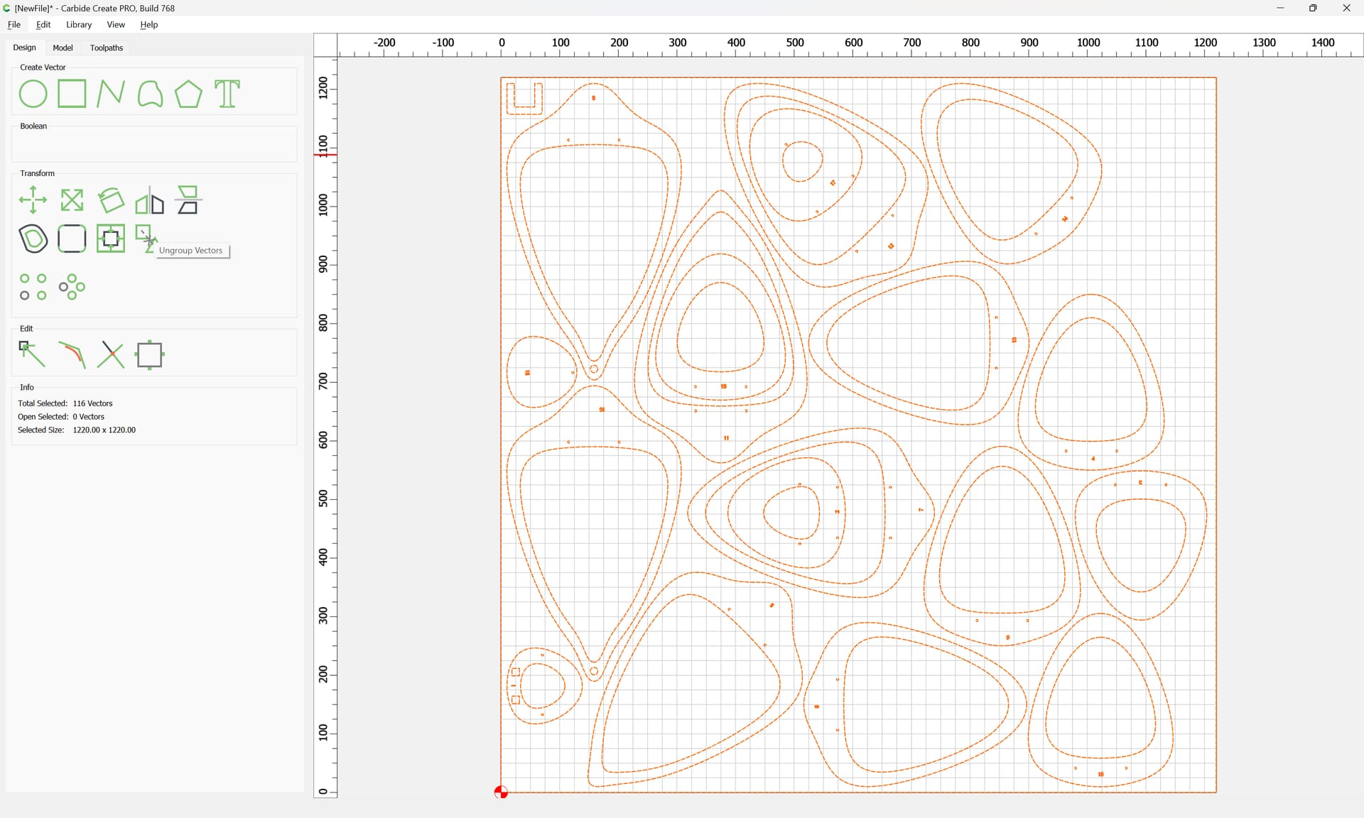

I purchased files from Etsy and the had the designed section filled in but the tool path was blank. They were all stl or dxf file that I extracted and converted to the Carbide 2 cd file. I’m not experienced enough to build the tool paths but was just curious if that’s standard for Etsy files?
