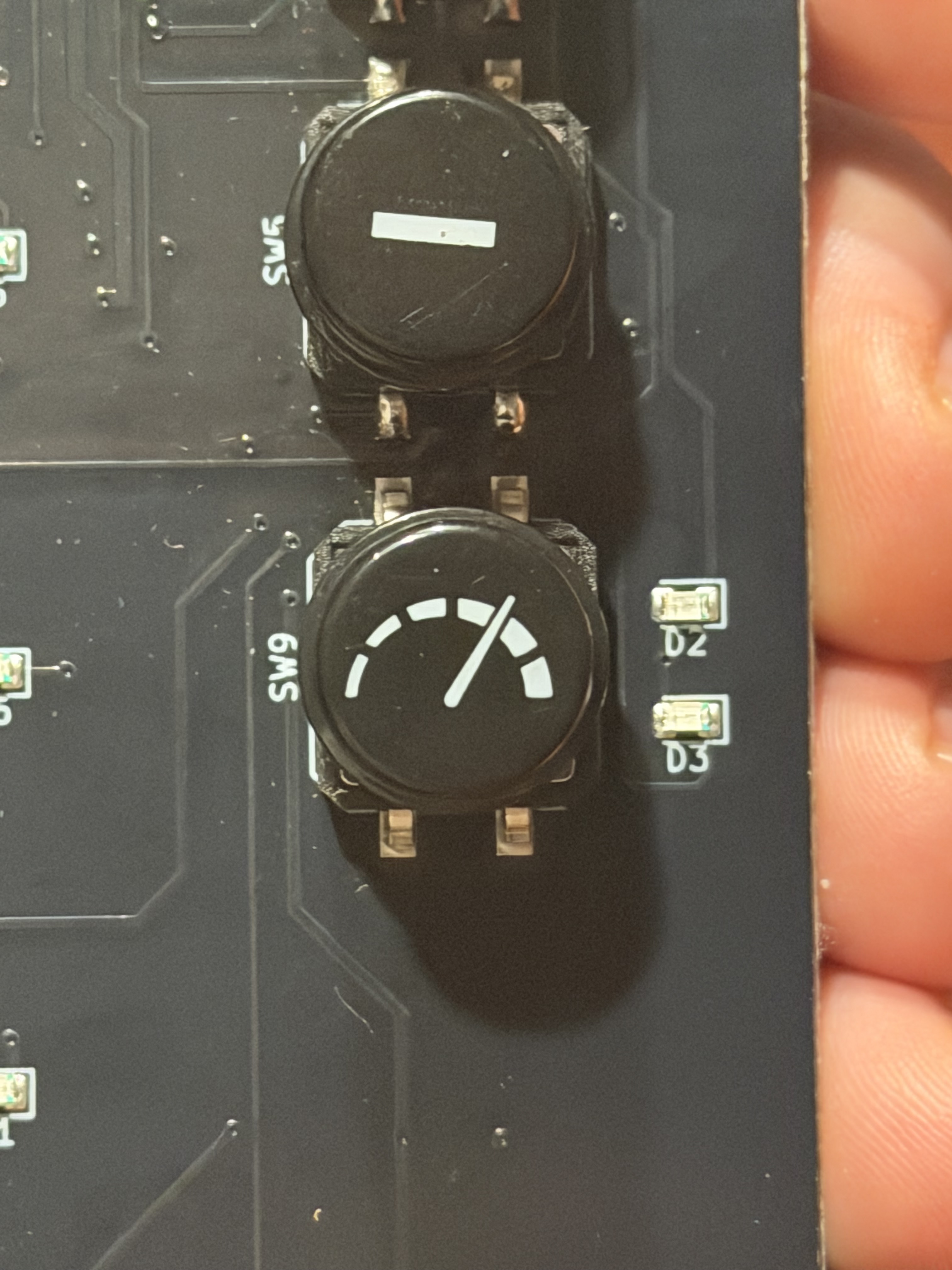

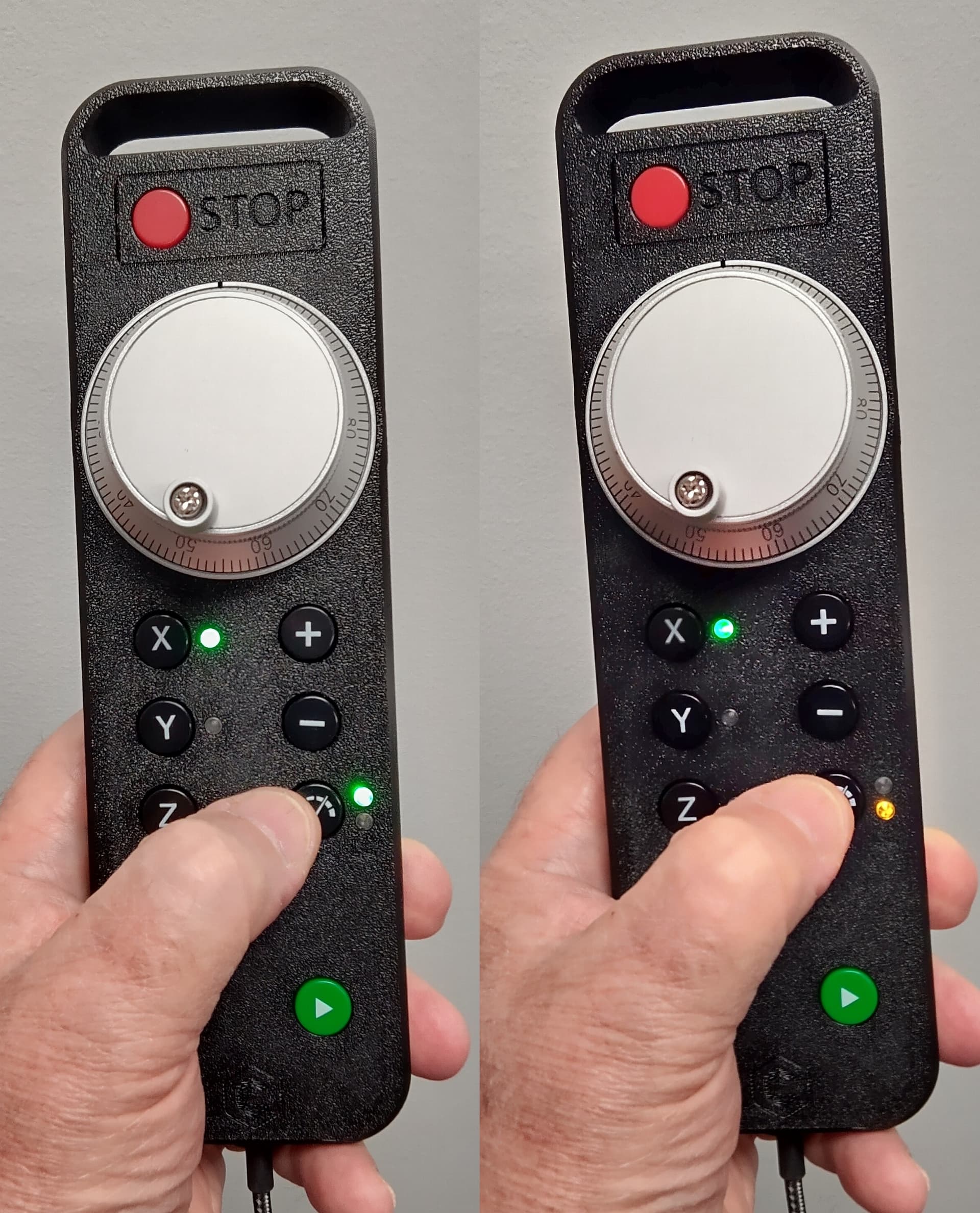

I am really tempted though to void the warranty and install an orange LED for LOW. I always end up toggling the jog speed button a couple of times to watch whether the top or bottom LED is lit; otherwise I need to bring the pendant right close to my face to verify.
You had better be comfortable with your surface mount skills, these guys look to be 0201 :slight_smile:
Maybe easier to just put a dob of acrylic paint or nail polish on the light pipe instead…or just replace the light pipe entirely with a colored piece. It’s just press fit in the case :yum:
Good cautionary message and suggestion, Tyler. It would be interesting to see what a little slice of transparent red acrylic rod would do…
In my own case, the company I work for makes instrumentation for the semiconductor industry and we have an SMT rework technician who did the LED swap (I was trained on SMT rework ages ago, but my certificate ran out a couple of decades ago…) The amber is a little less bright than the green (not delving into bias resistors, I’m thinking the HI and LOW LED’s share one…) but more than adequately visible even under our industrial lighting (will especially be in my apartment environment…) and instantly recognizable.
[EDIT] According to the electronics tech, the brightness difference is due to the original green LED being an 0805 size (.080" x .050" nominal) and the replacement amber being a slightly smaller 0603 (.060" x .030" nominal) and nothing to do with the drive circuit…
