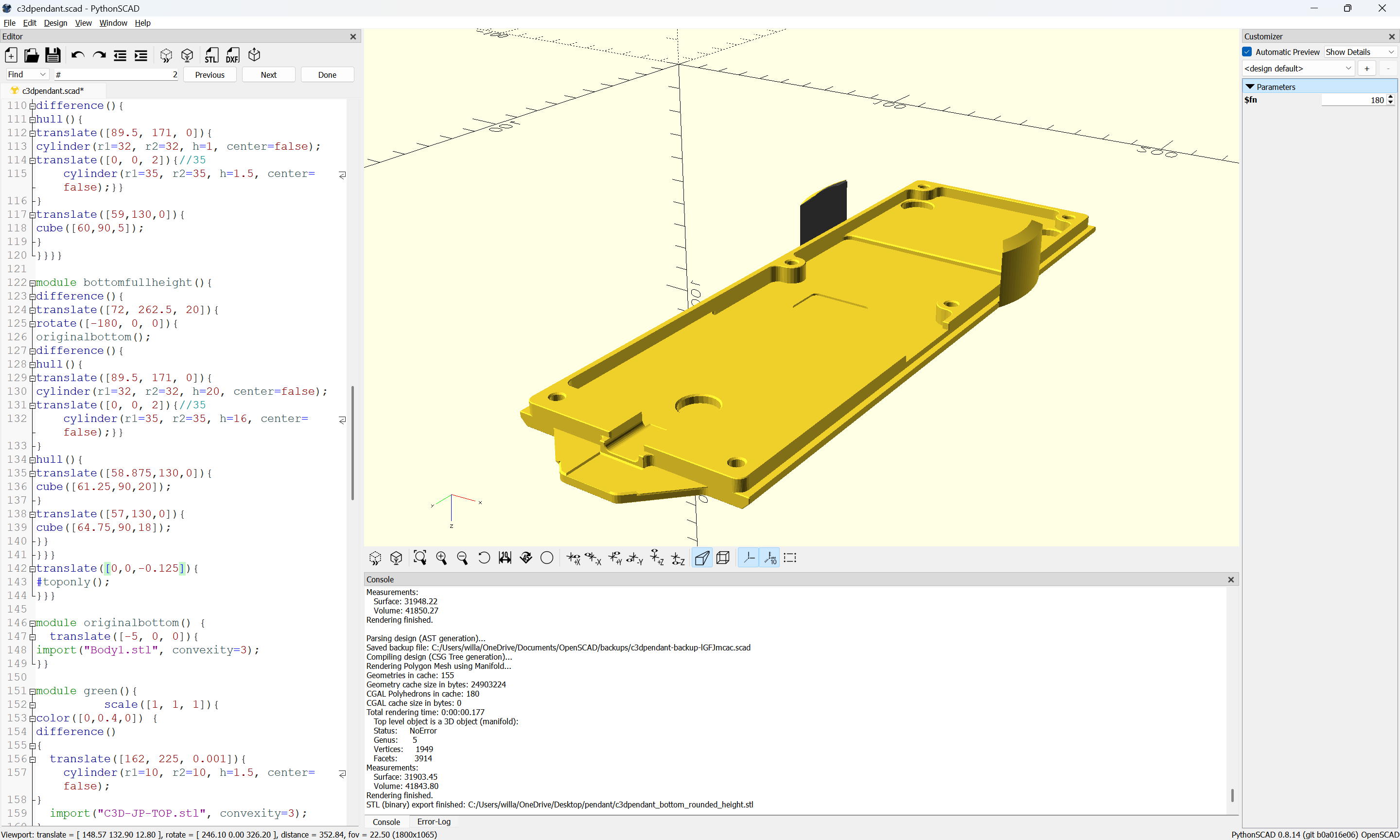

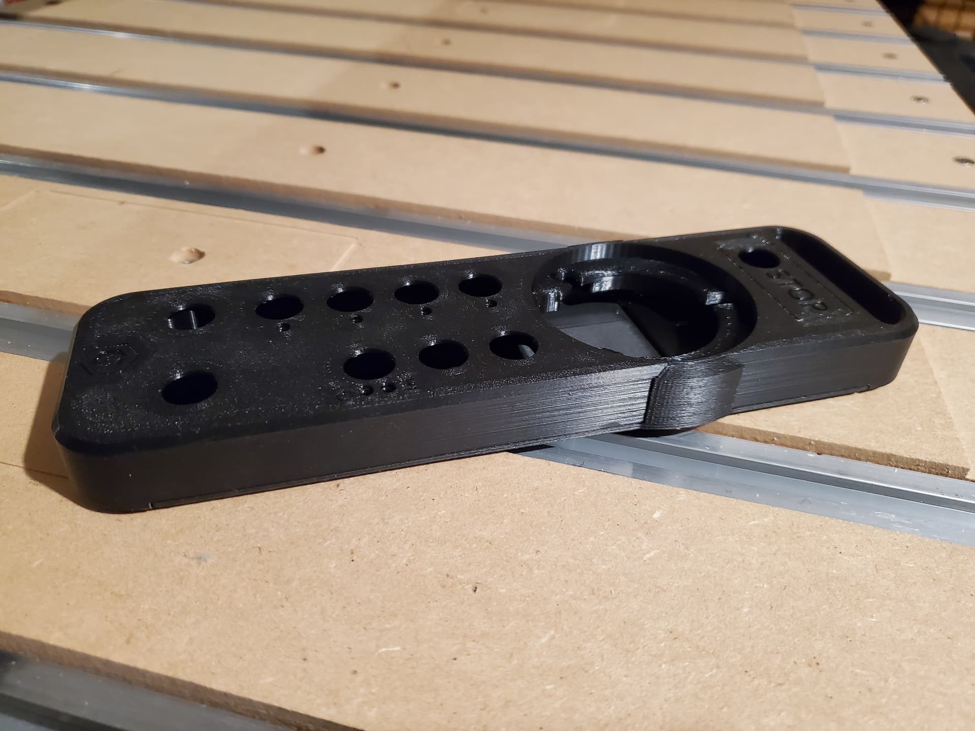

I’m going to move the Pi discussion here:
After using mine for a while, I gave some thought to just re-printing the bottom instead:
which seemed to work well:
If someone here wants the test print, let me know via PM and I’ll get it in the mail to you.

Curious how well that would print out of TPU
Good question. There’s a new TPU-GF filament which I need to look into.
I have also read of (but not tried yet) a newer filament called PEBA that is supposed to be easier to work with then TPU.
