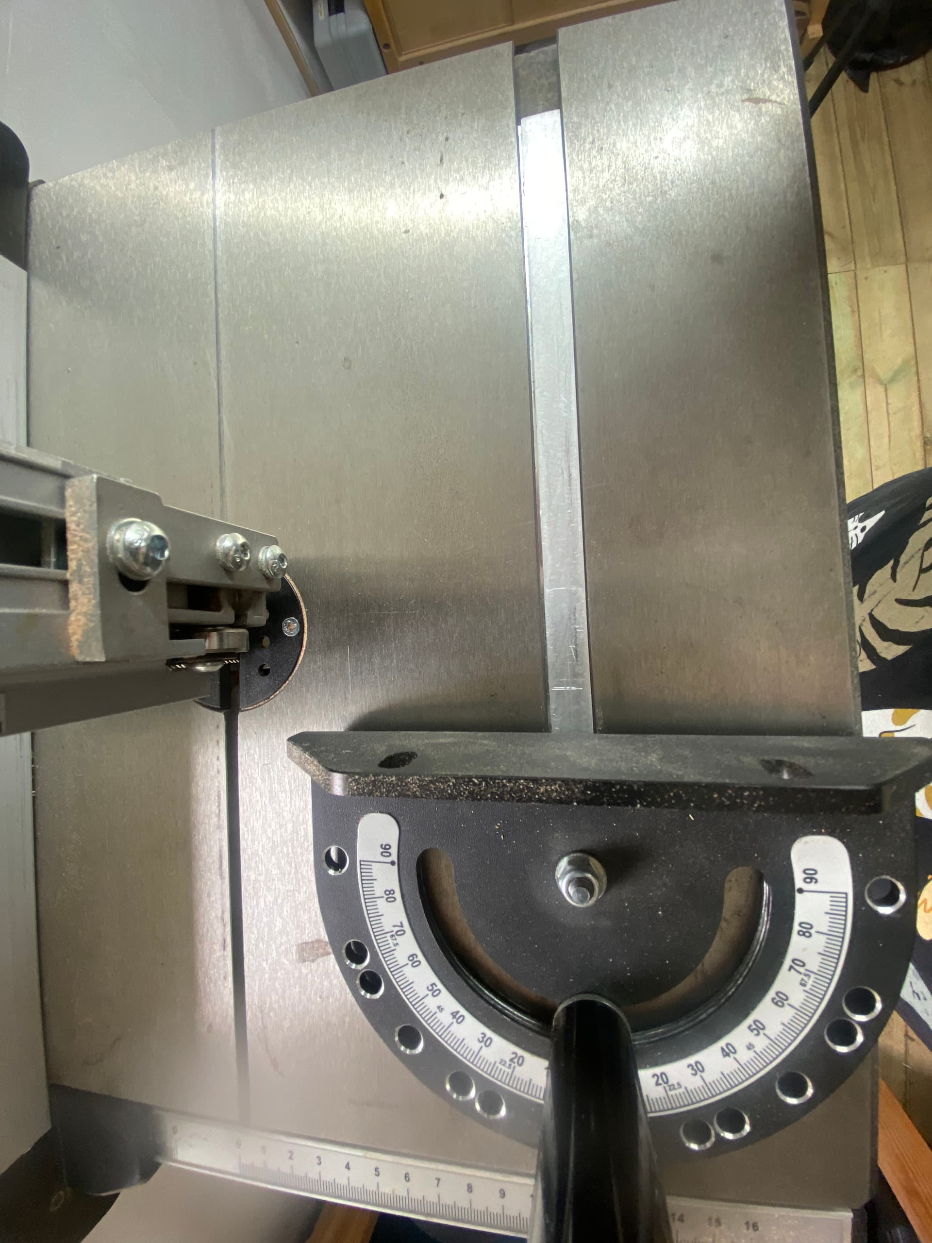

Another example of using the spindle use was I had wanted to mill some T6 6061 aluminium bar stock. I had used a BAS 261 Metabo bandsaw in my small workspace for about 4 years. The supplied mitre was very cheaply made and once it became ineffective, I contacted Metabo for a replacement mitre. They declined to supply a replacement unless I purchased a whole new machine.
I purchased a suitable mitre head and milled my own replacement bar for the ‘T’ track cast into the cast iron bed of the bandsaw. I can report that it fits well and does a fine job. pix below.
In situ:
Miter slots on different machines are different shapes. They have been making miter slots on machines for a long long time and yet there is no standardization. In the US most are .75" but a lot of machines are made in Asia which is metric but made for the US market. I have a small Craftsman bench top bandsaw that has a non standard miter slot so like you I made one.
Ain’t that the truth! I could not find any standard mitres that would fit. Overall depth of the ‘T’ slot was a strange 6.26mm. The slot width at its widest point was 19.77mm. The material width above the ‘T’ slot at the widest point was 15.32mm. I guess my cast table from Metabo was a Friday night item. This is not what I would expect from German manufacturing. With such weird dimensions, there was only the option of making my own ‘T’ rail remaining. I suspect that my ersatz Metabo item was made in China, whereafter it was drop-shipped from Shenzhen, just to make it look like it had originated in Germany.
