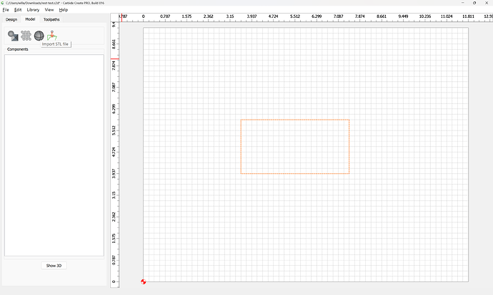

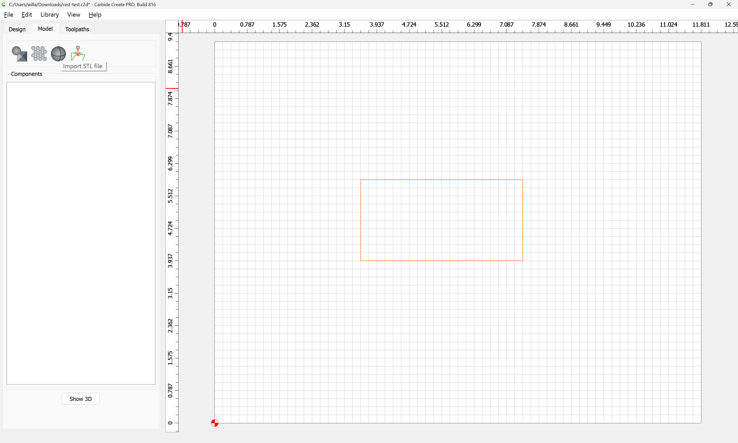

It is done by importing:
(sphere icon)
See:
So I am trying to follow the steps to import an .stl file. I have them saved to my local directory (Mac OS). If that makes a difference? I go into CC Pro, create a job of an appropriate size, I think. I go to the CC model link, click on the ball, my directory comes up, I select the .stl file, click on open, and then nothing happens, no pictures show up/imports into CC, so I am doing something wrong. Tried several times and with different .stl files. Same result…nothing happens. so what am I missing???
Is the STL binary or ASCII format?
If ASCII, open in a suitable program and re-save as binary.
If it still doesn’t work, upload here or send to support@carbide3d.com and we will look into it with you.
Thanks Will, I can open the .stl file on my Mac, once open, I can rotate it to any position. So that appears ok. Just cannot get it to import into CC Pro. I will send to support.
