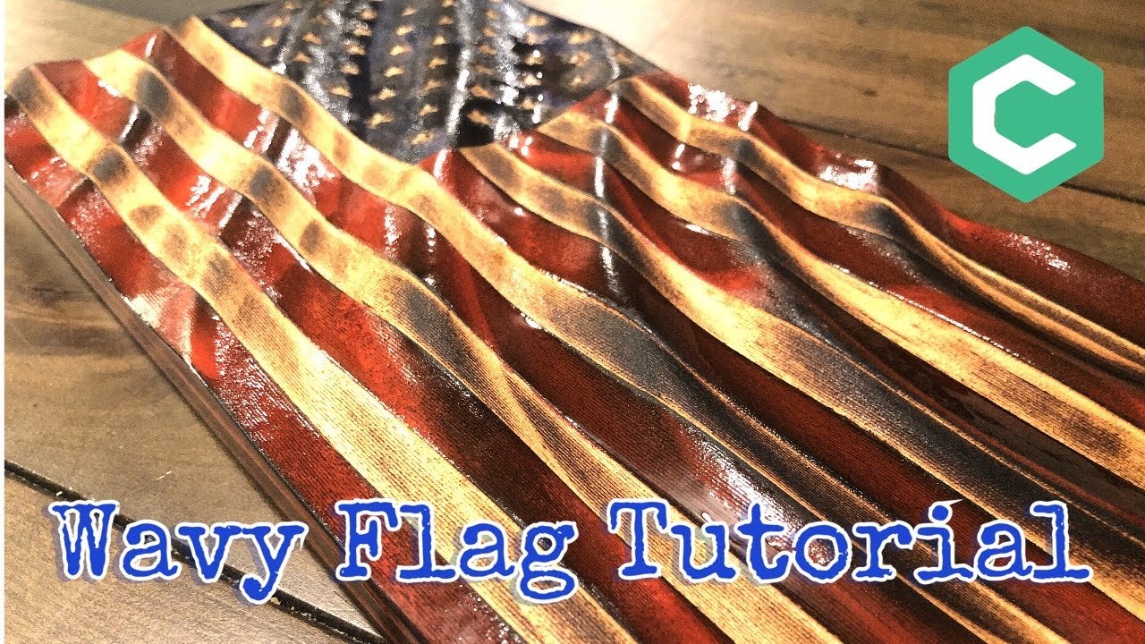

What software is easiest to use for creating shadows for things such as 3d flags? I’ve seen people use Photoshop, Gimp, etc. I’ve had my cnc for about 7 months and I’m still only cutting very basic stuff. (simple shapes and pockets). I know there are a lot of videos out there but i’m just a person who has trouble understanding stuff like this unless its being explained to me while someone is doing it in front of me. There is so much I would like to learn to do such as the 3d carving, V Carving, tiling, etc.

I’ve seen videos where photoshop is used to airbrush shadows for things like flag ripples and then brought into CC. Then a flag is layered over it and the 3d carving creates the ripples. I really wish C3D offered in person classes. Lol

If you have a pixel image depth map, then it’s quite easily imported into Carbide Create Pro.

For something like ripples, you could use any graphics program to generate a grayscale gradient where the different shades correspond to different cut depths. Some quick trial and error would get you some good ripples.
This becomes non-trivial when you want to sculpt or generate relief images of faces or detailed photos.

I have been following Chris Powell since I started. I have made some of his projects and I really learned a lot.
Here is a great tutorial for CC wavey flag project.
