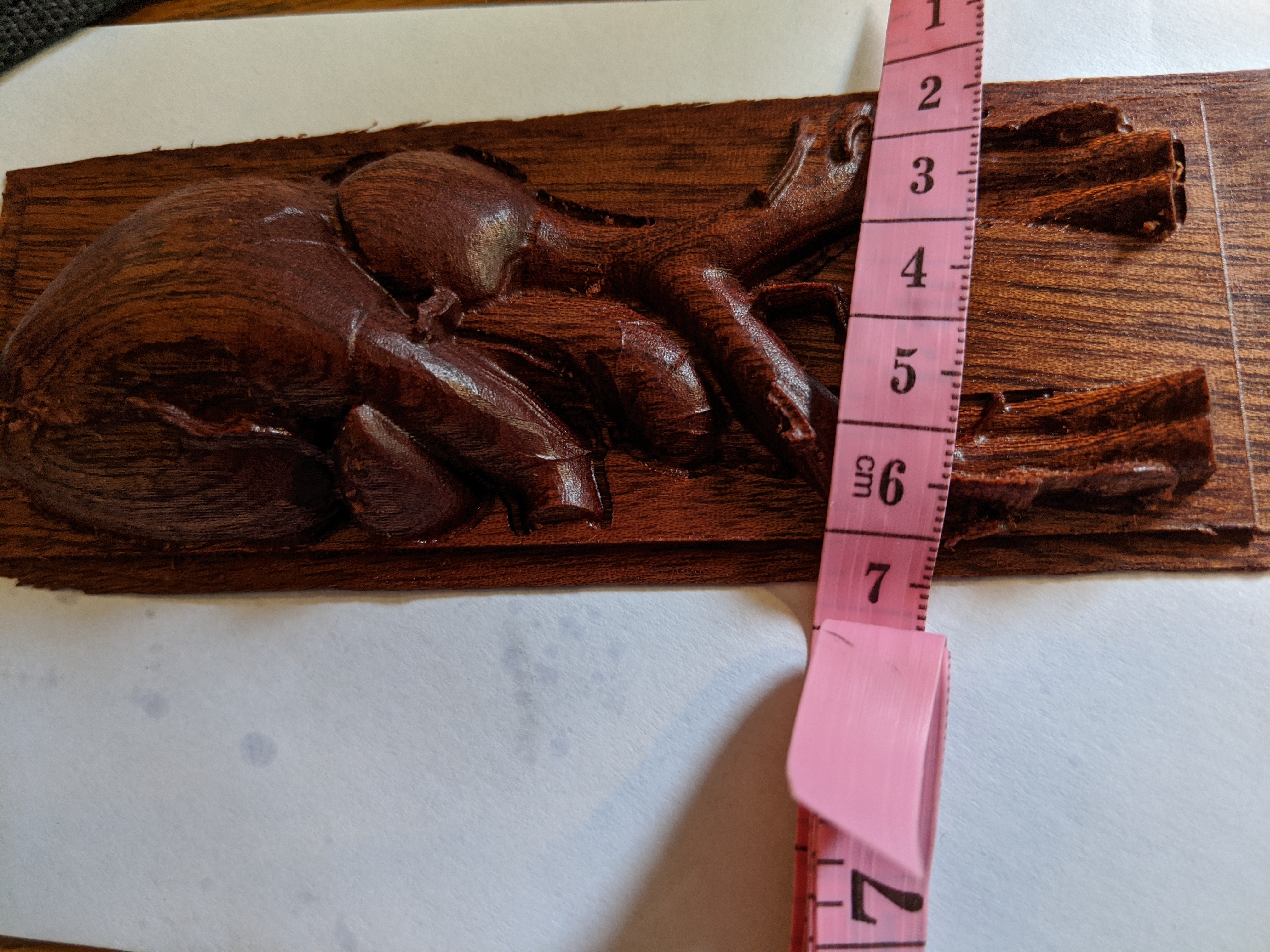

Now for the pictures; the first thing I cut with the C++ tool was a heart that I found on thingiverse (https://www.thingiverse.com/thing:3260660) so I decided to use that again.
In the current iteration, the details (vains etc) come out absolutely awesome. The only processing done was to put some oil on the wood; no sanding was needed.

It looks really nice, but I have a few questions. Did you do the entire project in one pass? Not a rough and a finish pass? What tool did you use, and how long did it take? I’m debating on whether to use the new version or try my hand at the old version for this topo map I am about to cut.
it was two passes (the gcode generates that)
I used a 1/8th inch straight but for roughing and then a 1mm tapered ballnose for finishing using 0.1mm for stepover
it took a bit over three hours to cut
What would you recommend for the 1mm Ballnose for speeds and feeds for mahogany? I don’t want to snap it first time out. But at 0.1mm step over, I kinda want to hurry it along.
50ipm seems quite fine for me, and I could even go 130% on that in CM.
The only thing I like to do is (in CM) set the very first pass to 50%, just to make sure that there is nothing unexpected (in my cut above there wasn’t… and I’ve made the tool use the roughing bit to make a “moat” around the design to create a bit of extra space… but well you never know)
