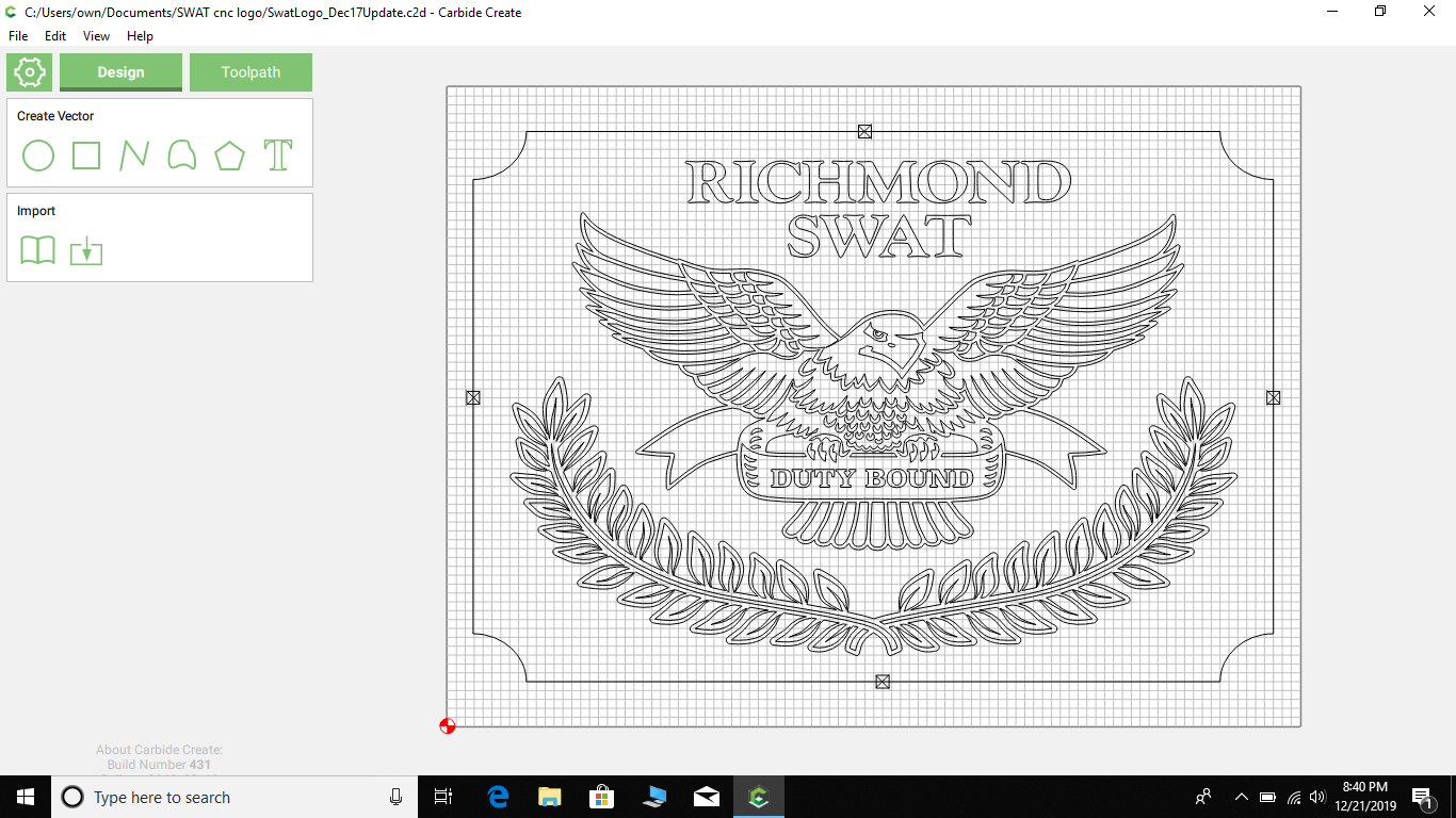

I spent all day in the shop yesterday. Ran 4 different projects on the Shapeoko. Had no issues with any of them. All files different projects. This one particular project I have attached, will not run correctly. I have set the zero multiple times (at least 6 attempts), and done it for both cut files for this project. But every time I hit run, the tool raises up about 2 inches, goes to position and starts moving but it stays about 1.5" above the wood. I have disconnected the laptop, cut power to the tool, I got up this morning and tried again, I have reviewed everything that I can think of in the file, and I can’t find anything. The only difference I know in this, is I had a graphics person redo this drawing from an original. When she sent it to me, she sent it to me as this file already in carbide create. Don’t know what that has to do with it. Anyway, thanks for the help, trying to get this project finished today for Christmas present. Thanks

ok so 2 issues Id fix urgently
  1. The file has the zero point set to the bottom of the stock. if you zero your piece at the top and not at the waste board that explains the air cutting
    (this can be changed in the “sprocket” screen where you also set the size of the wood etc)
  2. you have 1/2 inch of retract hight set… 0.1 or even 0.05 is much nicer given the limited Z height in our machines
See,i took for granted looking through my details that I had everything set like I usually do, but since she sent me this file, I completely overlooked it. I just changed it and will give it a new shot in a few. Will let you know. Thanks!!

You were exactly right! I overlooked the bottom vs top as the zero point. Once I changed that it worked perfect. I did encounter another issue once I did the cut. If you look at the image in CC, it shows all the leaves of the laurel branches there. But when it cut, on the right side, top of the laurel one of the leaves cut as just a line. I thought I had overlooked that as an image issue, but I just reviewed it and it does not show like that in CC. Suggestions? Again, you guys are great! Thank you for always helping and teaching!IMG_0027
