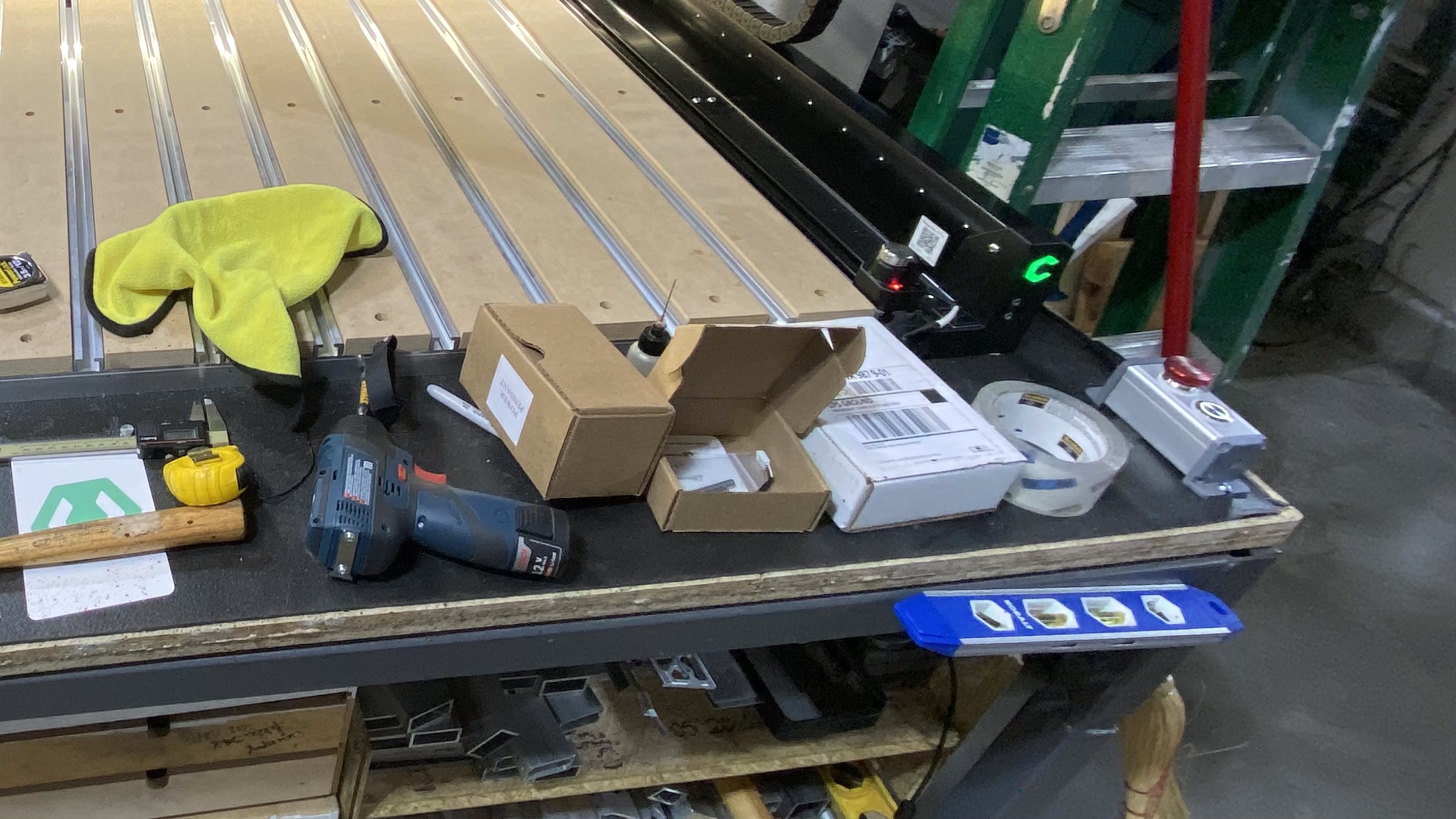

I’m just a noob an want to get your experience, tips, and tricks. I would appreciate that.
Finally got the machine initialized, did all the things the screen told me to do and it seems to work great. Probably check the trimming next.
Questions

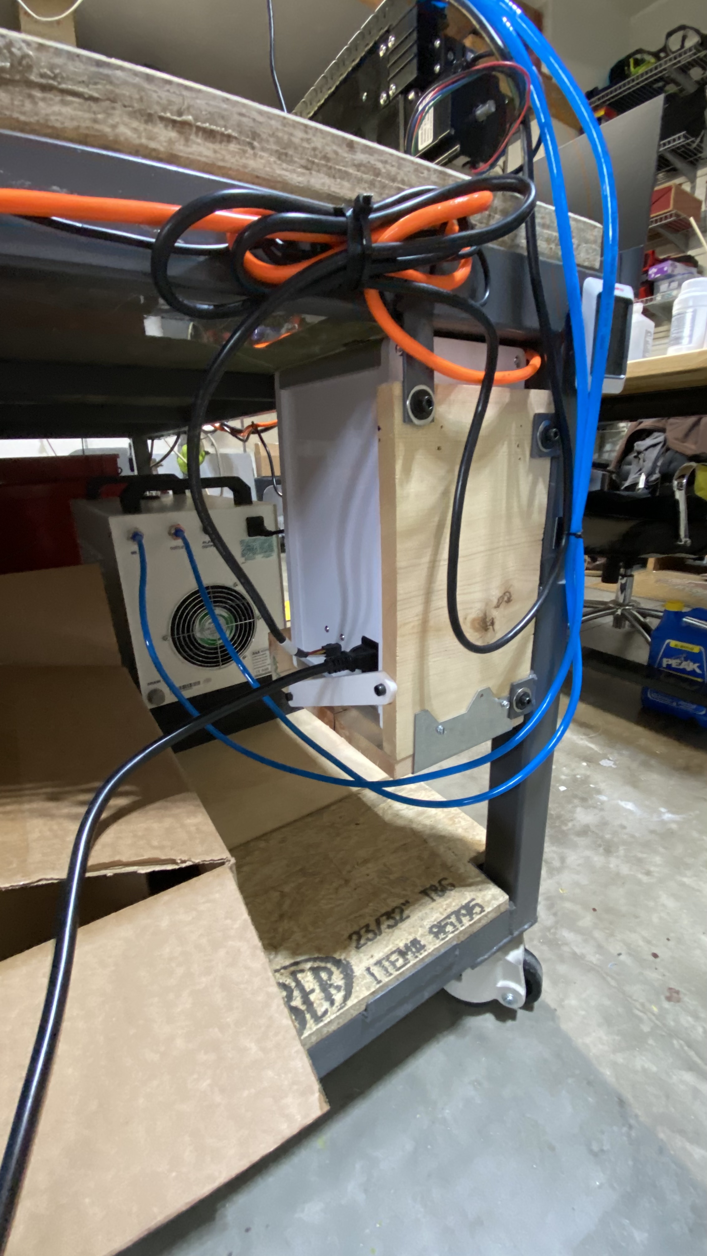

  1. Do I need to bleed the chiller?

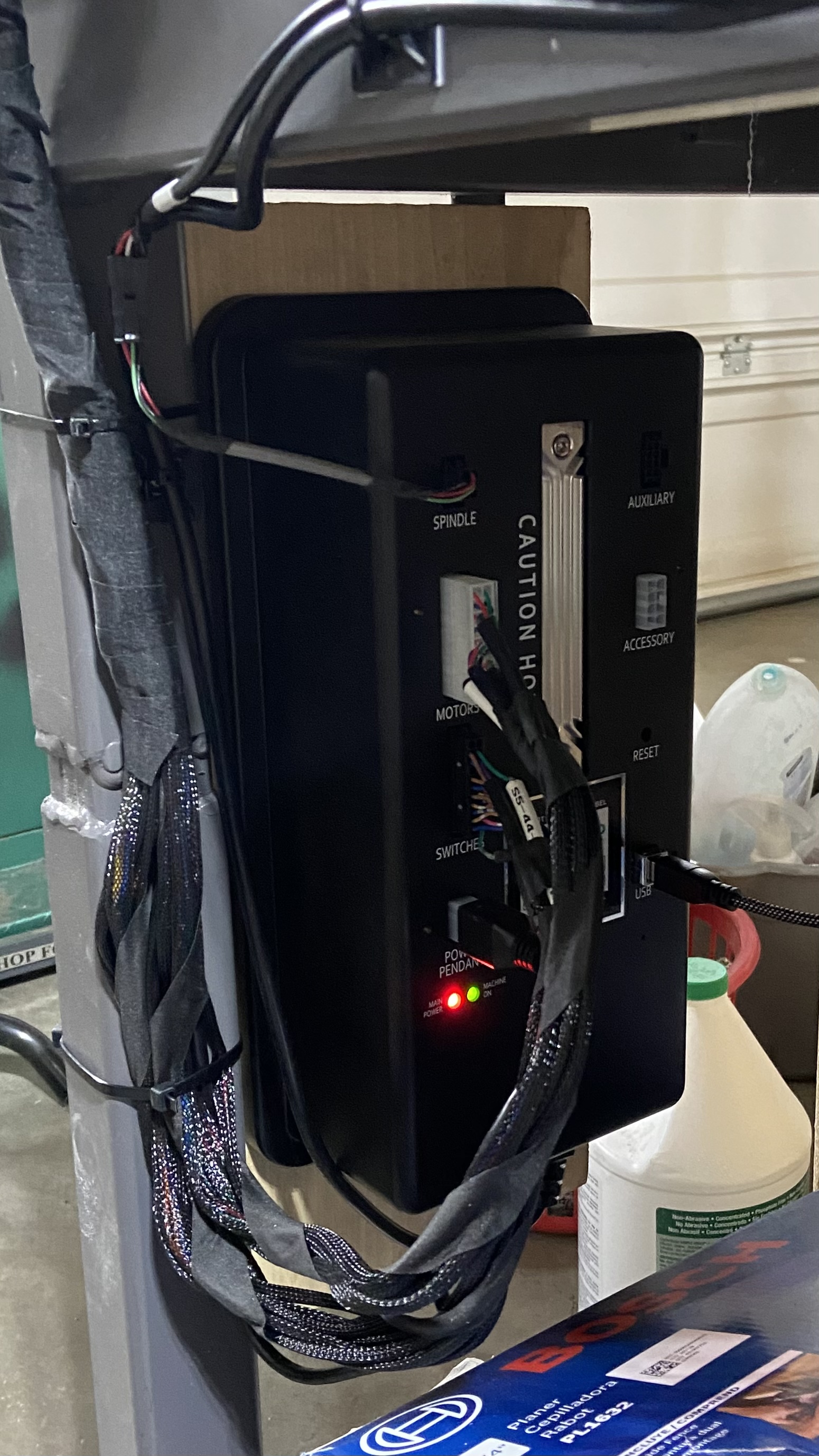

  2. You can see it I have the control box on the right back corner, VFD and Chiiler on the left back corner. VFD seems running great, but would there be signal interference from the chiller fans, etc?

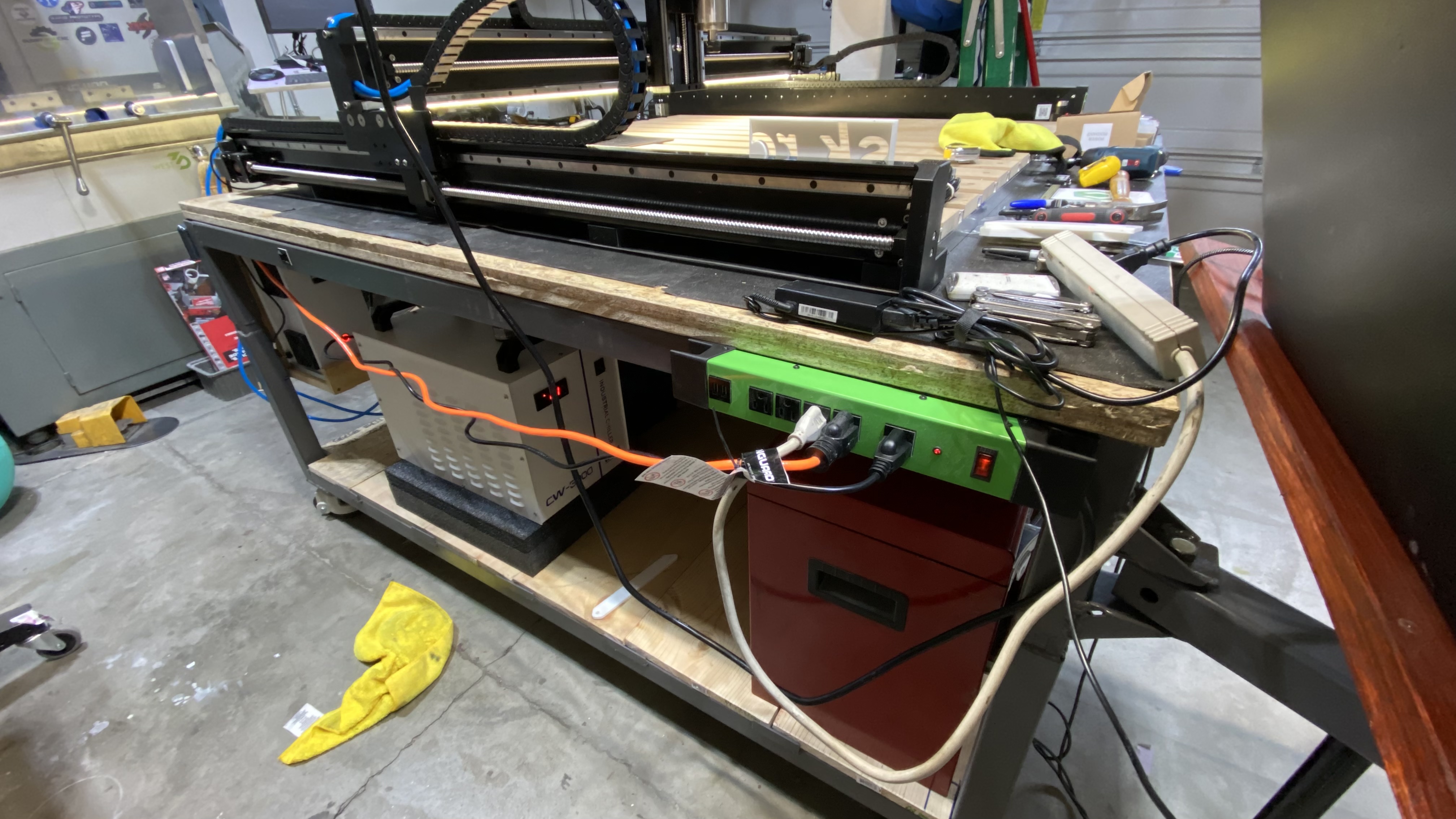

  3. I tied all 120V plug to the a surge protector and use this for on/off. Is this next practice? Would I ruin the individual box that connect to it?

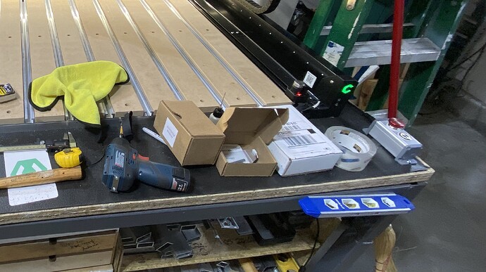

  1. That E button probably should be closer to the computer strand.
  1. Would love to add remote pendant to jog.
Thanks
