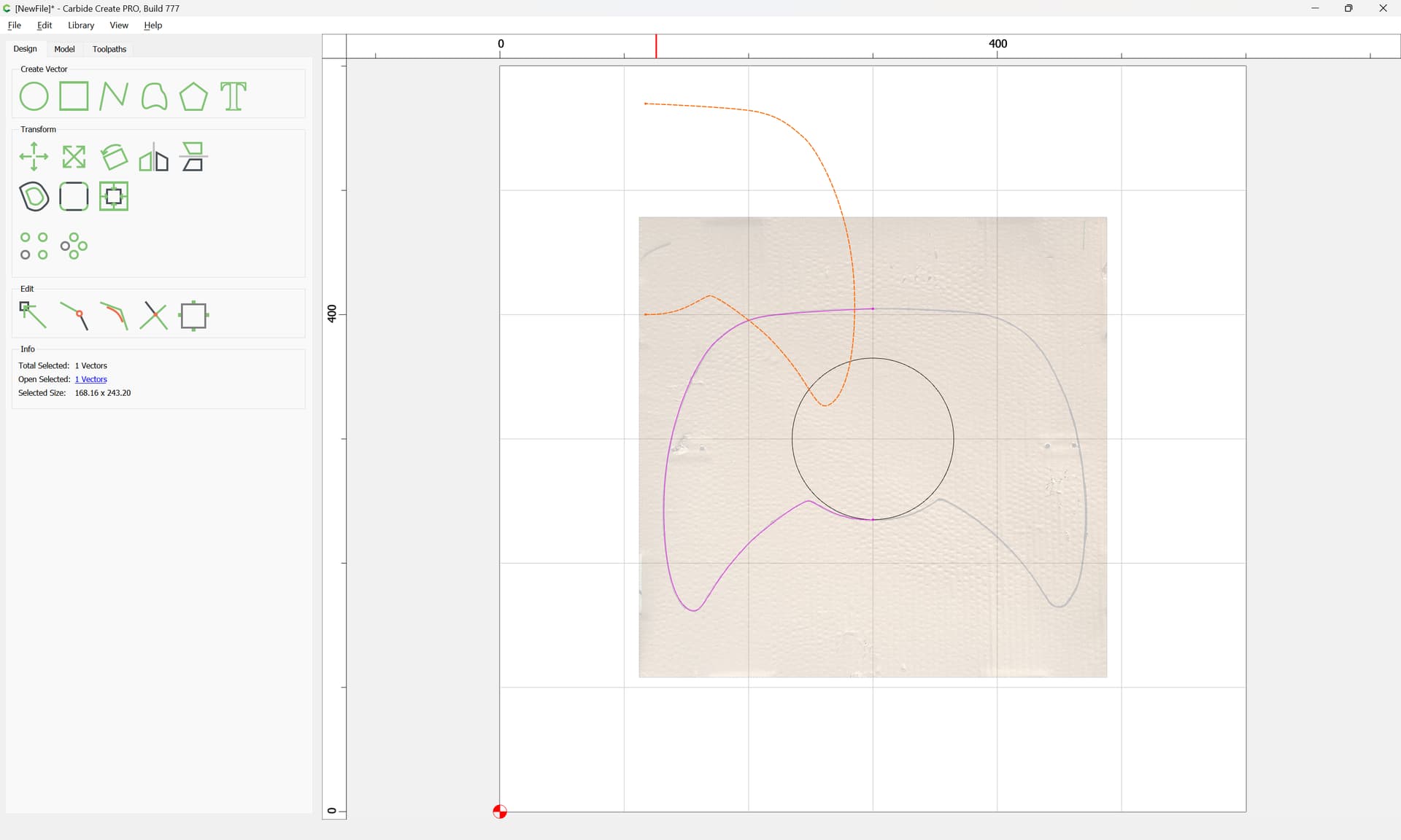

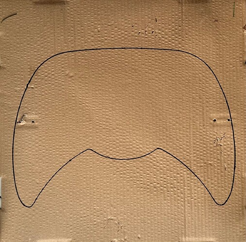

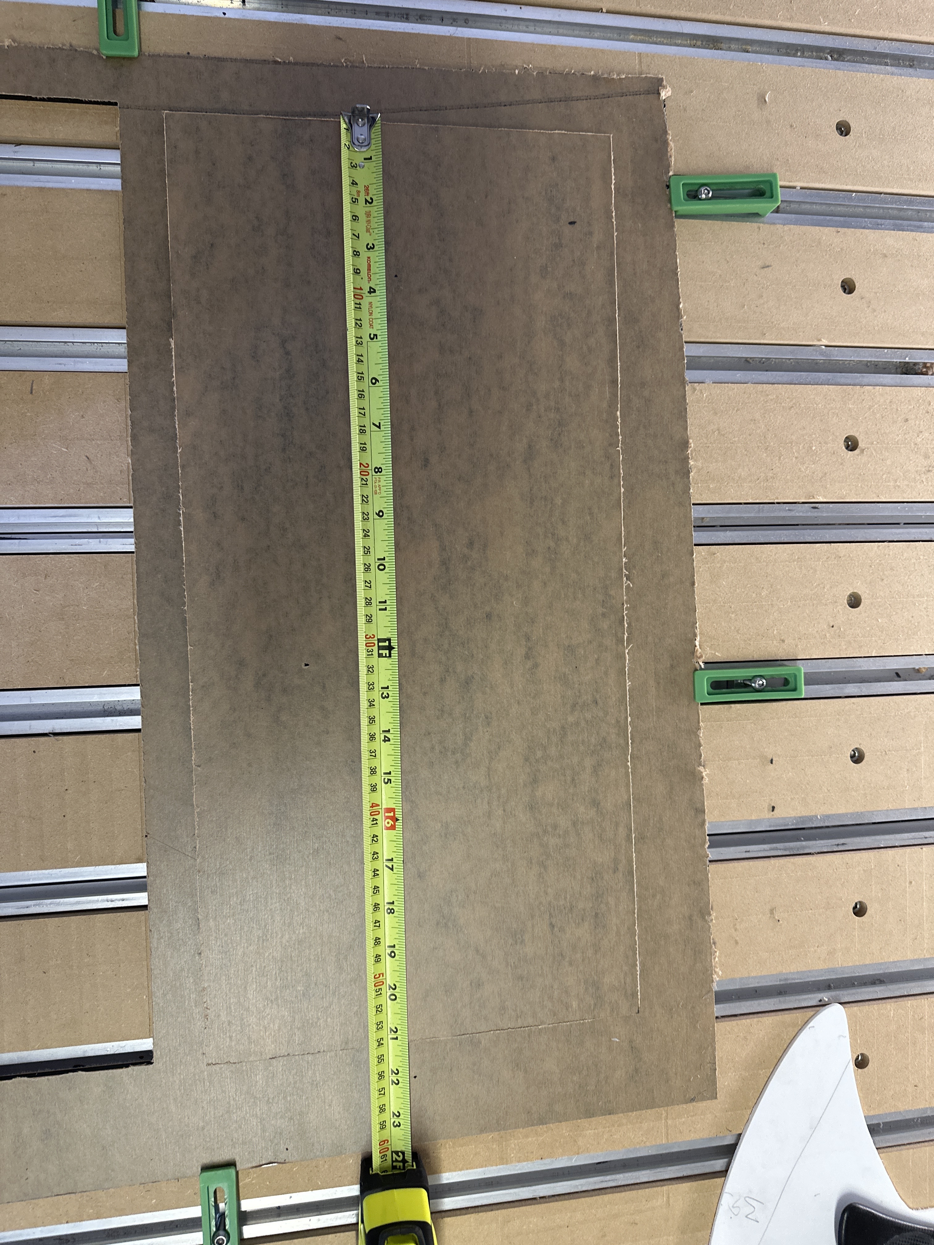

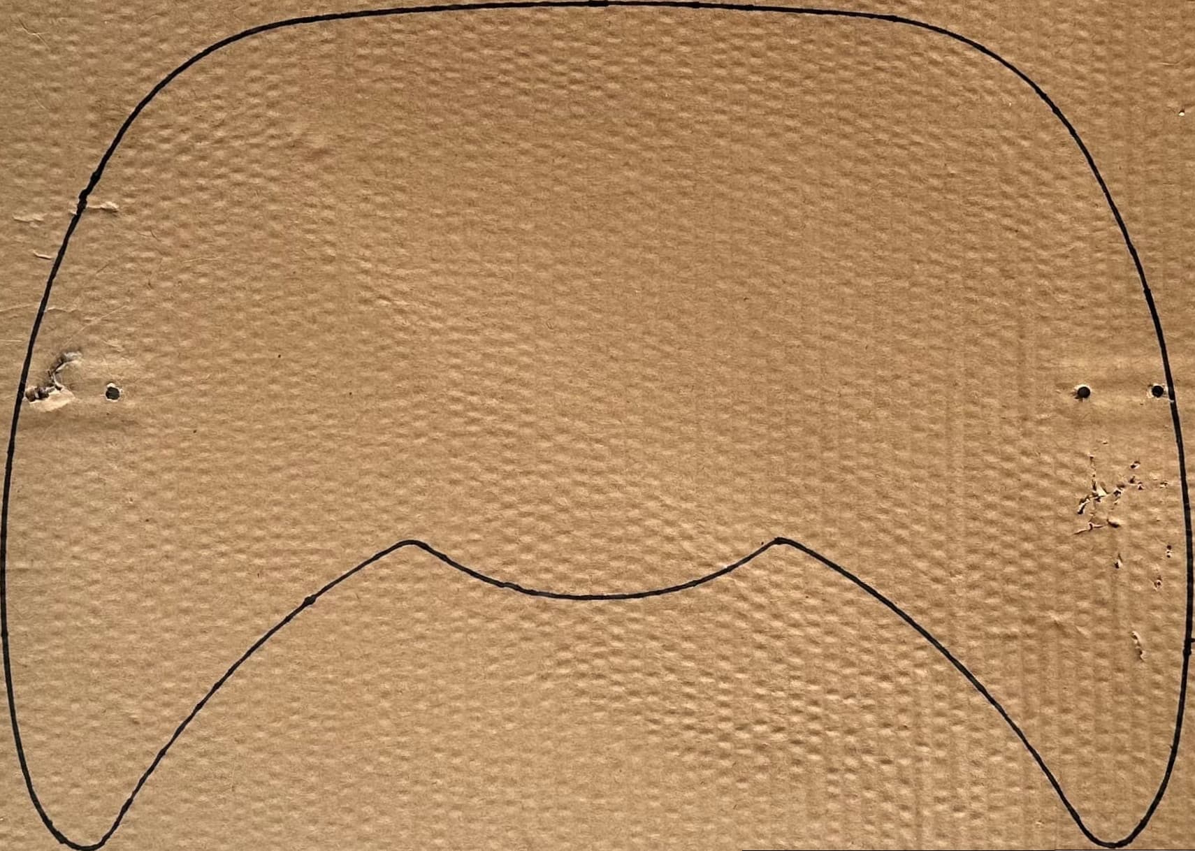

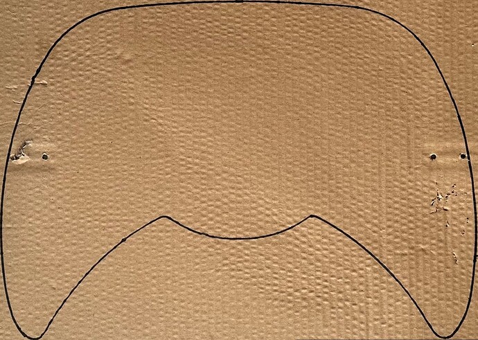

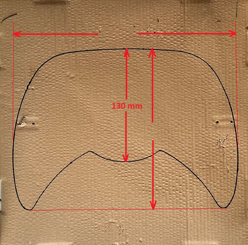

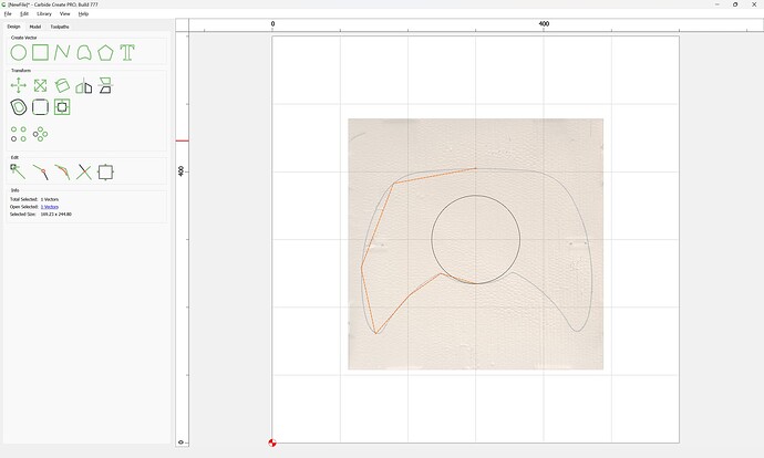

it gets really hard to get designs right for me @WillAdams I tried with other panels and they came out great but I still get a small measurement off. How could I make this panel with this much curves and have it right. I drew the outline for this one since it wasn’t laying flat
its 130mm in the round part in the middle

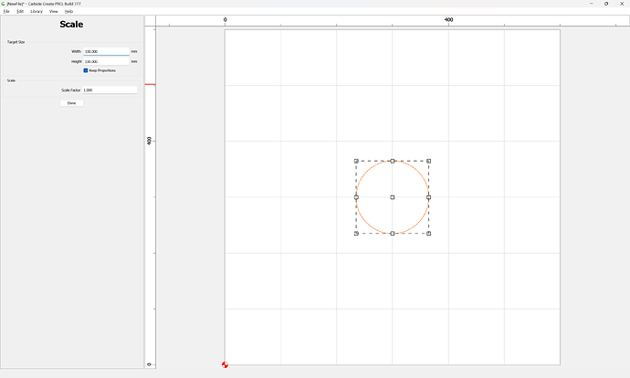

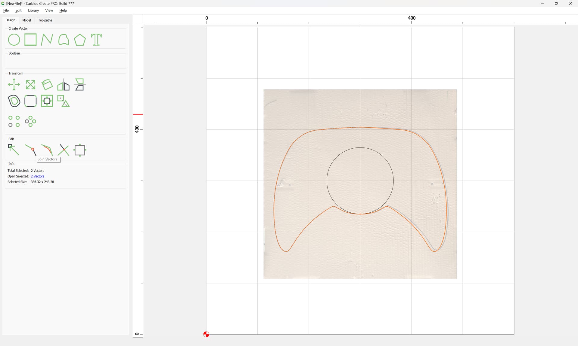

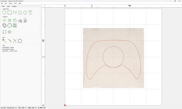

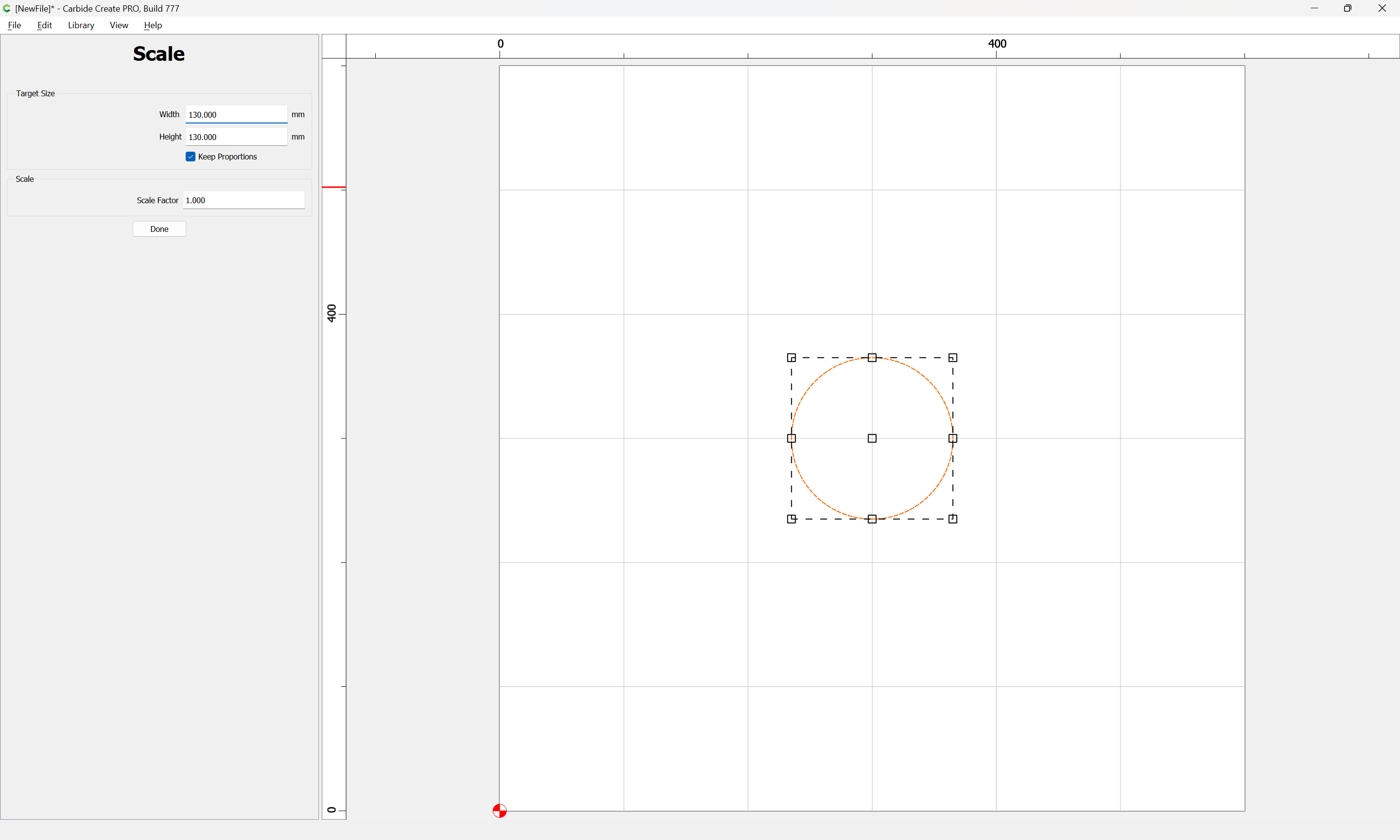

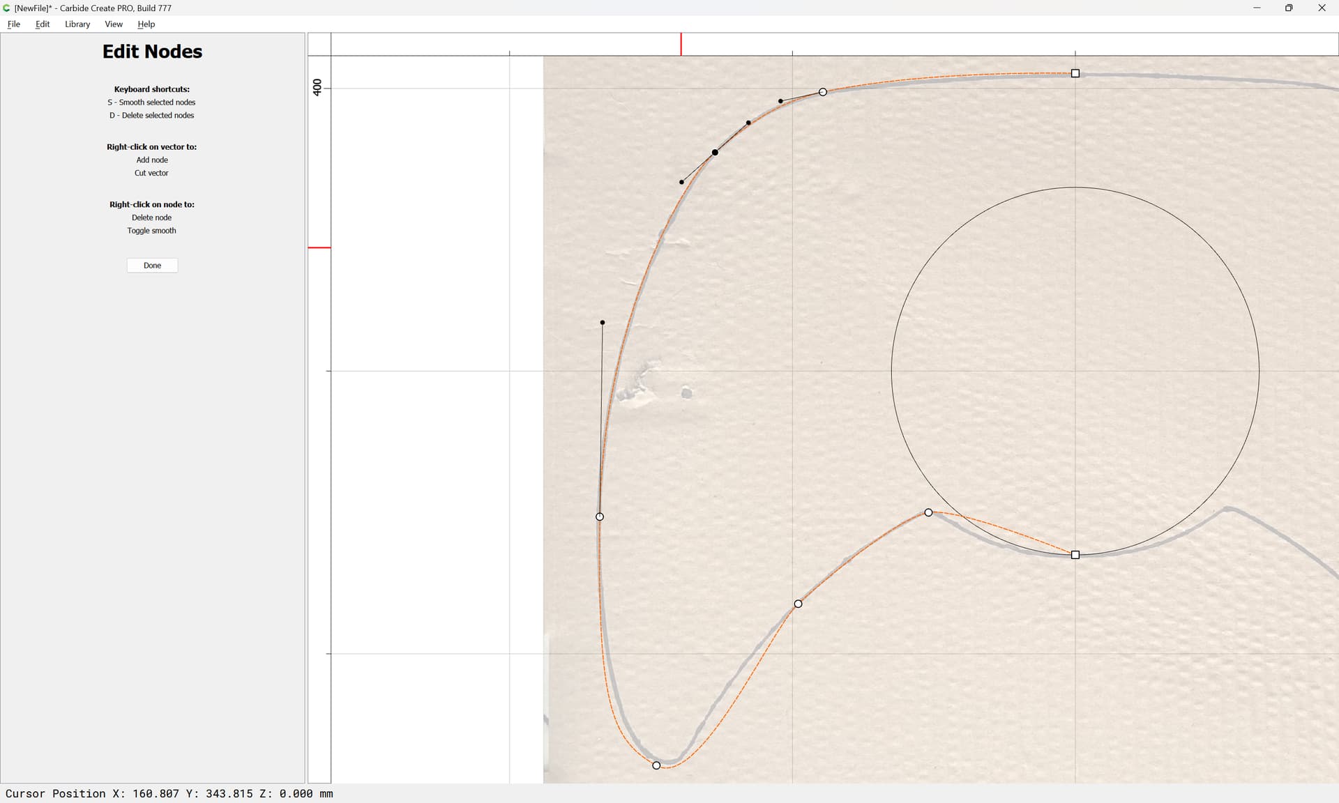

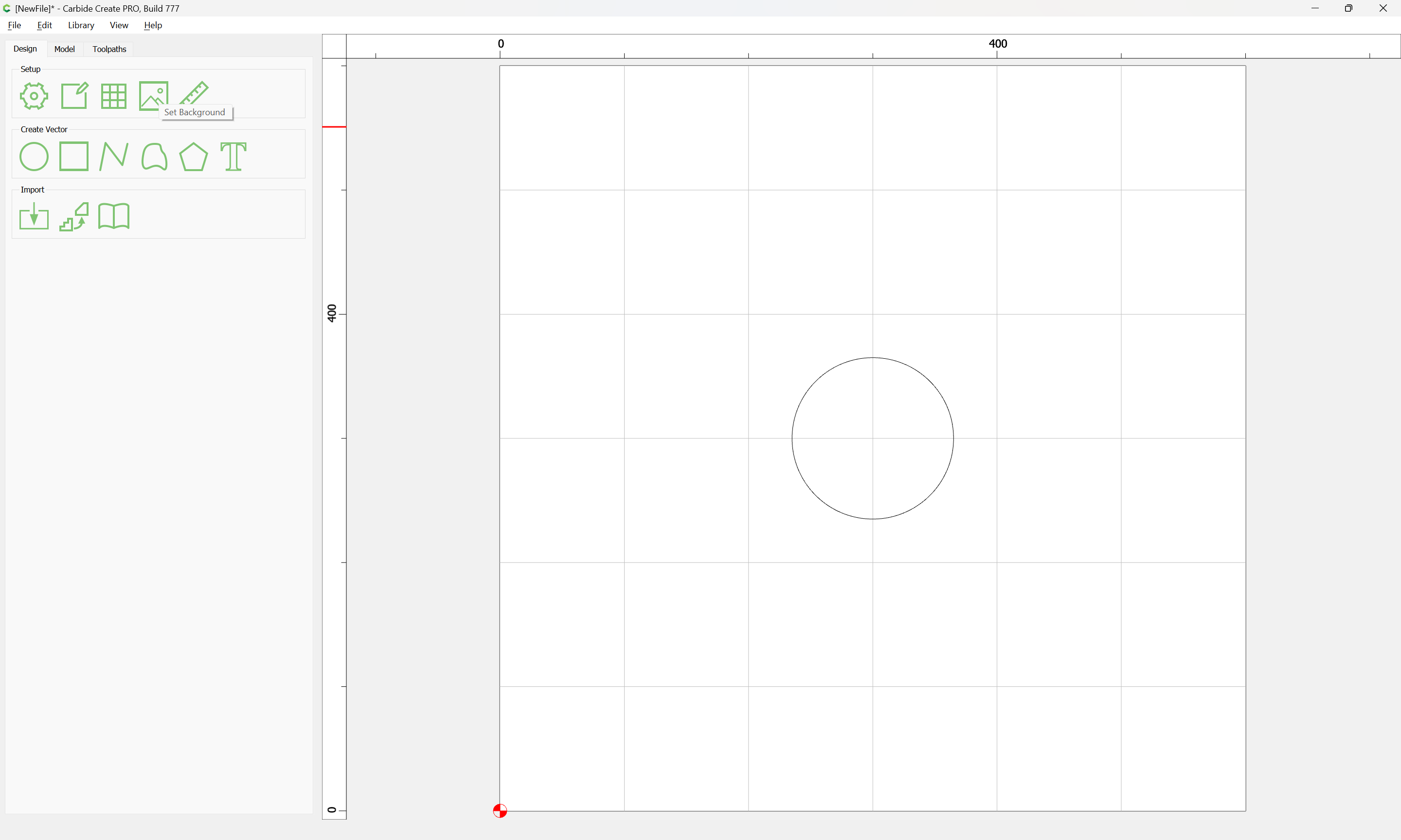

Start by drawing in a circle of the correct size:

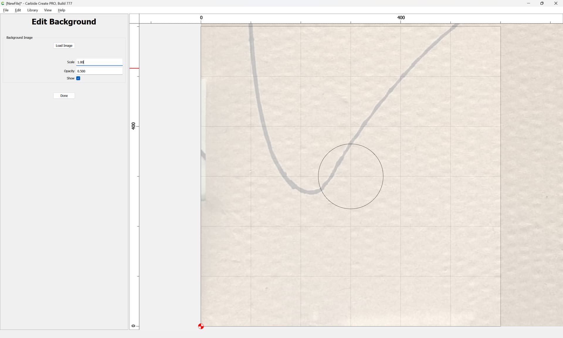

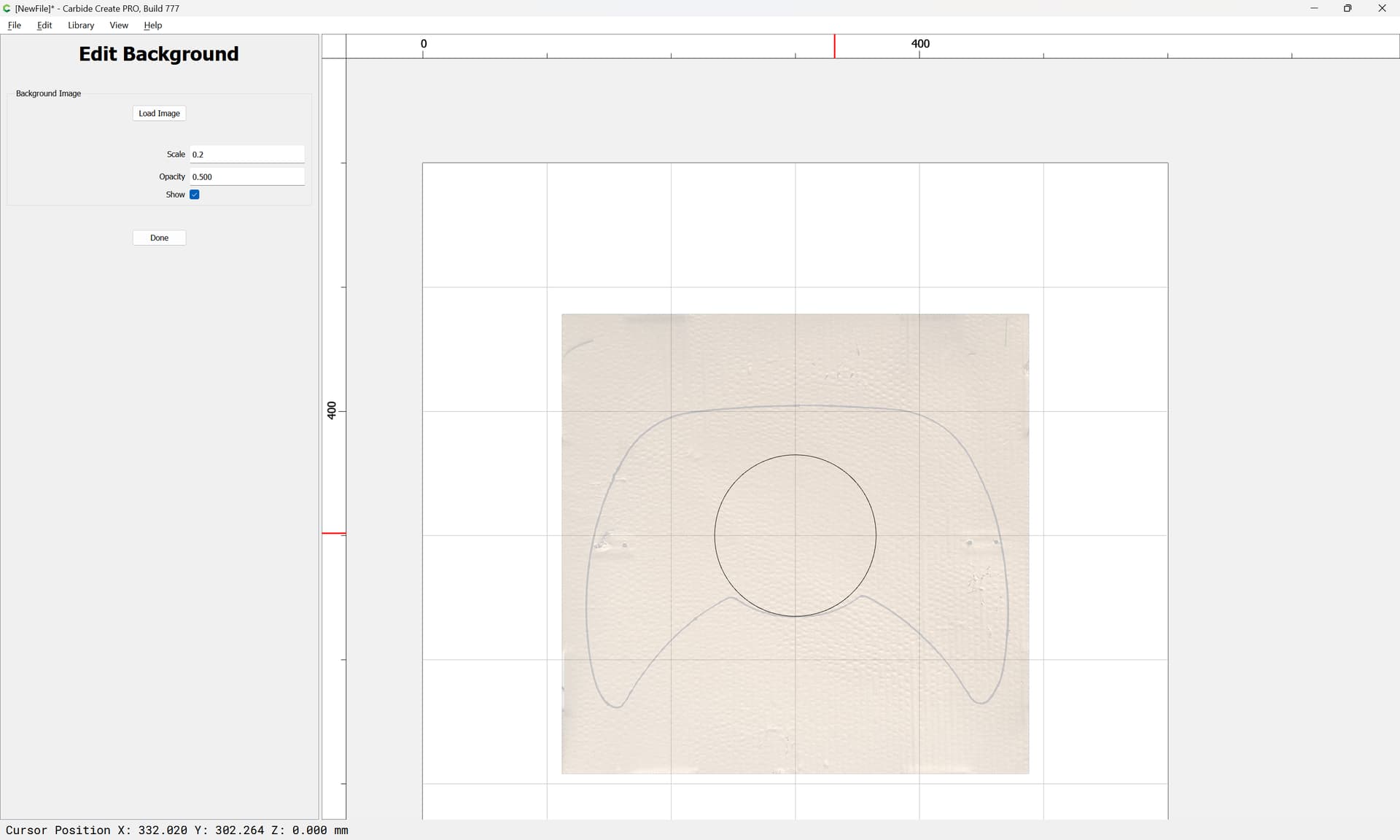

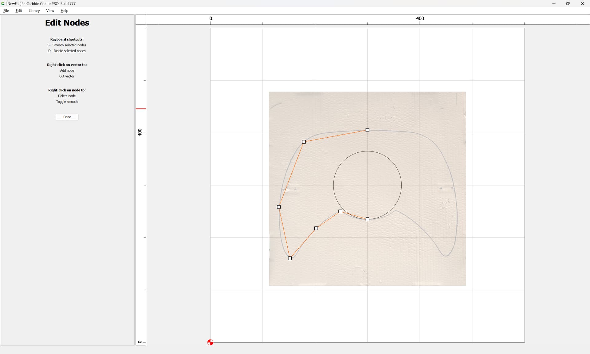

Then import the pixel image:
Adjust size and position as necessary:

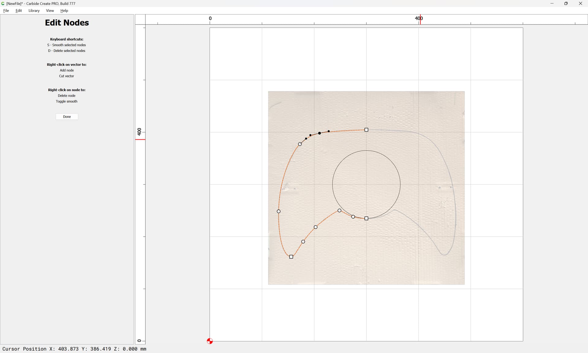

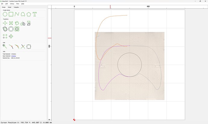

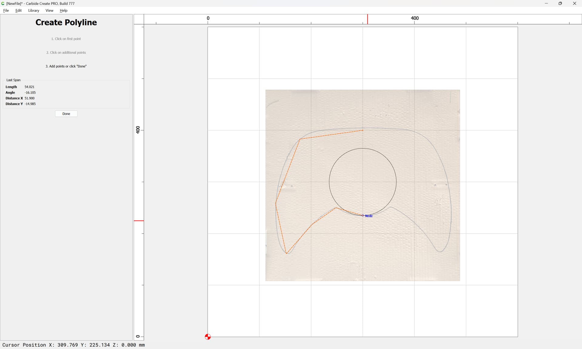

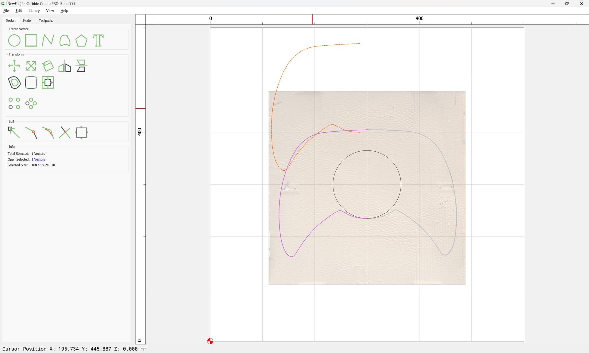

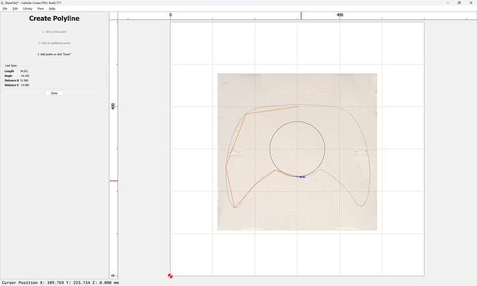

Use the polyline tool to draw in a rough approximation of half the part:

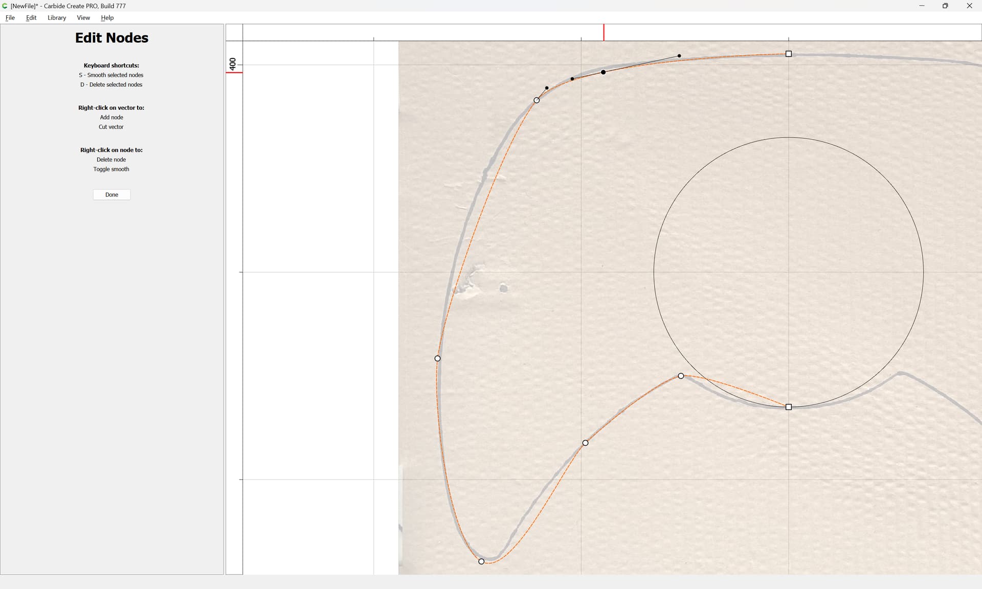

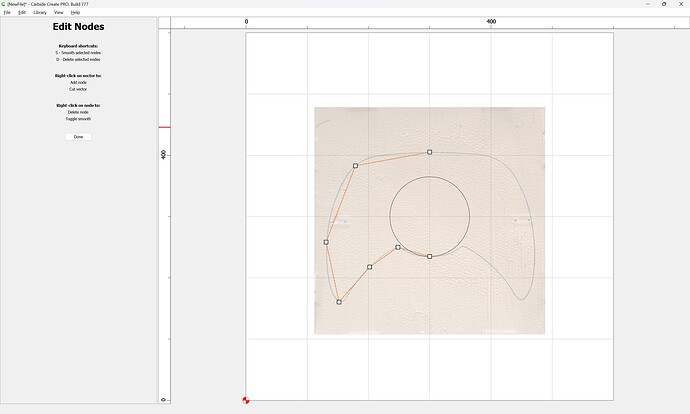

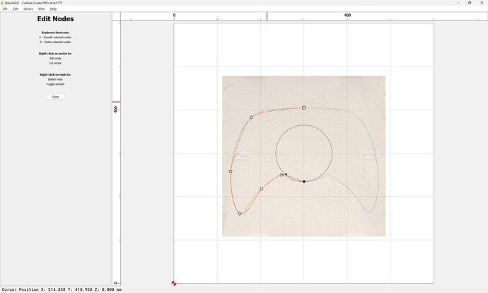

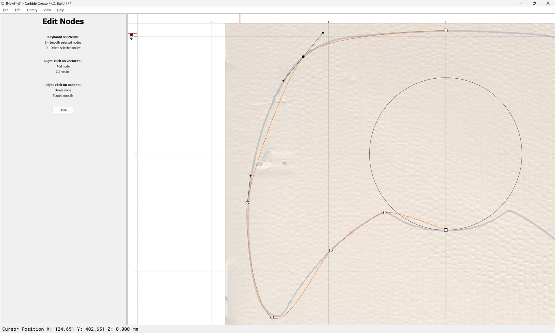

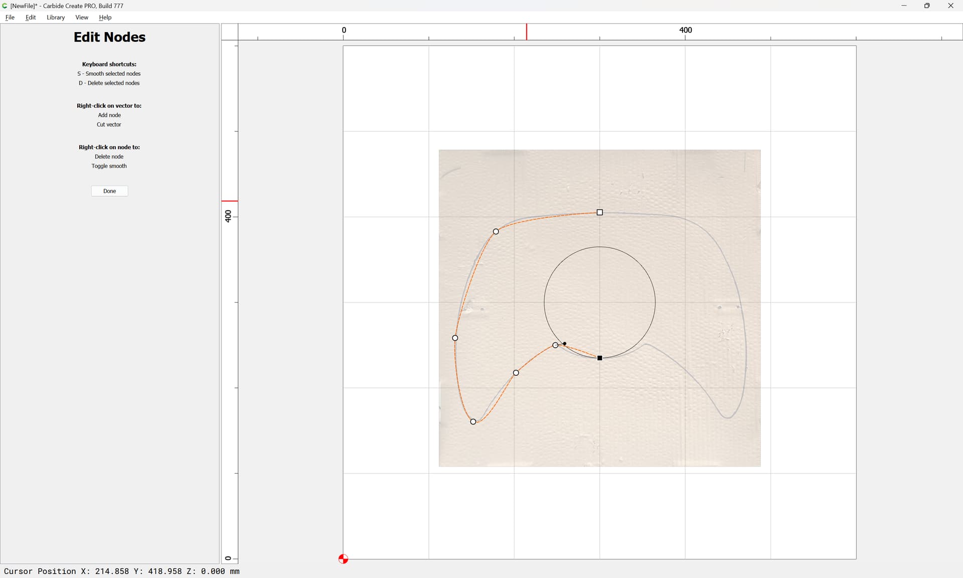

Go into Node Edit mode and adjust until things match:
If need be, add additional nodes:

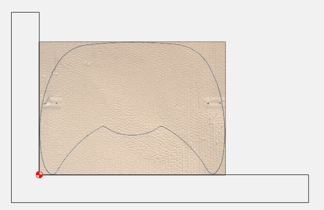

Done

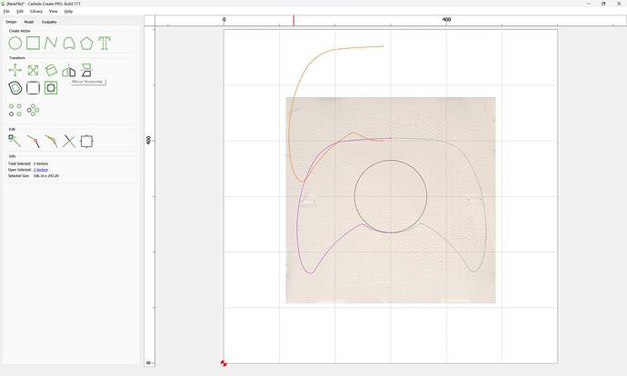

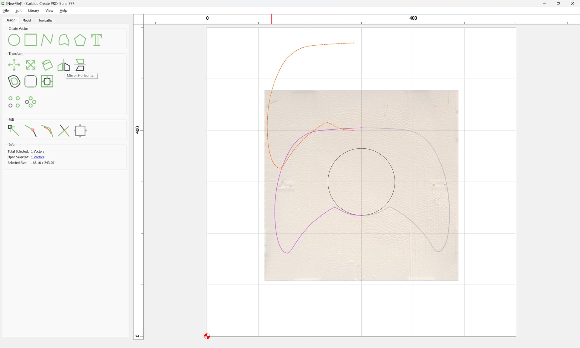

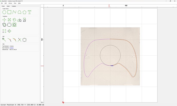

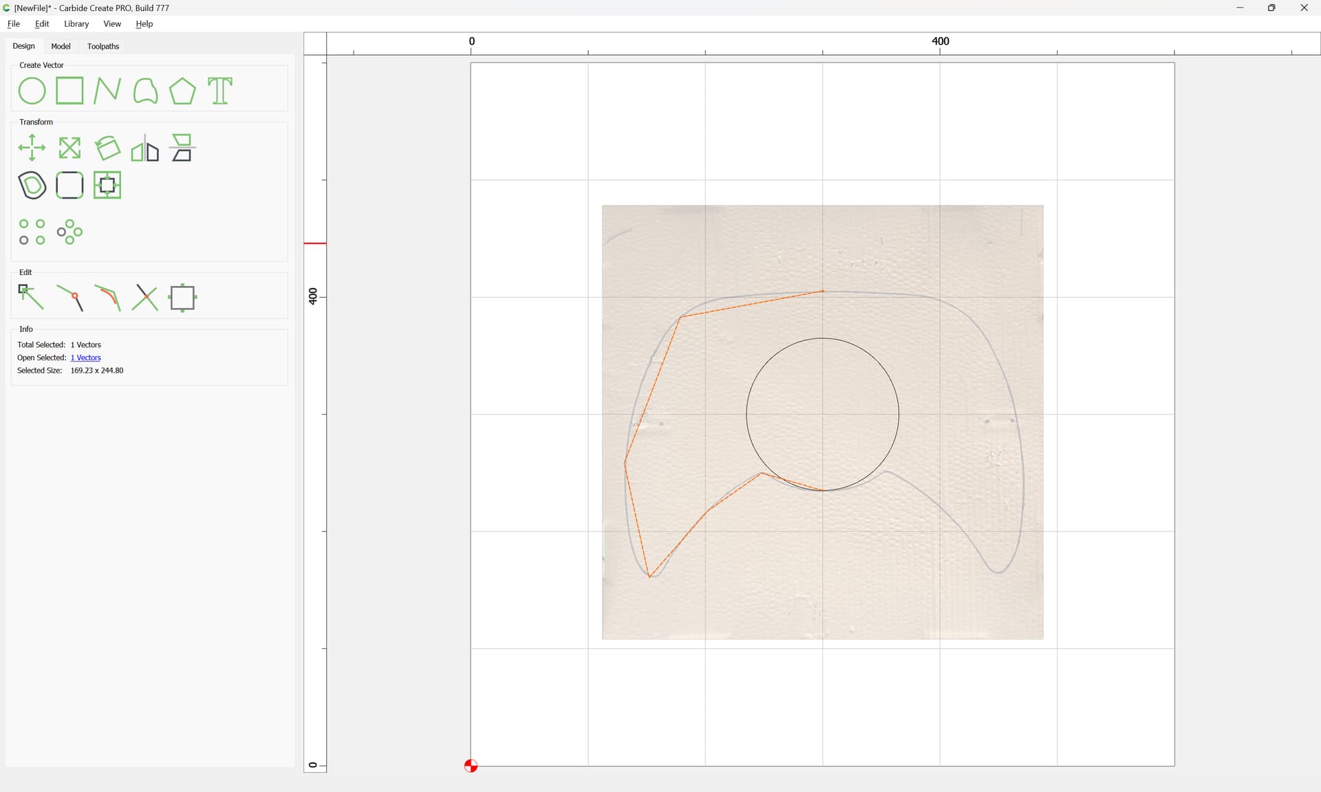

Duplicate

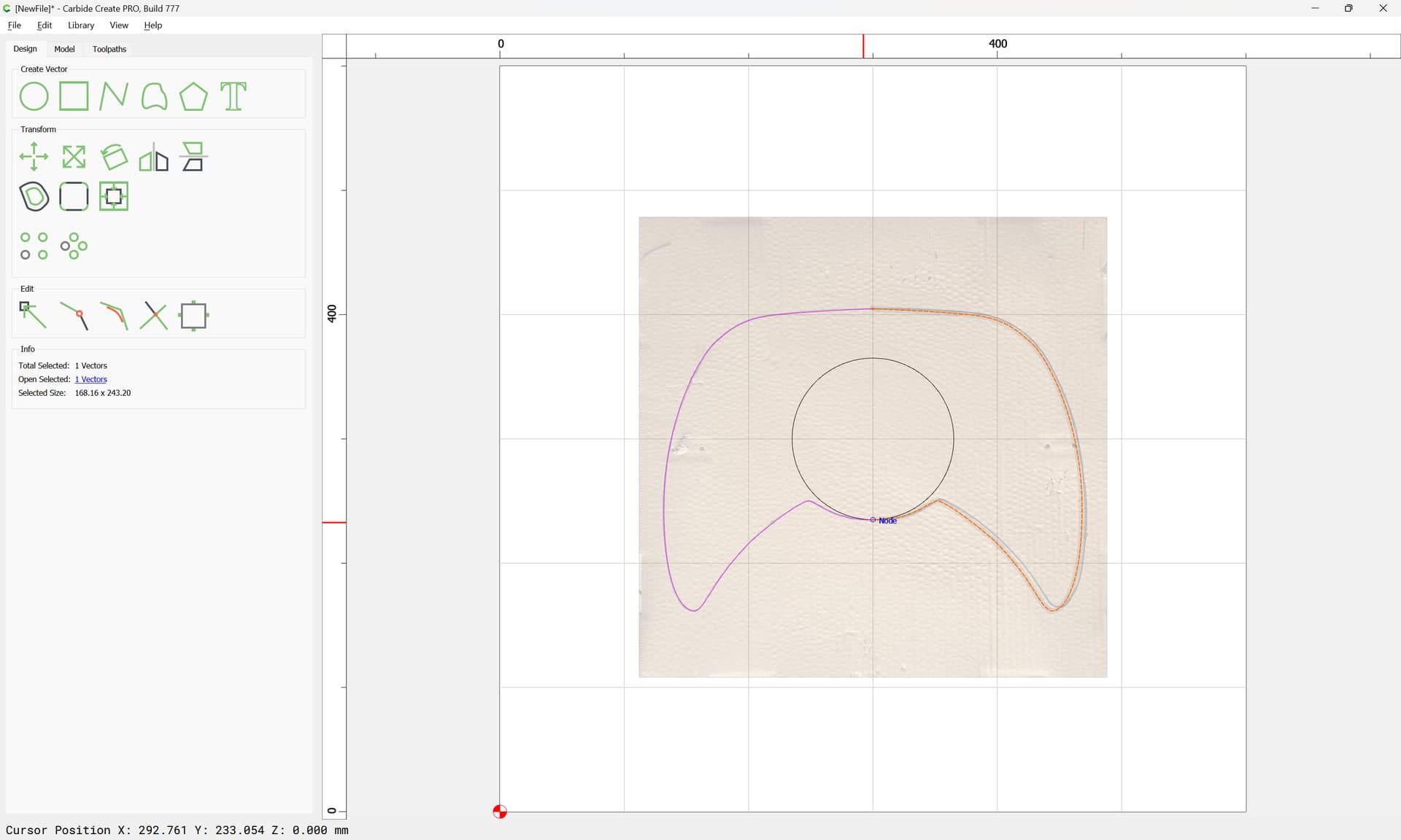

Mirror Horizontal:
Drag the twain into alignment:

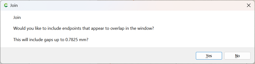

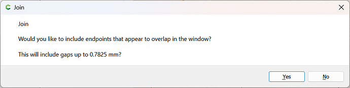

Select both parts and Join Vectors:
Join Vectors:
Yes
Cut a test version in an inexpensive material and adjust as necessary.
Attached as a v7 file.
curve_v7.c2d (3.7 MB)

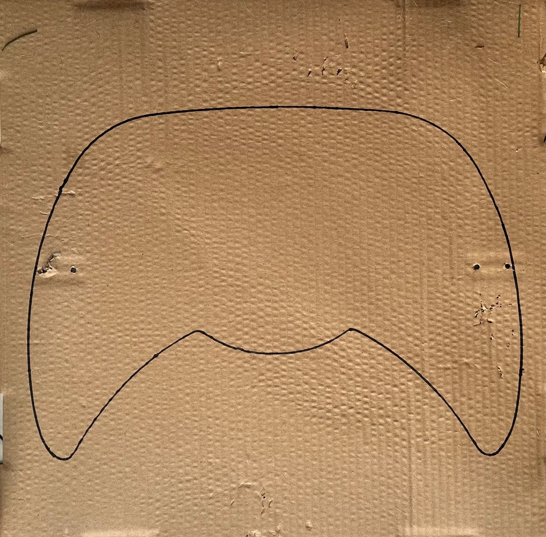

How accurate are you trying to get this?
I would start by using a few more dimensions. I assume your 130mm is the measurement I drew?
Taking a picture of a trace will not be perfect. Your best bet is to make sure the camera lens is as close as possible to the centerline, perpendicular to the paper, and as far away from the paper as you can get it & still get a decent picture. That combined with the additional dimensions will get it a lot closer.
With the dimensions above, you can create a frame for the image to know you have it aligned as good as possible.
The next thing would be to edit the picture & get it square…
Then follow Will’s method to draw in half & mirror…

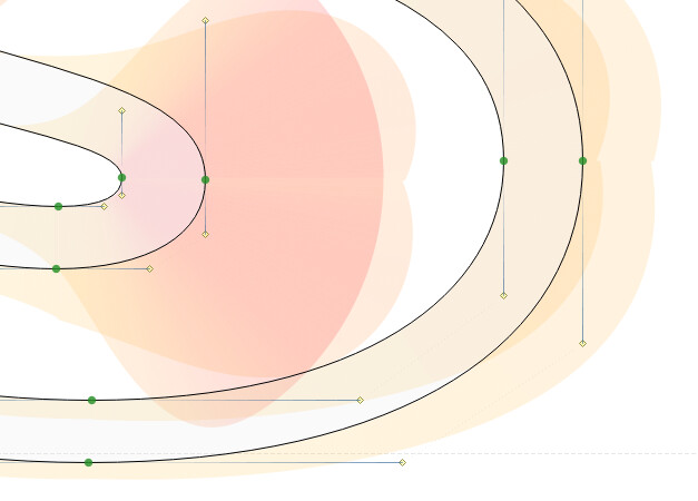

Thanks will for showing how to do this in CC. Getting curves right also needs experience and eye-training. These 3rd degree Bezier-curves are great for drawing, but they are not ideal for all shapes. If you draw a circle, duplicate, rotate 45 degree, zoom in enough, you might see that the circle is not perfectly round, that is how the math works.
Specialised cad and drawing apps can visualise curvature, how fast a curve is bending:
(screenshot from a type design app)
It helps to get better curves, good enough for human eyes, but nowhere near good enough to build fast vehicles where curves must have G3 continuity. That requires different math for circles, and up to 5th degree Bezier curves. Specialised product design apps can do that.

Sometimes you have to get creative, especially with a part like this that has not flat or square edges. Ideally a flatbed scanner would be a better way to get an image.
For measuring, place the part against a contractor’s square, and measure from those edges.
Is there a scanner thats bigger ? Because some of the projects I have are bigger maybe like 500mm or 800mm
Get a probe and use the machine?
I’ve had good luck putting objects down on a gridded surface (I use a series of cutting boards) and taking a photo.
