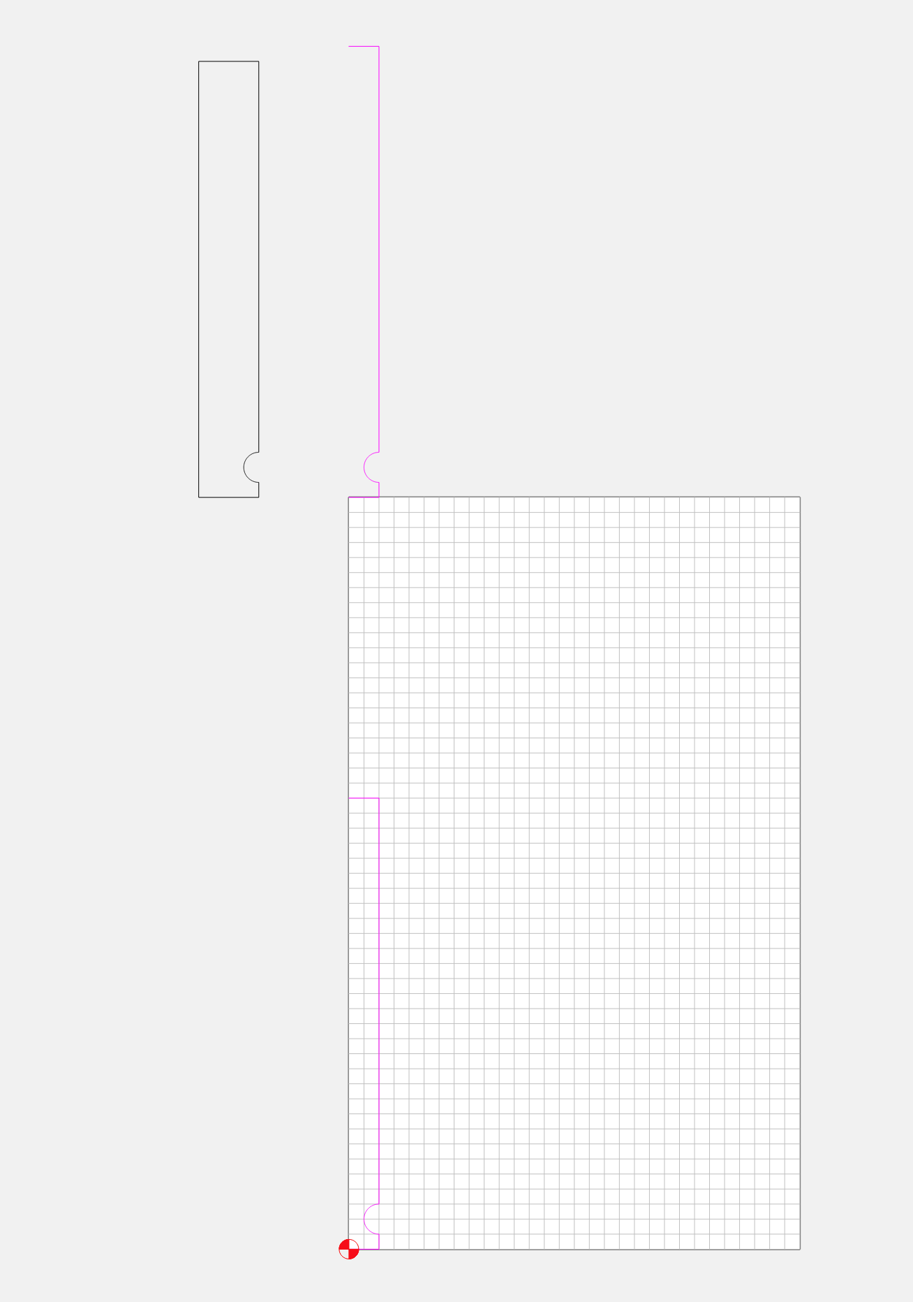

Here is my first-pass at a solution. Sorry if it’s not entirely clear.
Here are the requirements for us to make something that we can officially support for every customer:
  1. We need a solid fence\guide on the left that allows the sheet to be slid through, without any shift or rotation
  2. We shouldn’t depend on a factory edge on the sheet to be straight enough or bump-free enough for indexing.
  3. We need a way to index forward accurately.
  4. We don’t want anything that would over-constrain the system, Like pins.
Here’s a rough sketch of what I’m thinking.
So, the first part would be to bolt down something like this, and possibly cut it in place (though that’s difficult if it’s outside the cutting area) to act as a fence. The dimple becomes the alignment mark:
At each index, the mating surface would be cut into the edge of the sheet. (Purple lines below)
So, as you index forward, you have a known-flat edge to get the sheet straight, and you get the dimple to nest in to set the distance.
Problems:
  • I’m not sure that a dimple is the correct shape, but it’s easy enough to change.
  • Cutting the first tile requires a little care to get the position setup correctly, but that’s a process that can be documented.
  • The location of the fence defines how tall each tile is, so I’m not sure it’s possible to change the tile height without repositioning.
On the positive:
  • You’re cutting everything you need for alignment on each tile.
  • Nothing gets cut into the wasteboard.
  • Nothing should ever jam due to overconstraint.
  • If you REALLY love pins, it’s actually possible to replace the fence with two pins, slightly offset in X. While this would work, it might not be immediately clear what’s going on for new users.
