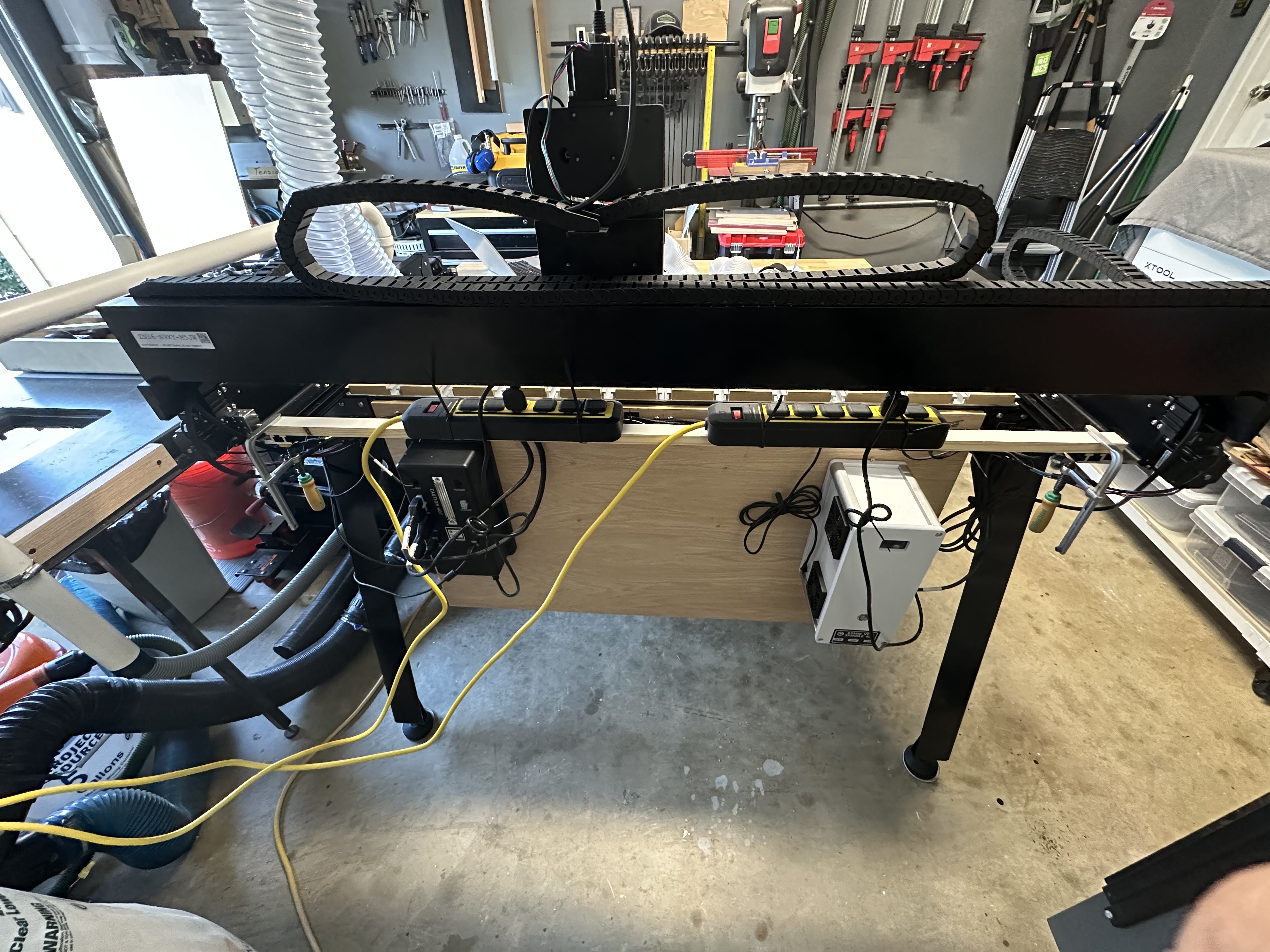

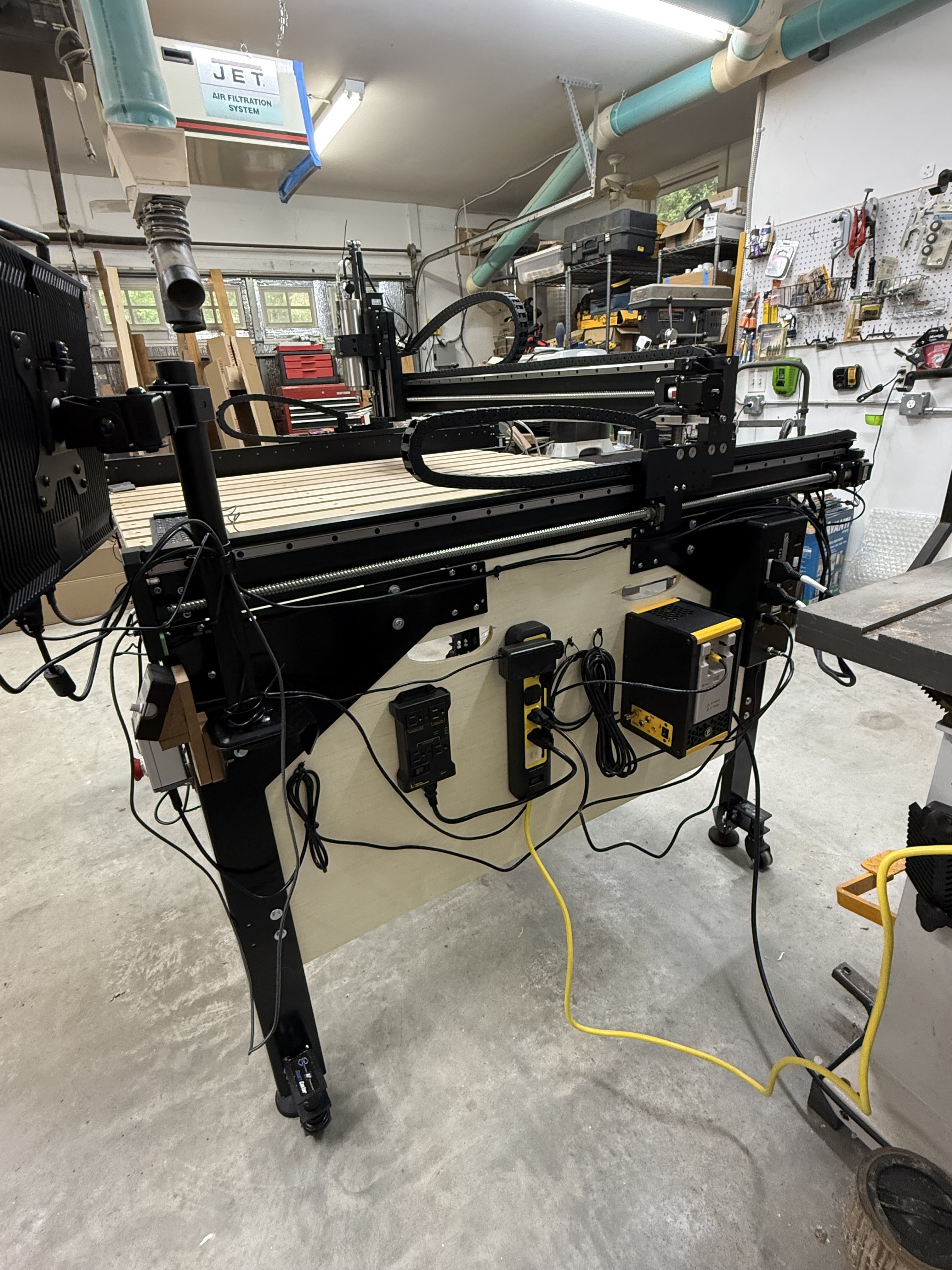

No reason beyond the added work and added complexity of cable routing — it’s what I did.
While on the outside, here’s one example:
I just finished mounting all my electronics yesterday. I made a panel to attach the stuff.
[IMG_8933]
Like you said though it does make the table wider. I thought about inside but crawling under isn’t attractive.
You could probably rig up a recessed panel with a little creativity. My solution makes doing the shelf not viable but I am not sold on the shelf idea anyway as it creates a lot of dead space under the machine. Feels like it should have been a little lower.

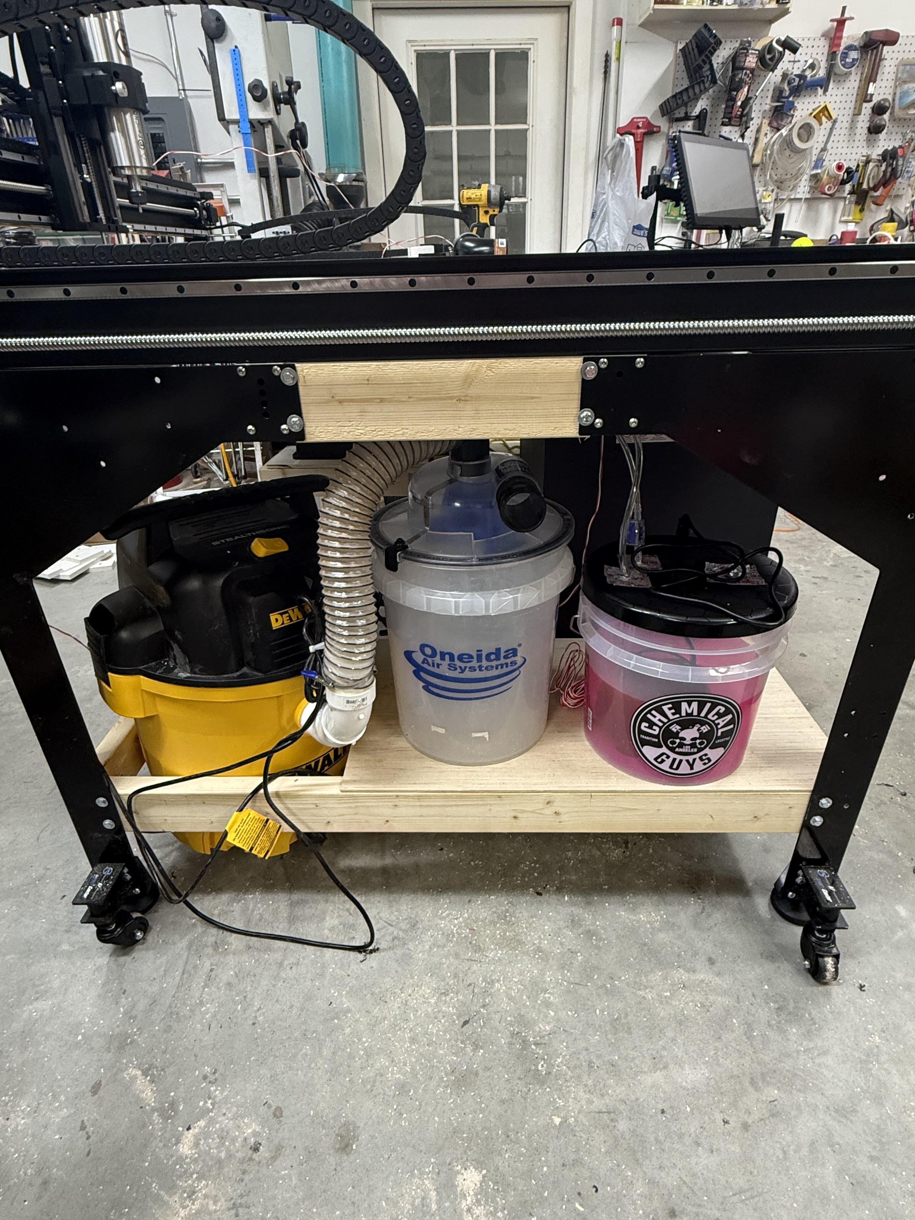

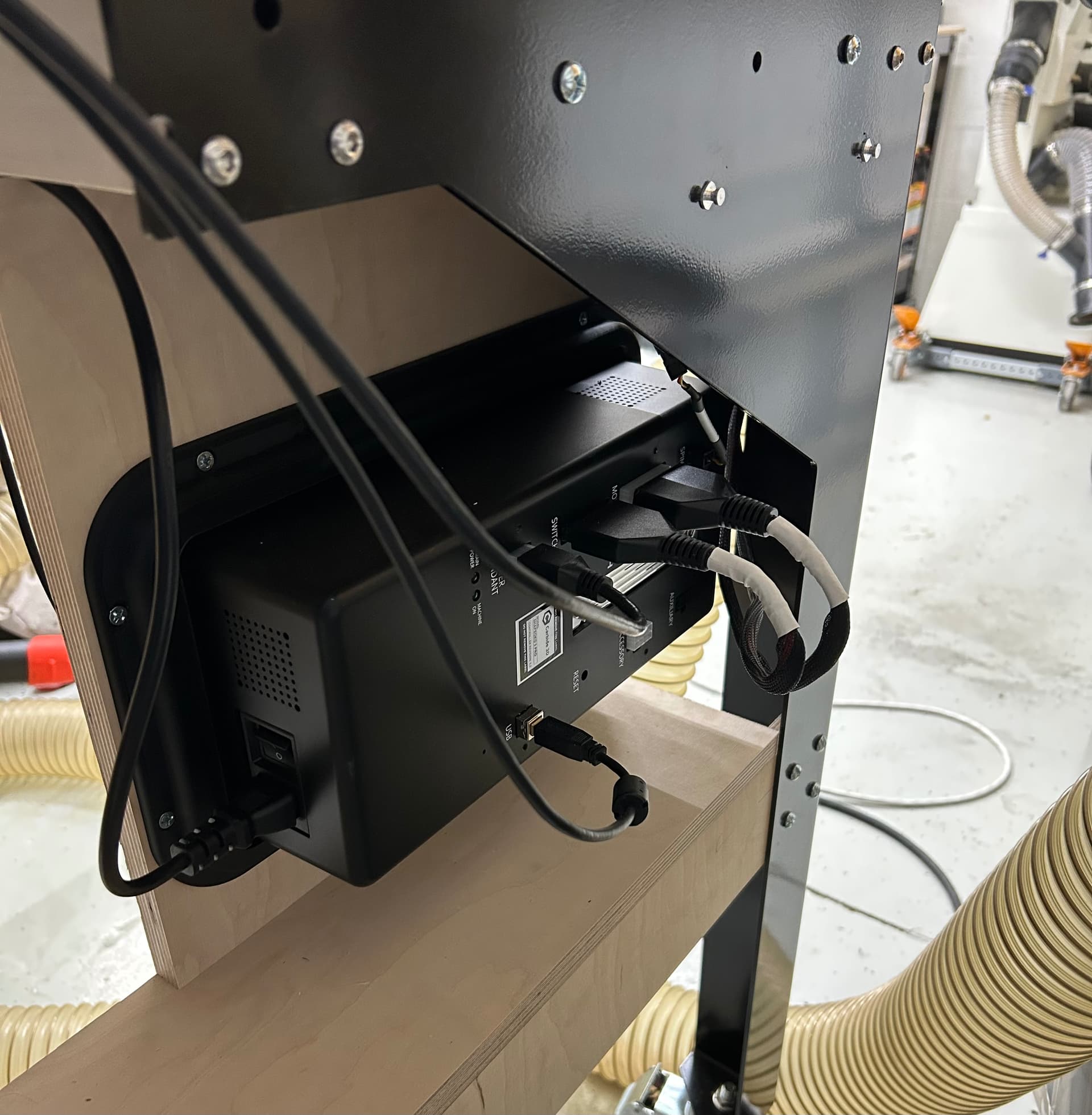

Note that I felt challenged to move the equipment into to footprint of the machine so I switched to this:
I took your challenge to get things within the footprint of the table. I removed the board I had things mounted on and built a shelf on one side for the controller and VFD.
[IMG_8977]
I am not sure if the controller and VFD should really be on their backs, need to check into that.
On the other side I built a shelf for the vac, dust separator and the coolant bucket (I use a bucket and pond pump rather than a chiller). The vac nestles into a hole in the shelf to get it low enough.
[IMG_8979] …

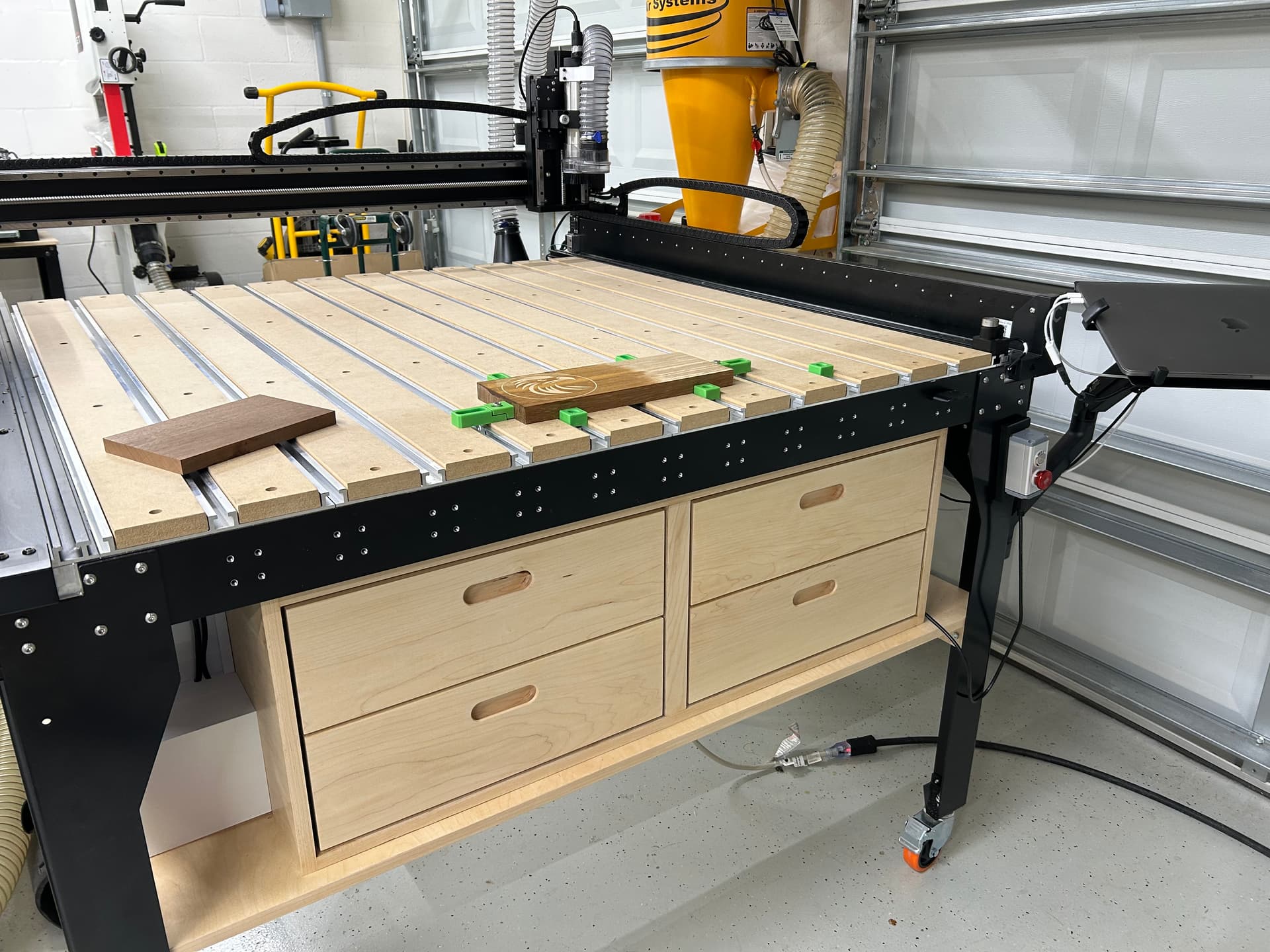

I made my own legs, and mounted everything on the inside. I ran the cables through the back cross rail. A 3/4" hole is not going to weaken it. I also drilled 1/8" holes on the inside or the back cross rail for a few cables. You can see it on my build post.
I am mostly done with the legs. I still need to add some front drawers, but that might be a while. Several other projects to do. I used a single sheet of 18mm Birch Plywood.
It was also my first real project, after having it for over a year. I am setting it up for PE foam production. There were a lot of other projects I needed to complete, and life got in the way.
I am also done with the high volume dust collection system, and the PwnCNC 30mm spacer. I am in the process of designing a quick, h…
