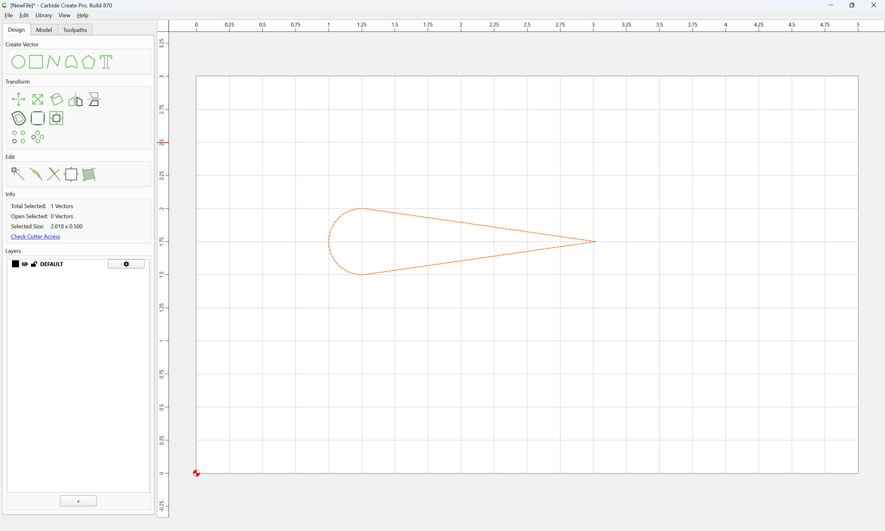

The only thing which one can’t do readily is a fluting toolpath along an angle and that can either be done as a 3D model using the new Angle tool:

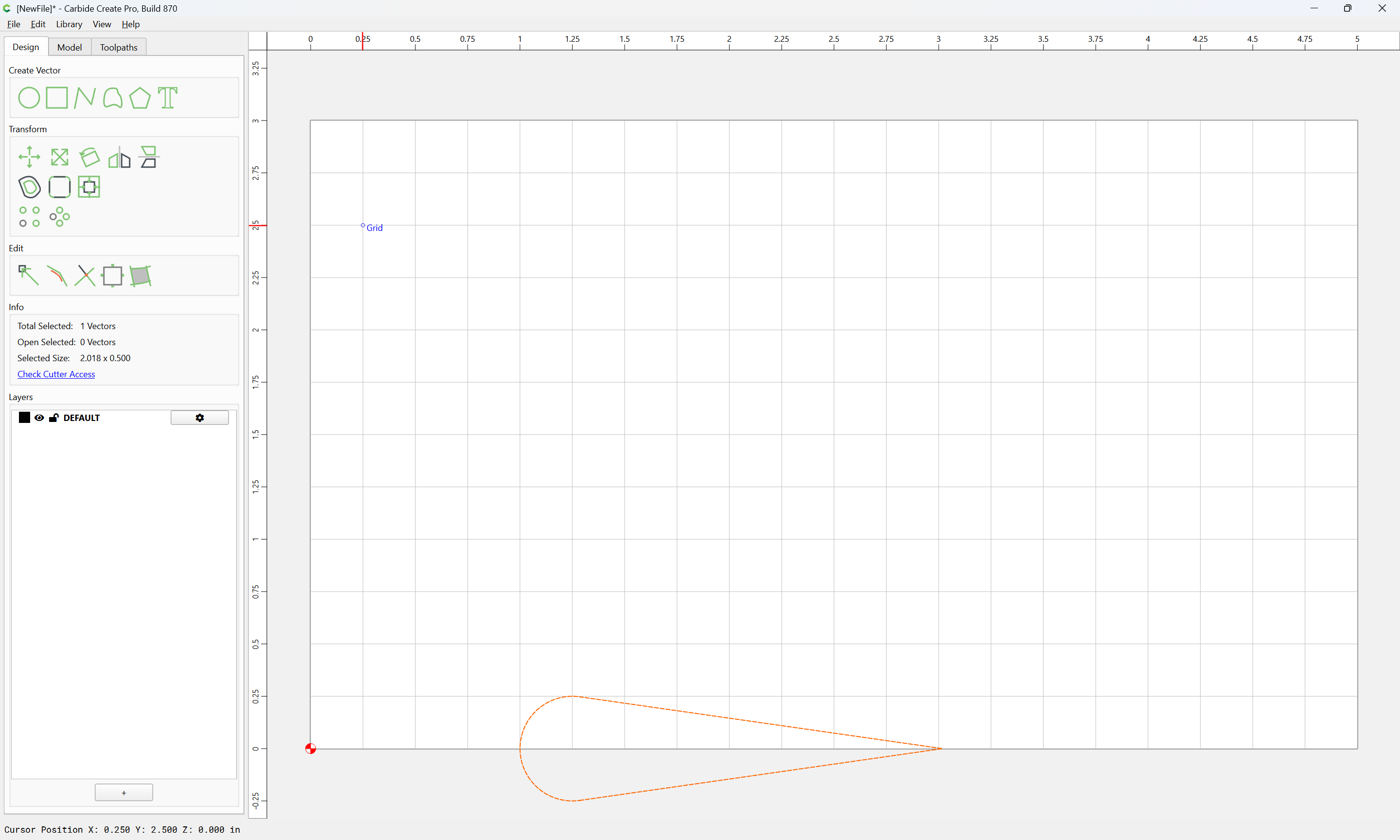

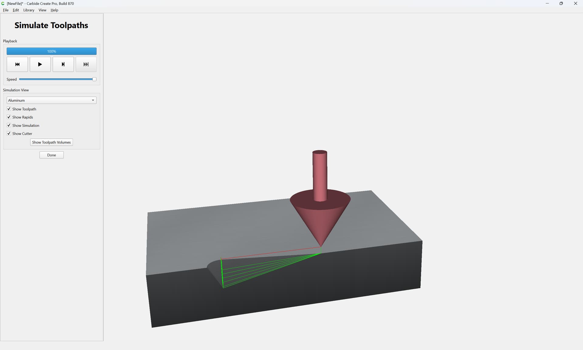

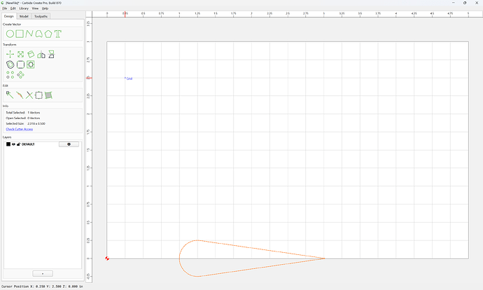

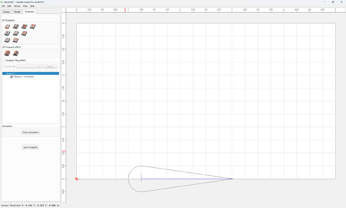

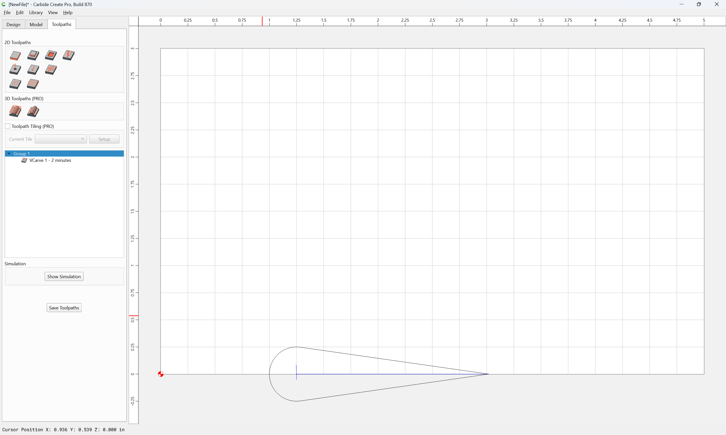

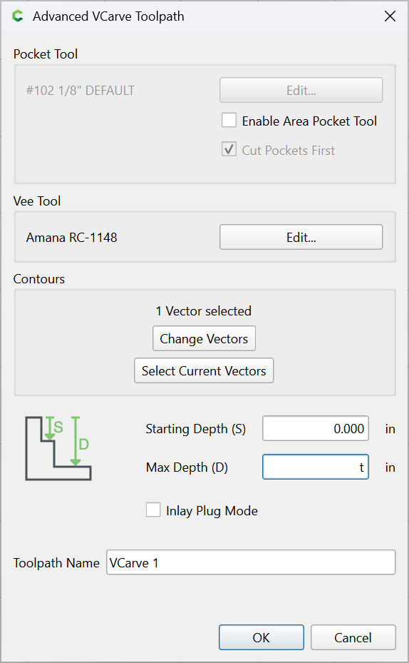

or by drawing a suitable shape for a V-carving if one is using a V-tool:
