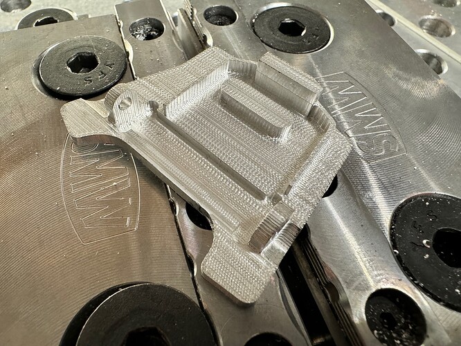

A part of a paddle shifter for a car out of 6061 aluminum. Maybe I got lucky but nothing is more than half a thou off which is better than I thought I would get out of the machine.
