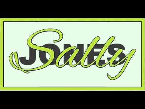

A lot of the videos out there on stacked text show using regular end mills and straight sides. If you do that it is pretty easy.
If you want to do it with a V bit you need to remember to offset the top layer vector by the amount appropriate for your bit.
This video shows that technique and how to do the calculation. He is using VCarve but the same method works in CC.
Thank you for this video. It is a great help for stacking text or pictures. I will be going back thru the video a few times to make sure I find options that he was using to understand how CC can do this same stuff.

Excellent Tutorial and video explanation! Thank you for posting
I think it tracks with the method from @WillAdams but explains it a little differently.
Thank you WillAdams for your input. I have been looking into trying to figure out the last stages of making the final programming layer of stacked text. I don’t want to just stack text. I want to be able to put pictures behind or above text, or pictures above pictures under the layer parts.
I havent looked at what you have posted yet, but am heading over there now to see what you might have given me to research more into. I thank you in advance for helping me along my journey towards understanding layers and working towards making more in-depth carvings from CC Pro.
Interesting and clever, thanks for explaining. I am impressed and couldn’t conceive how it could have been done otherwise!
