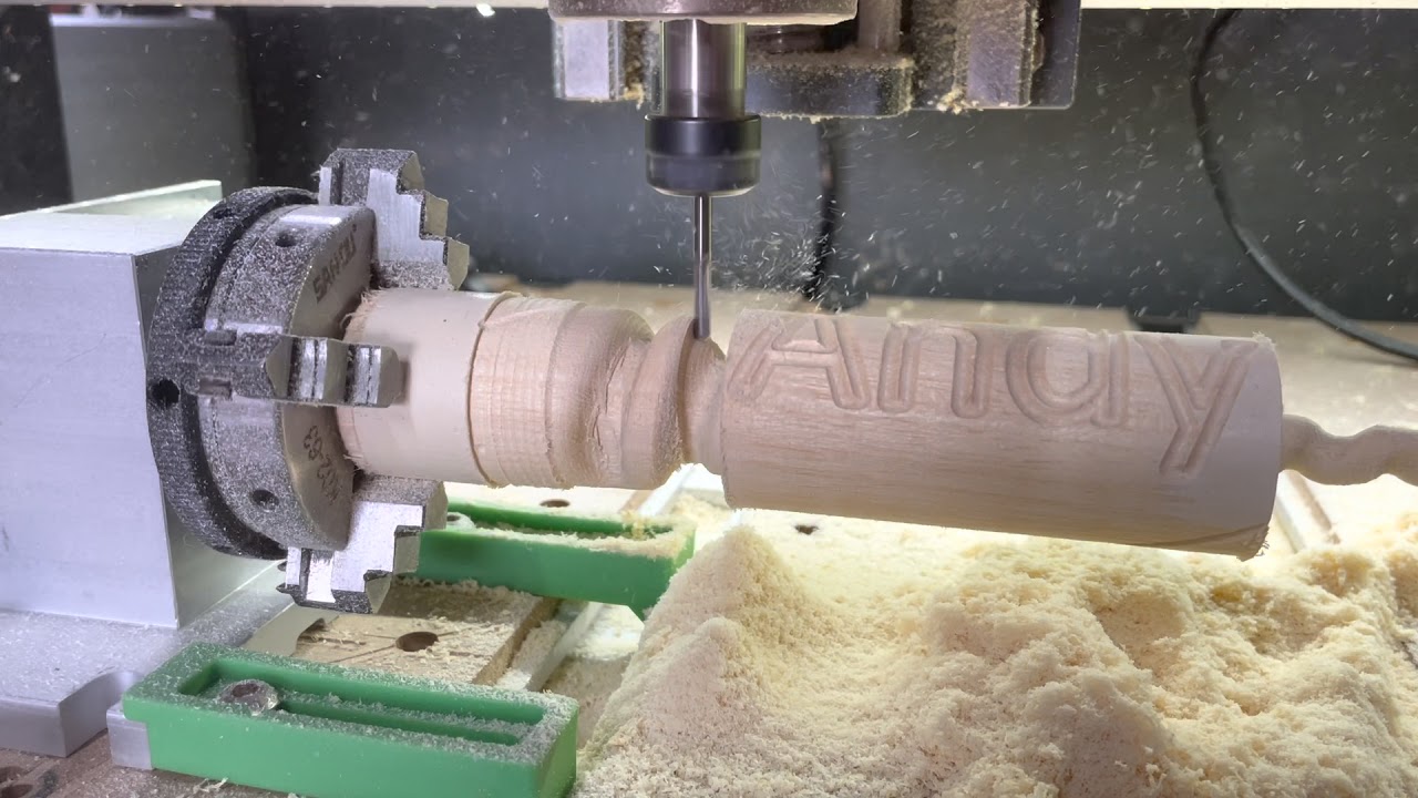

Closing the gap between my 3XL and the newly announced HDM… 4th Axis on my 3XL HDZ
It’s a very deep rabbit hole, but I’ve got it fully up and working. The first hurdle being that the standard electronics only supports XYYZ axes, with no spare capacity or IO pins on the controller. I researched various alternative controllers, but settled on the KeyeStudio MKS 1.2 combined Arduino 2560 and RAMPS 1.6 on a single board, hosting the Grbl Mega 5X branch of code.
Specs:
  • KeyeStudio MKS 1.2 Arduino/RAMPS Controller board, 6 channels plus the usual limit sensors, PWM, probe IO etc
  • Step-Stick 2209 drivers x 5
  • Power supply 24V 15A with fan cooling
  • Grbl Mega 5X branch of Grbl uploaded using Arduino IDE
  • ā€œfrom Amazonā€ 4-jaw spindle with Nema 17 driver and 4:1 belt drive gearing
  • Aluminium case for the electronics with miniature cooling fans
  • Universal G-Code Sender (UGS) with ABC axis enhancements (hopefully due to make 2.09 release)
  • Existing Huanyang VFD with 800W water-cooled spindle
  • Fan water reservoir/cooler with modification to engage the fans only at 28c
  • Laser cross-hair XY zero ā€˜pen’ ā€œfrom Amazonā€ enabled from a spare IO on the controller
Video of the axis running, making a test piece:
The electronics need to be tidied up… but hey, it’s all working

Wow very nice. I can’t help but wonder if there is interest in a custom controller board that fits in the existing enclosure but adds an extra stepper as well as a separate PWM output for laser, and anything else that can fit.
That’s awesome! How much does a setup like that cost?
@ctdodge About $250 all in, plus self-time putting it together and configuring Mega 5X, and contributing to the UGS code development. Will itemise the costs when I get a moment
