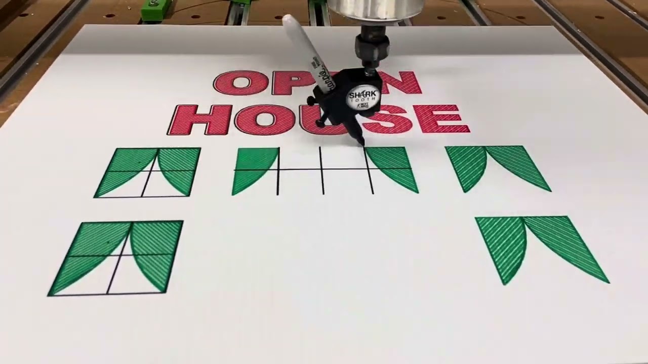

I did a couple more Coroplast items. After this I promise I will shut up and go back to doing “real” CNC work.
First was an Open House sign as a proof of concept for a sign shop.
Video on the process is here:
In short, I used the Shark Tooth with various colored Sharpies and then the SST dragknife to make the cuts. I won’t lie, this was try #2.

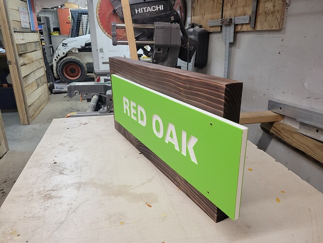

This is my first project. It’s a new top rail for our porch bench. French Satee cut Red Oak with inlays. I also used a round-over bit to radius the profile (front side only). A 60 degree “V” bit was used to make the profile groove. I did have trouble trying to make the v bit work for the inlays so I used a 1/16" two flute end mill to do them. I’m thinking about an epoxy fill for the inlays. Since I’ve never worked with epoxy inlays, I will probably make a test piece using some scrap MDF
