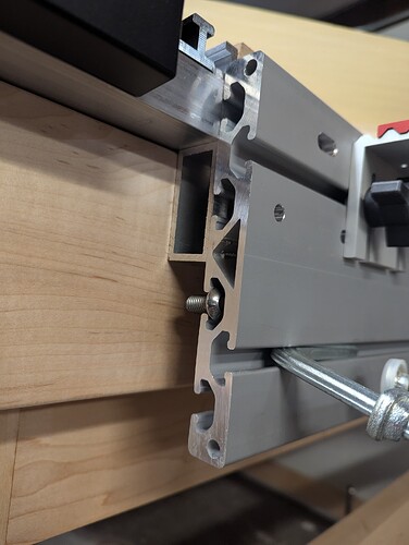

This is what the underside of the slat looks like:
The whole thing is siliconed down to the Aluminum extrusions for the Hybrid table. Makes switching them out a bitch, but it gives plenty of airflow.
Thanks for the detailed photo, so silicone seals the spoil board down to ensure it’s sealed and the vacuum pulls thru the MDF itself. Really nice setup!
Yep. I used “Light Weight MDF” which I guess is the name for LDF in the US. I had to pick it up from a specialty cabinet supply place. I also painted the sides of the LW MDF to seal it so all the vacuum is coming out the top.
@CthulhuLabs
Makes sense, thank you again.

MDF (especially the light weight stuff) is porous. The vacuum pulls a vacuum in chambers inside the MDF which causes the air on the surface of the MDF to be sucked down as well. That in turn sucks down on whatever is sitting on top of it. It is the same way the MythBusters lifted a car with a single shopvac.

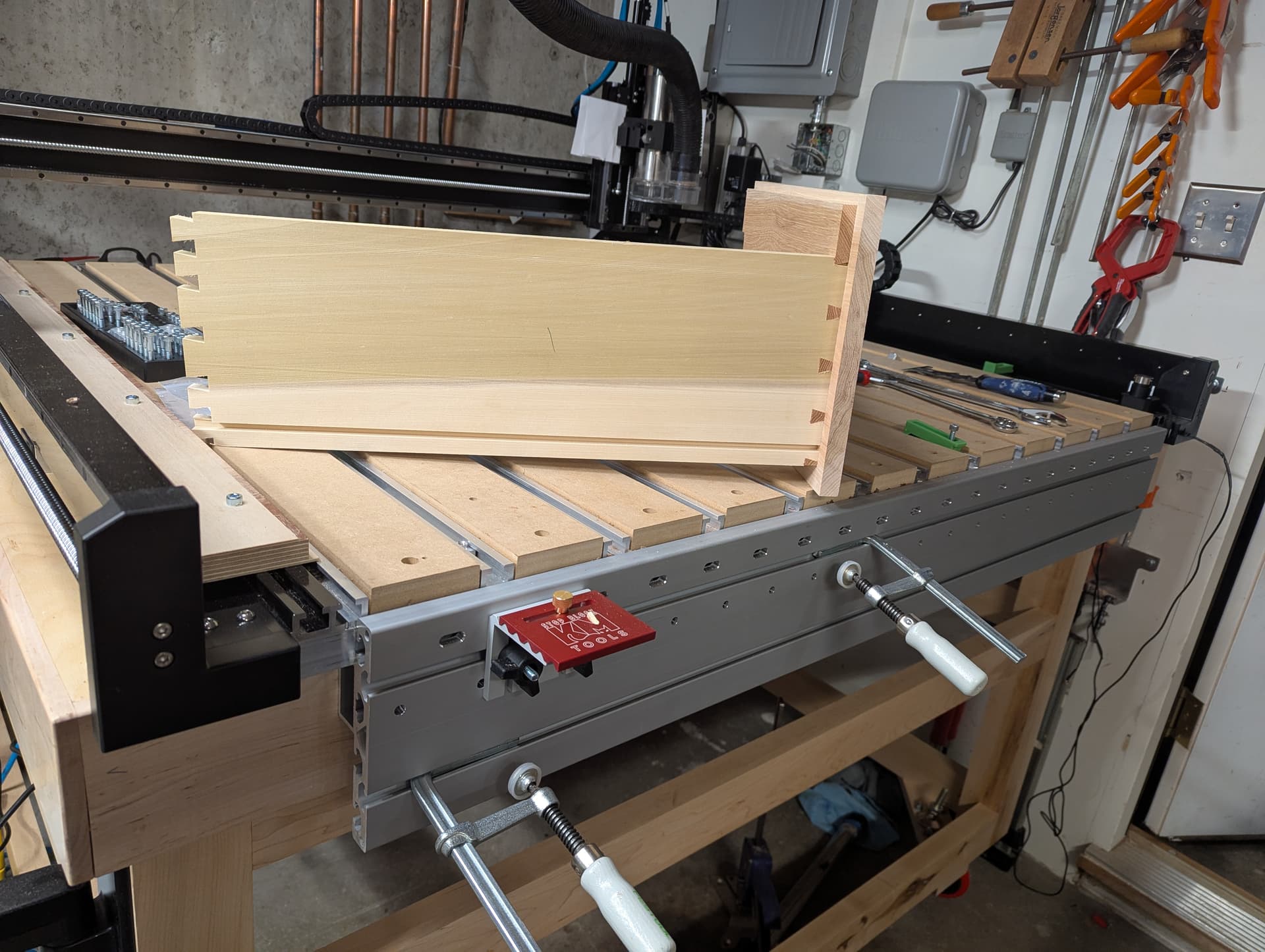

Hi, Nathan. Very clean and interesting idea. Reading through the posts, I don’t understand where you say “added an aluminium tube.” What kind of tube, how did you added it, and the source, please.
Also, will you tell me how you attached the fixture to the SO?
Thanks so much for sharing this great idea.
Regards,
Allen
Hi Allen, I have a close-up photo with a short explanation here
The 1x2 rectangular aluminium tube that sits in the corner of the Shepeoko and 80/20 extrusion comes from OnlineMetals.com Part #: 18003. If I did it again I might get something thicker and face the front and top.
Let me know if additional photos would be helpful.
