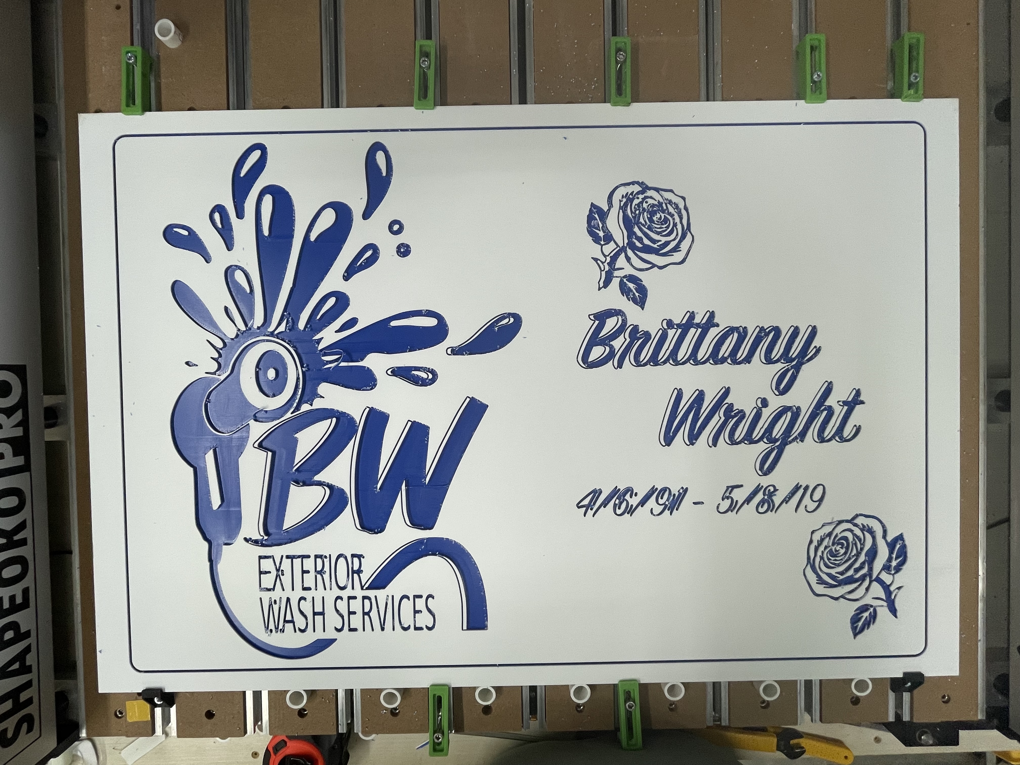

I finally got around to cutting the project I described in this thread.
All was going good until a little while after switching to a 1/16” bit and I had a shift in X. I wasn’t watching at the time so not sure what happened. It couldn’t have hit anything. The only thing I can think of was too much plastic buildup around the bit leading to lost steps or maybe some issue with the vac line but I have never had an issue with that before.
I paused occasionally to clear the bit but after I noticed the shift I paused to look and there was a a good buildup.
You can see it in the lines to the left of the words.
Naturally I had already messed up the back side because of a brain fart when setting the Y zero. I couldn’t use the BitZero on this one since the material is 36” wide so the corner was out of the cutting area on my Pro XXL.
$80 worth of 1/2” color core wasted. I can use the unmolested area on the back for some smaller projects.

Despite the issues ( oops been there), the presentation looks great !
I remember a previous thread when you were trying to decide have to handle the project.
Good choice.
Thanks. I didn’t bother cleaning up the fuzzies since it’s a waste but they would clean up easy.
I am going to analyze the toolpath for that bit and see if I can identify where it first went wrong. Looks like maybe in the handle for the pressure washer nozzle but not sure. There is a lot of odd chatter right there.
Is the gcode CC generated ?

You could recut the suspect feature in the upper right corner for testing.
No, I use Vectric Vcarve for design.
Seems like the dust collector would do about the same as an air assist but maybe not.
I have done ColorCore before and tried lots of bits and settings. I posted a long thread about that back in October or November.
I tried the recommended O flute bits and low RPM with high feed rate. I found that the venerable #102 from Carbide 3D gave me the best surface. I use 8000rpm and something like 60 feed rate. I know that bucks conventional wisdom but it provides a smoother surface.
I use a 1/16” upcut for the finer areas.
I do not have air assist, but I am know it would put more force on the chip than a vacuum.

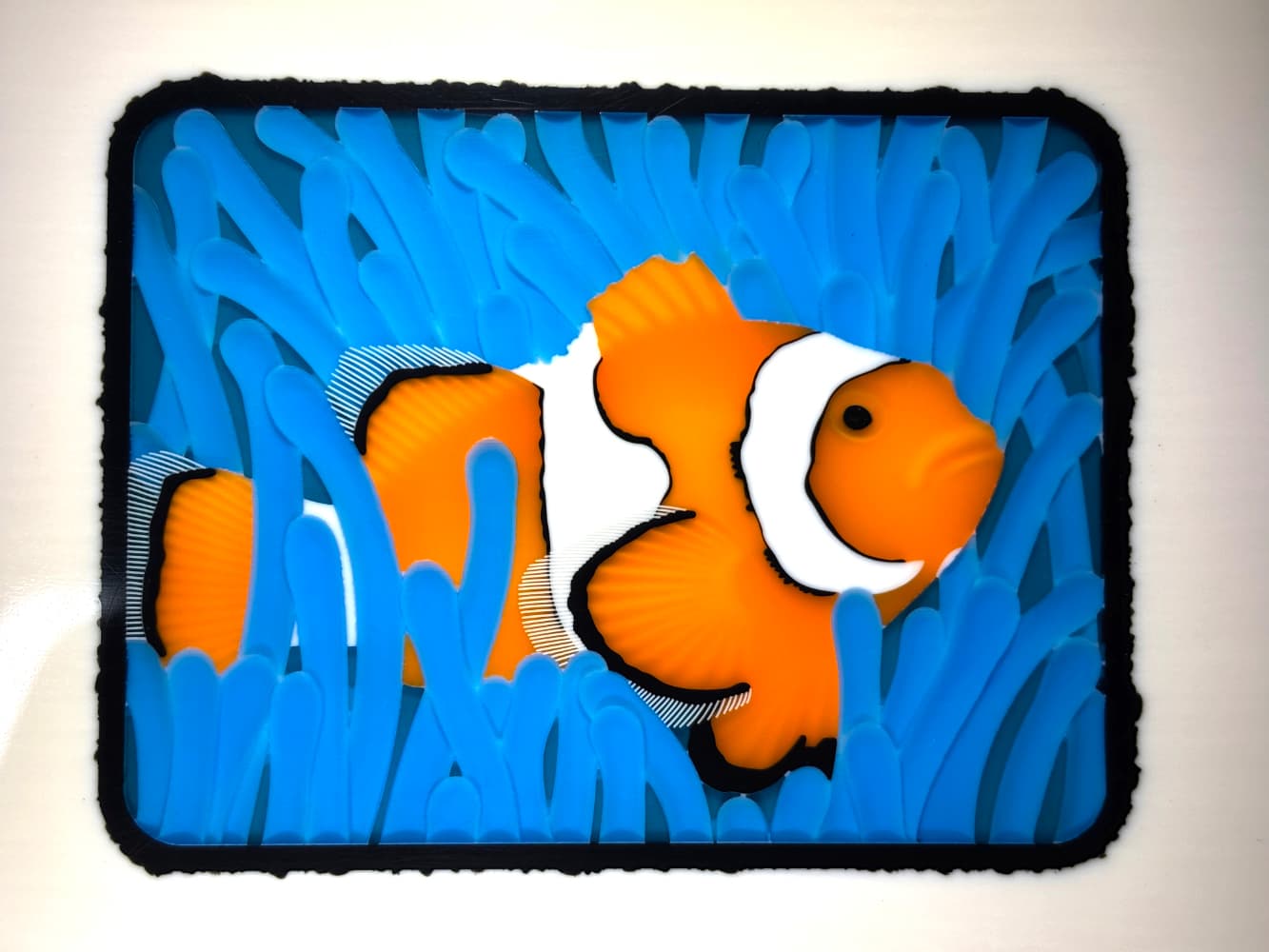

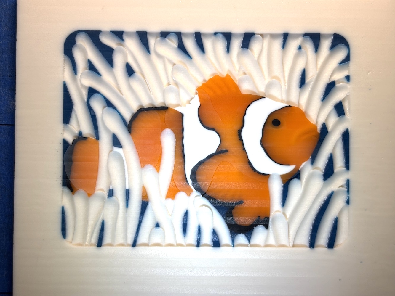

This is about 65 mm high, will be cutout and inlaid into a box. It’s a new medium for me. This is done is several steps, by color, each taking a day including time for the epoxy resin to set. Some steps are simple pocket cuts such as the white and black. The black was done before the white such that the black pockets could be cut fat enough for a bit but the white overlaps so the lines end up thin.
The orange and blue are done another way. They are 3D carved into the substrate:
So the details in the orange are due to differing depths of the semitransparent epoxy. This is tricky as it is dependent on the depth of the cuts as well as the density of colorant in the resin. The heightmaps were created by hand in Affinity Designer.
The anemone was handled in a similar manner:
The engraving is such that the deeper parts are darker which matches reality. But this means that angled light will cast shadows opposite reality. I experimented with filling a simple pocket outline with the colored epoxy, carving a positive relief and filling with clear epoxy but this was unsatisfactory due to edge interactions with adjacent features.

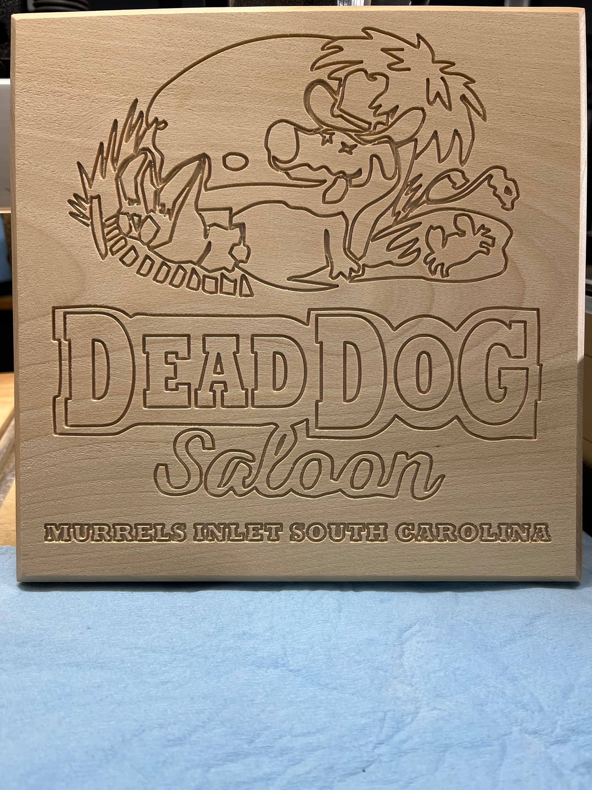

A freind gave me a coaster and asked if I could make a trivit for her daughter in law. It’s her favorite hangout when she goes south to escape our cold Canadian winters. Apparently the walls inside are covered with pictures of peoples dead dogs… hers included.
It’s 9"x9" hard maple, contour cut with a 30° V bit, 1.5mm deep and finished with butcher block conditioner.
Thanks. I should have mentioned the target max depth was 2.0 mm. I should have grabbed a pic with a single light at an angle other than above or below. The anemone takes on different appearances as the light angle changes.

Thanks! The piece is 85 mm x 65 mm. It was designed on Affinity Designer (iPad) including the heightmaps. All tool paths and gcode were created with CC Pro.

Can you post a bit about your process in Affinity Designer? Are you starting from a standard image and blurring?

The method varies and gets more involved as I get feedback from trial runs. I’ll post separately on this later.
