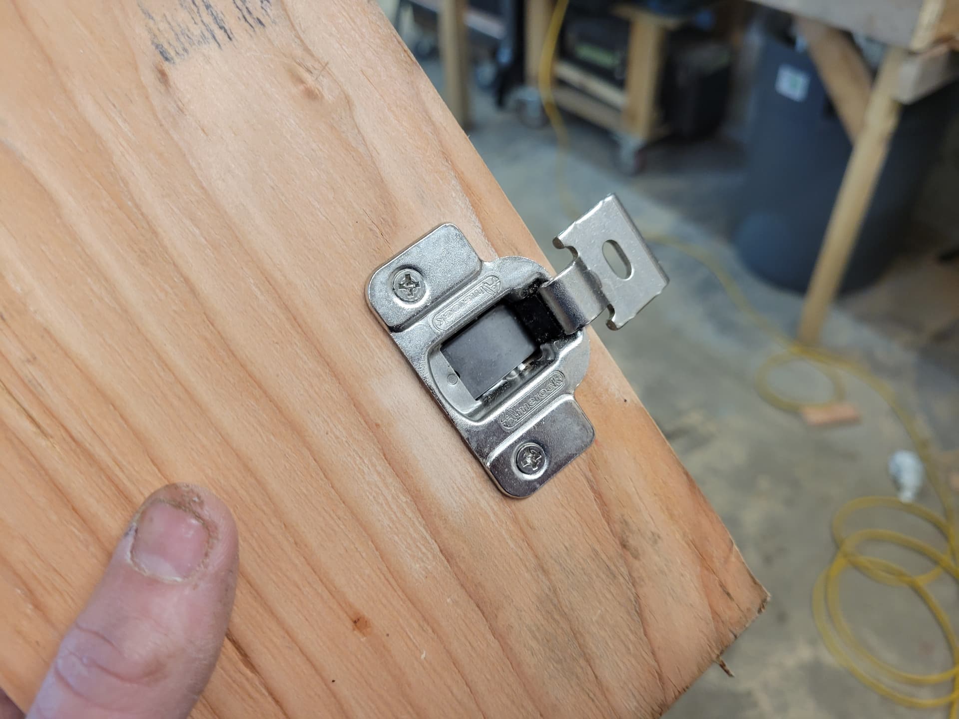

No need to buy the jig. Maybe 5 min to design, 1 min cut.

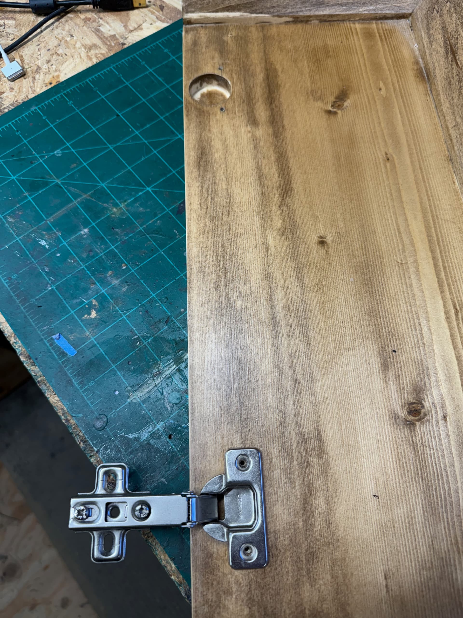

I did the same thing a couple days ago. The template that comes with those hinges makes it easy to draw up.
They make a jig for that? I always just use a Forstner bit to drill a hole. I guess people really will buy anything.

Unless I’ve completely misunderstood what Ed and Mark were doing the hinge is just a single hole. I want to say 1 3/8th inch, it something in Metric, but I couldn’t find any metric bits locally. A drill press and a ruler to mark the center point is all it needs. If it’s something more than that my apologies.

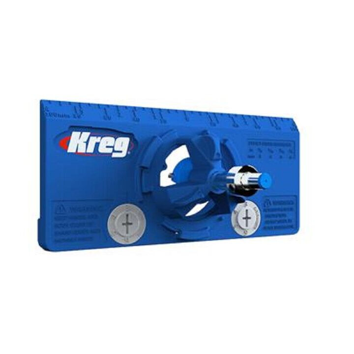

Well…I love mine:
$27.00 at Acme - including the Forstner bit with the stop collar.
Works great. Takes about 6 seconds a hole and has alignment, spacing (You can set the distance from the edge of the door), holes for the screws and everything you need. There’s almost no setup and if you’re hogging out the holes for a cabinet’s worth of hinges, this is the easiest solution out there for repeatability at this price-point.

I have the same jig, time is money. And knowing that it will be done right everytime is good. For everything else, there is mastercard.
I have the Rockler one for making the holes for European hinges. One of the first holes I drilled I came almost all the way through. It was just a cabinet door for the shop so the hole is still showing. It is a reminder to NOT DO THAT. Live and learn.
I own that same Kreg jig and without a doubt, it is a quick way to get those holes made, especially when you have a bunch of cabinet doors to hang.
My son-in-law also like it. In fact, he likes it so much he took it home with him last fall and I haven’t seen it since.

Noe taken, but I can’t speak for other folks who might? Yes just a few tools that allot of folks may not have or be able to afford, such as a drill press you mention. It’s also hard to convey the tone of a comment in black and white print on the internet. I’m fortunate to have a small drill press and the bits to do exactly what you say. I also purchased the Kreg jig for the hinges, it’s faster and consistently more accurate to us than using the ruler, center punching and drilling. Plus it aligned the screw holes.

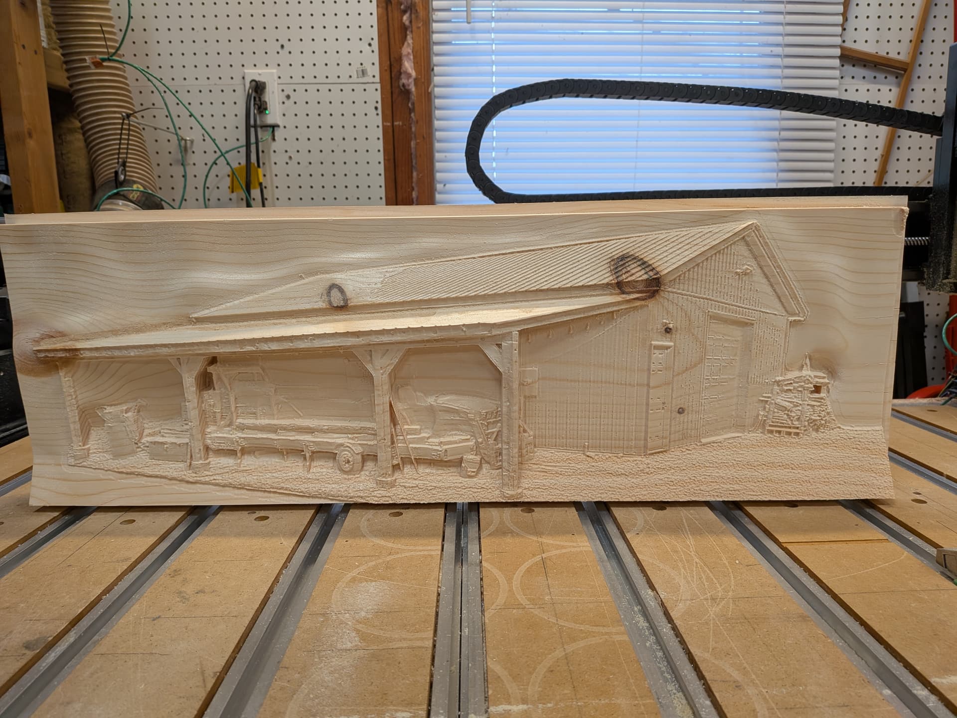

This weekends time consumption device. Learned to use Cody’s skinny Jenny. Nice.
@jtclose Nice work Jim! did you use the image to relief app to create the STL?
Yes, I used @xenith app. This is way too much fun, without much pre work.
The biggest issue I have is finding a good Z height to canvas size.
Seems 1 Z unit to 15 XY units is in the ball park.
