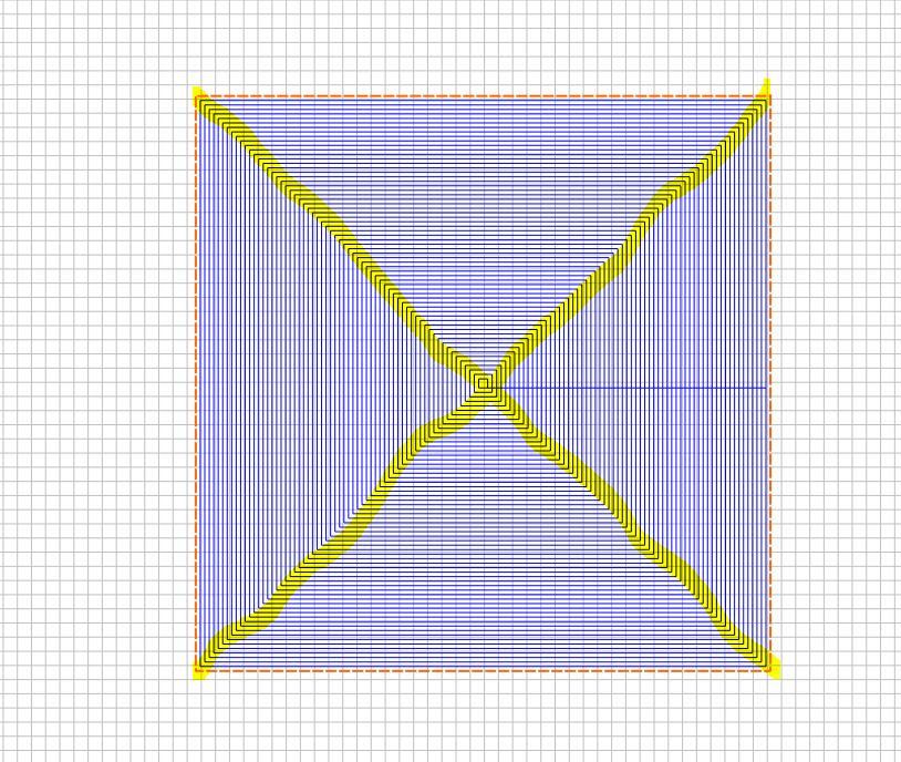

I suggest using a .25 EM and using a Raster Toolpath.
If you choose an offset toolpath on a square, you end up with an “X” on the board due to the corners. It’s very faint, but this will require a lot of additional sanding to remove.
If you use a McFly, then I suggest using a lead-in and doing a manual Toolpaths.
1st step is to measure your Board. Then, create a Line that is wider than the board by 1.25 times the size of the Bit. McFly is 1" in Diameter, so extend the Line 1.25" past each side of the Cutting Board.
Next, open the Array function, select the line. Assume a .5" offset, so take the length of the board in inches and multiply by 2. For mine, I used an 8x8 cutting board, so I set the number of Rows to 16 and the number of Columns to 1. Spacing is .5", select Group output and duplicate toolpath links. Now, Center the Array and set up your toolpaths.
Open the Toolpaths tab, select Contour Toolpath. Select the Array, Select the McFly Tool, set max depth to .02", No Offset, 20 degree Ramping. You should be good to go.
