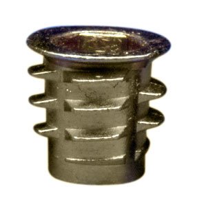

I didnt want to spin the inserts in the MDF, I used 5 on the dial and that worked.
EZ lok makes a M6 and a 1/4-20 version of this insert. (via amazon)
Cut Preview of the rear of the bed grid. the holes are 9mm and the recesses are 12mm.
The T 40 driver will work best IMO to drive these inserts.

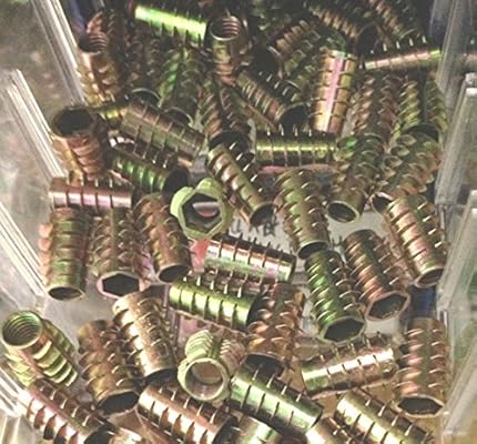

I found a packet of 50 threaded inserts for wood (M6x13mm) on Amazon;
Are these the same type that you would recommend?
Thanks!
I would get the flanged inserts if I were you. I purchased non-flanged, and every single one I put in bubbles my wasteboard slightly. I increased the size of the hole beyond what they recommend, still bubbles it.
I believe these are the ones Winston Moy used with success.
@Tem
I prefer the inserts with a shoulder.
Also those inserts look long, double check your not going into the metal braces below the mdf.
EDIT: Thank you all for the advice and links!!
I found some Metric M6-13mm through Amazon, because I have a box of M6 hex head screws already.
