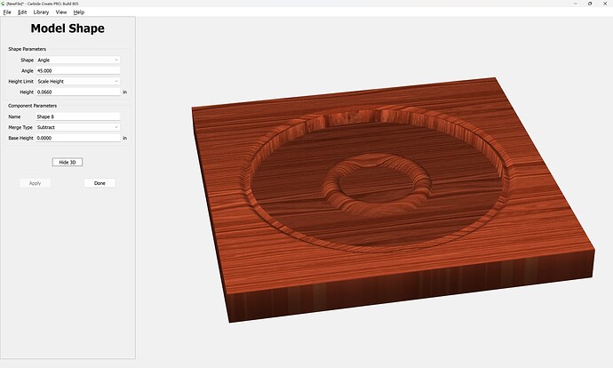

I’m pretty new to 3D modeling with carbide create V7 pro, and I’m stuck on a project. The included photo shows a square piece of trim or a ‘rosette’ I’m trying to recreate for someone, it needs to be slightly different due to new trim in their house but the profile is pretty much the same.
I have all the measurements and a good sketch of the dimensions. My question is how to 3D model this piece with each part of the design being a specific thickness. I understand how to make a grayscale image to carve in 3d, but not how to make each point in the design a specific height or depth to match the thickness of existing trim. Is this possible? And would a greyscale map be the right way to go about modeling something like this? Thanks for any advice you can give to a newbie.

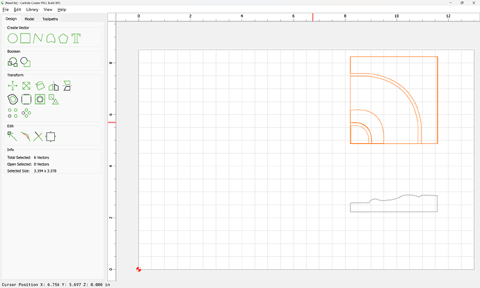

I’ve learned a lot from the links you posted, thanks! Can you elaborate on what it means to model it in a full circle? I drew the profile and played around with modeling tools and now seem to be stuck. I’m uploading my file so you can see. Thank you again.
3drosettereal.c2d (64 KB)

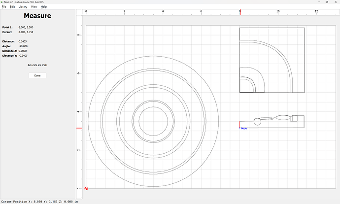

Get the overall measurements:
and start by drawing a circle of that dimension:
Then measure each aspect of the design:
(rounding off if desired to make things easier)

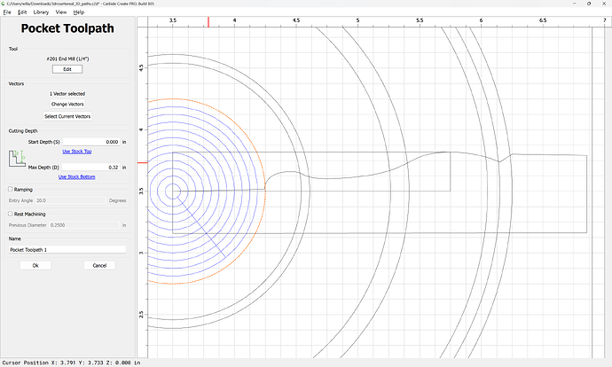

Alternately, one can just use a series of No-offset Contour toolpaths w/ a suitable array of tool profiles to just cut the design more directly…
The flat regions are quite straight-forward:

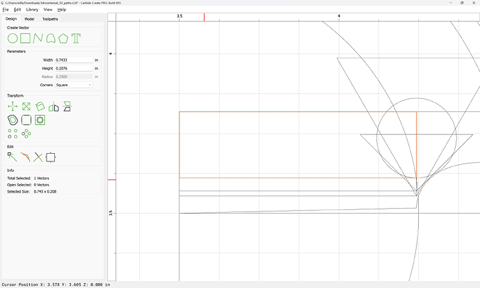

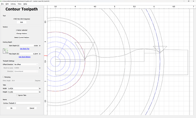

Similarly, the angled region is easily done — draw the tool up in profile:
and measure how deeply it needs to cut:
which last technique is then used for the balance — draw the various V and ball-nose tools which one has available in profile, then position copies of each relative to the profile and determine how deeply one must cut along each circle as noted in the afore-mentioned links.
Repeating this until one arrives at the desired result.
Here is a beginning in CC v8:
3drosettereal_3D_paths.c2d (76 KB)
