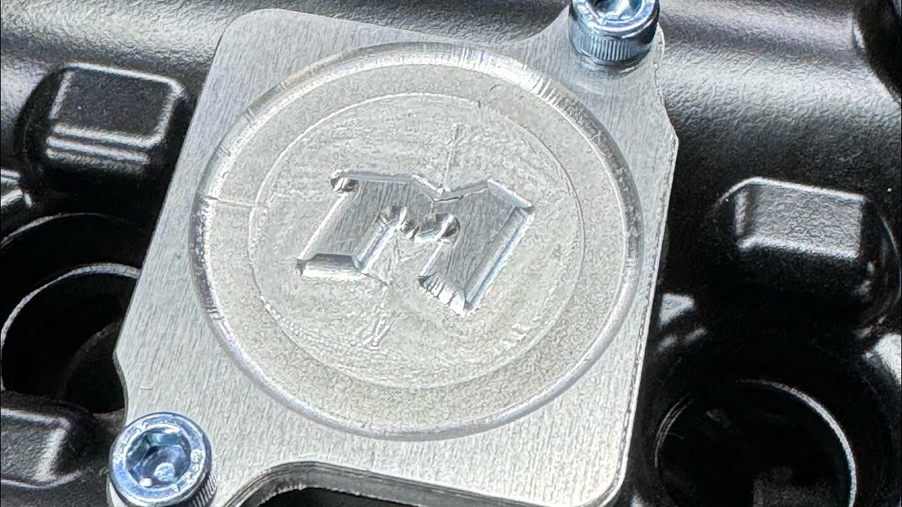

This pic is on the laser, but I cut this last night out of 3mm aluminum sheet.
Otherwise I cut plates and extrusions for people fairly often.
and then brass for leather stamps. which also gets a v bit added into the mix.
I do use a spindle, the noise of the router got to me for long cuts. and the whole workflow and letting gcode set the rpm for me is just much nicer.
