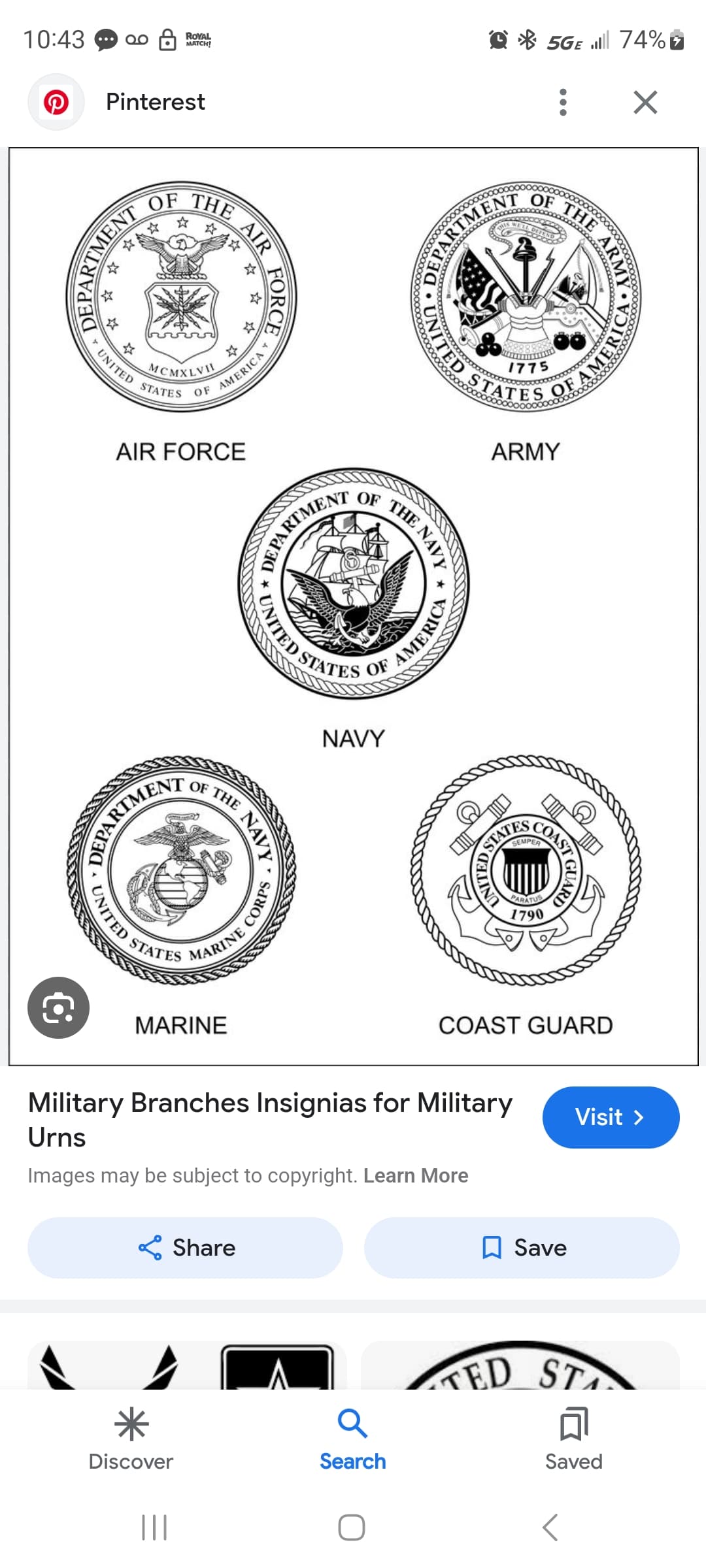

The air force, army and navy circle logos
These are the ones.
We did the Marines at:
Various Navy things:
Army:
and also see:
As @WillAdams said some of the vectors are open. You can go in and use the node edit tool to close them up. That is tedious and time consuming. If you decide to fix the vectors the zoom feature is your friend.
