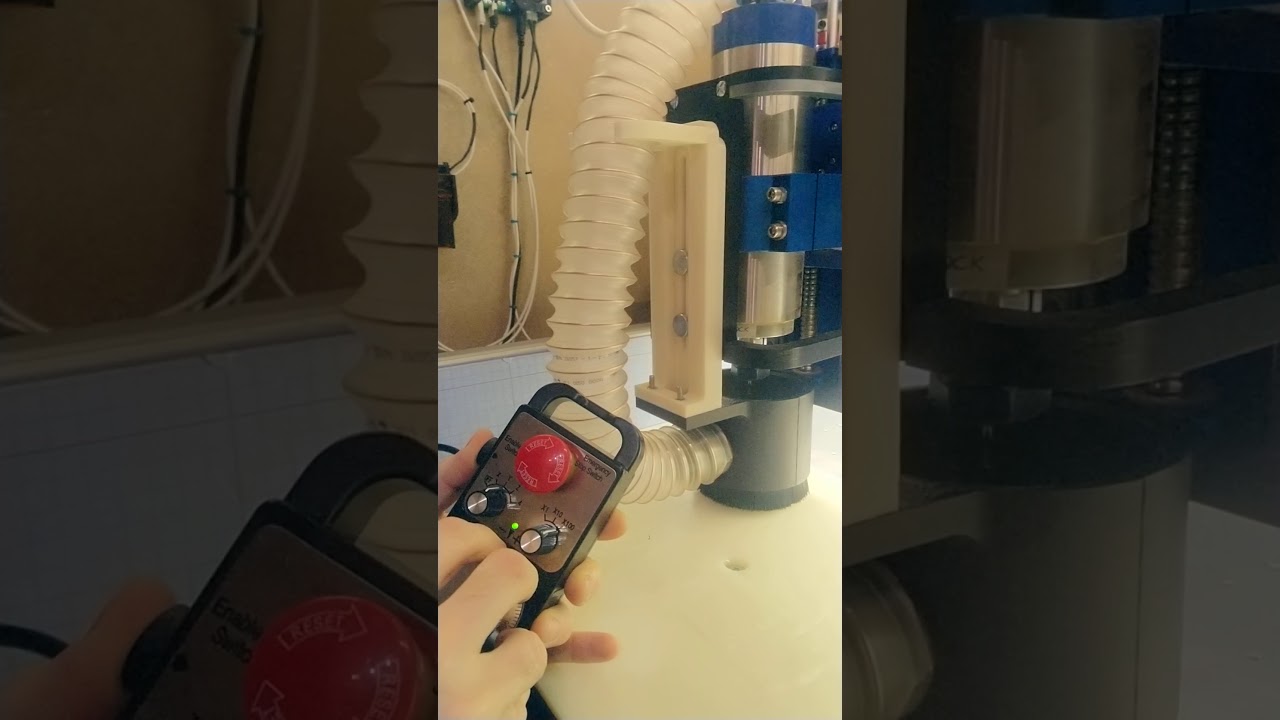

Recently I was inspired by this post (thanks @npross!) and bought one of these pendants that have two multi-position switches, a handwheel, and an enable pushbutton
This post is intended to document how I interfaced it with the Shapeoko, in case anyone wants to make a similar setup. This is completely overkill if you just want to trig predefined keyboard shortcuts on your favorite G-code sender, a USB or wireless keyboard will be much simpler to use. But I wanted to have the ability to map the pendant controls to run arbitrary G-code snippets on the Shapeoko.
The pendant I bought came with a wiring sheet, which spared me the effort of figuring out which wire corresponded to which part of the pendant:
(the Aliexpress link to this pendant is in the original post, but there are many variants of this around)

Next, I connected the pendant wires to the Pi like this:
Left column from top to bottom
pin 9 / GND
pin 11 / GPIO17 = X
pin 13 / GPIO27 = Y
pin 15 / GPIO22 = Z
pin 19 / GPIO10 = MOSI = 4
pin 21/ GPIO9 = MISO = X1
pin 23 / GPIO11 = SCLK =X10
pin 27 / GPIO0 = ID_SD = X100
pin 29 / GPIO5 = EStop
Right column from top to bottom
pin 2 / 5V = handwheel power supply
pin 8 / GPIO14 = TXD = A
pin 10 / GPIO15 = RXD = B
pin 12 / GPIO18 = PCM_CLK = LED+
A few notes on the pendant signals:
  • 5V is used as an input voltage for the internal handwheel mechanism.
  • the “A” and “B” signals are connected to the handwheel, and allow one to determine when the wheel is turning, and in which direction. They are supplied by the 5V input, but a Raspberry Pi has 3.3V inputs, so a simple voltage divider with two resistors is used to bring voltage down to around 3.3V before it enters the Pi (I used 1200 ohm and 2200ohm resistors for this).
  • the pendant has an LED, that can be turned on and off
  • the X/Y/Z/4 signals come from the left switch/selector.
  • the X1/X10/X100 signals come from the right switch/selector.
  • there is a signal for the E-stop pushbutton
  • the pendant has an enable pushbutton on the side, but no dedicated signal, it just enables/disables other signals.

What the code does is connect to the CNCjs server, and send “write” operations to send specific G-code commands to the Shapeoko (CNCjs server acts as a gateway)
The code implements this logic:
  • the enable button needs to be pushed for anything to happen. The LED on the pendant is turned on when enable is activated.
  • if wheel movement is detected
    • a short turn will trig a single jog step (e.g. G91 G0 X5)
    • a continous rotation will trig a smooth jog (e.g. by sending $J=G91 G21 X10 F2000 repeatedly)
      • stopping the rotation will trig the sending of a jog cancel command (0x85)
  • the left switch is read to determine if the jog should happen on X,Y, or Z axis
  • the right switch (X1/X10/X100) is read to determine
    • the jog step when doing a single jog step (currently mapped to 0.1mm, 1mm, and 10mm)
    • the jogging speed when doing smooth/continuous jogging (currently mapped to 100mm/min, 1000mm/min, and 5000mm/min)
Note : I implemented it all in metric units (millimeters)
For the code to work, ¨some of the Raspberry Pi GPIOs used need to be configured to activate their internal pull-up resistors, I did this by editing the file /boot/config.txt and adding this line:
gpio=17,27,22,10,9,11,0,5=pu
(followed by a reboot)
Note: input pins 13 and 19 for signal A / signal B do not need any specific configuration, as they have an internal pull-down by default, which is the right configuration for these 5V inputs.
The pendant is then installed by copying the cncjs-pendant-raspi-jogdial directory somewhere on the pi, entering the directory and typing:
npm install
Then it’s executed using
node bin/cncjs-pendant-raspi-jogdial
and then selecting the USB port on which the Shapeoko is connected to the Raspberry Pi (/dev/ttyACM0 in my case)
And voilà:

I wanted to pass along my thanks for this writeup. I now have a working pendant! The only issue i have is that I am still able to jog with the estop activated. Is that a feature or a bug?
Sweet! The e-stop button is just not managed at all in the current implementation, because I had no real use for it (since I have another e-stop on my power control box already). If you think of a useful CNCjs action that you’d like mapped to the e-stop button on the pendant, let me know and I’ll add it.
Could it be used as a feedhold ?
Yes, and that’s probably the most sensible use. I’ll update the code over the week-end to support this, I had to do an update it anyway because I changed my GRBL params to greater max speeds, and need to adjust the smooth jog message timings anyway.
