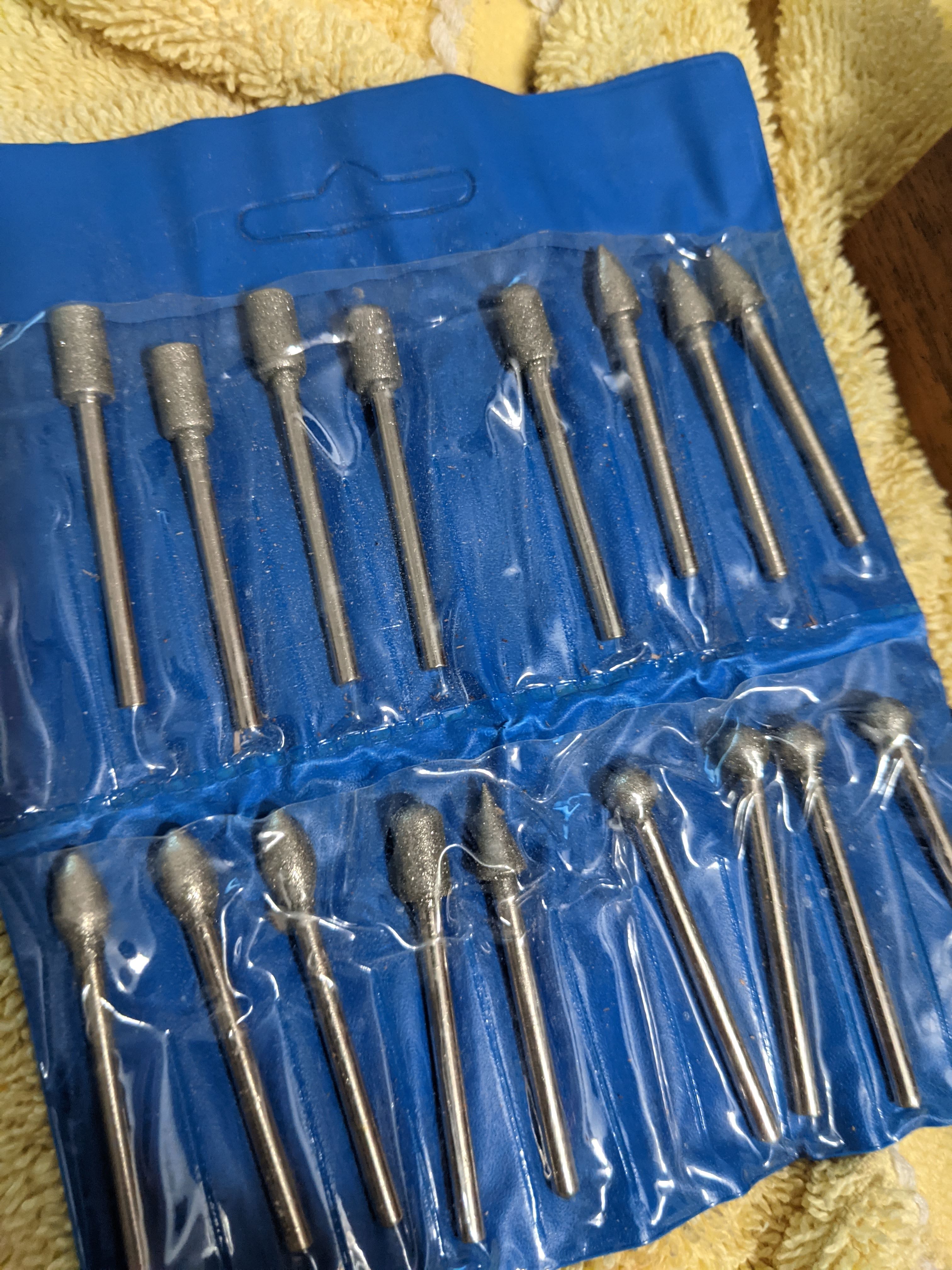

First project to sort of test the waters, as it were. I’ve wanted to do stone/marble something for a while. I know soap stone exists, and a few people have done that, but it’s soft…and also already been done.
So we have a family friend who had a dog pass not too long ago, and figured this would be a pretty neat/unique thing to give them. I went to Lowes and grabbed this marble tile piece for like $4, got a dog bone shape online, and did some fancy looking text for the dog’s name.
Here’s what I started with:
Using these tools (That I apparently got from amazon like 3 years ago https://smile.amazon.com/gp/product/B01NABXF9V/ref=ppx_yo_dt_b_search_asin_title?ie=UTF8&psc=1):
At first I was doing the vcarve on the text. Also was going to vacuum the dust:
Vacuum dust worked okay, but the bit was cutting terribly. Eventually I swapped over to the using a pipette to drop water in.
Things got SUPER MESSY
Still though, concept worked (mostly) and I got some decent brownie points from the wife which is always important. I’m going to take the machine apart and clean it (it needed it anyways), and then make a wasteboard thingie that I can submerge a part in for the next project. Main lesson learned here was water makes things go way smoother. Was running at ~30% aluminium speeds without water and the machine didn’t like it too much. With water it was comfortable at ~140% speed and didn’t sound awful. Neat thing with the water was that I could feed water infront of or behind the cut and the water would run towards the bit.
