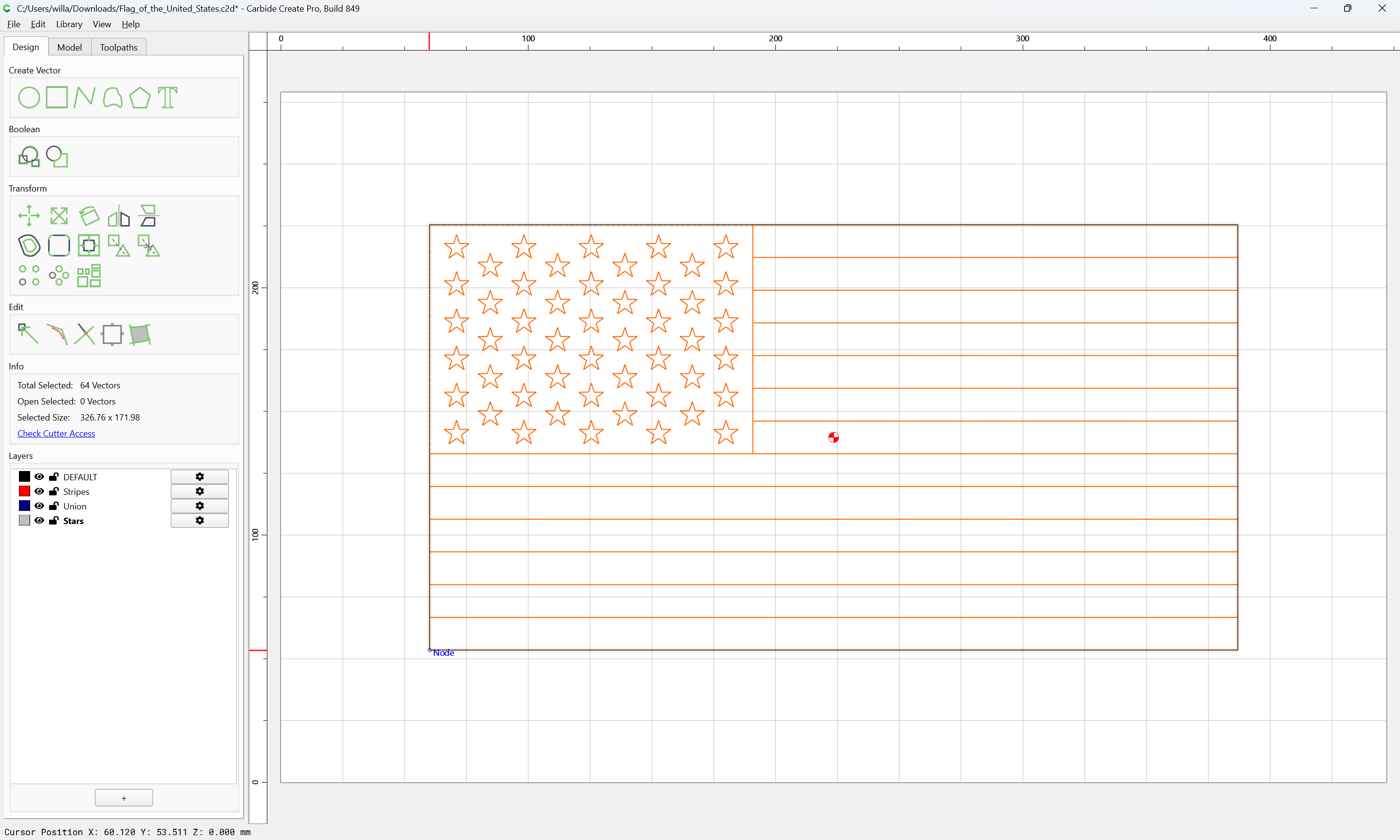

Creating a flag with superimposed design over stripes using Region Builder
as requested on support…
We will use the current beta:

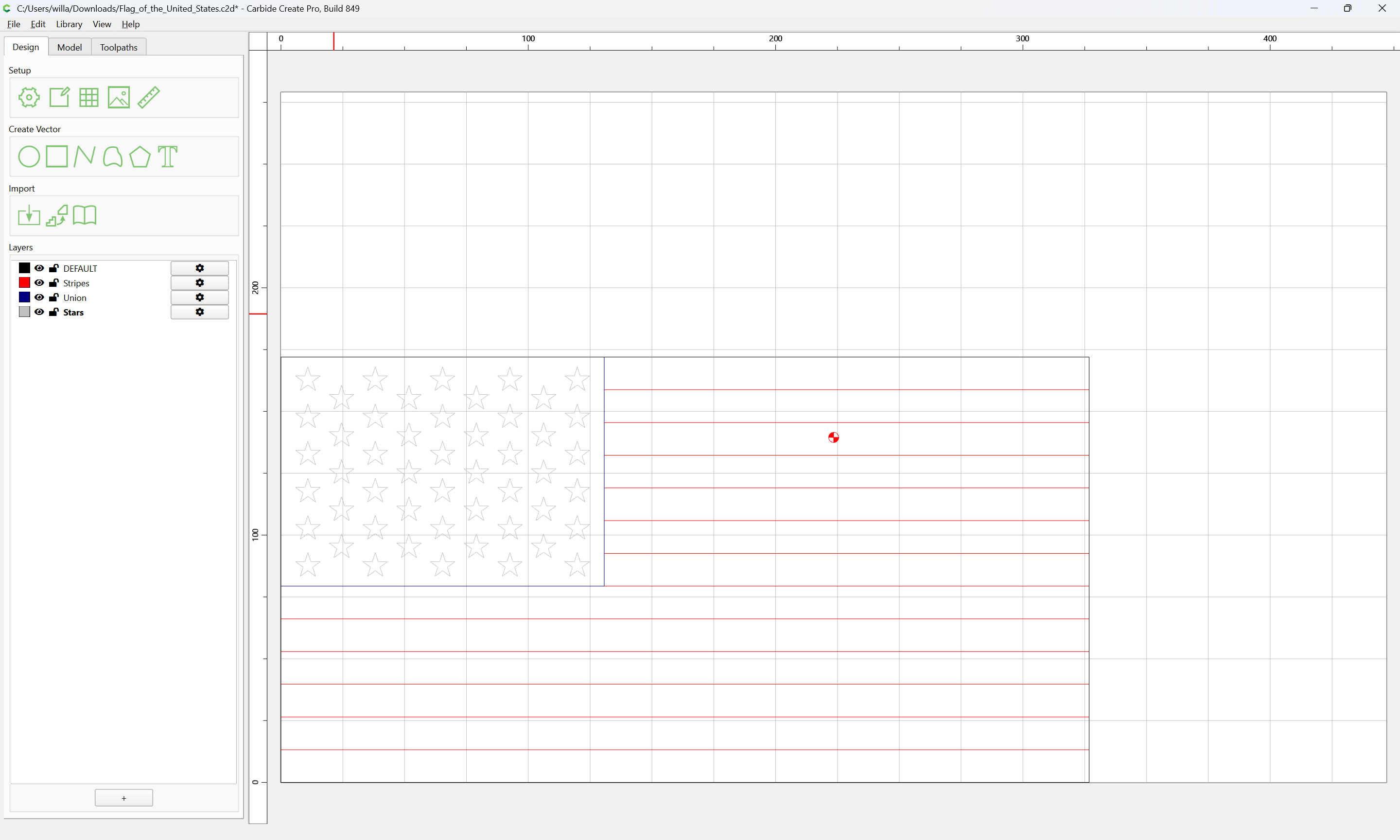

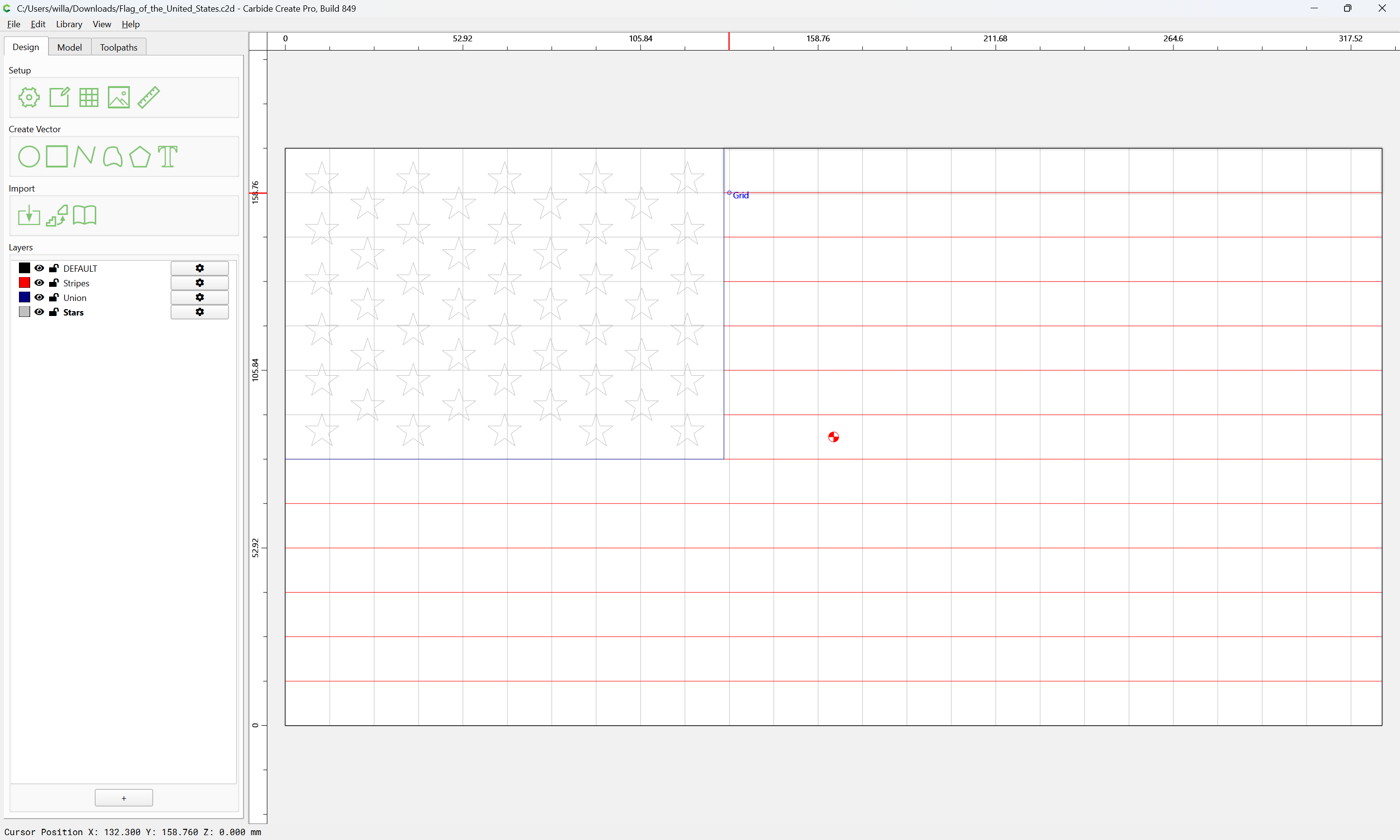

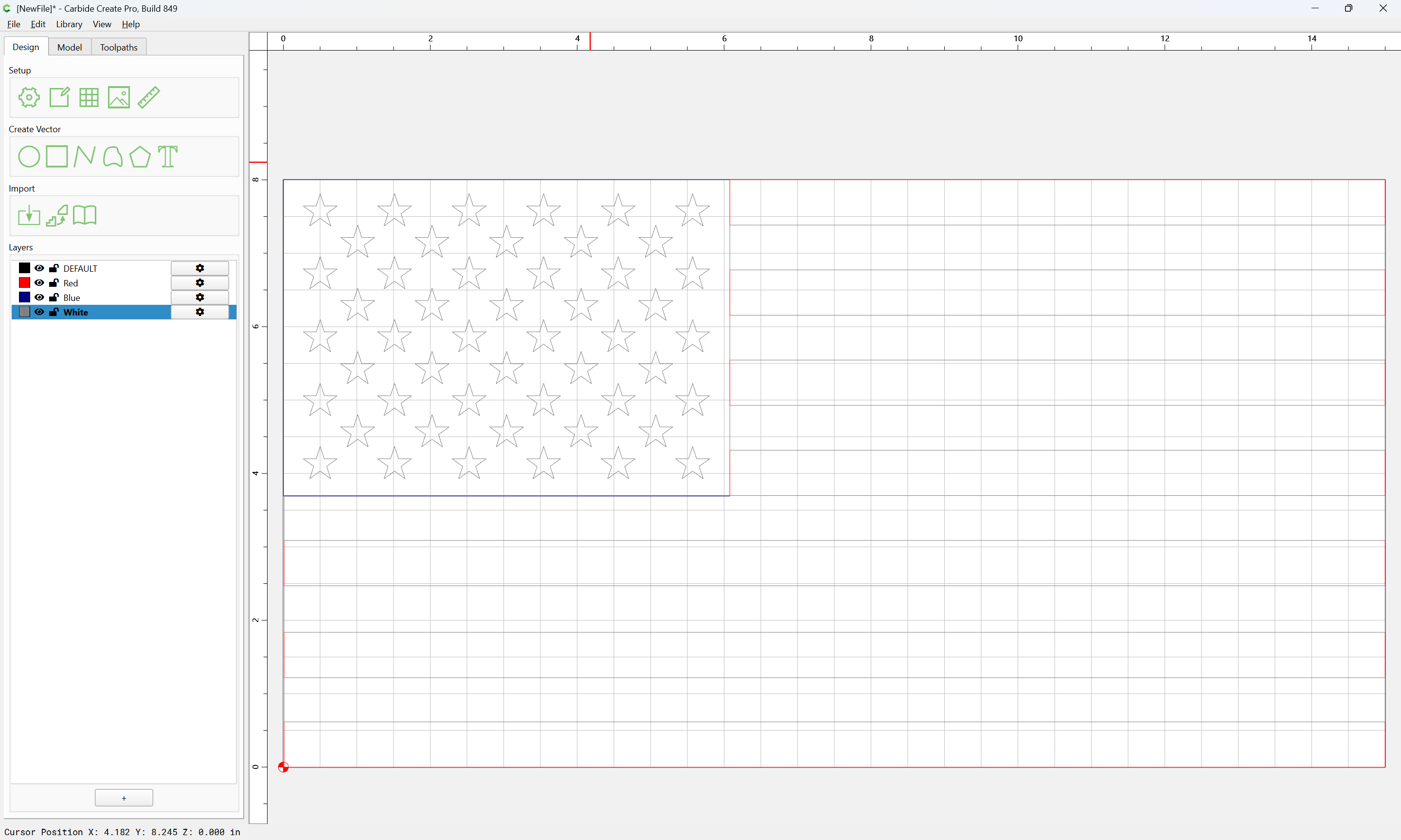

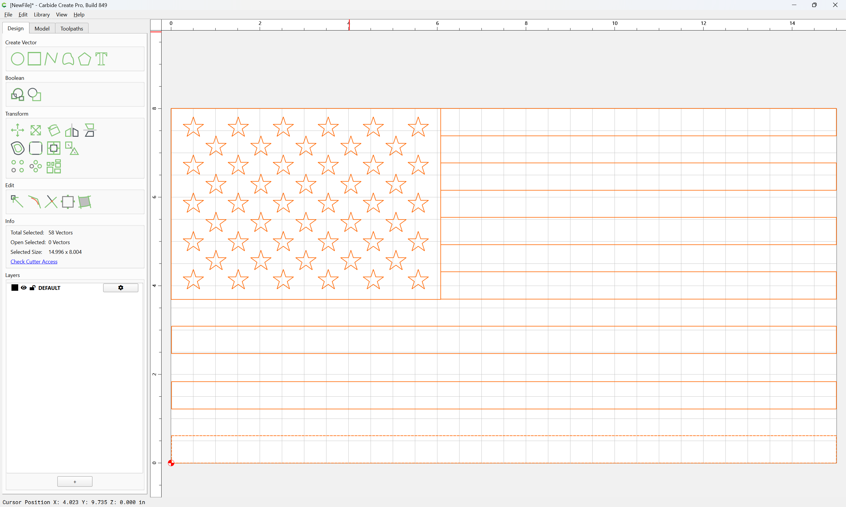

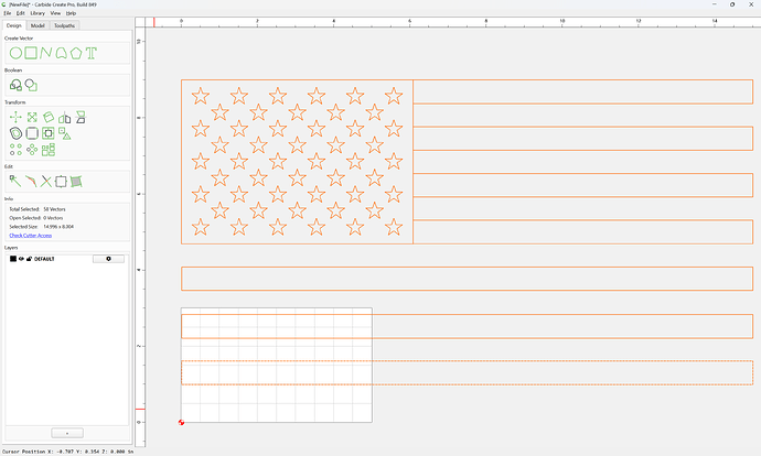

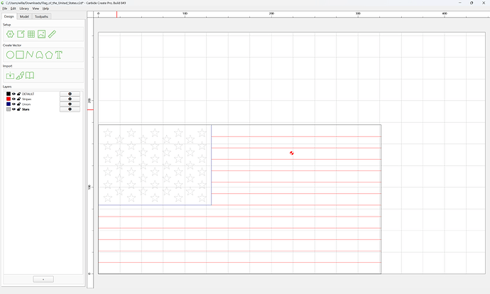

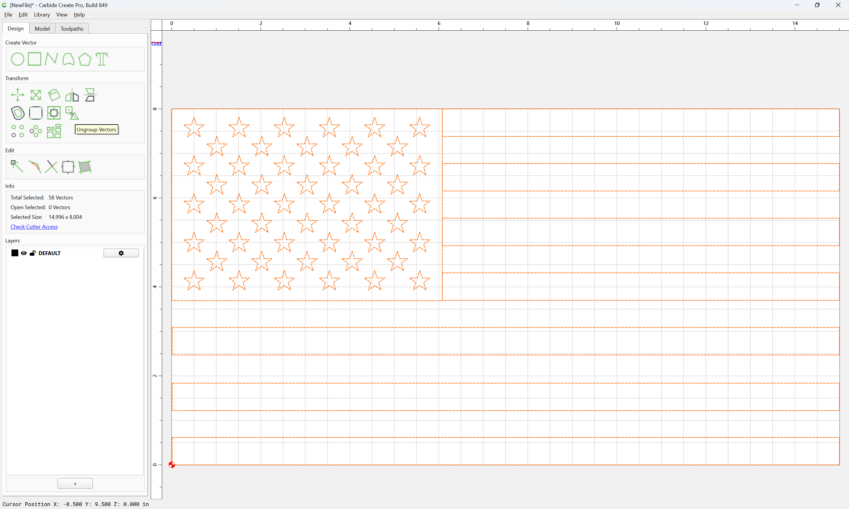

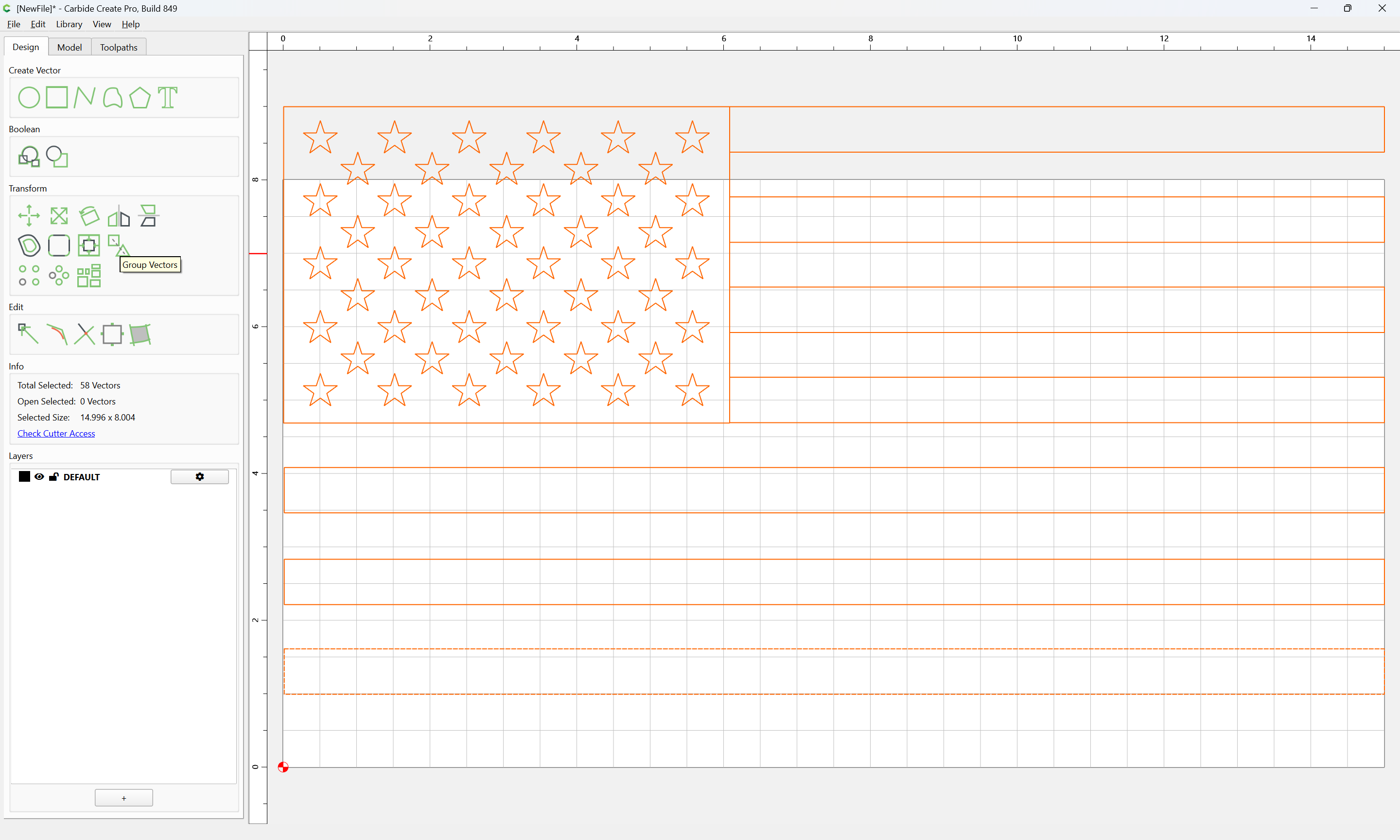

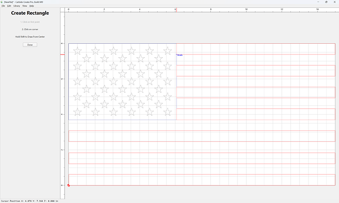

First, we import/open a flag:
https://cutrocket.com/elements/us_flags/united_states-flag
which raises the question of size, since this was unspecified, we will accept the imported dimensions after deleting the surrounding rectangle:
(the white strips will be drawn in presently)

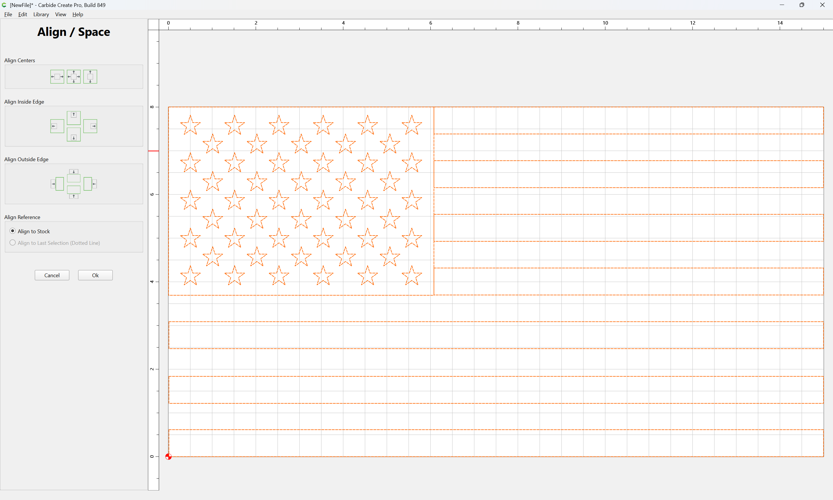

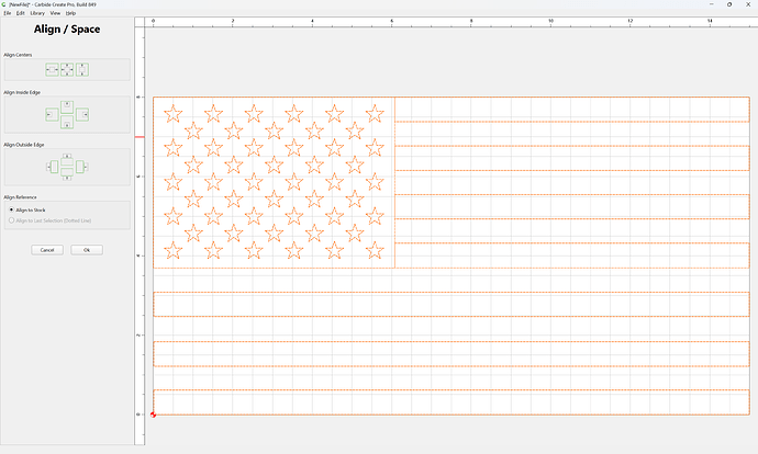

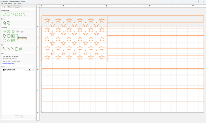

If the flag is grouped:

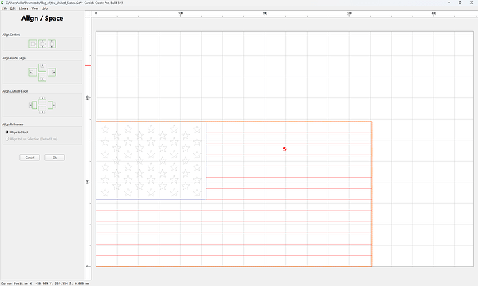

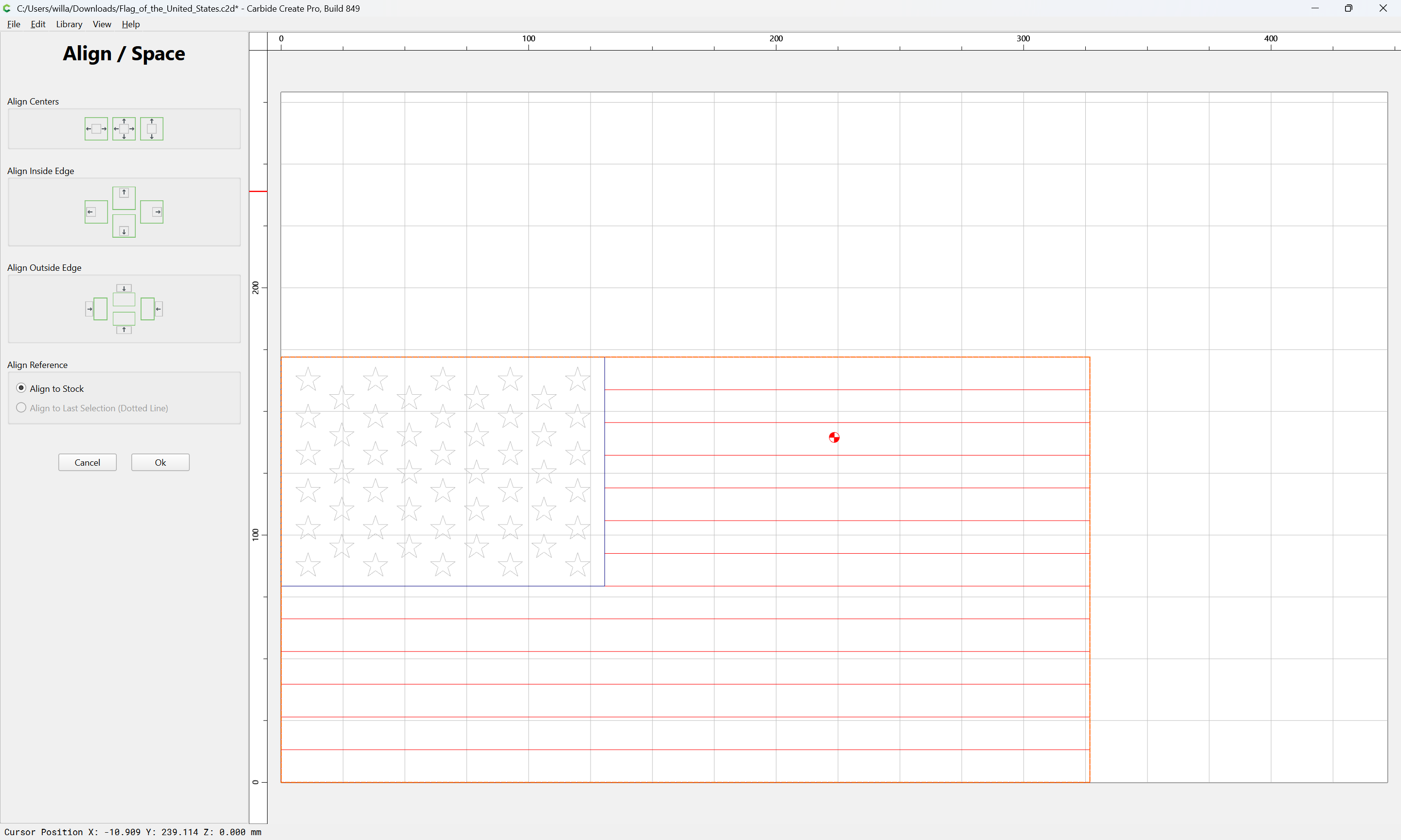

it may then be aligned to the Stock Area:
Ok
Ungroup

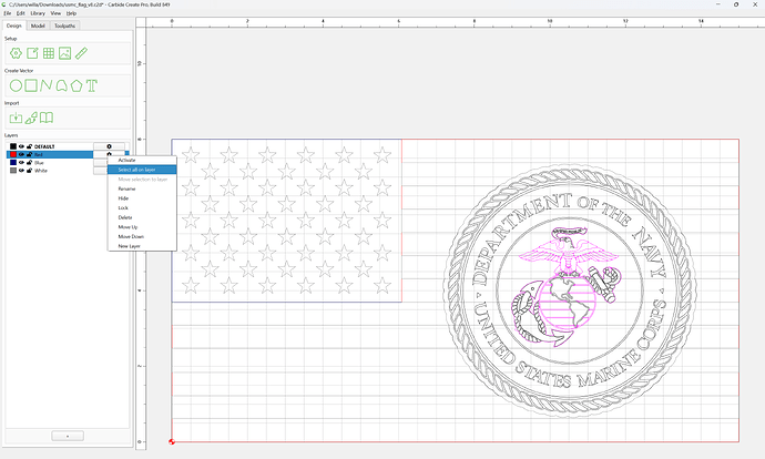

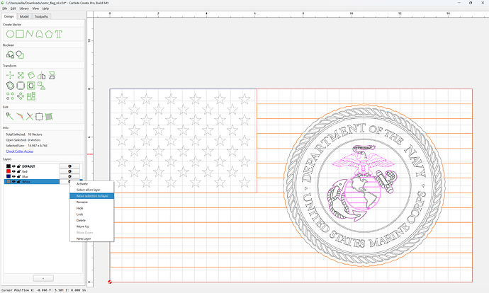

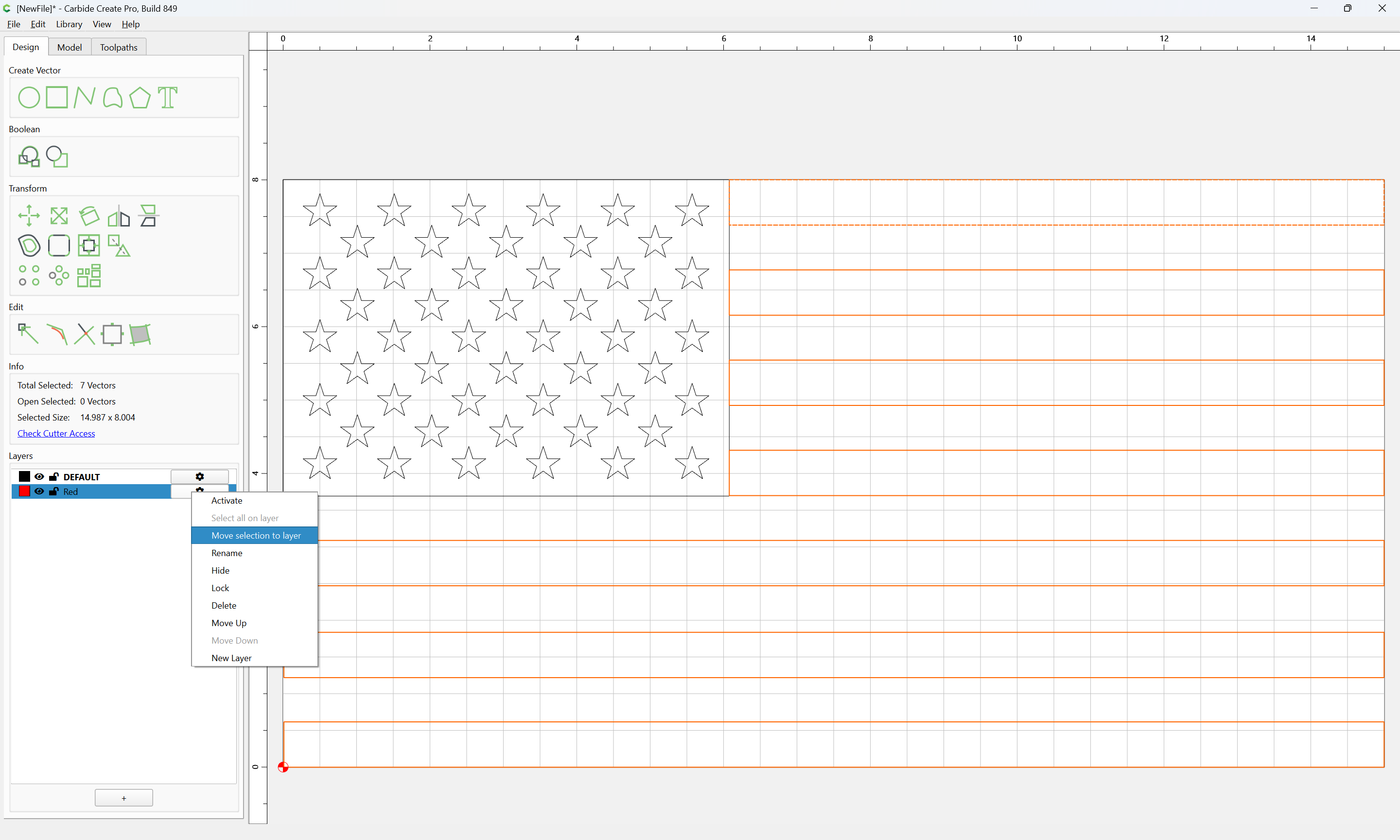

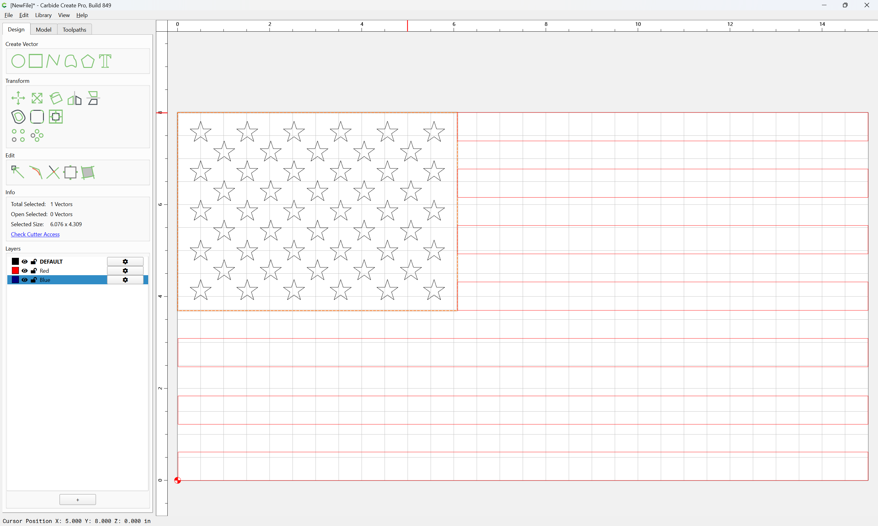

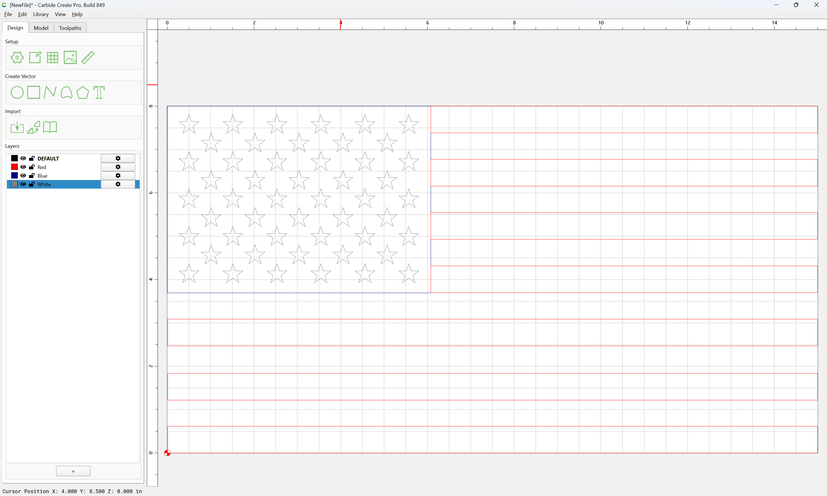

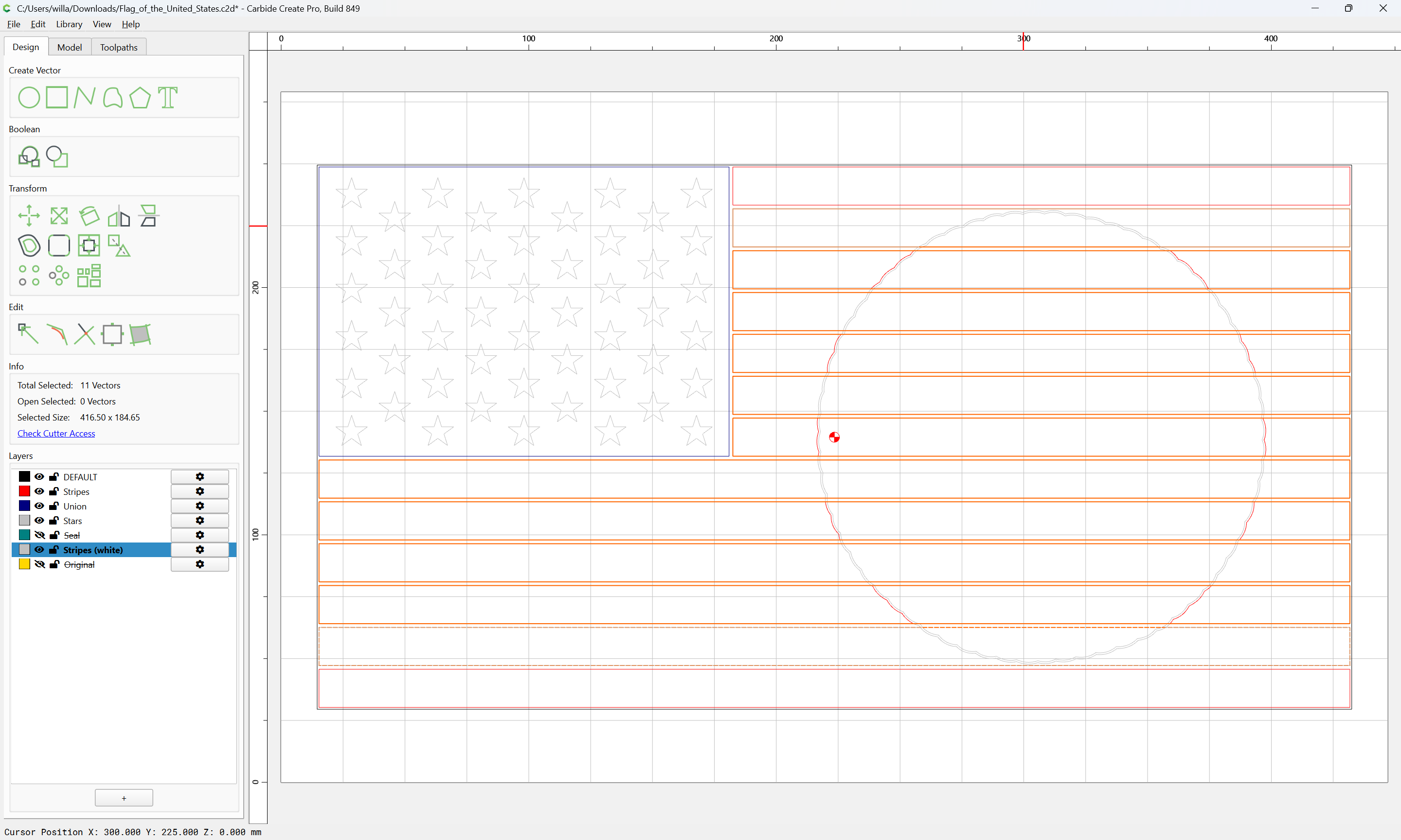

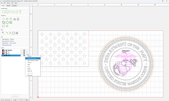

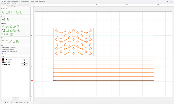

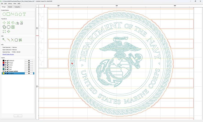

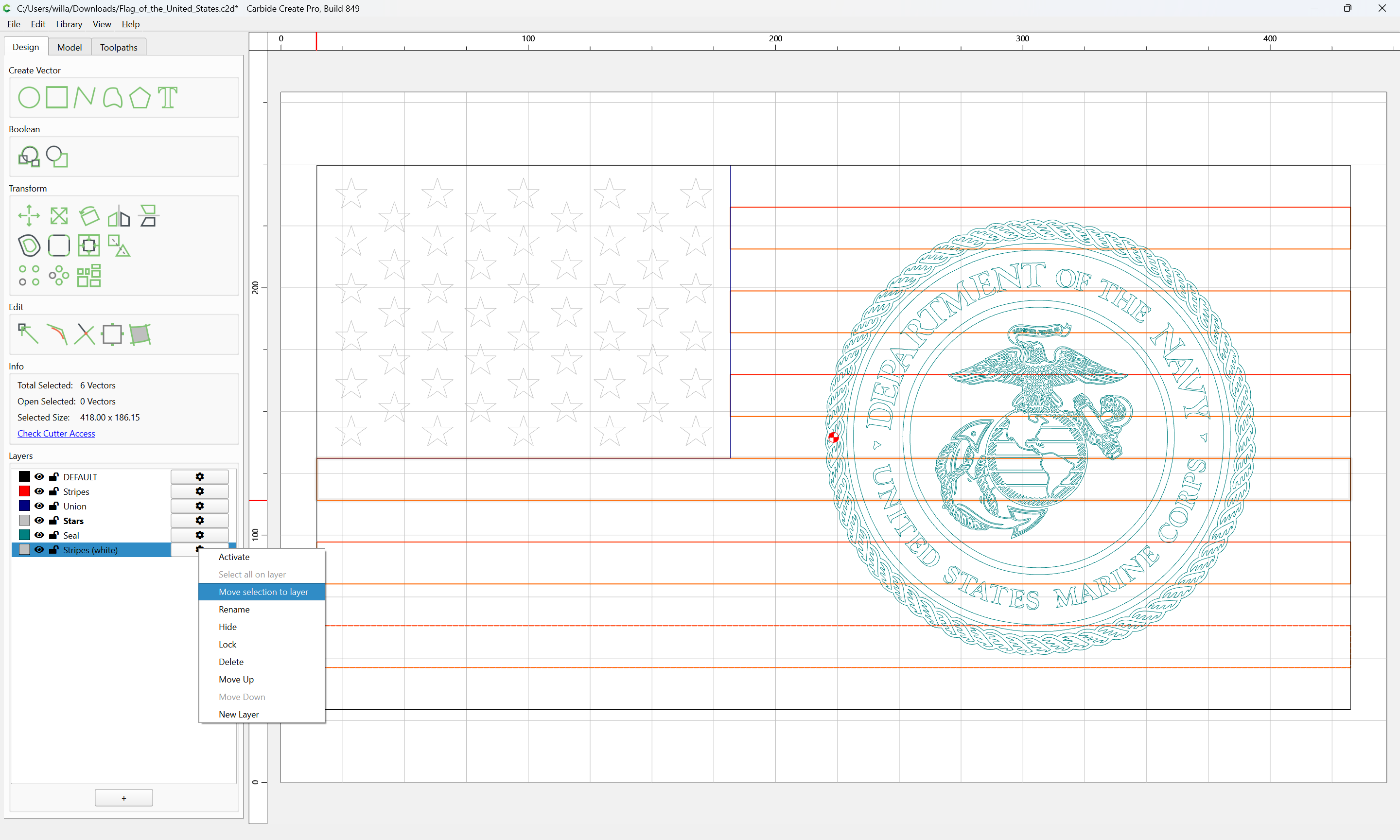

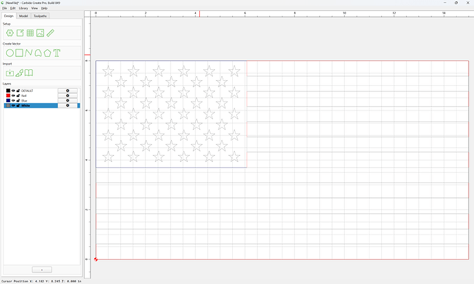

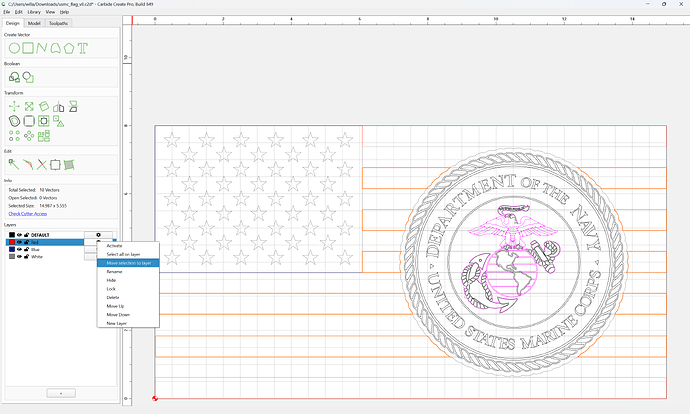

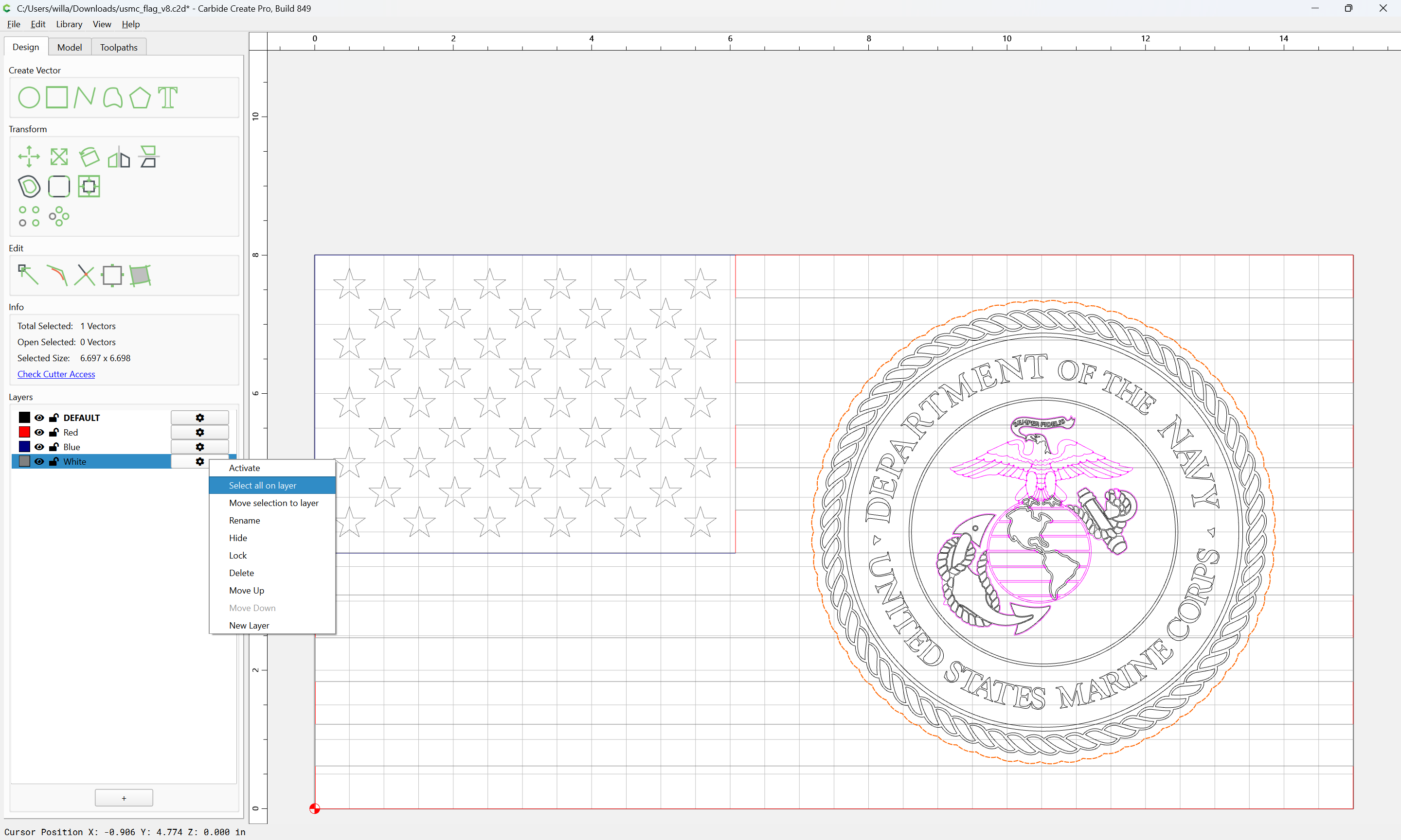

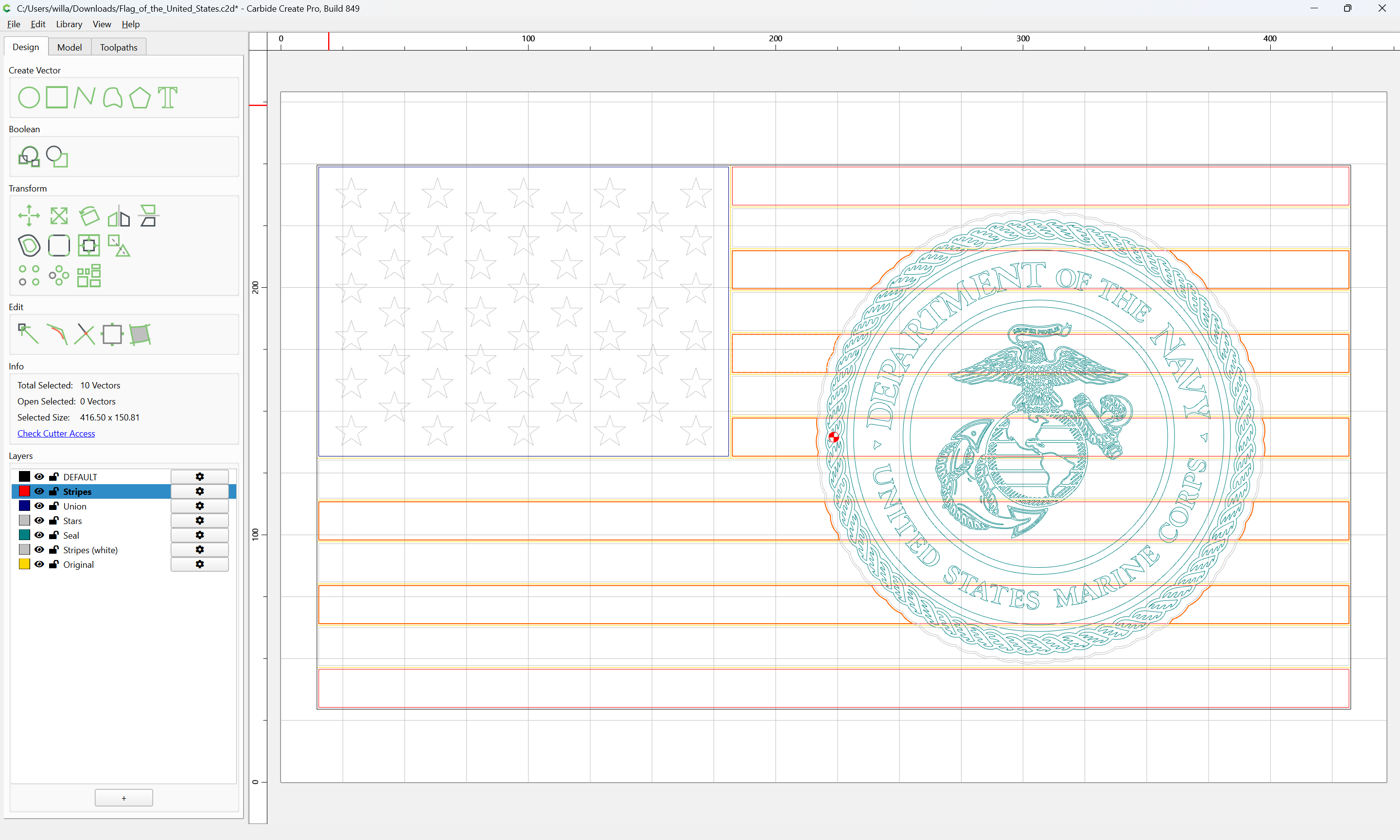

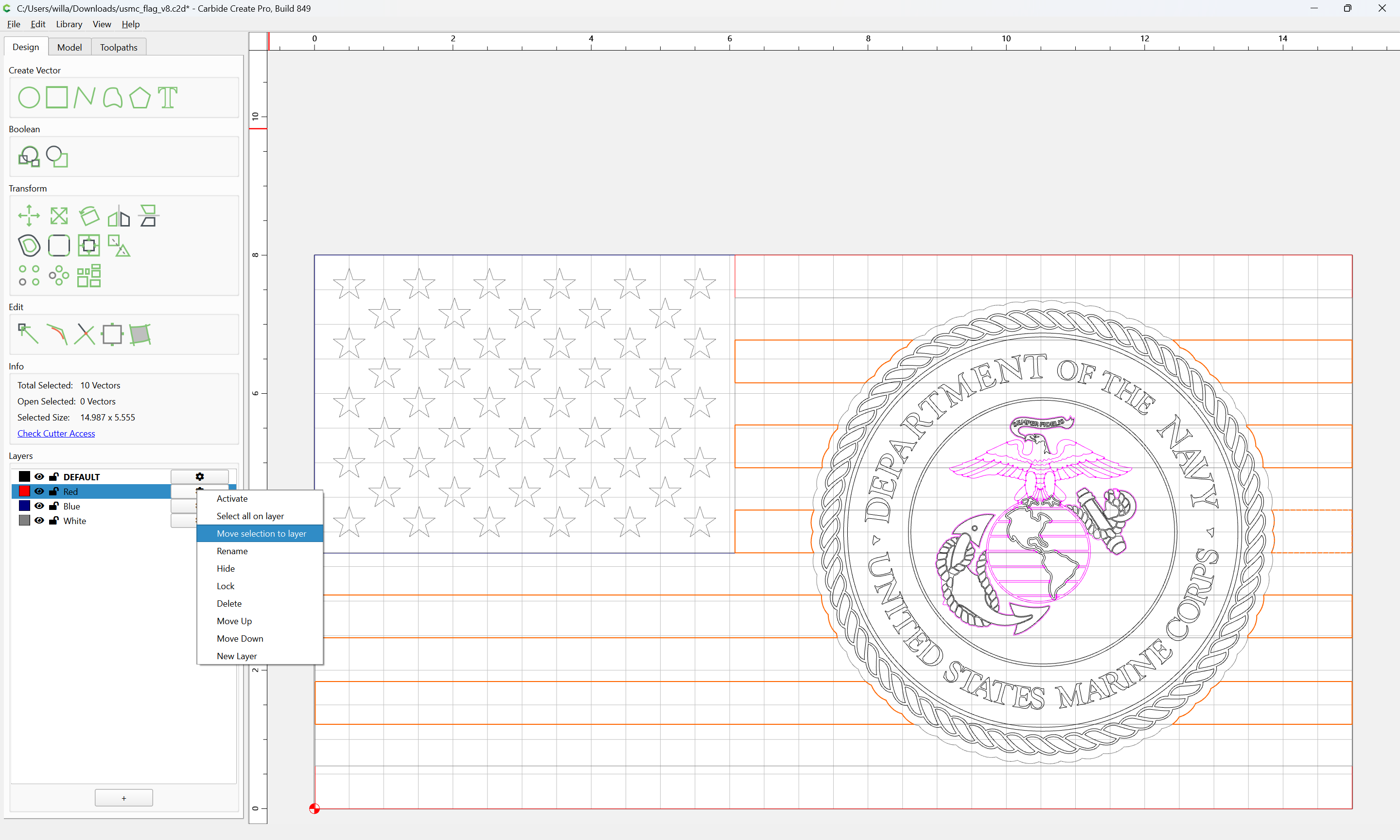

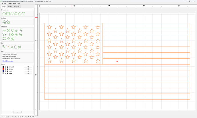

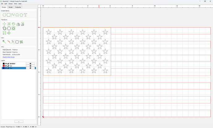

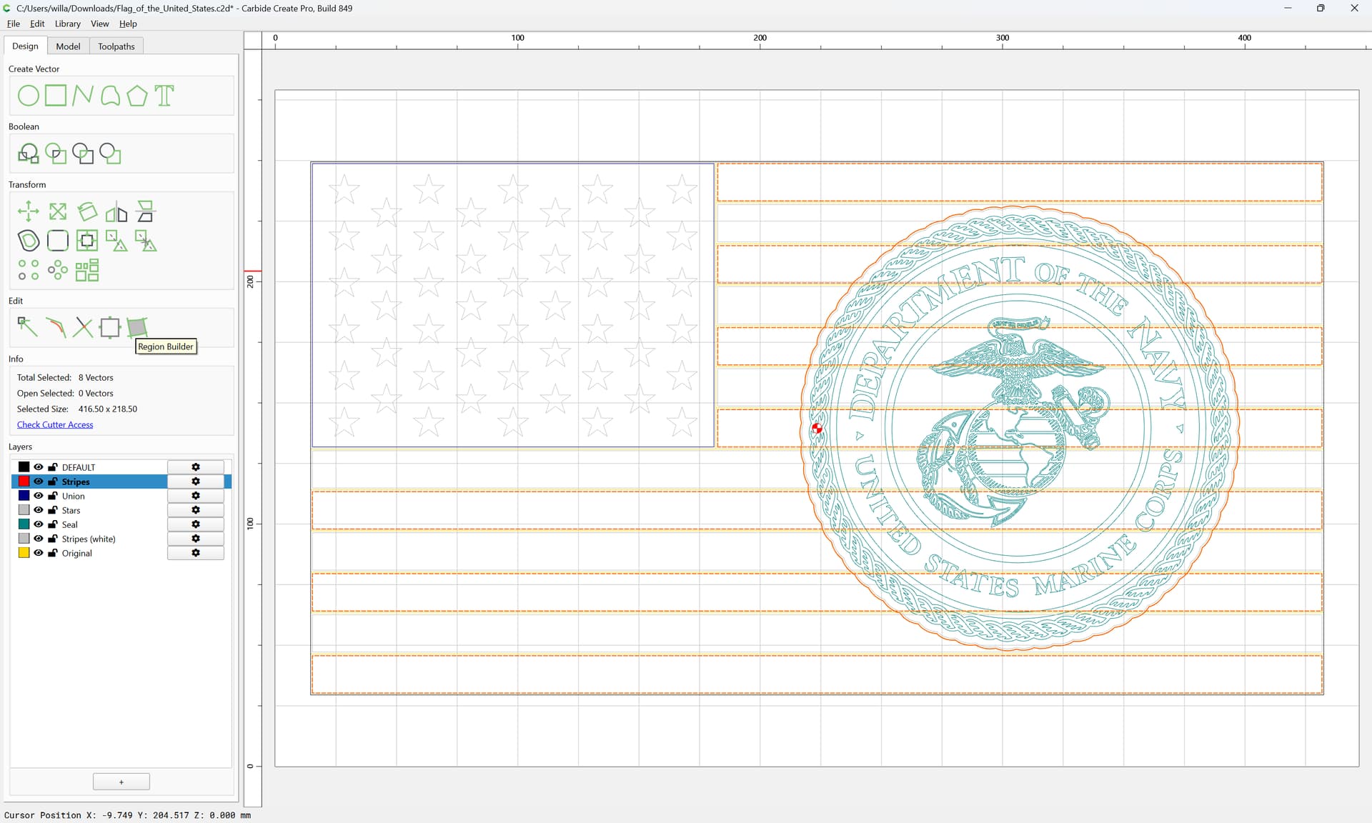

Create layers for each colour:
then select the elements for each layer:
and move them to that layer:

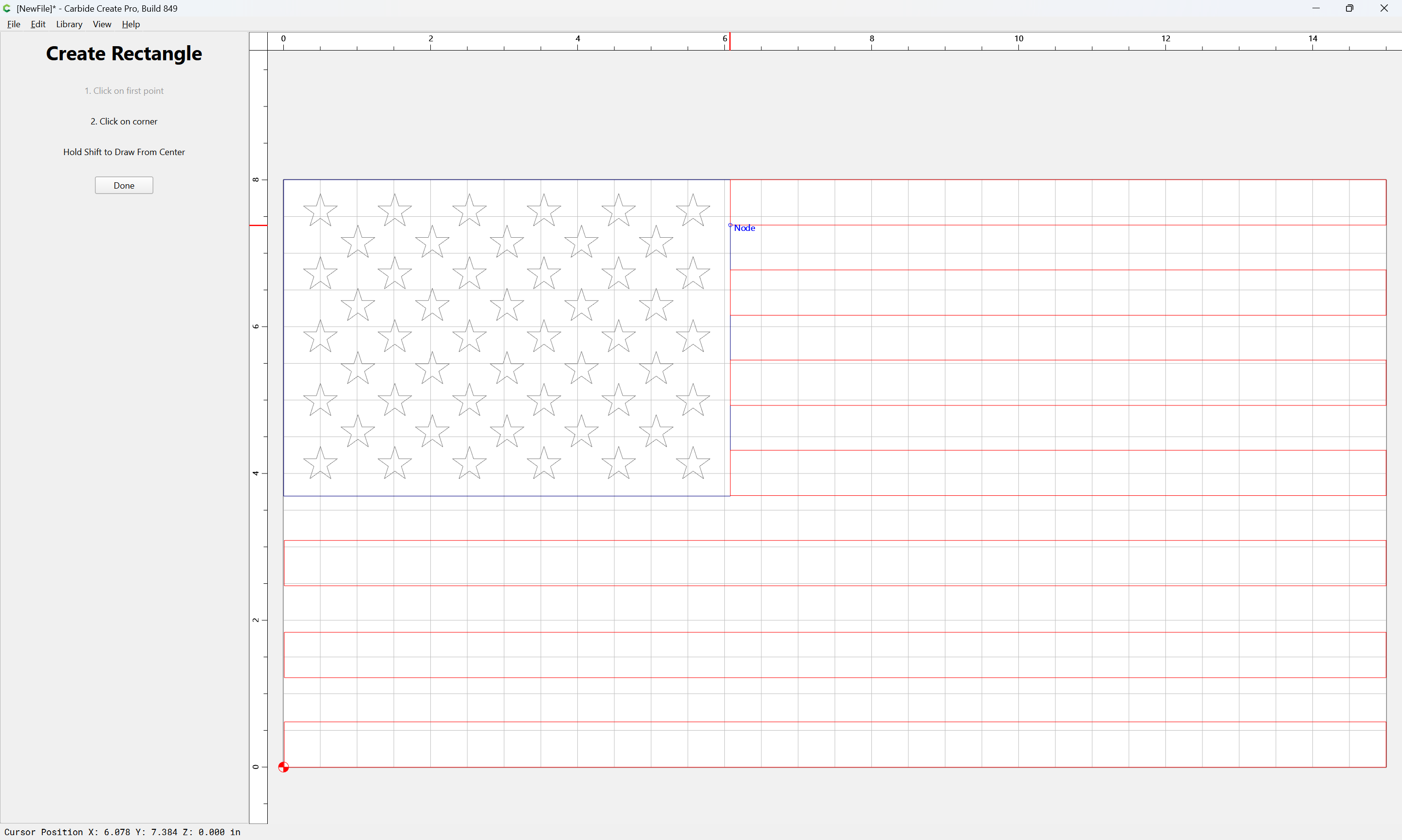

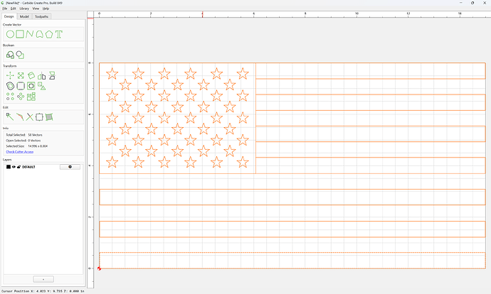

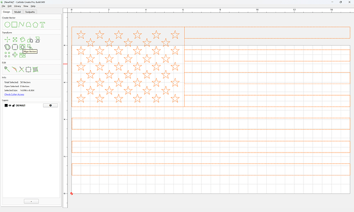

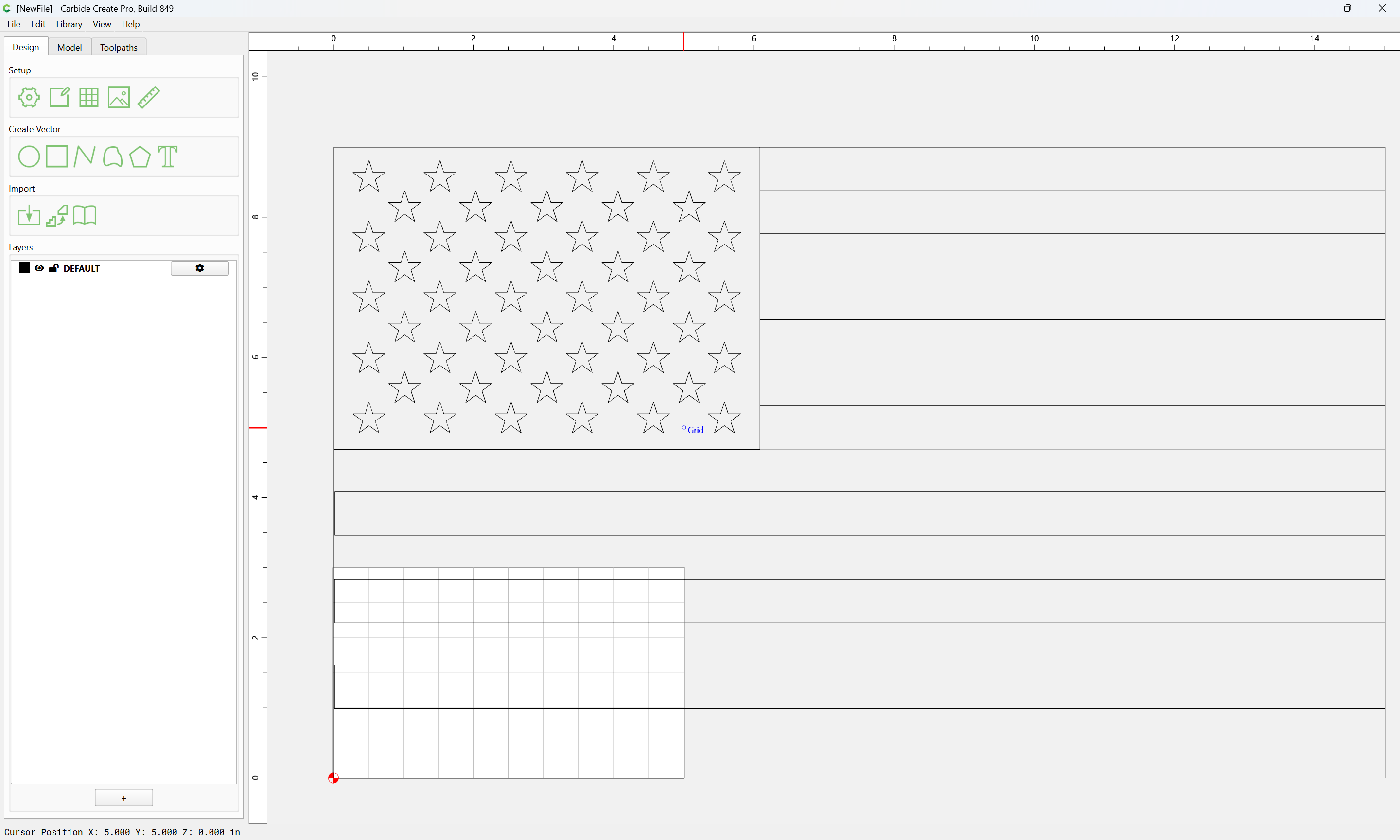

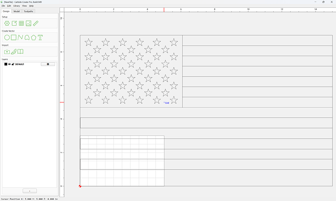

For the missing white stripes, draw them in using the rectangle tool:
(after double-clicking on the White layer to make it Active)
repeat for all other stripes:

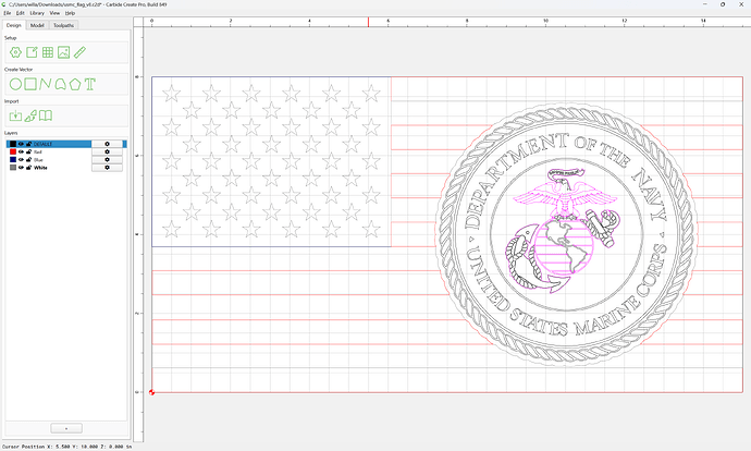

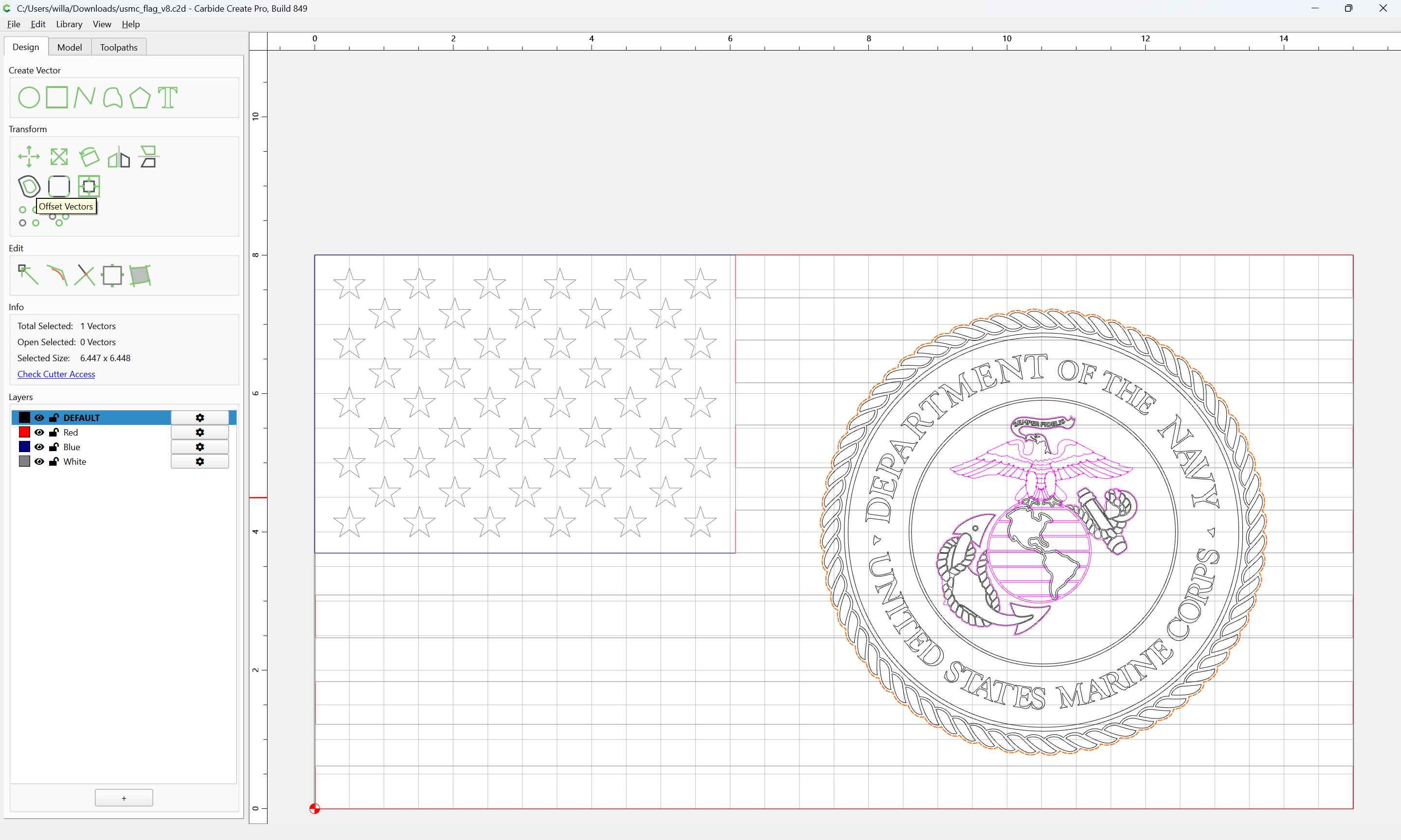

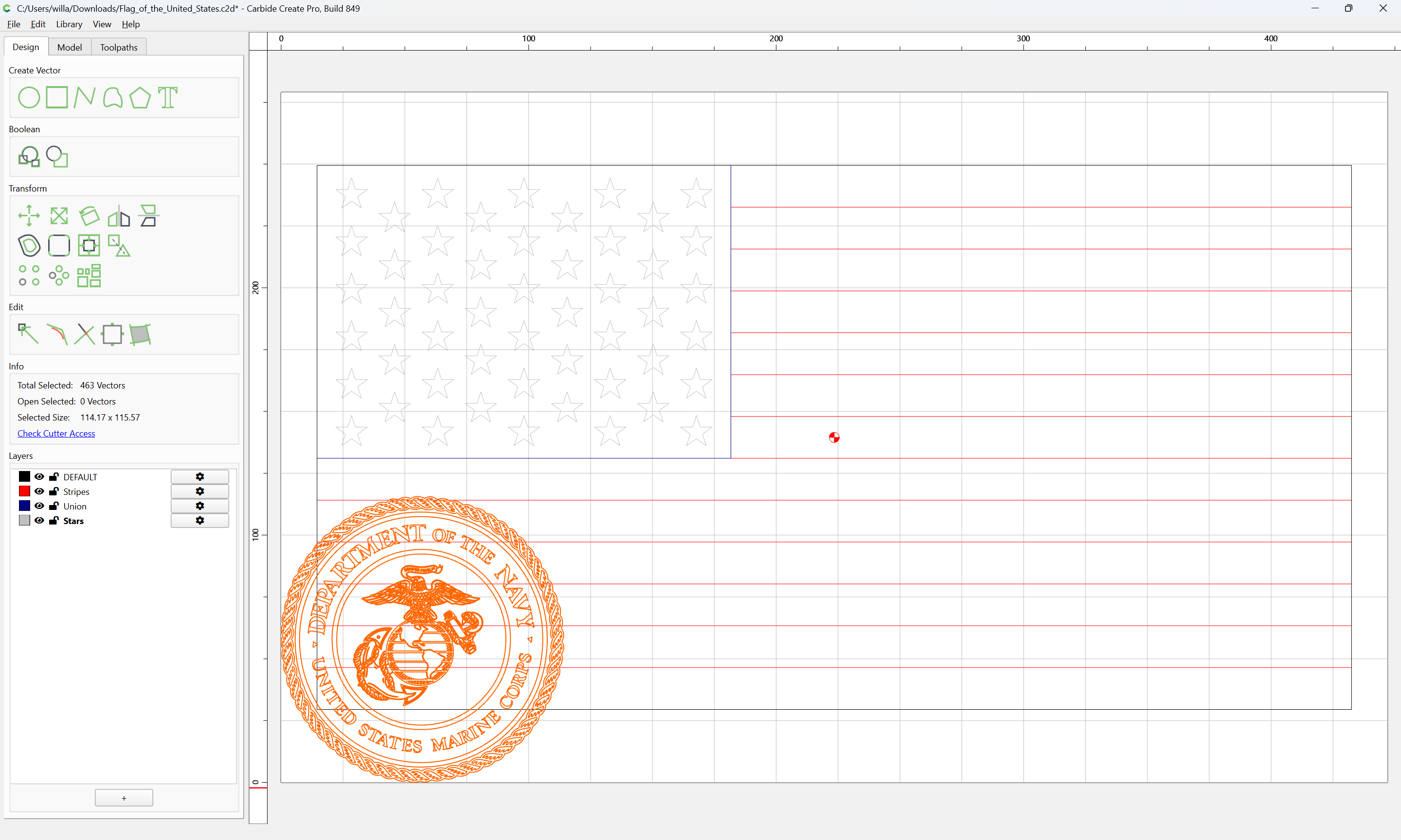

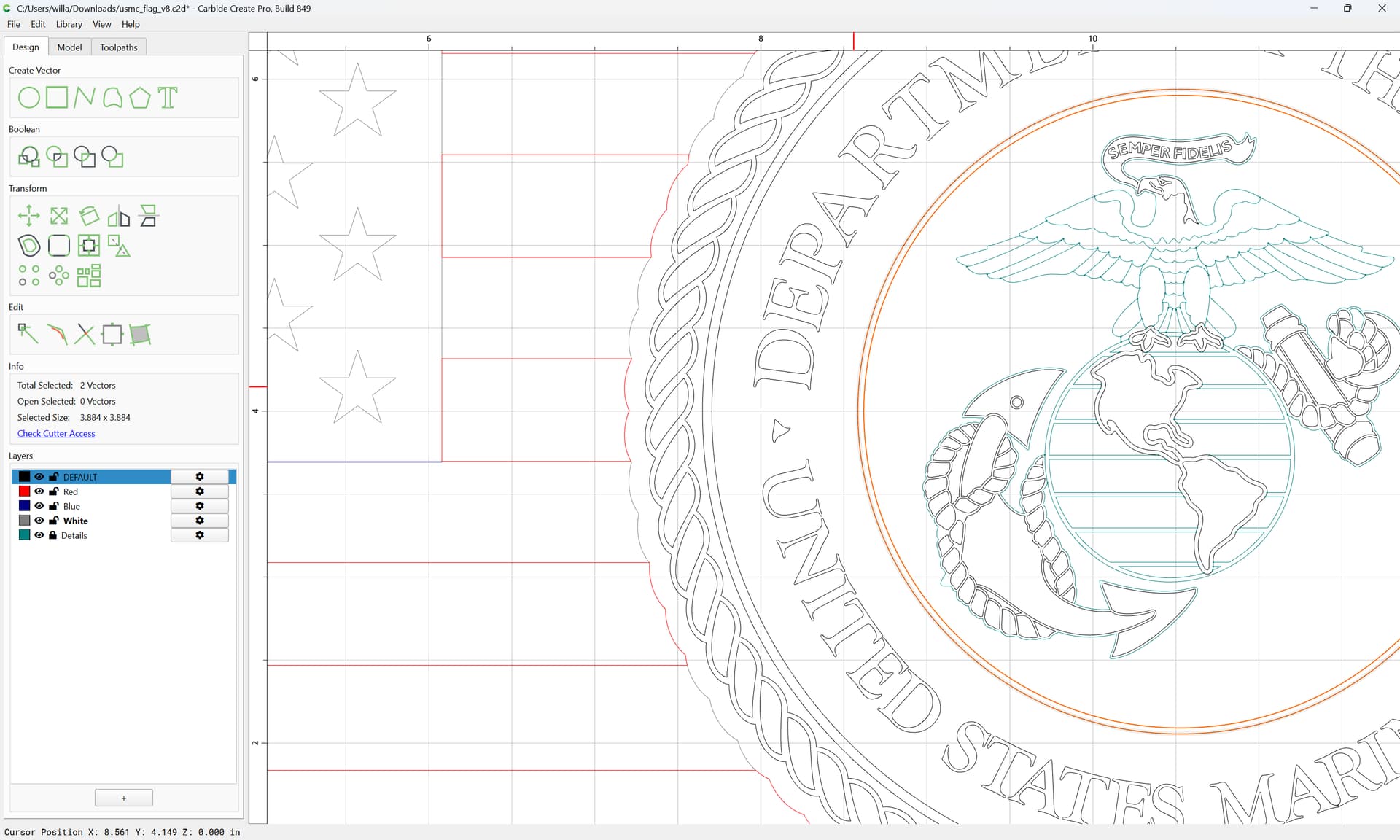

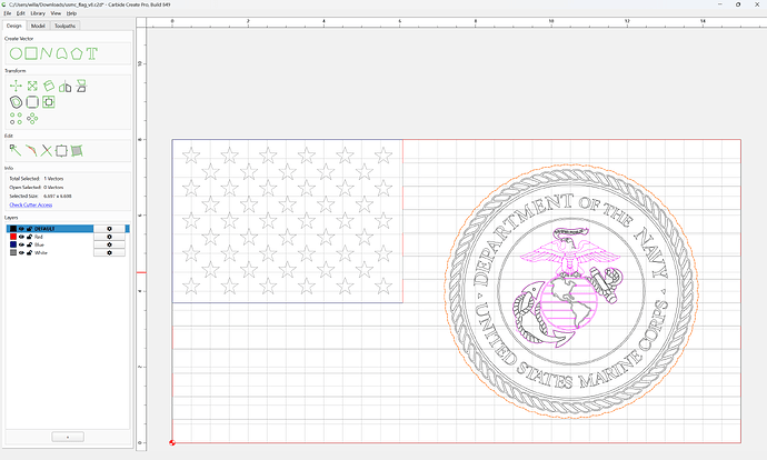

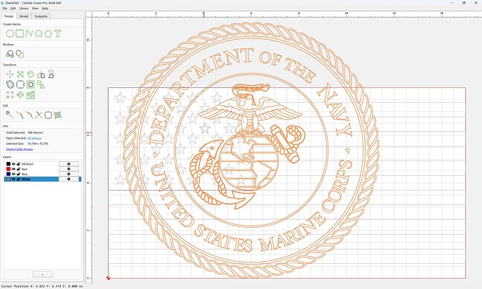

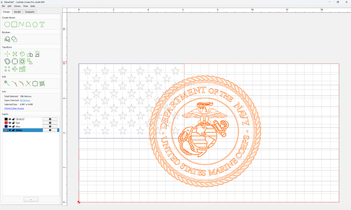

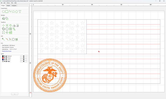

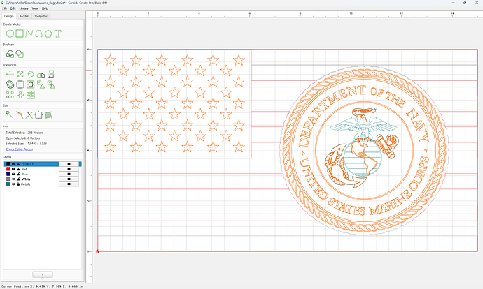

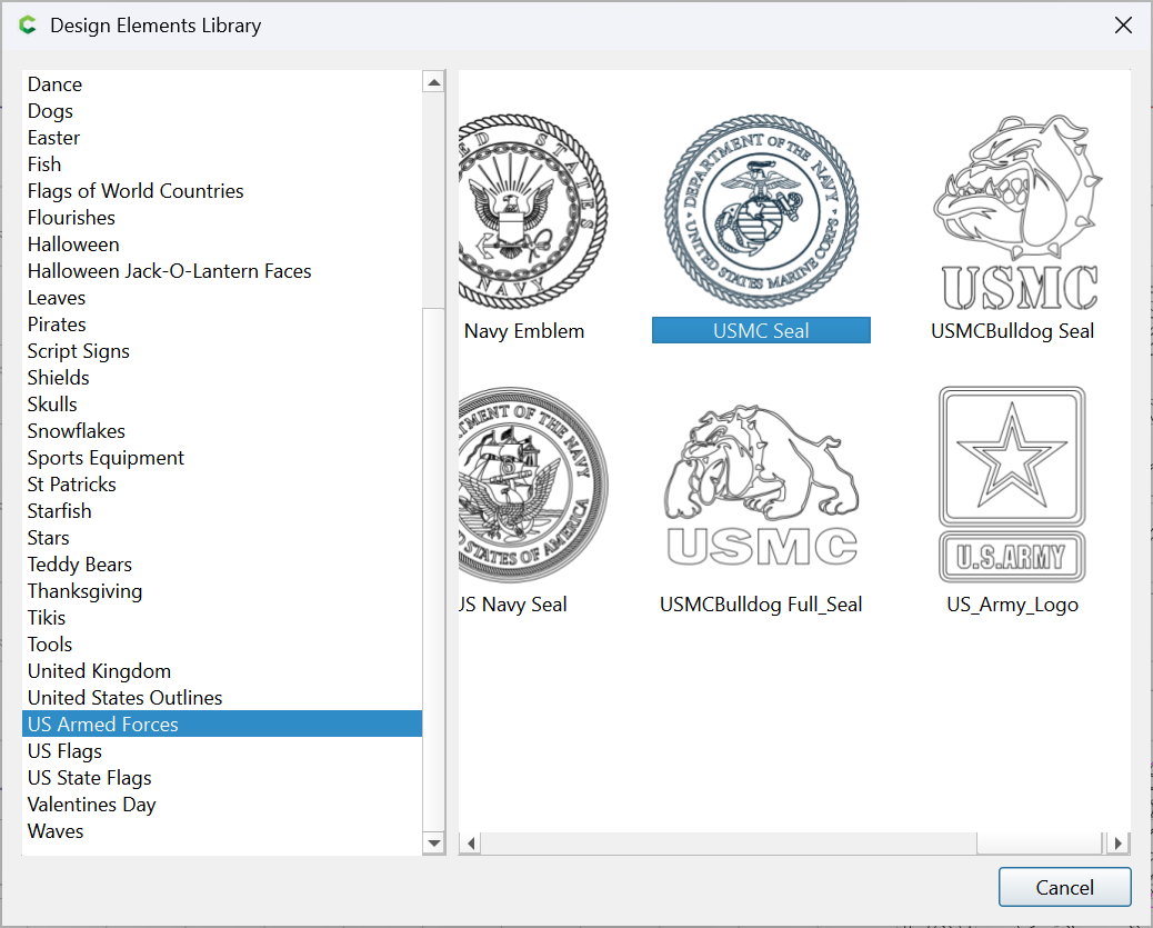

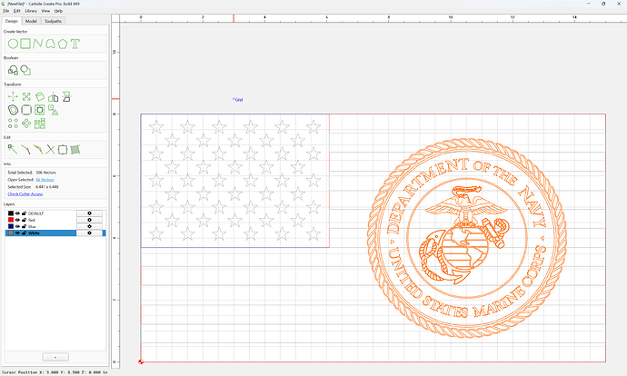

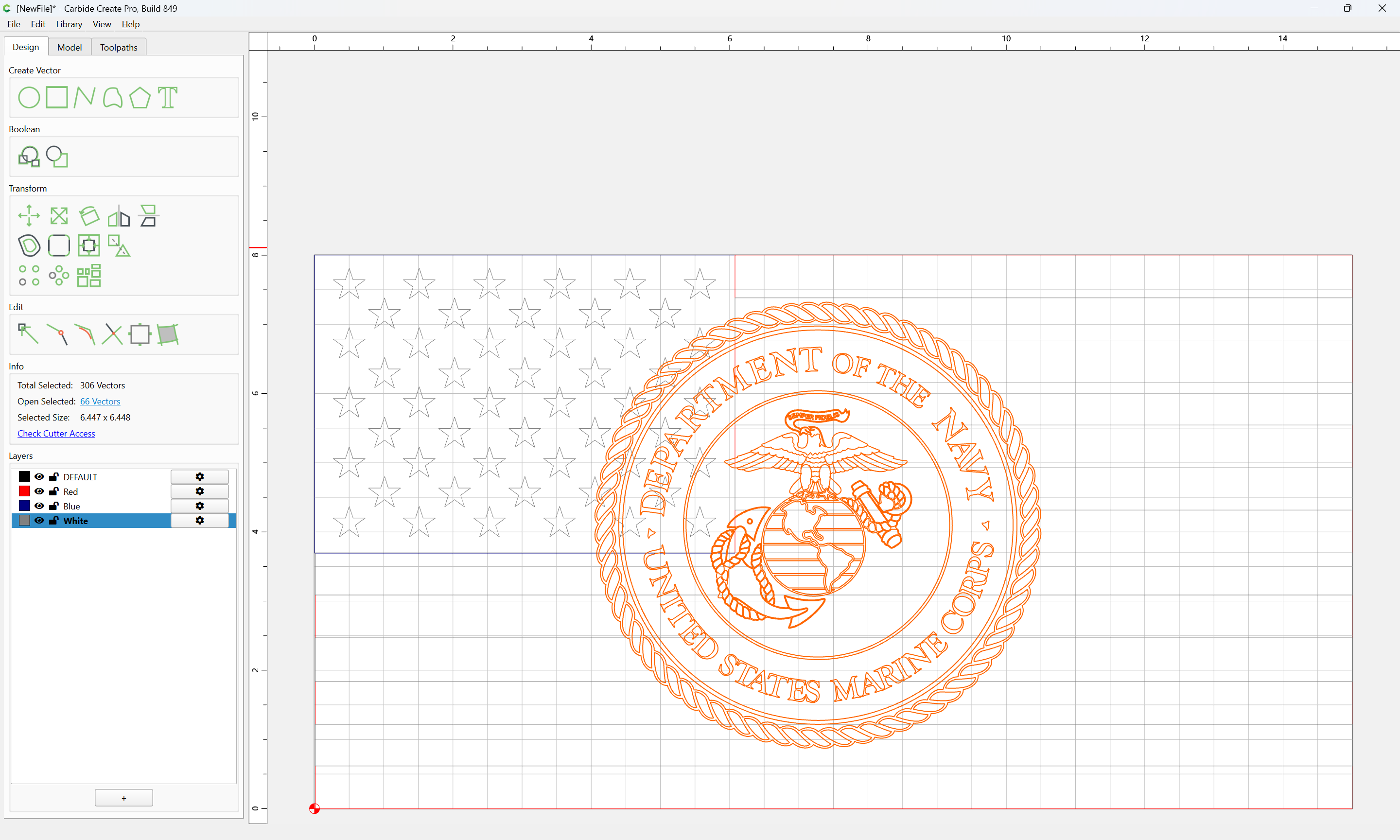

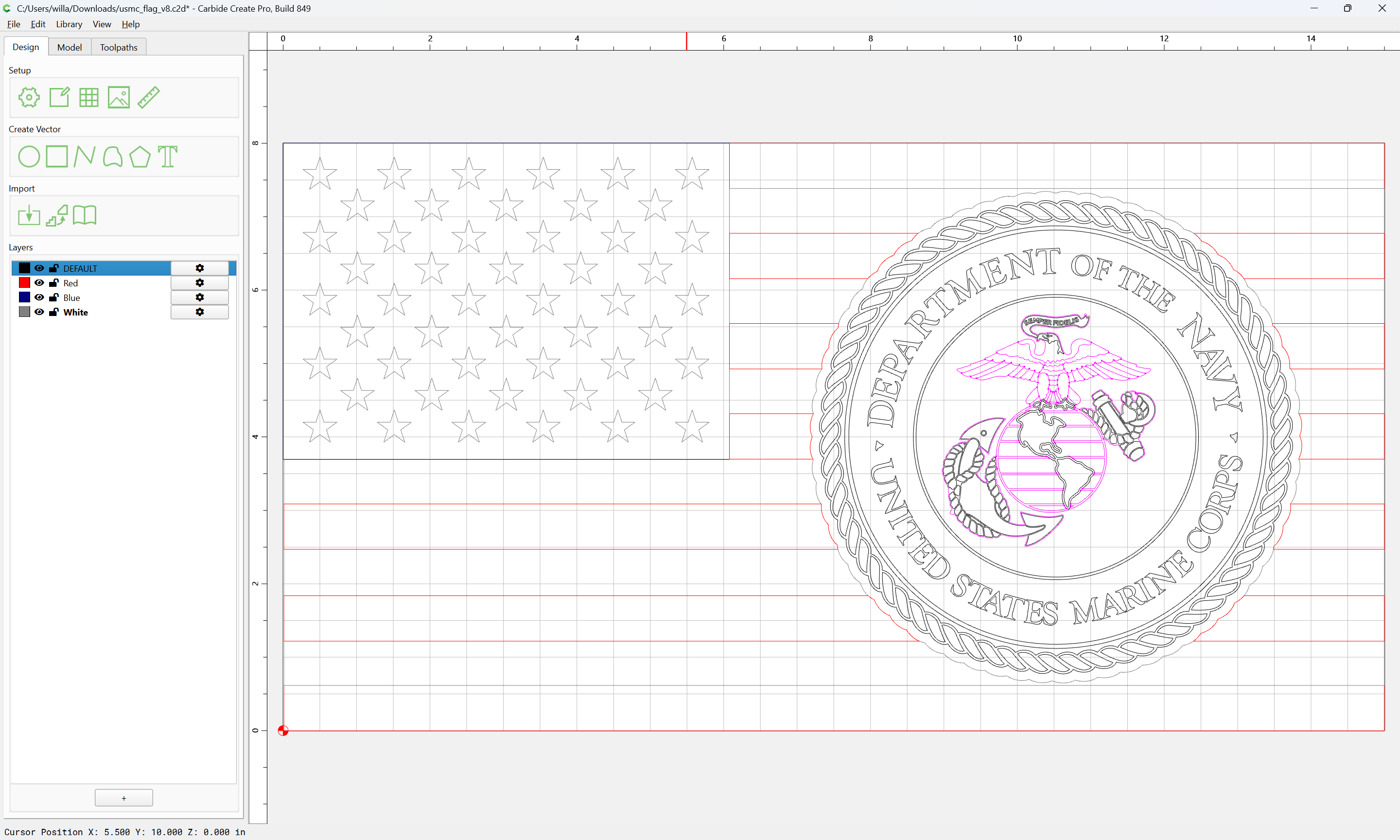

Import the USMC seal (after double-clicking on “Default” to make it the Active layer):
c.f.,
and adjust its size and placement as desired:
Done

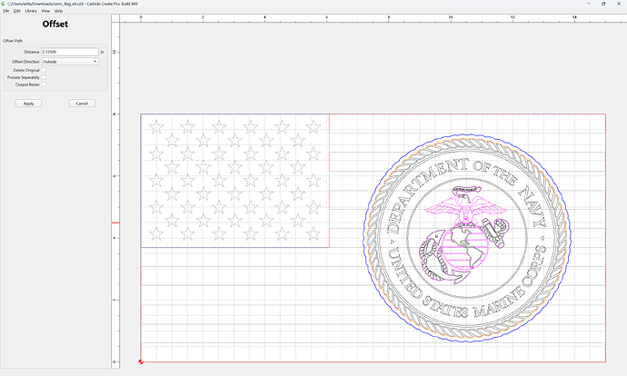

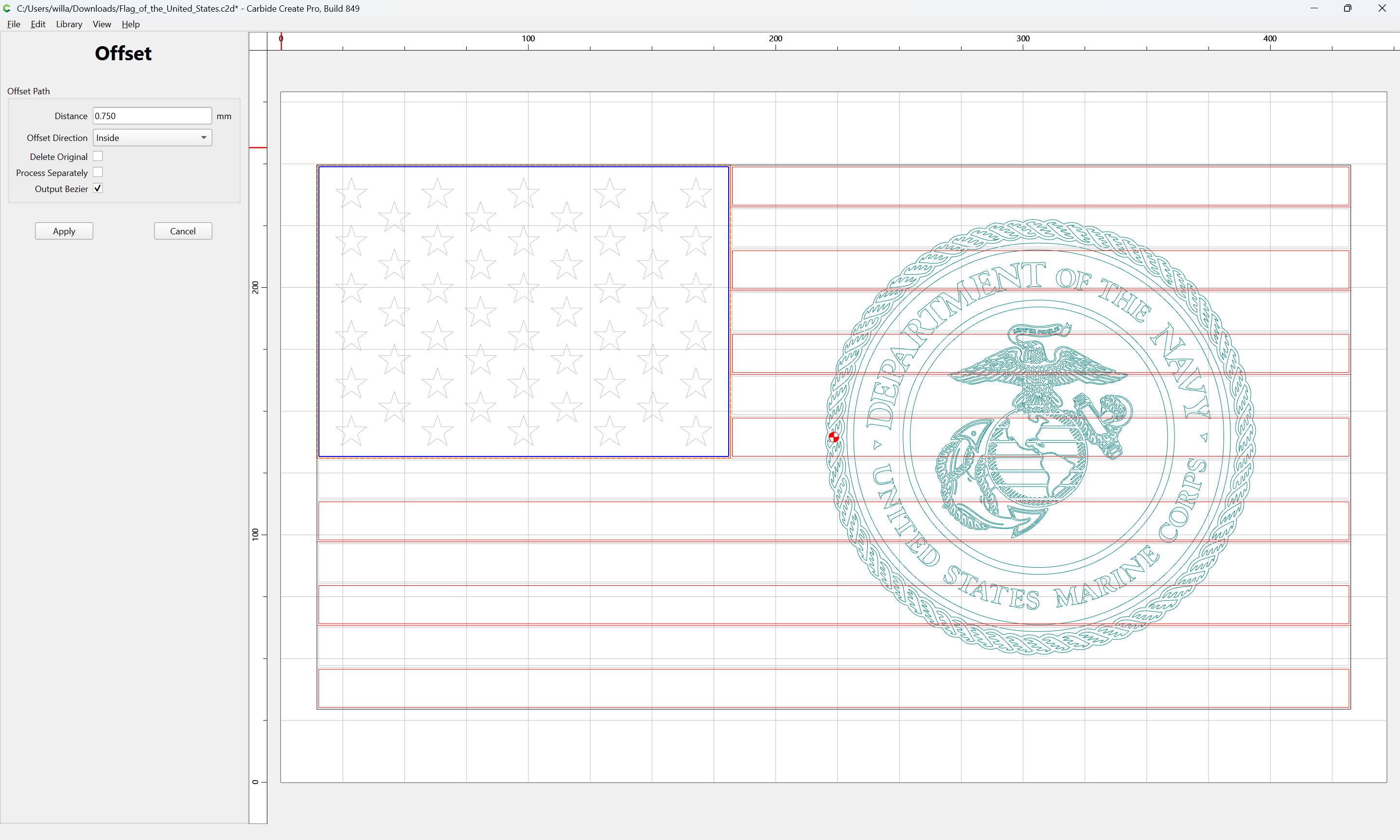

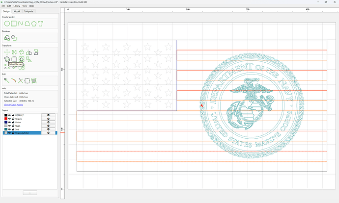

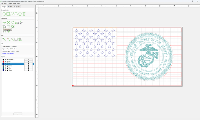

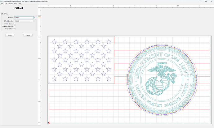

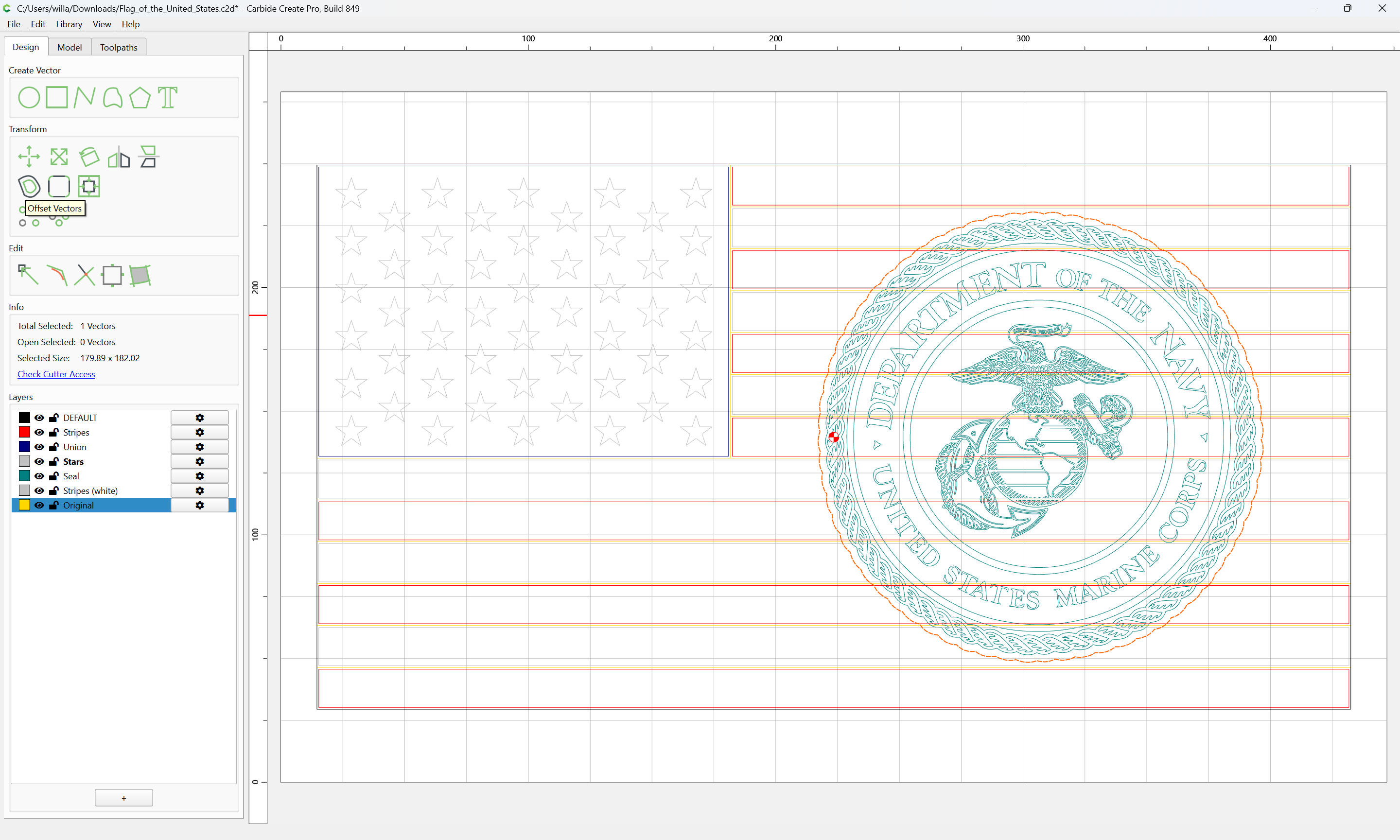

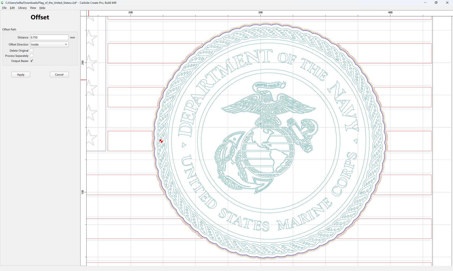

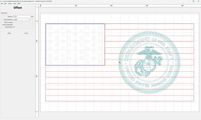

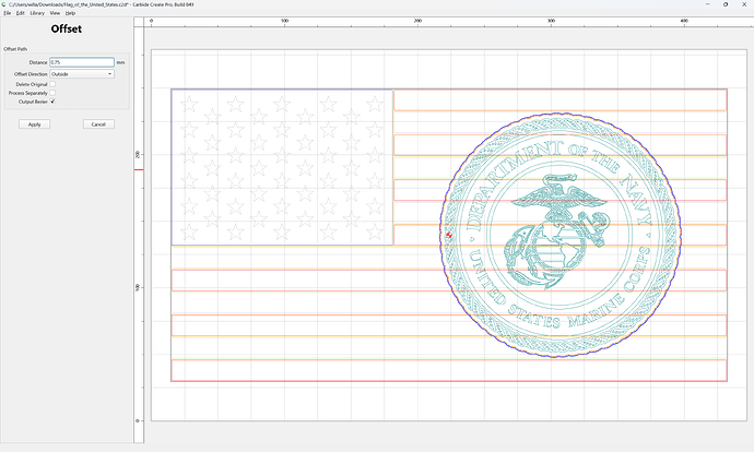

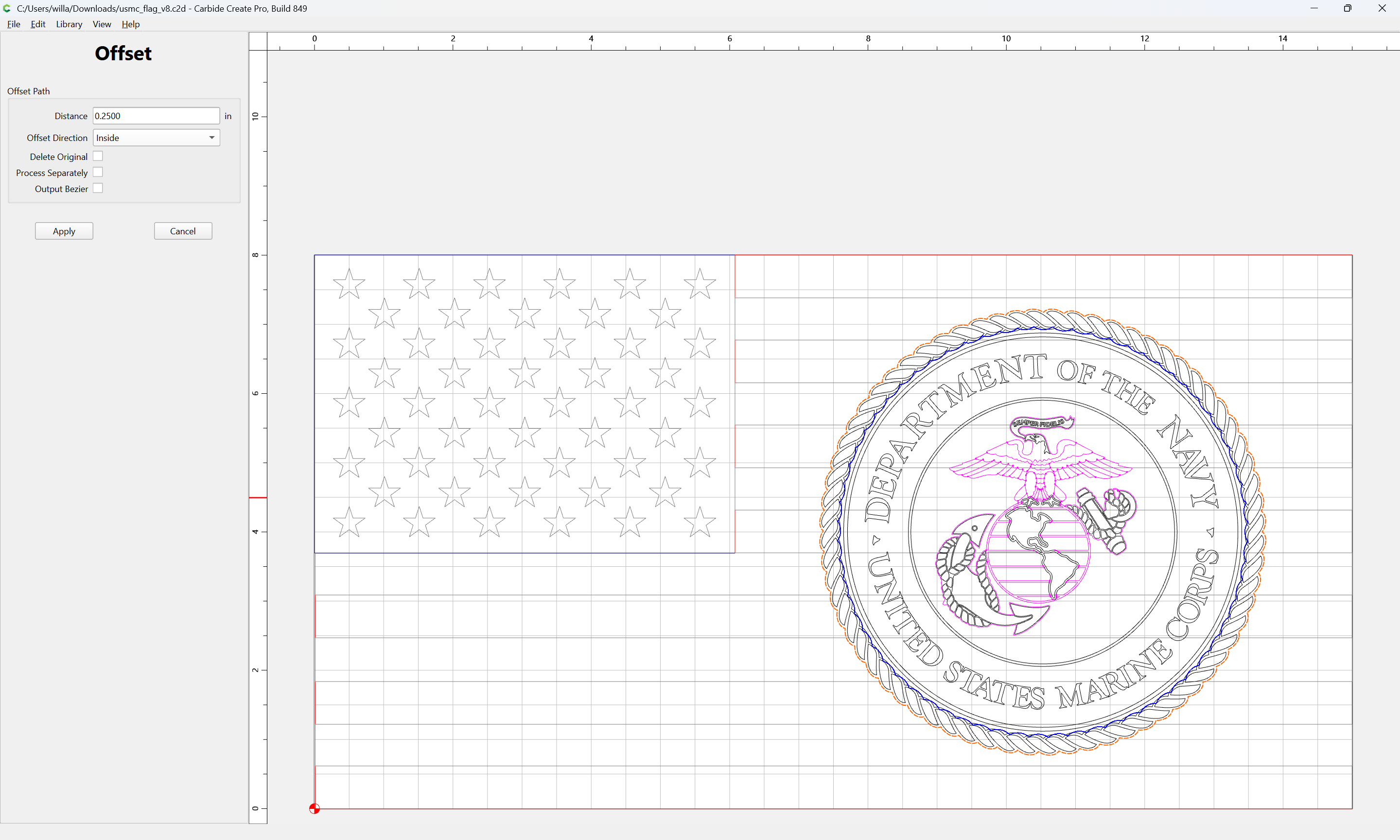

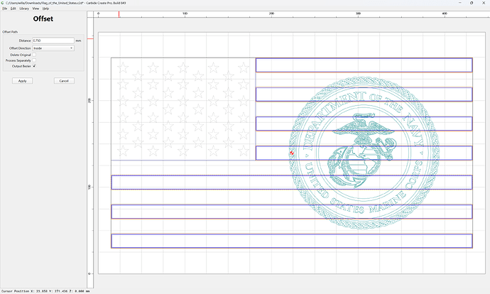

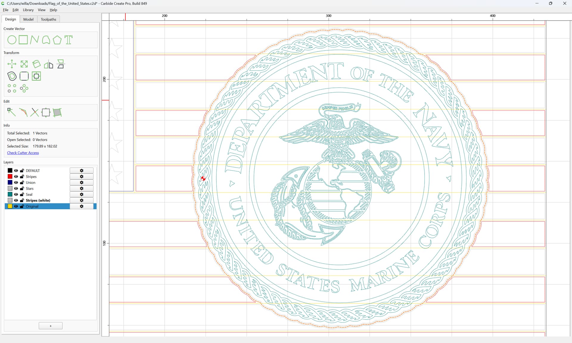

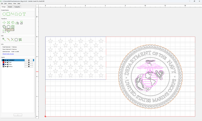

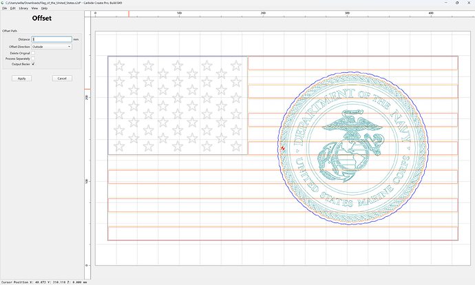

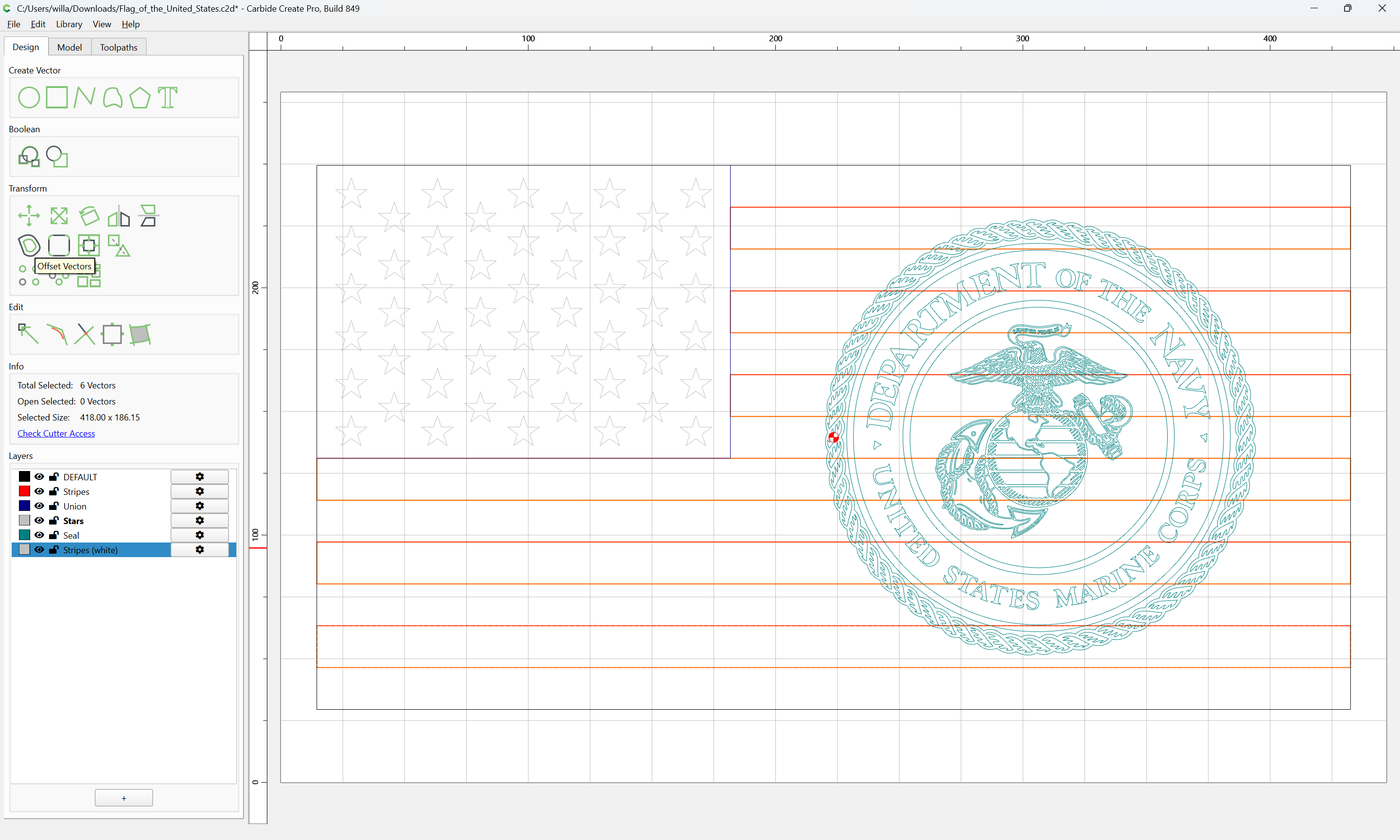

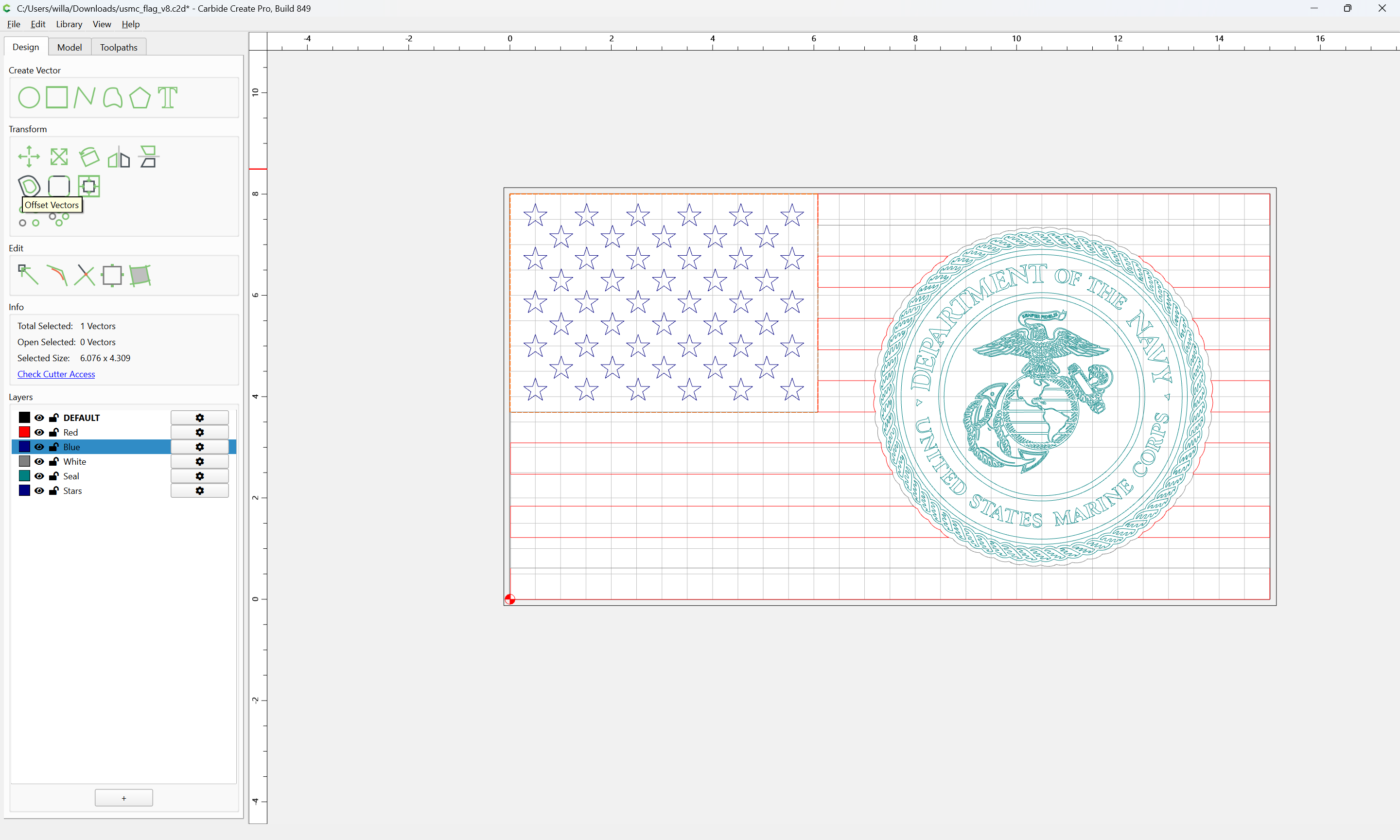

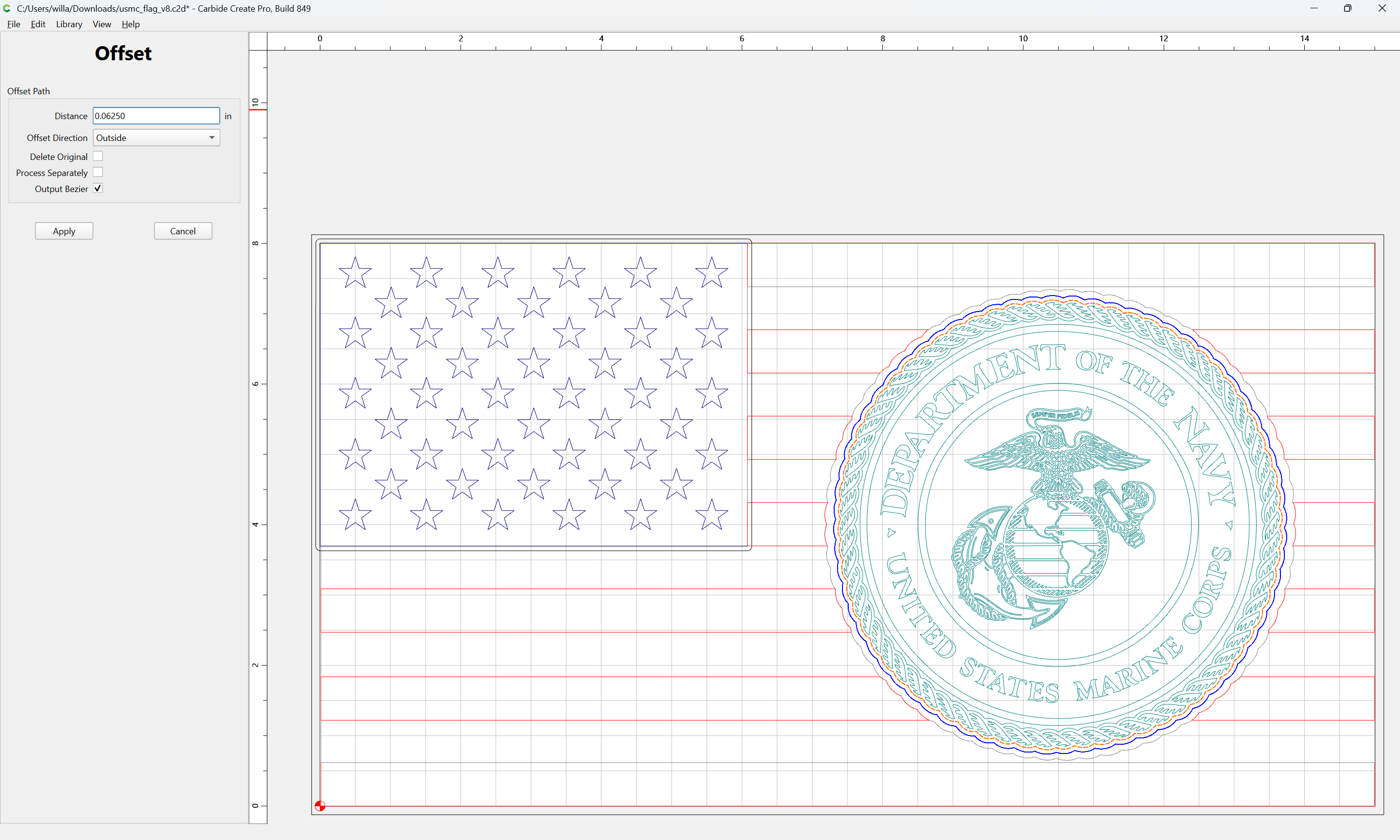

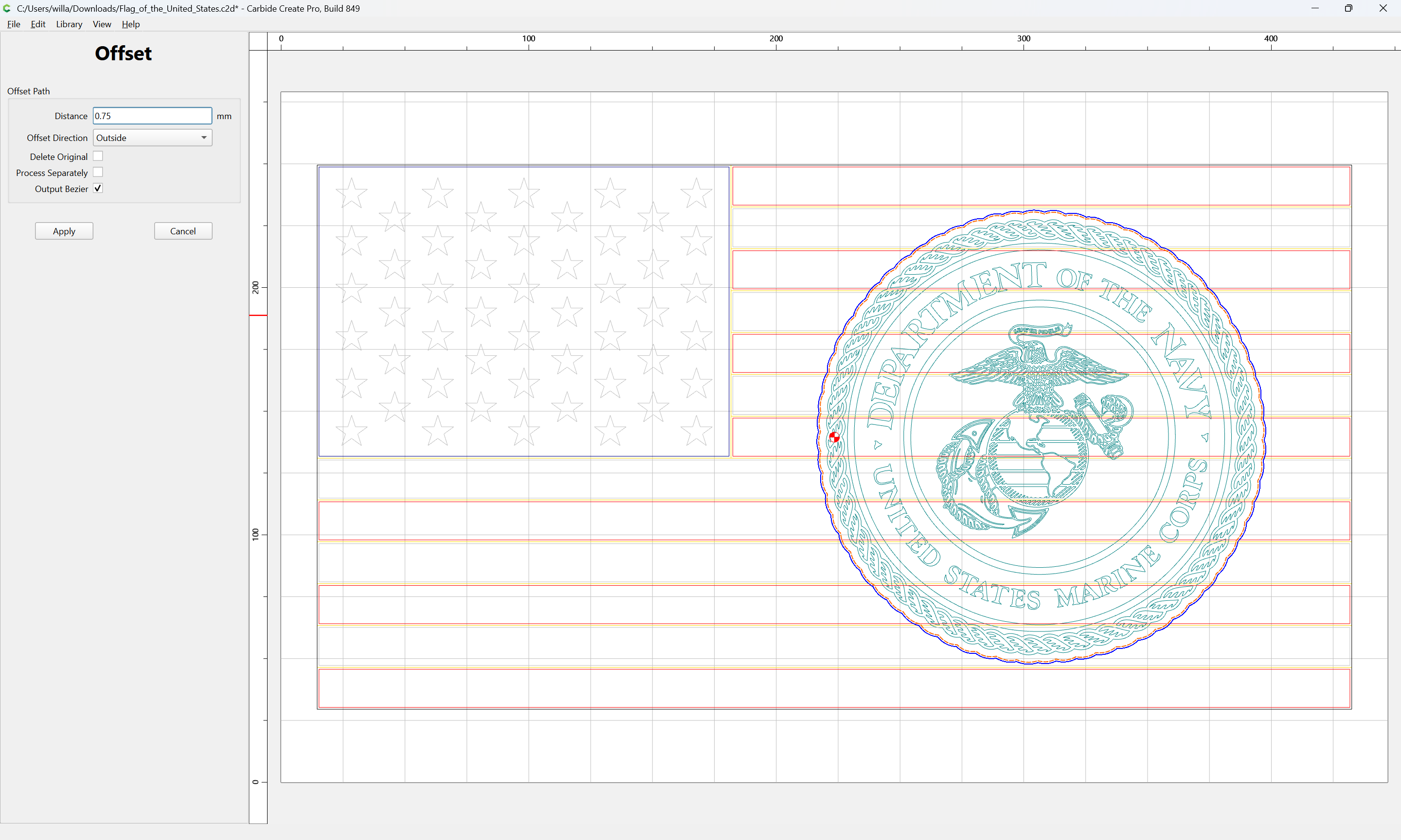

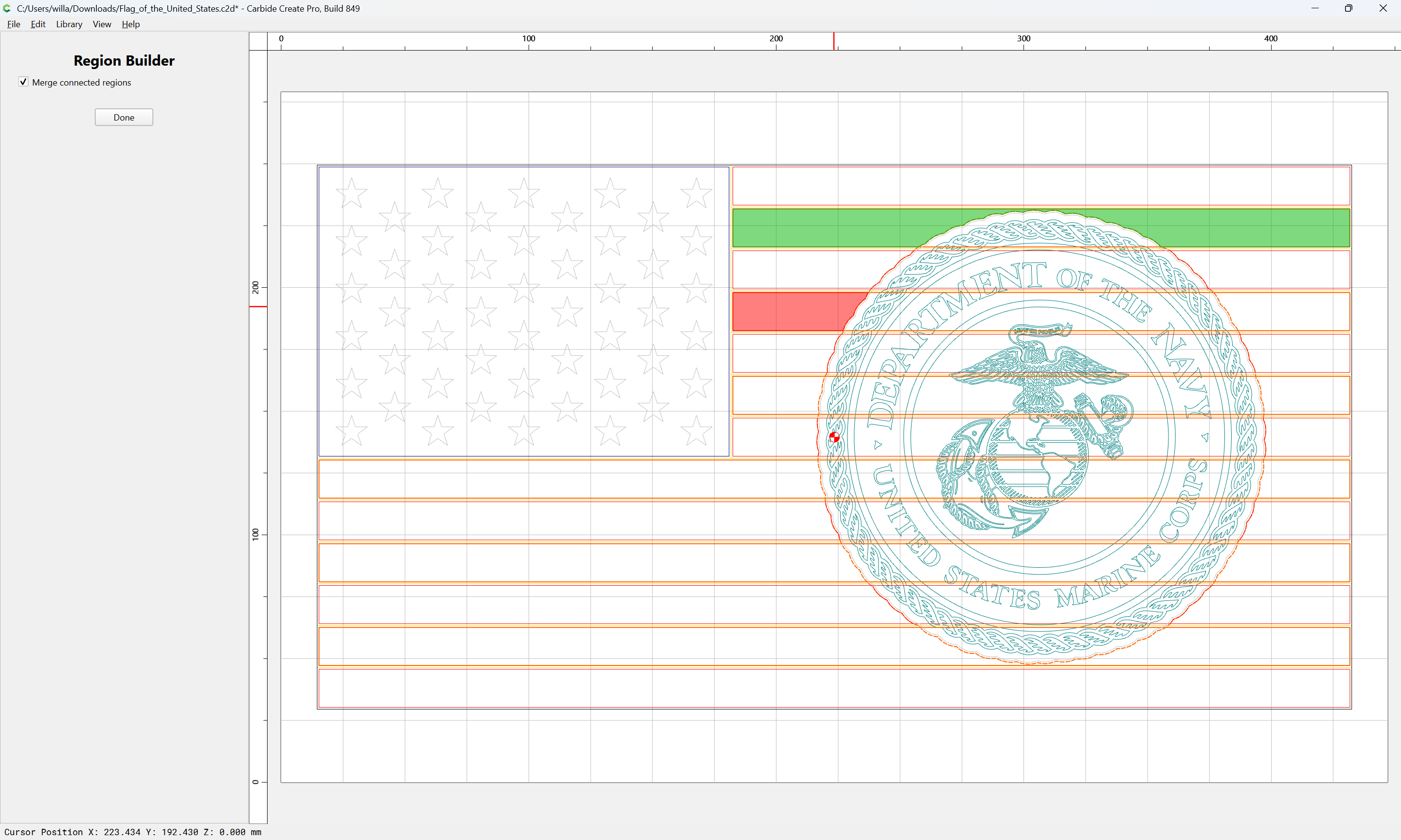

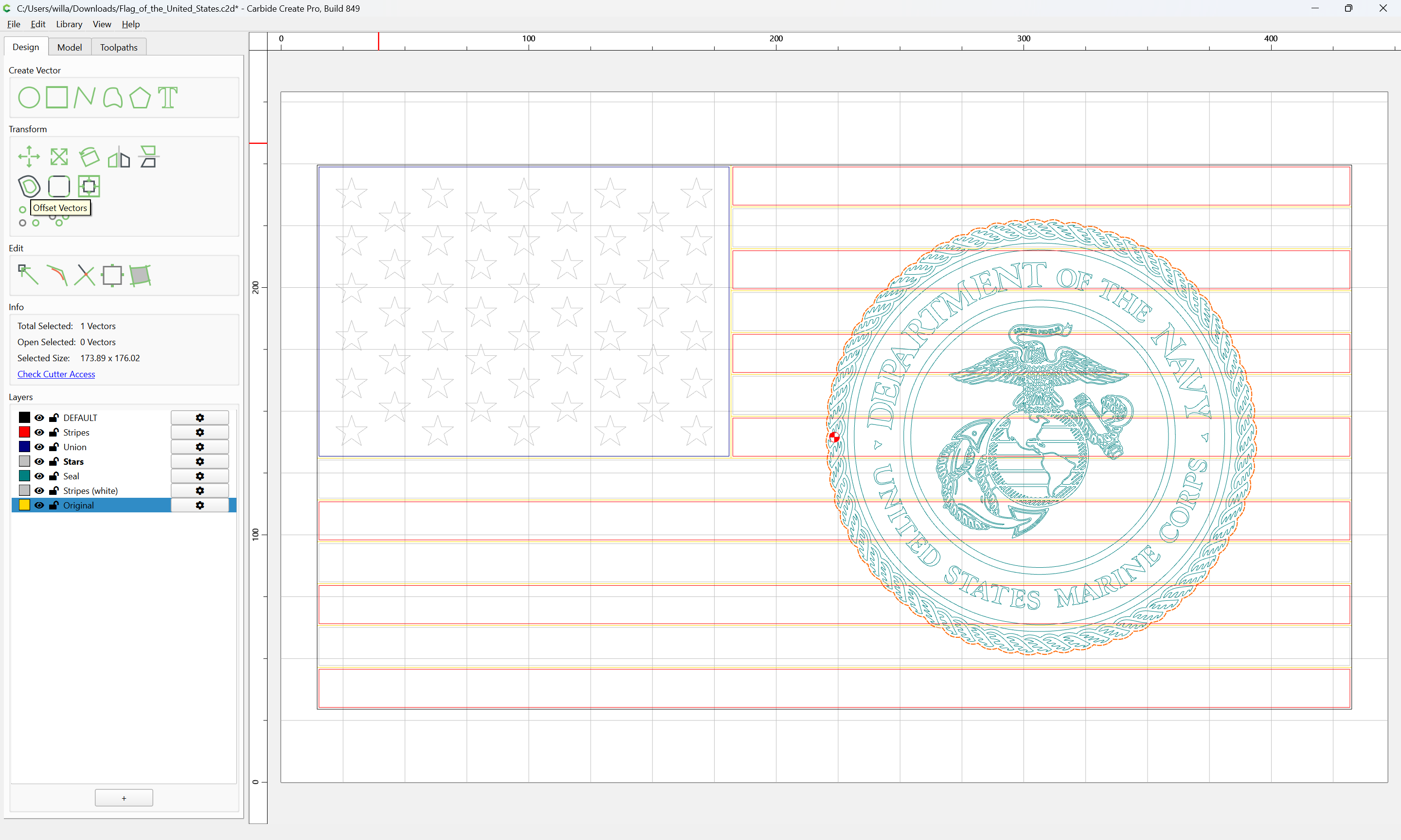

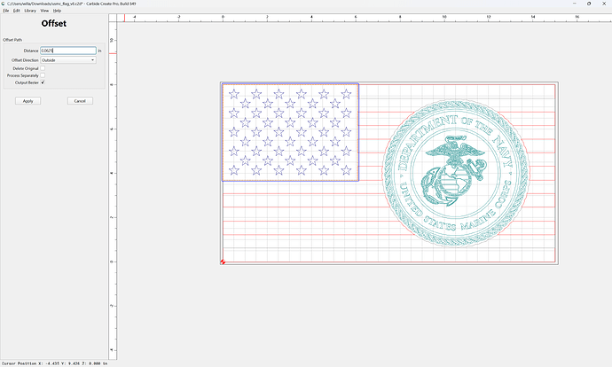

Next, it will be necessary to create geometry around the emblem for a separation:
Offset Vectors
adjust the settings
Apply

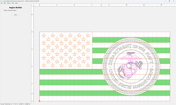

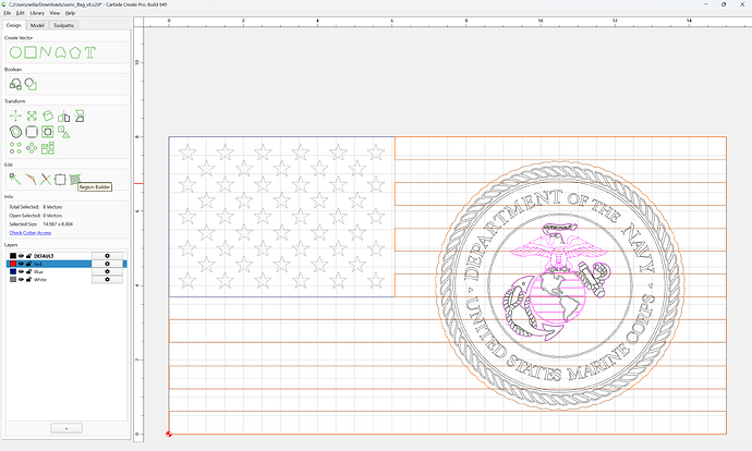

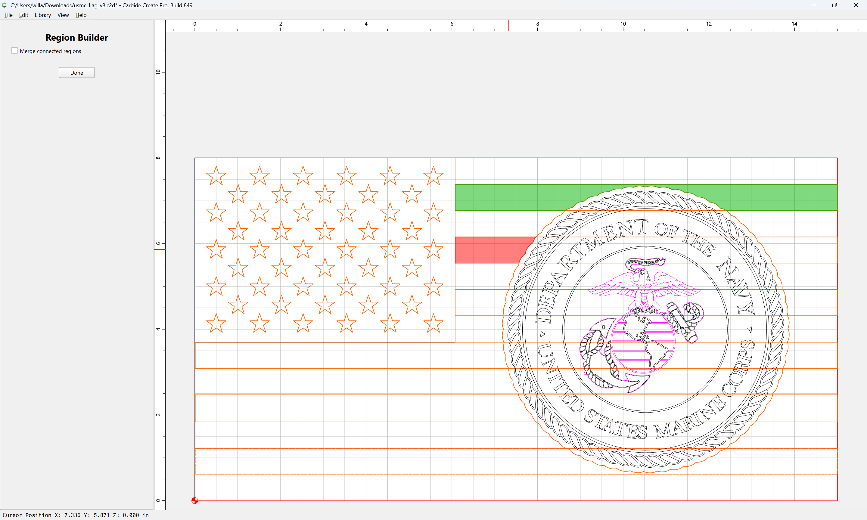

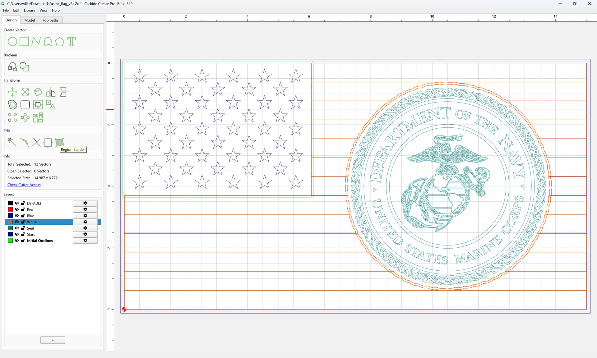

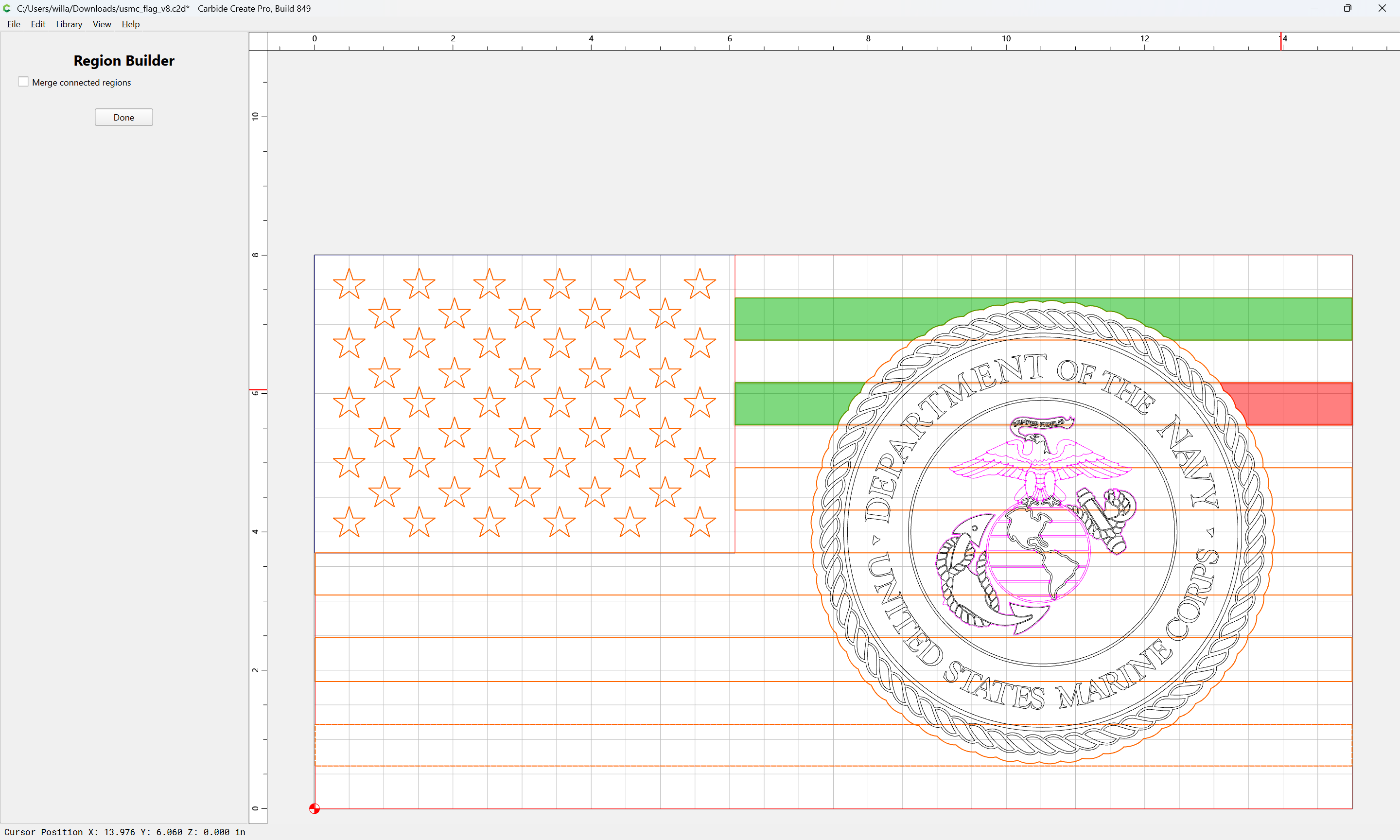

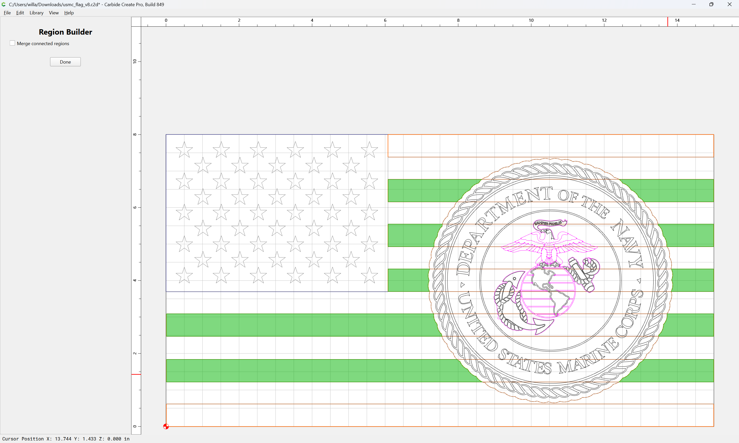

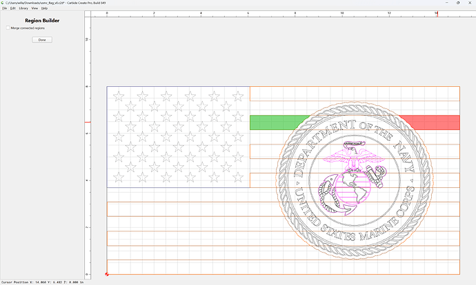

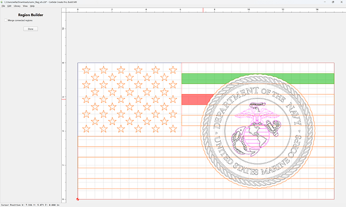

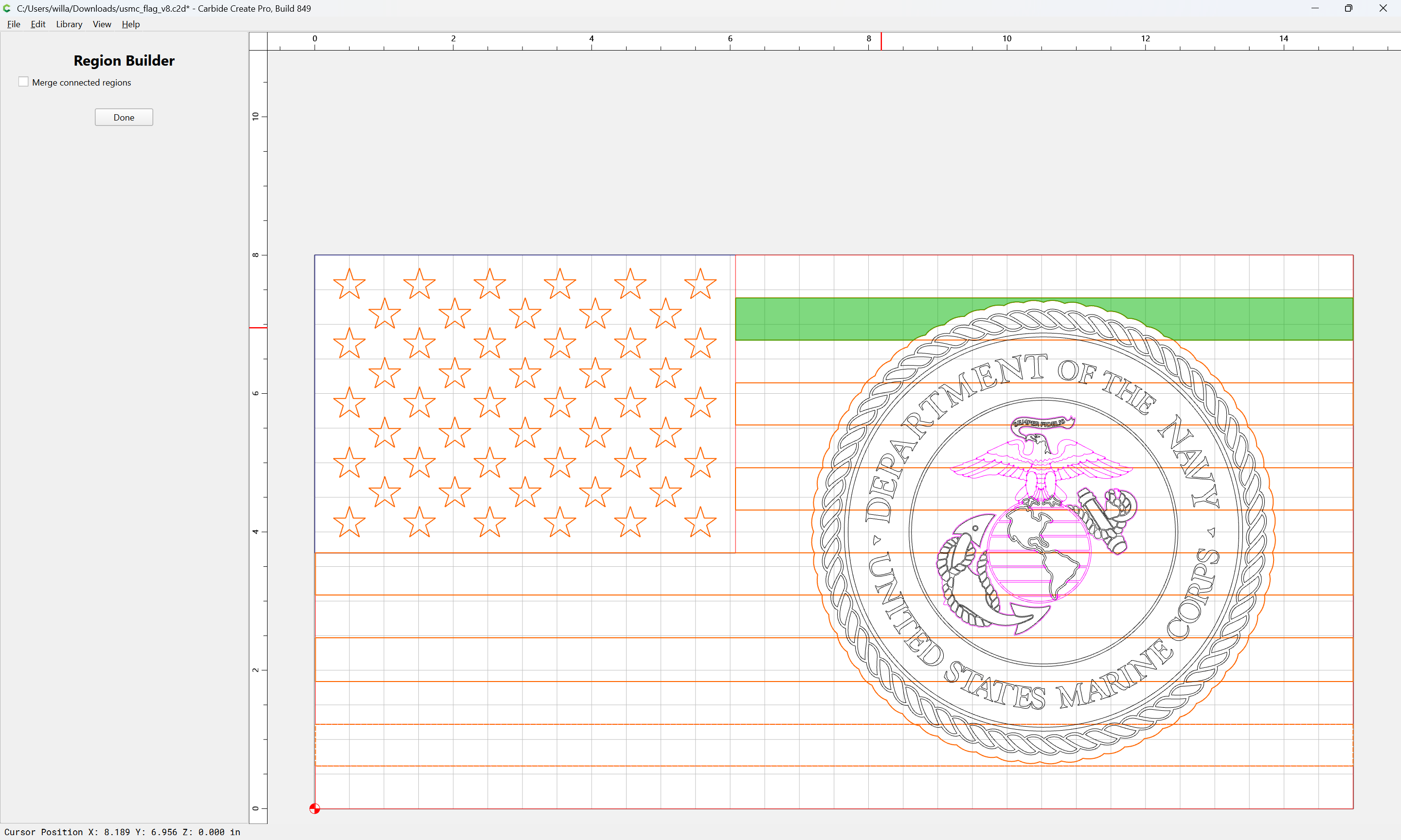

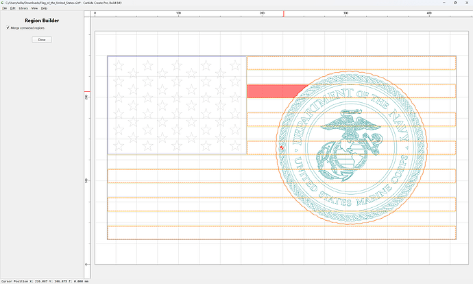

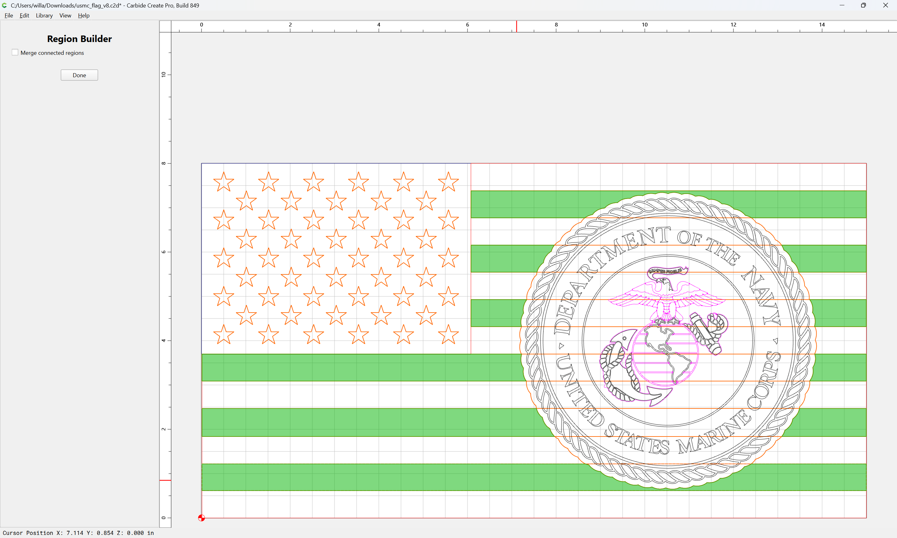

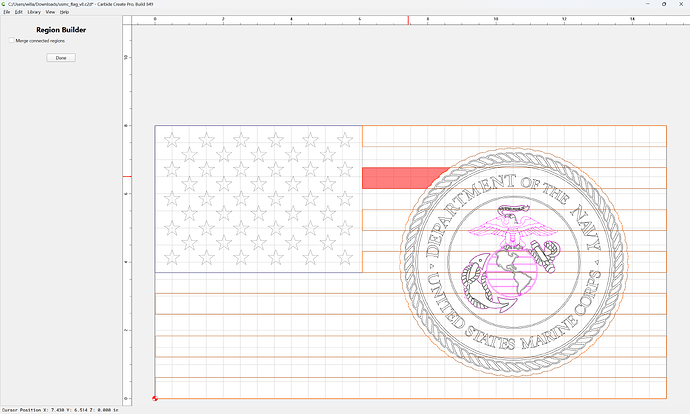

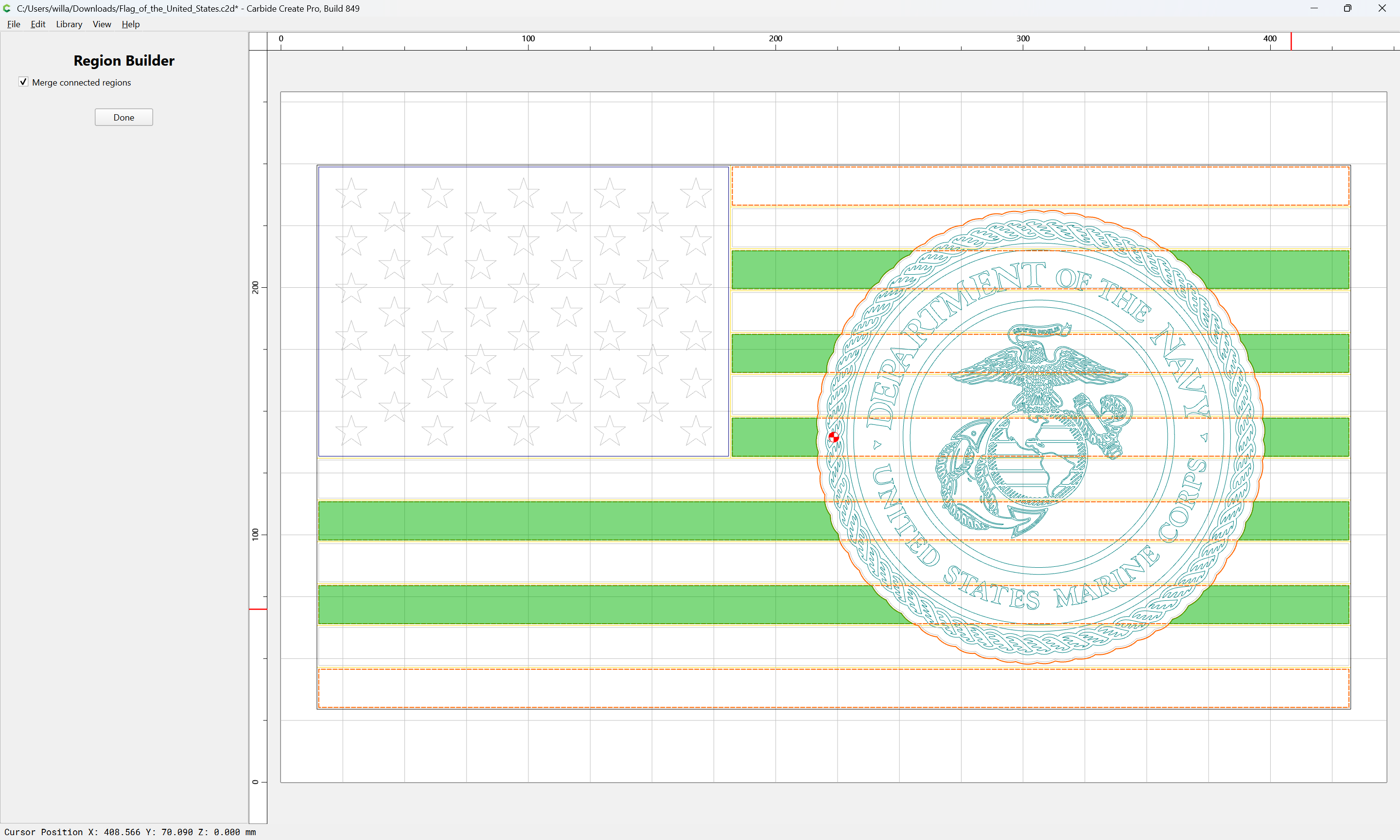

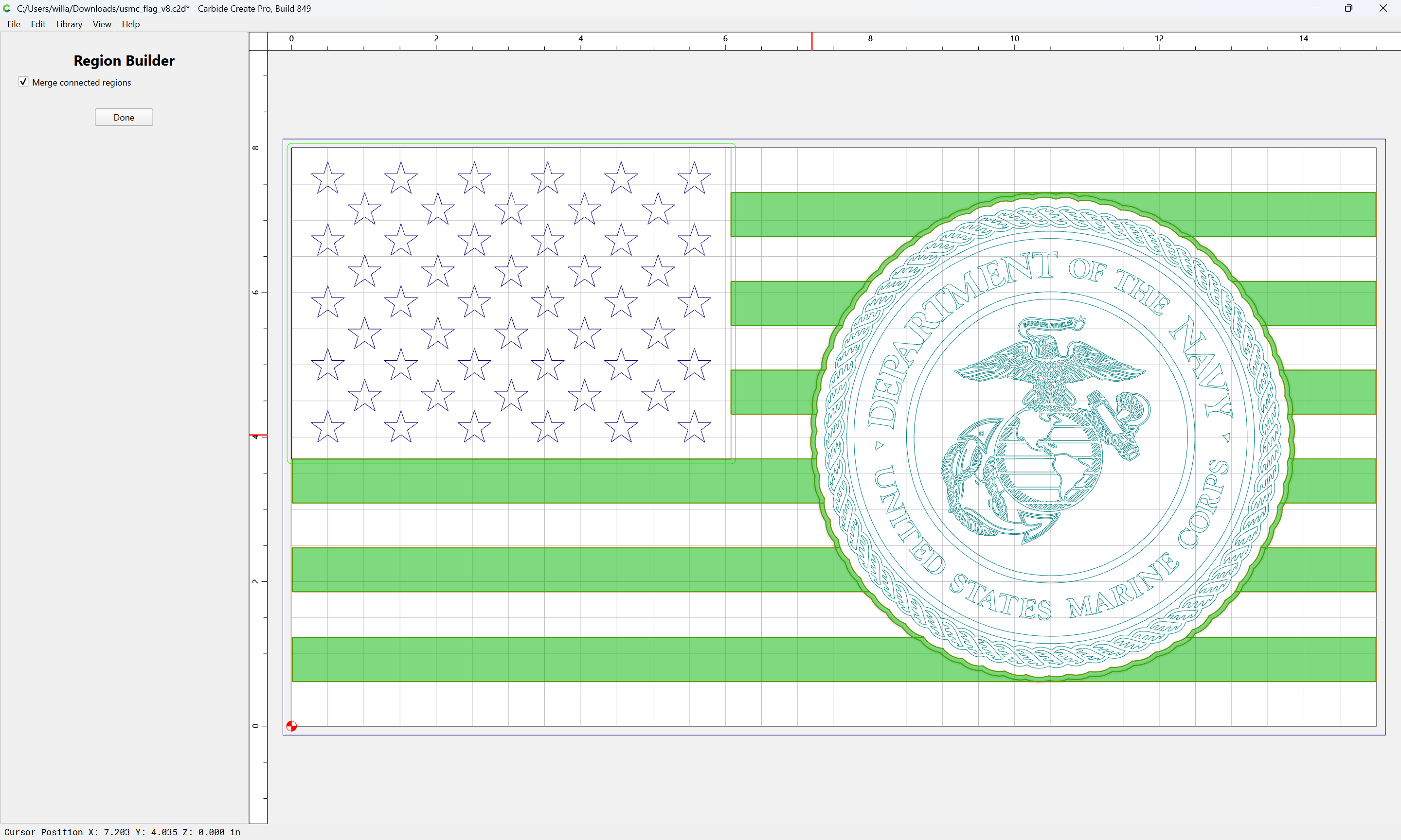

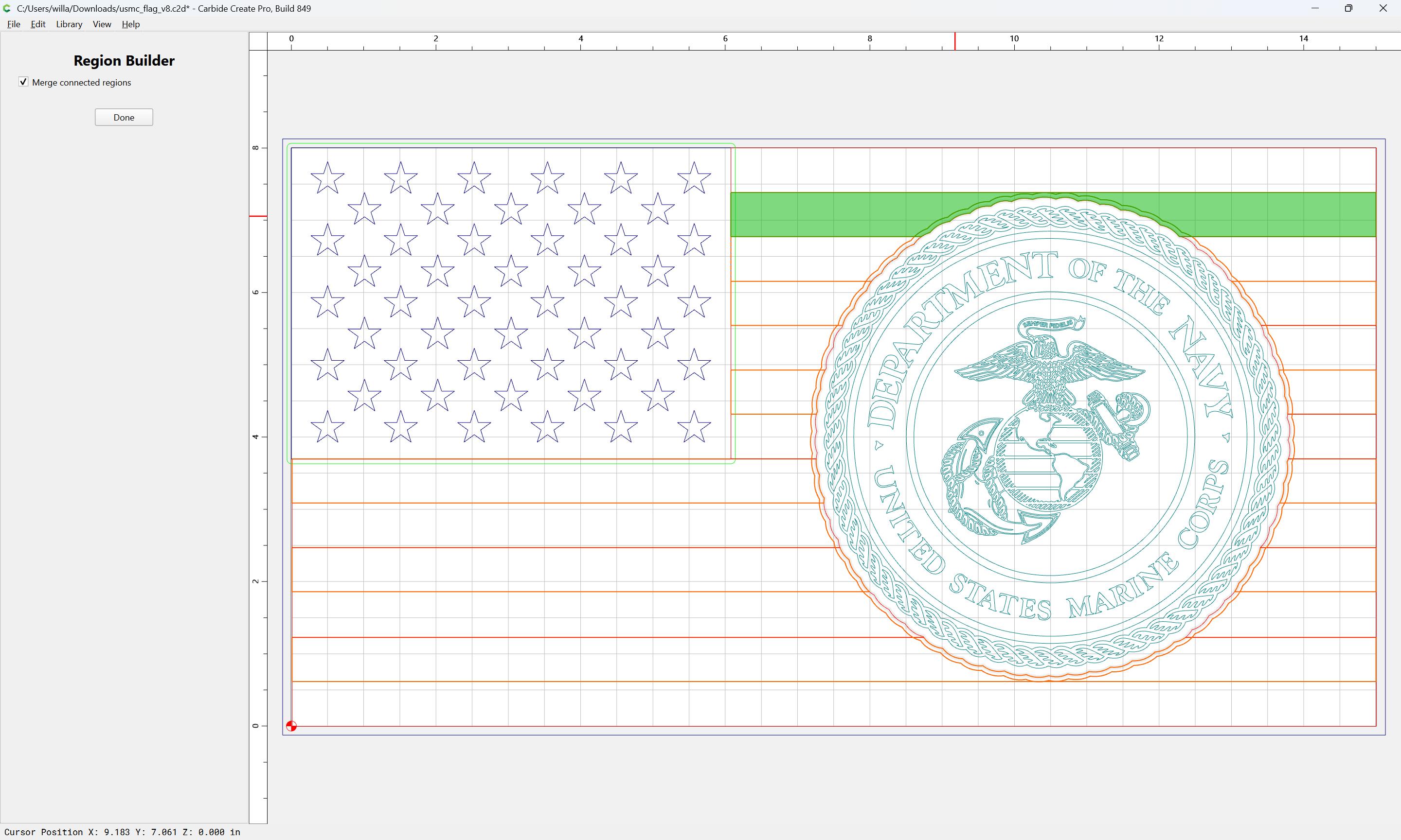

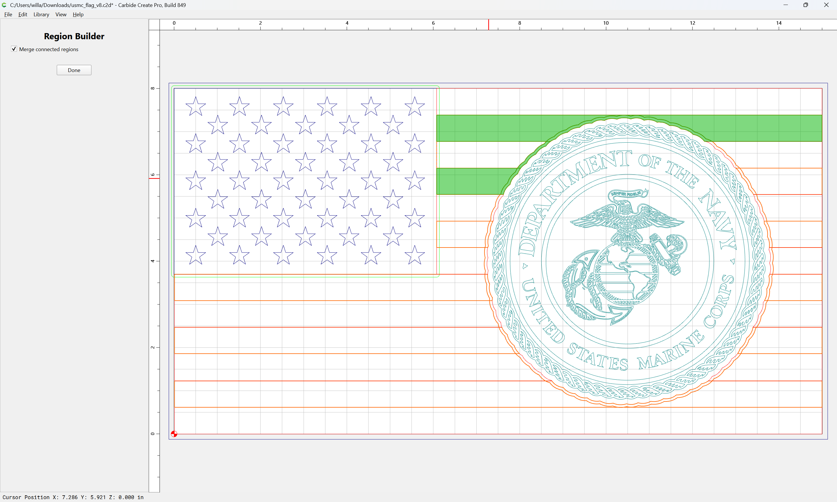

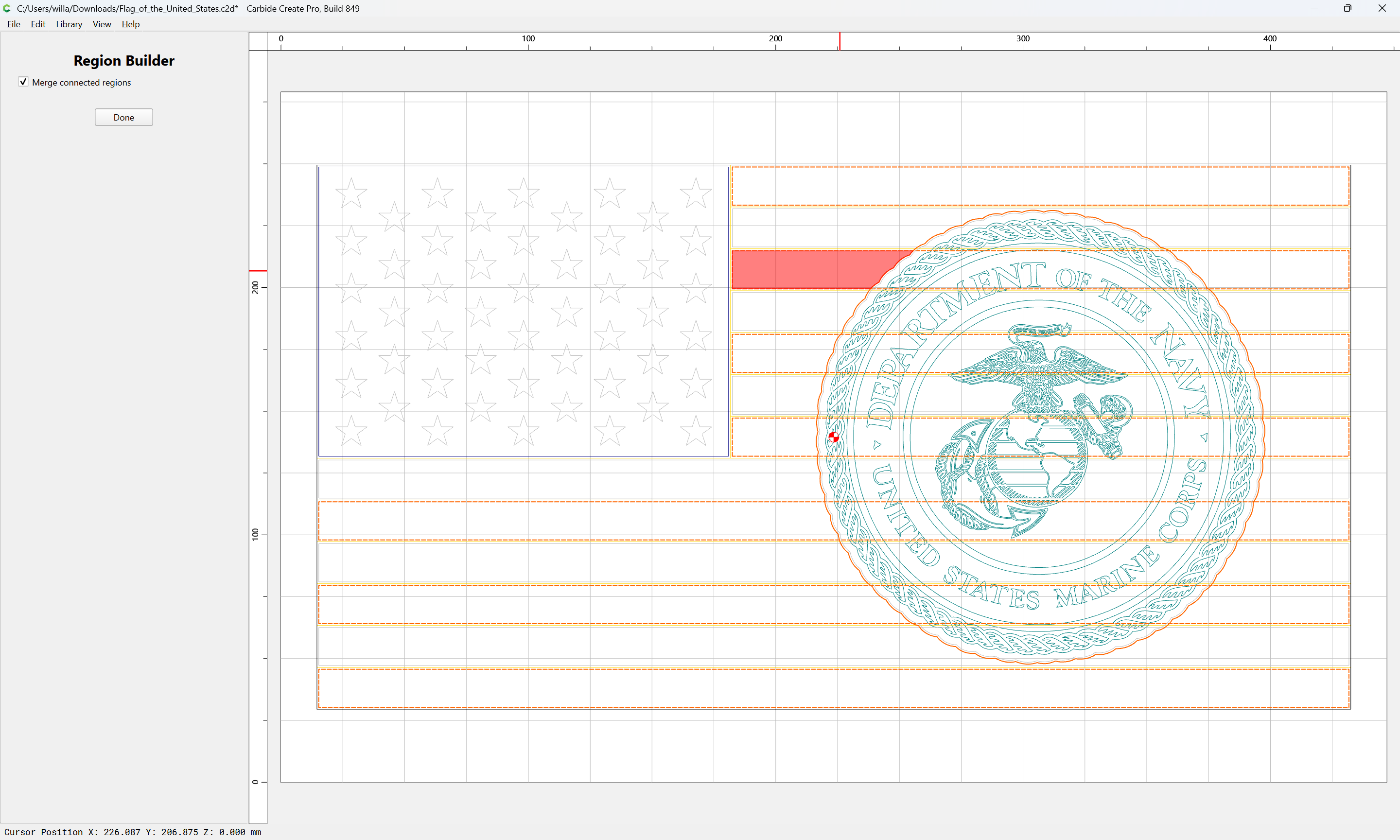

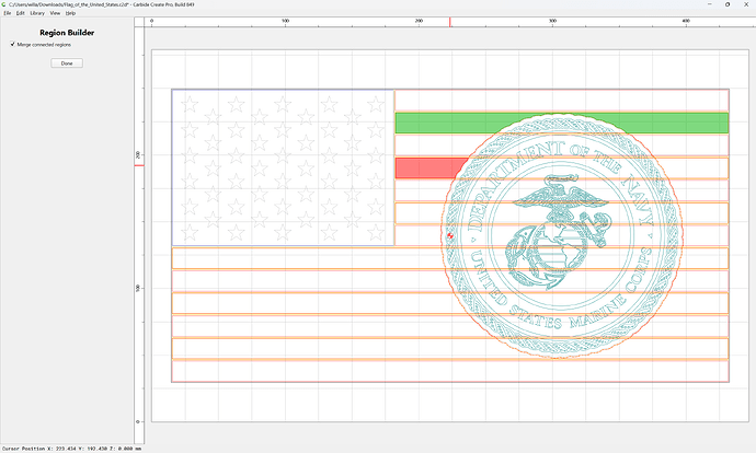

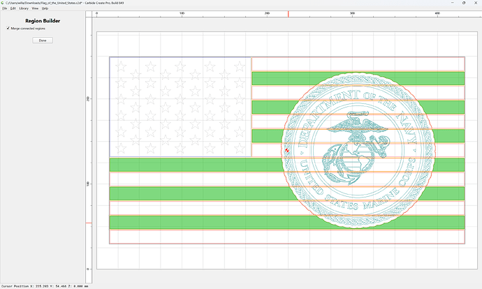

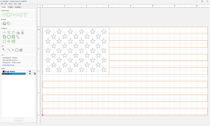

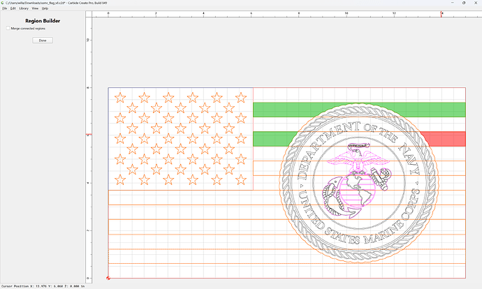

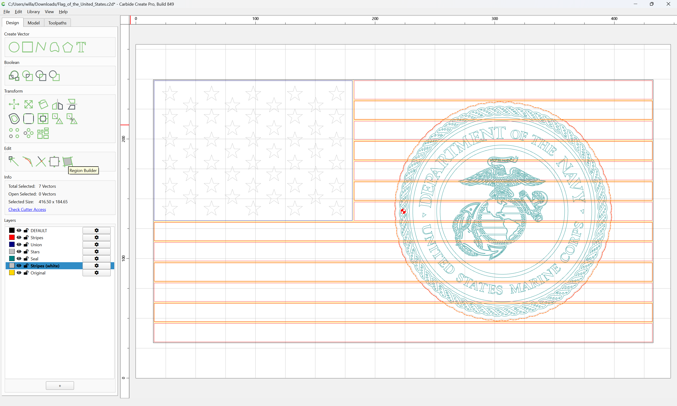

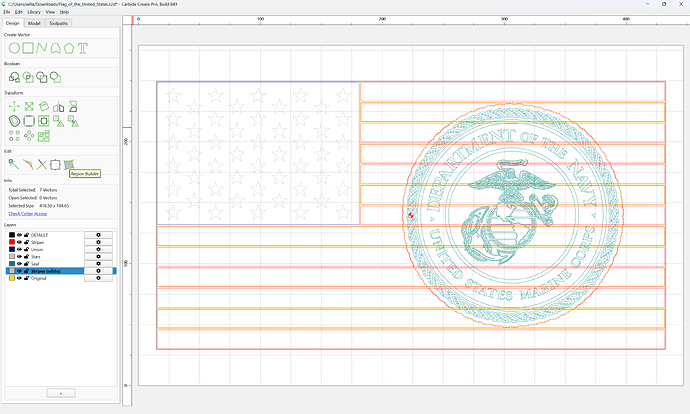

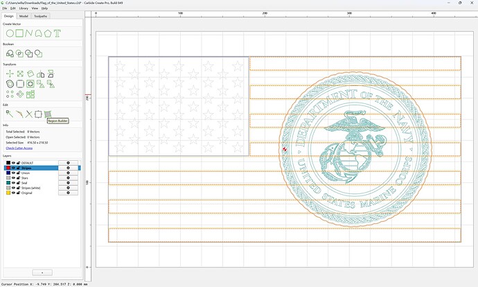

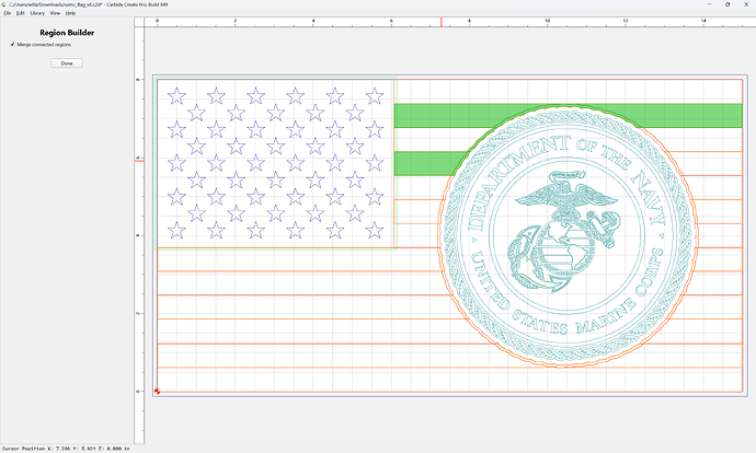

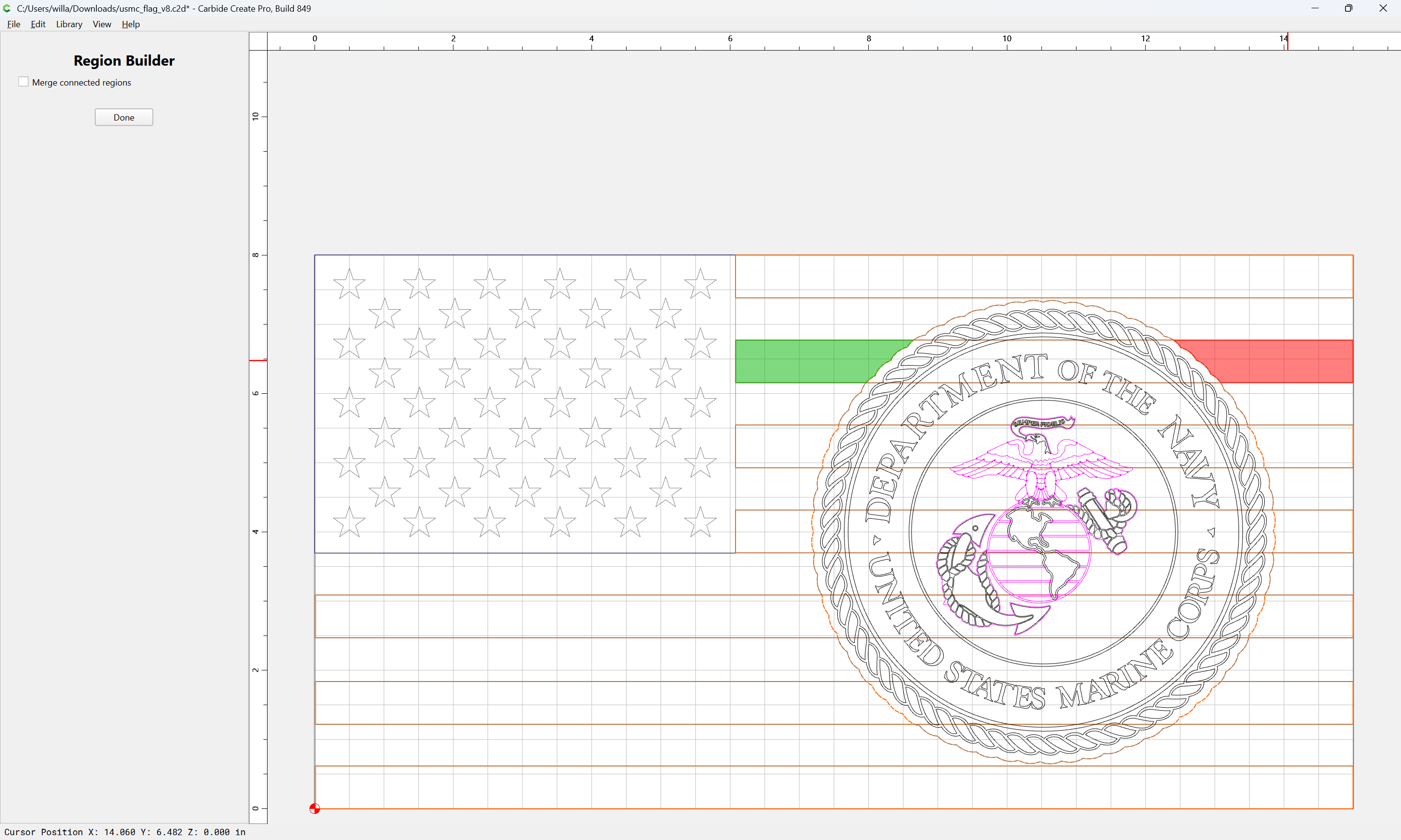

For each set of stripes, select them:

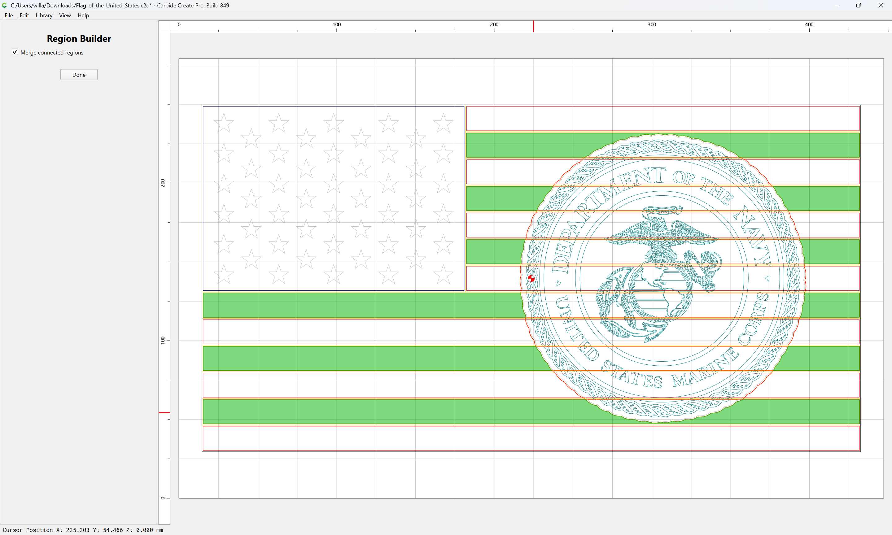

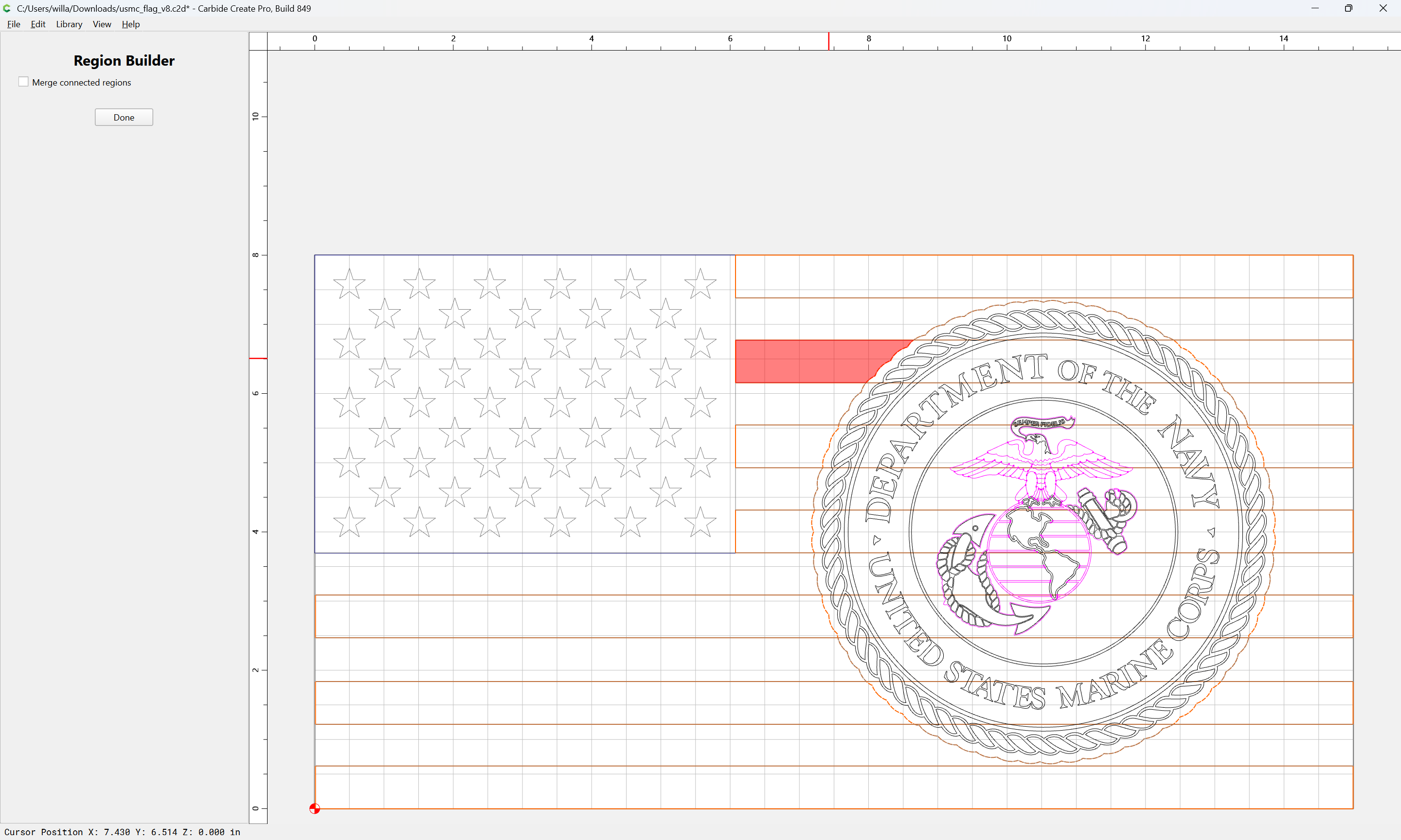

and then use the Region Builder to identify the geometry which one wants:
Yes
click on each region:
repeating until one arrives at:
Done

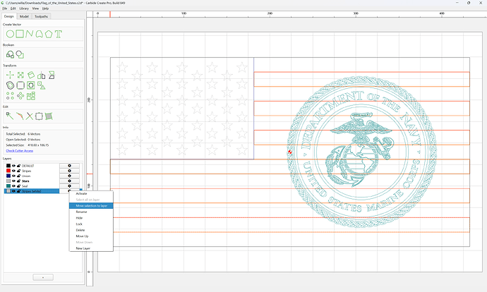

If one forgot to double-click on the matching layer to make it active, move the geometry to that layer:

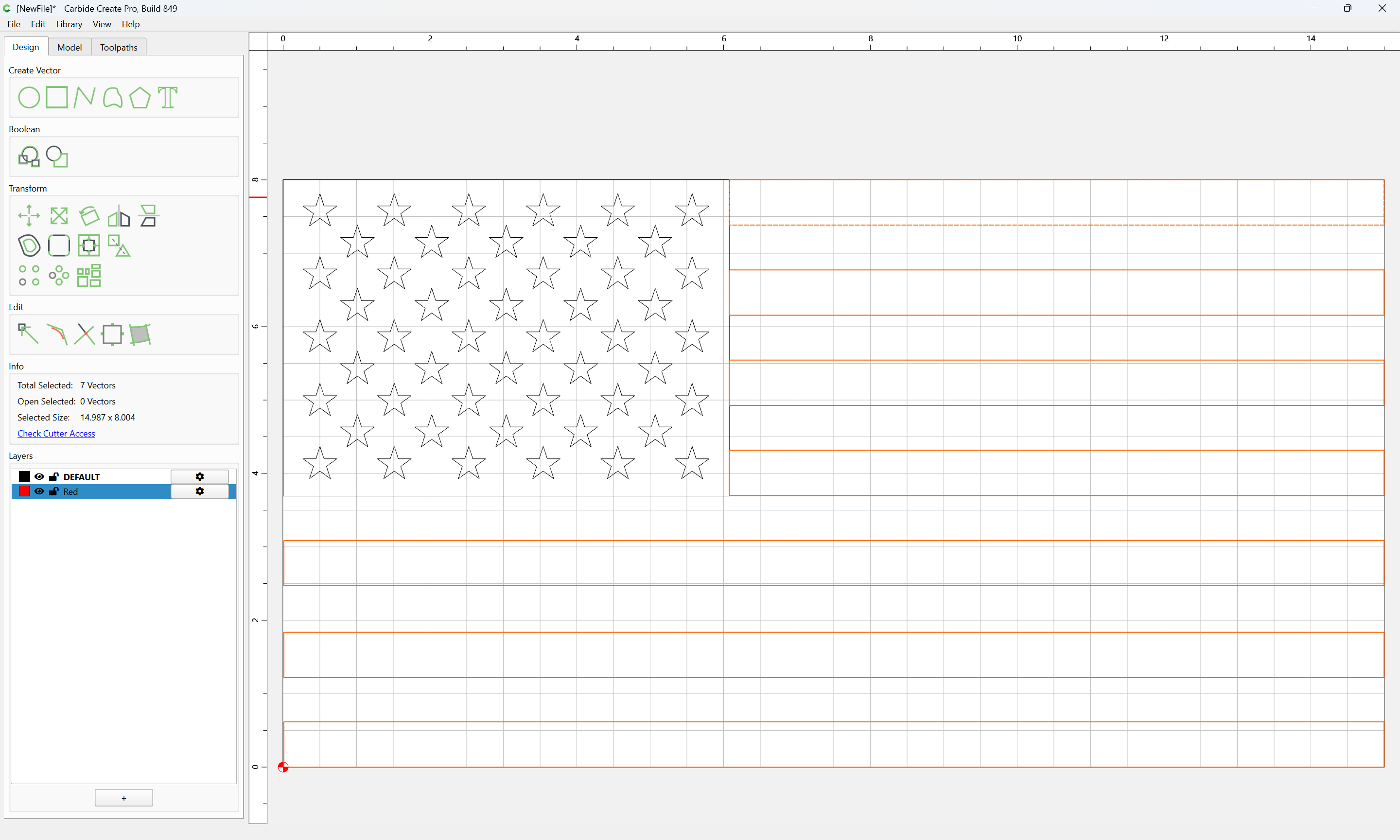

Repeat for the other set of stripes:
Done

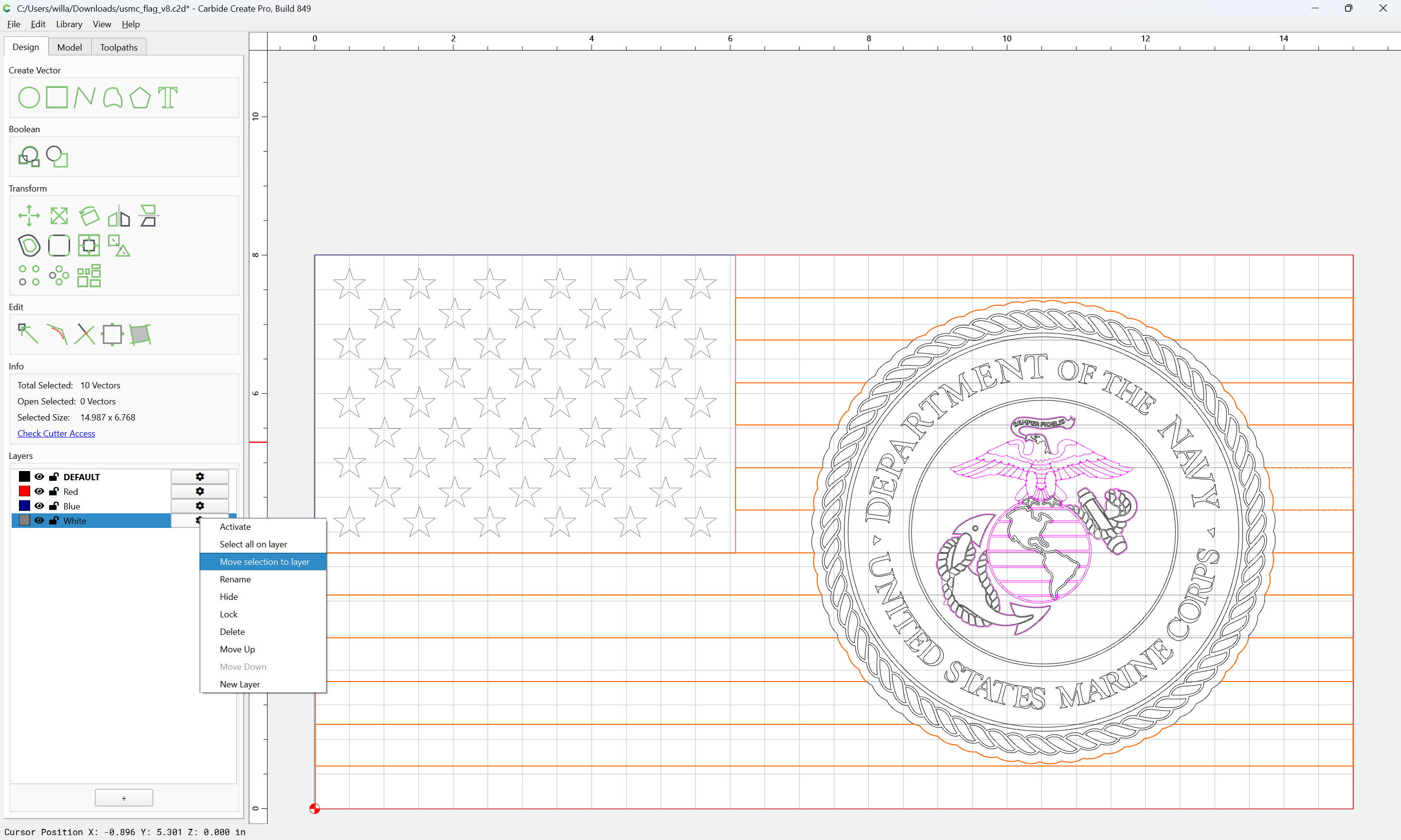

if necessary, Move Selection to Layer
Hide all but a single layer:
and remove the original stripes which were redundant
Repeat as needed:

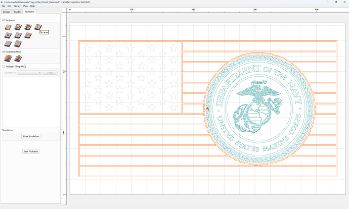

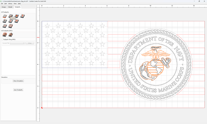

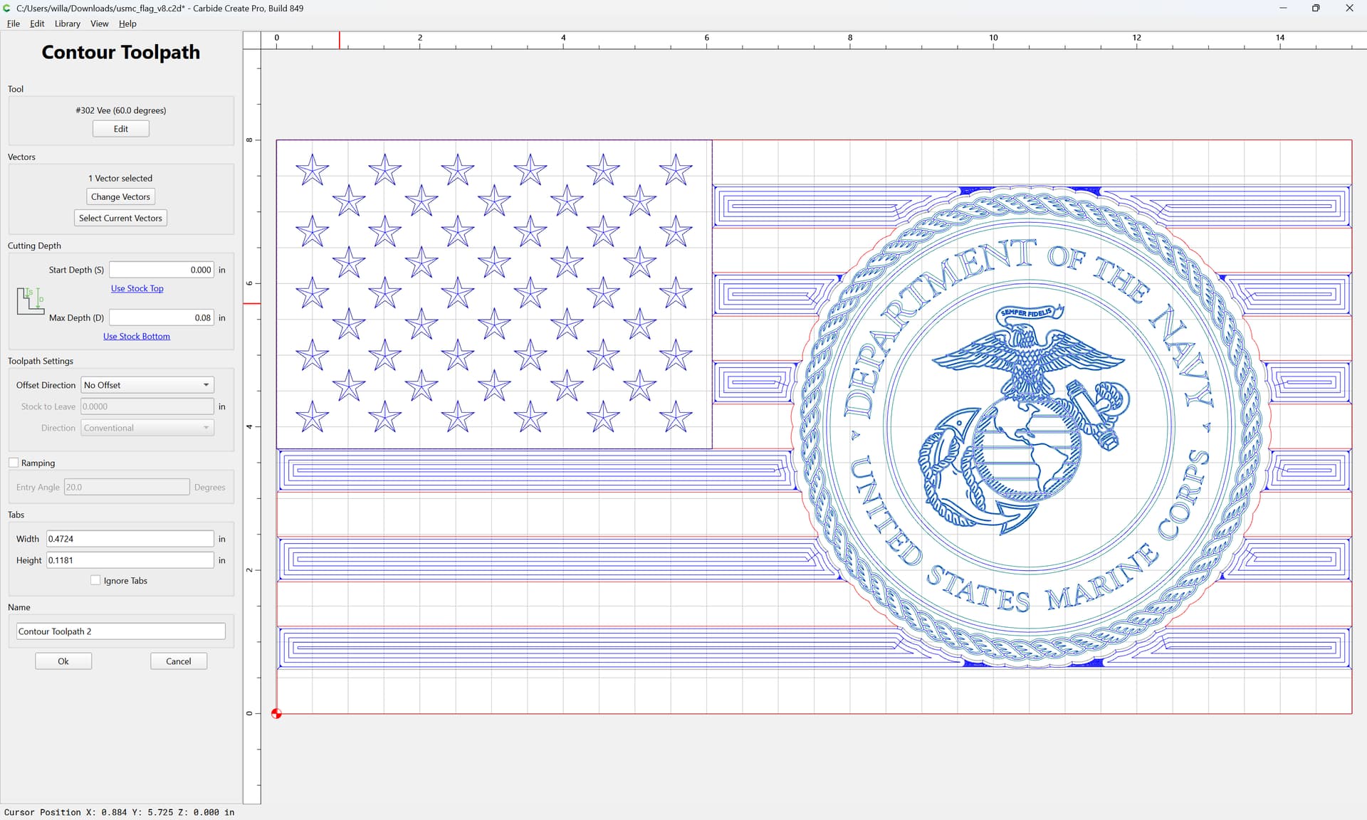

Lastly, assign toolpaths…
For toolpaths, this will depend to an extent on how the design will be coloured and finished (some sort of colouration will be necessary since there are adjacent regions).

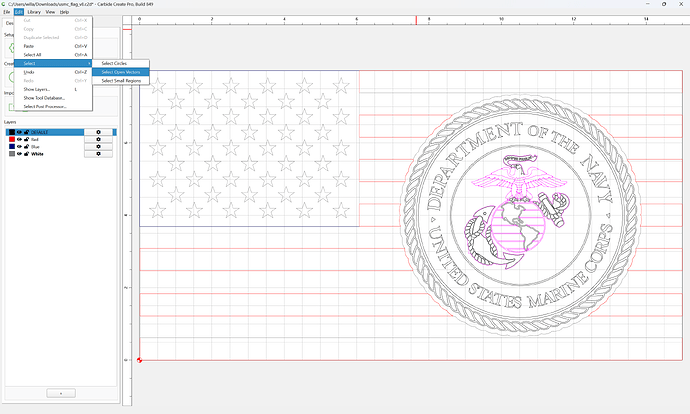

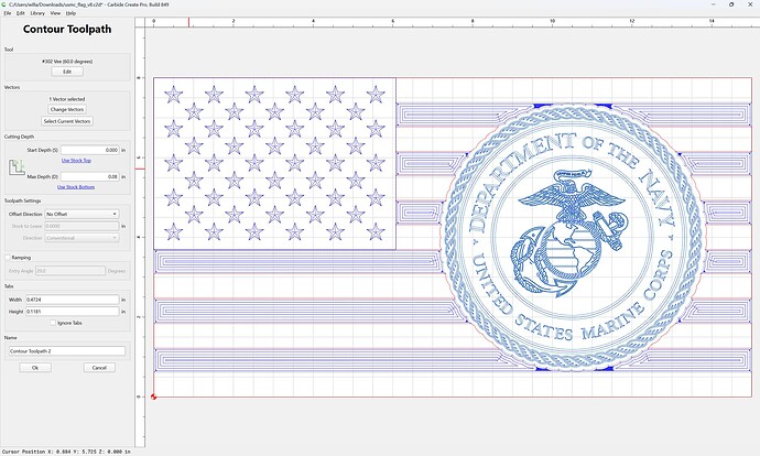

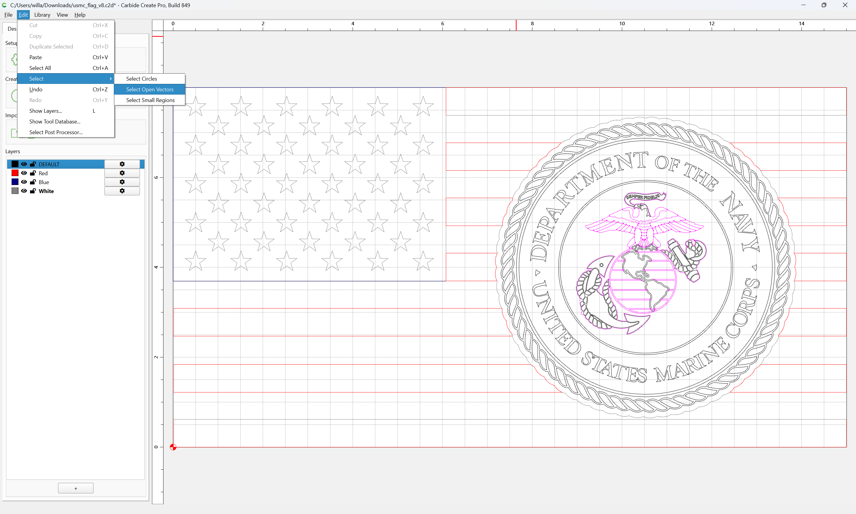

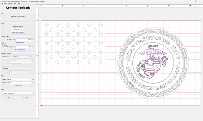

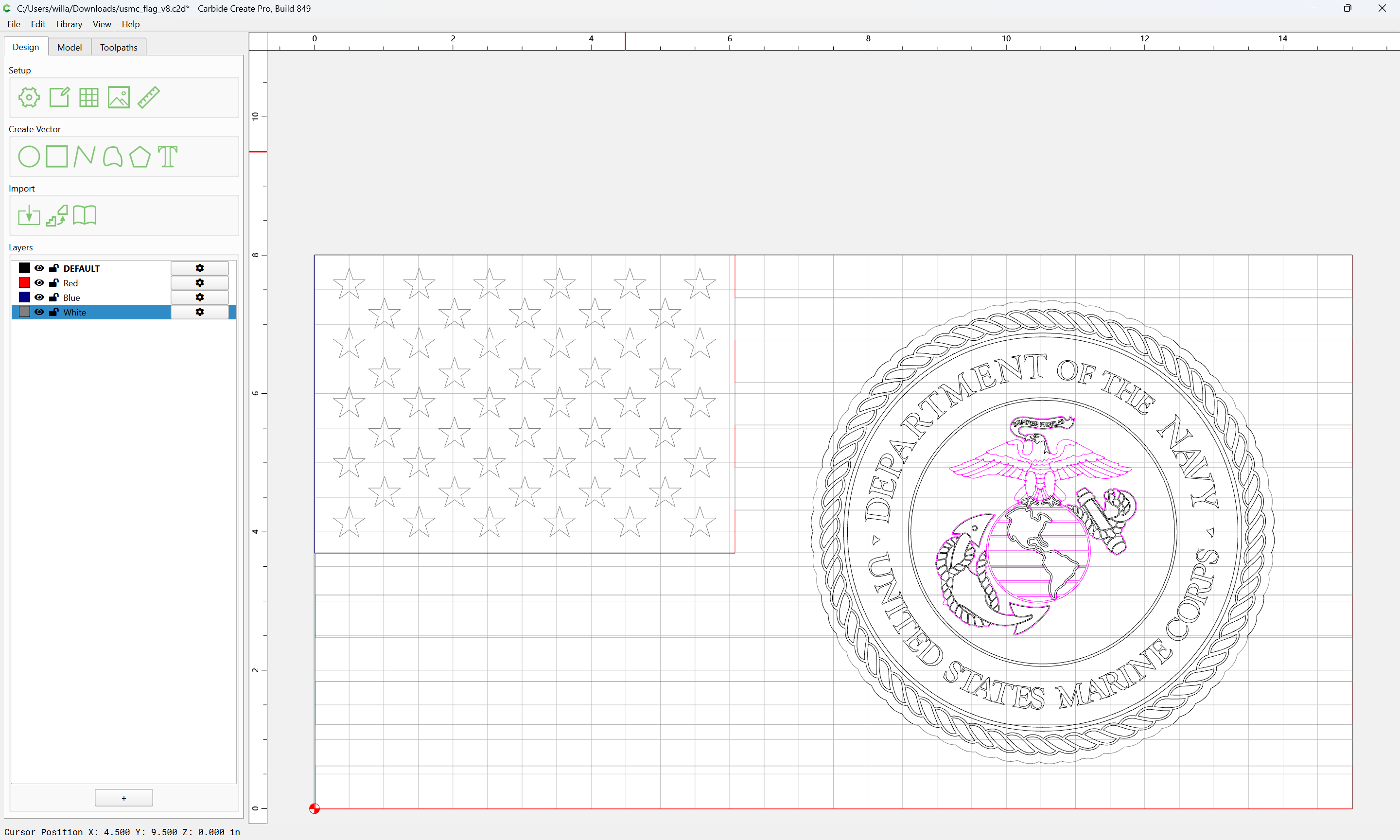

A further consideration is that the imported design may have open geometry (indicated by being magenta) which may only be cut using a Contour toolpath.
Start by selecting the open geometry:
and group it and if desired move to a new layer:

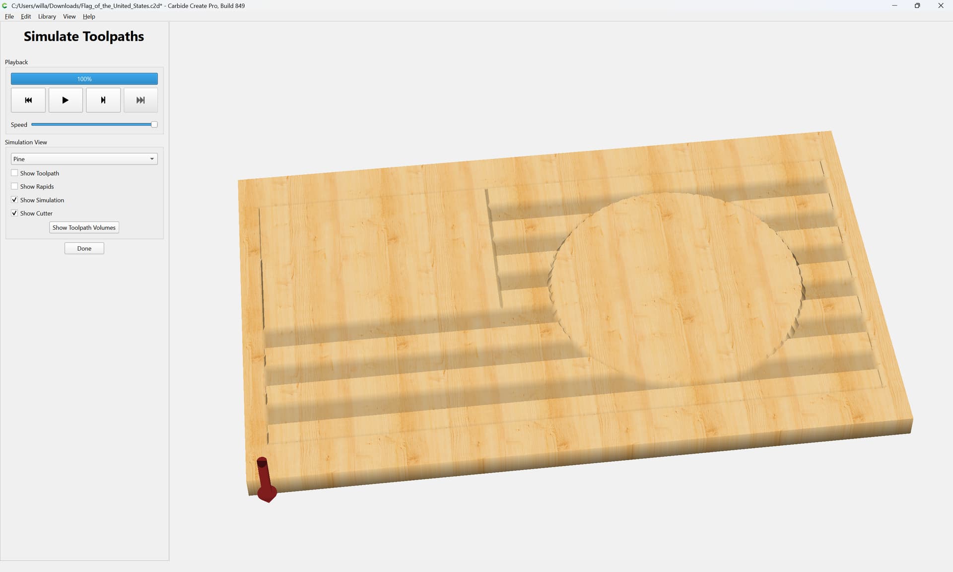

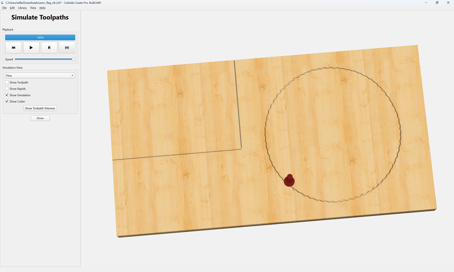

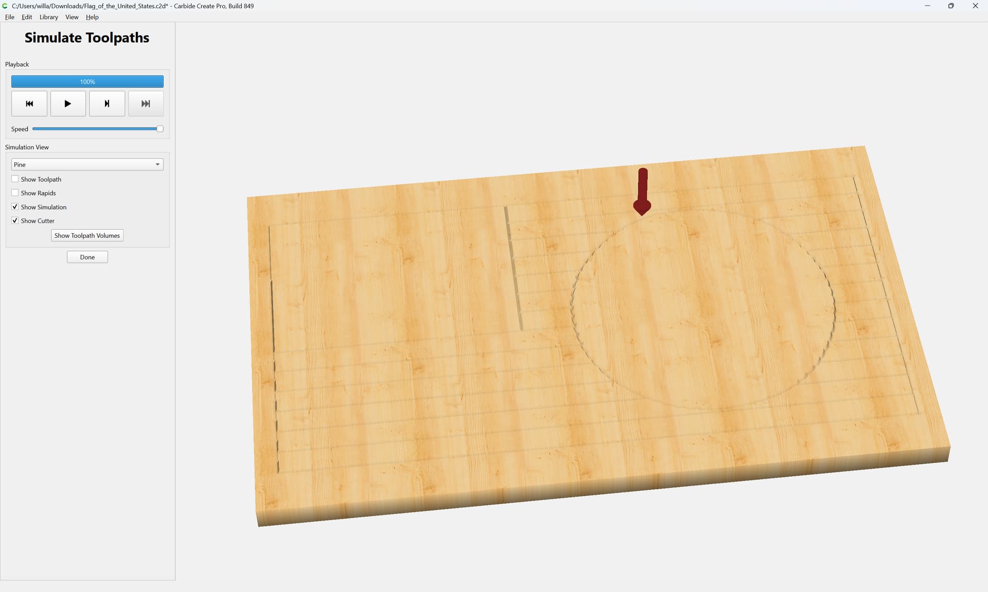

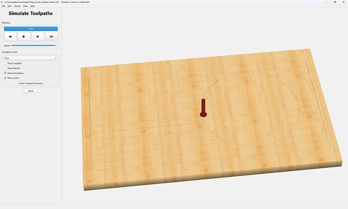

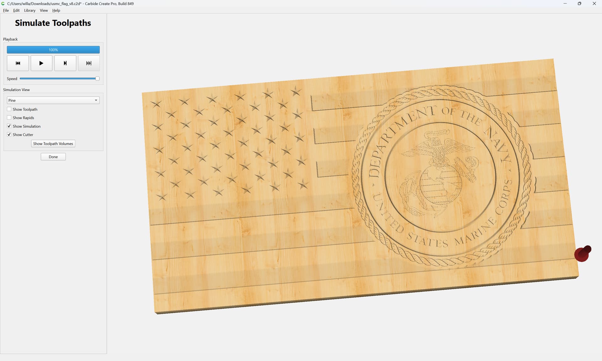

check the simulation
and adjust as desired

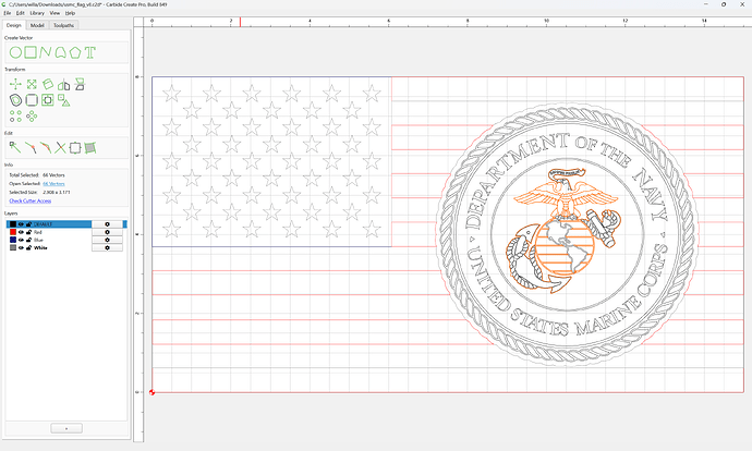

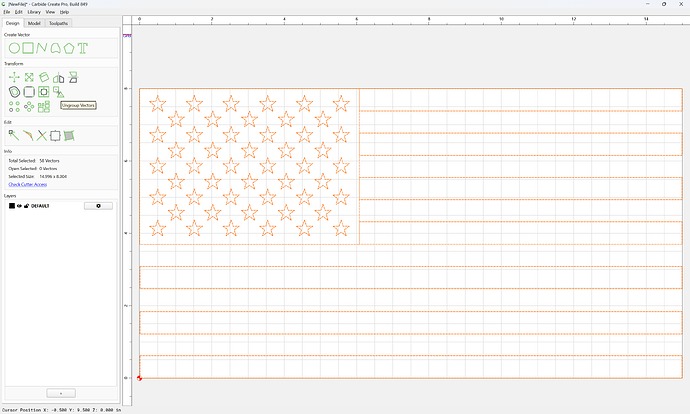

For the balance of the design, check for doubled-up geometry:
and delete it:

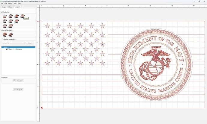

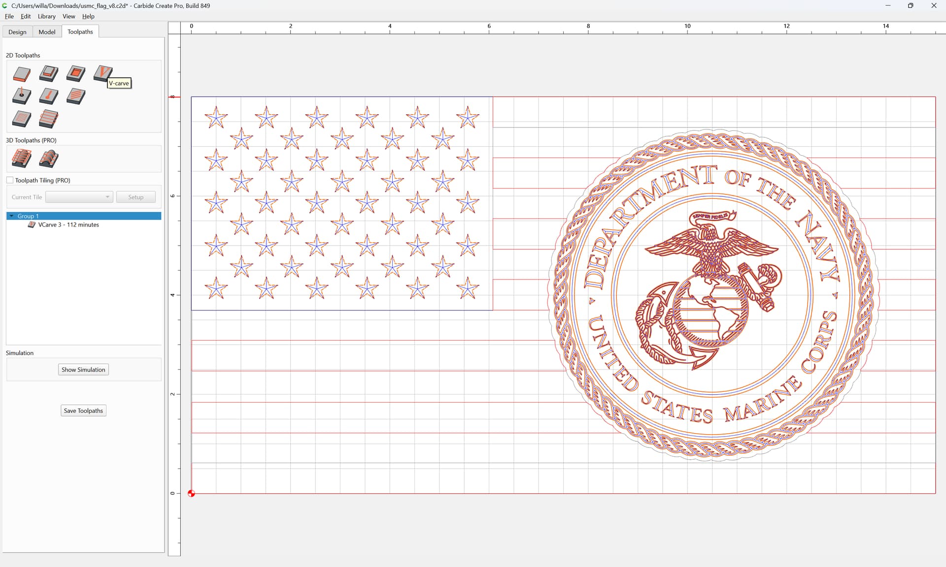

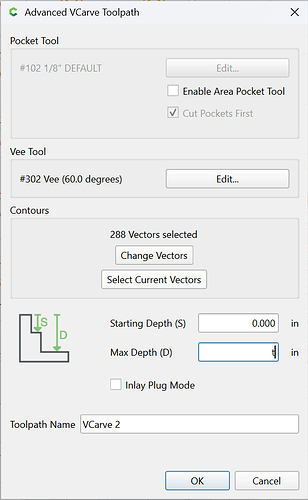

and then assign a V carving toolpath to suitable elements:
and adjust the selection and treatment of various elements until one arrives at a desired result.
Alternately, import a version of the design made up of closed geometry and only use a V carving toolpath.
Switching to the closed version allows one to use a single V-carving toolpath:
Presumably, the white stars would also be cut away:
V-carve toolpath

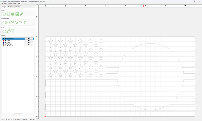

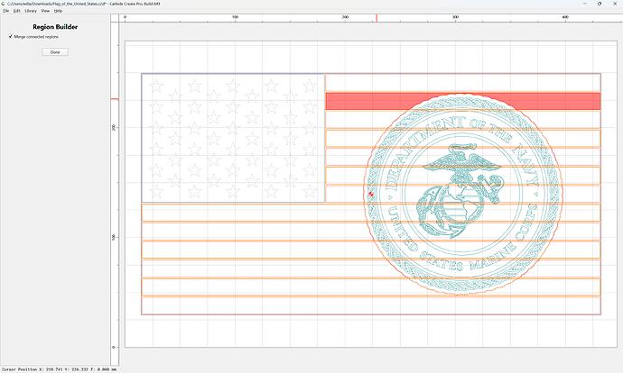

After sleeping on it, I believe that extending the white region to cut between the red stripes and the seal will improve the appearance/separation, and make painting easier — select the strips and the offset geometries:
and use Region Builder
Yes
to construct a region of the white stripes and the offset area:

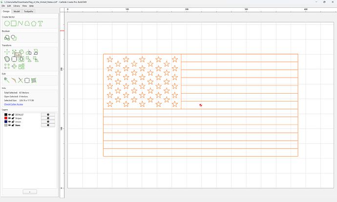

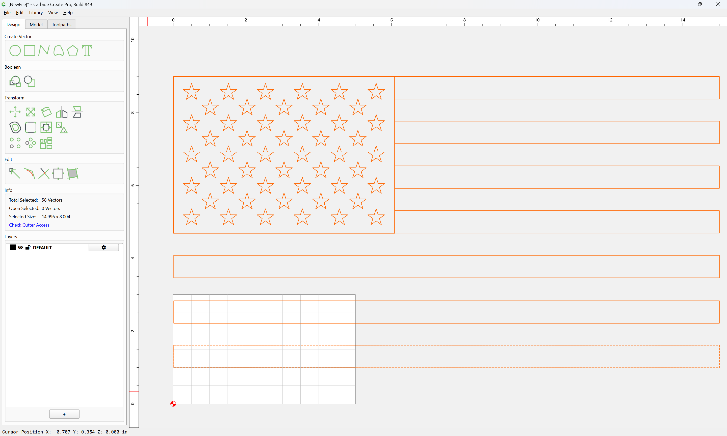

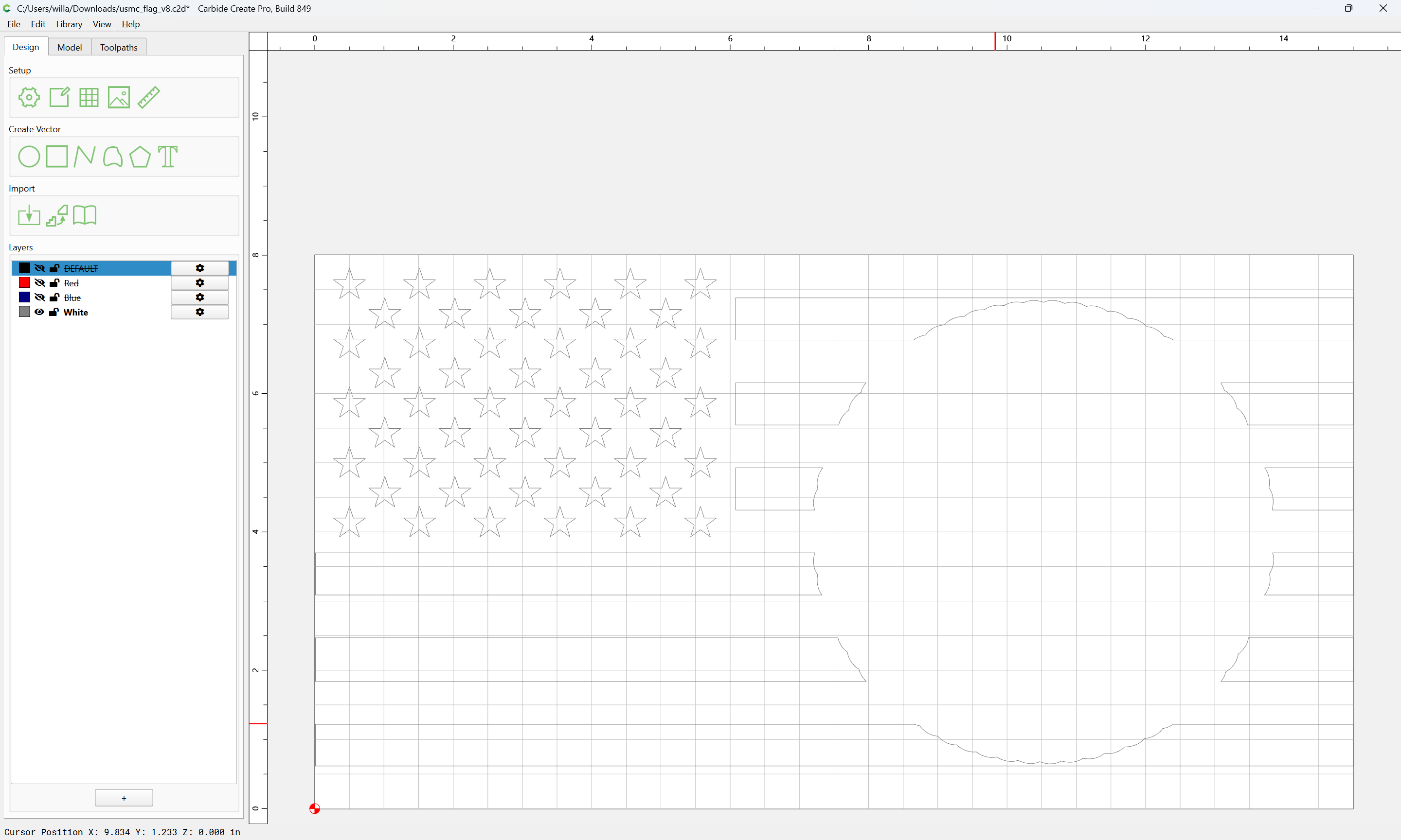

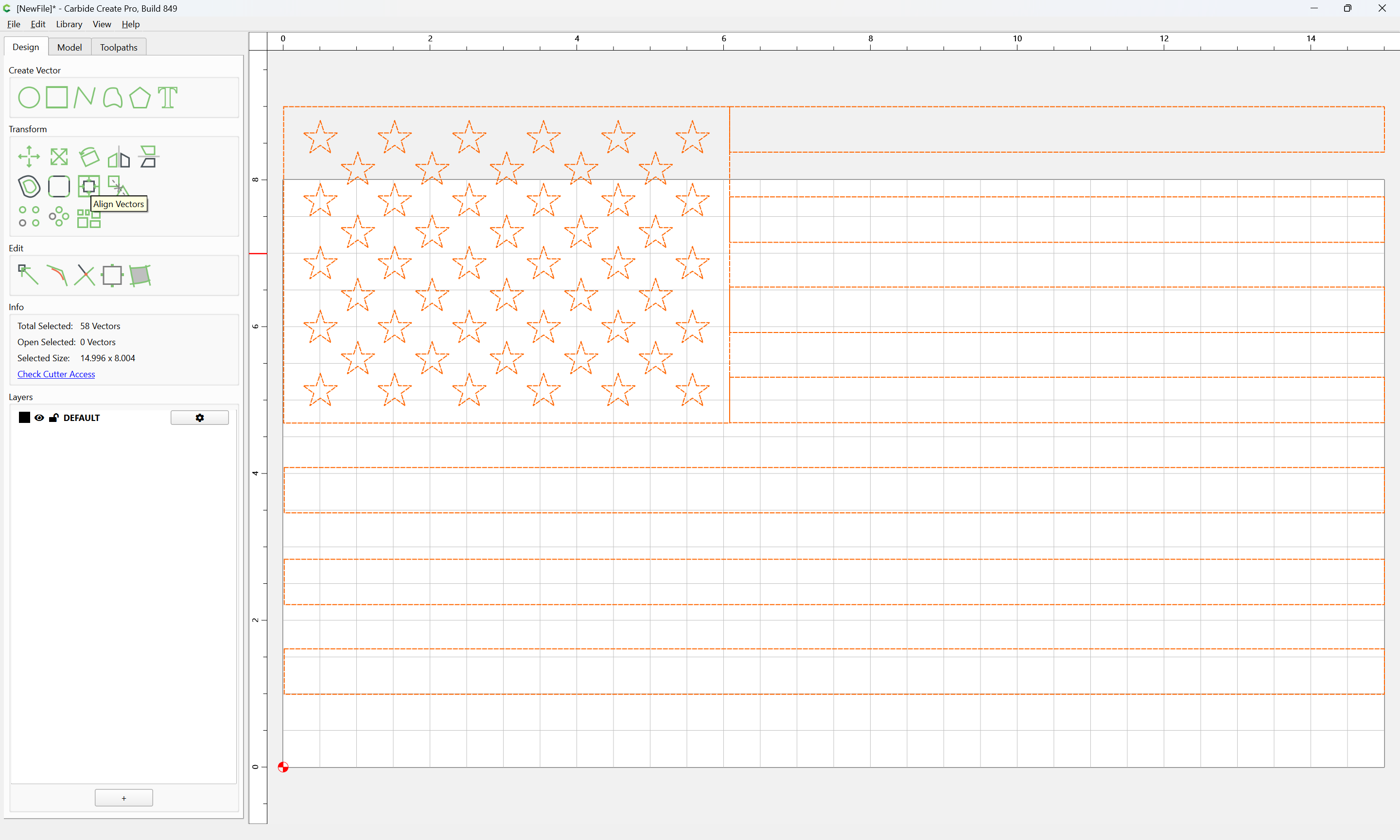

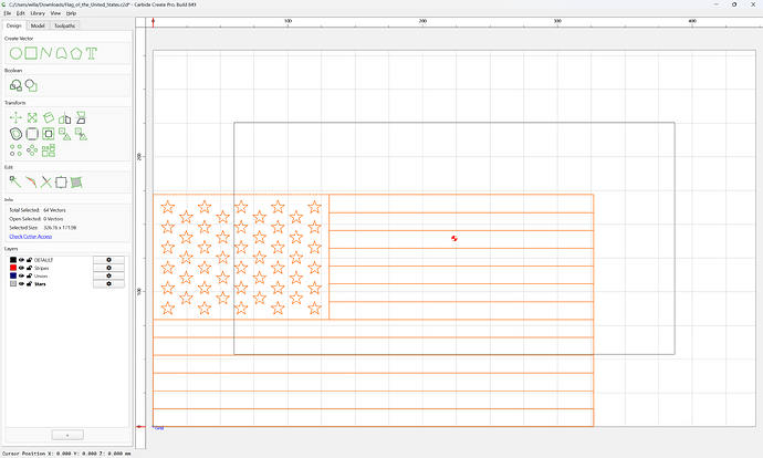

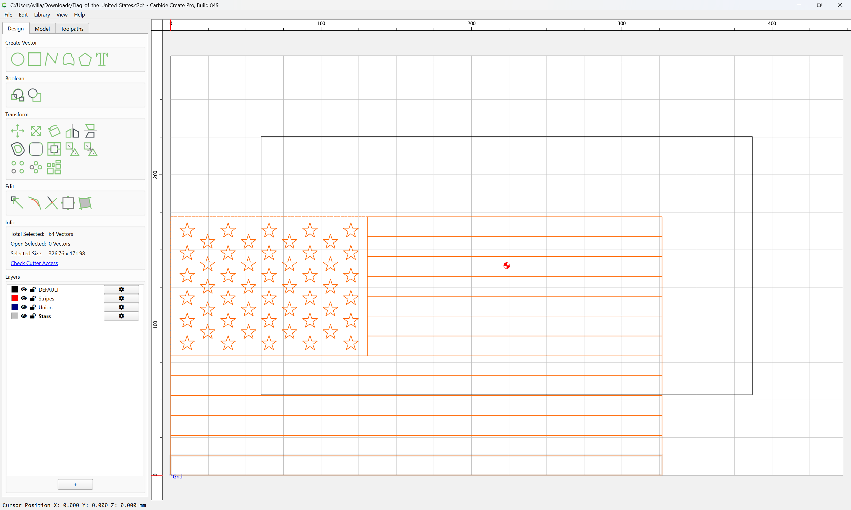

Starting with that latter, we begin with the flag file from:

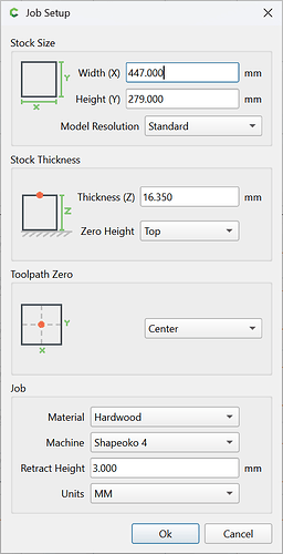

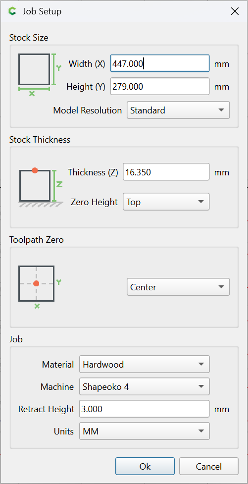

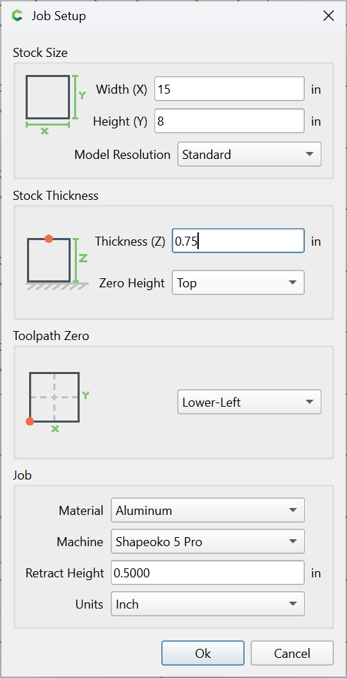

The next consideration is Job Setup — I will be using an Ikea APTITLIG
Cutting board, bamboo, 17 ¾x11 ":
https://www.ikea.com/us/en/p/aptitlig-cutting-board-bamboo-80233430

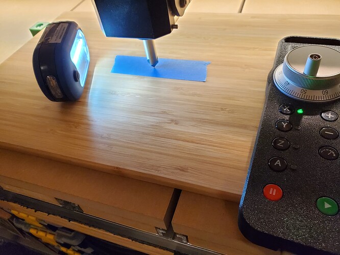

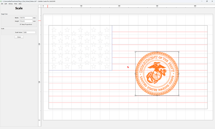

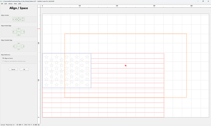

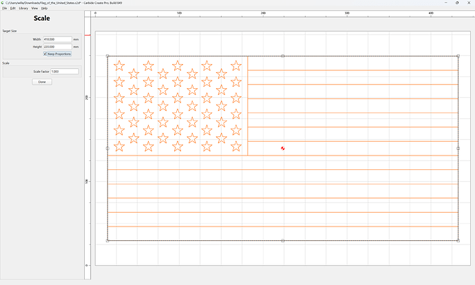

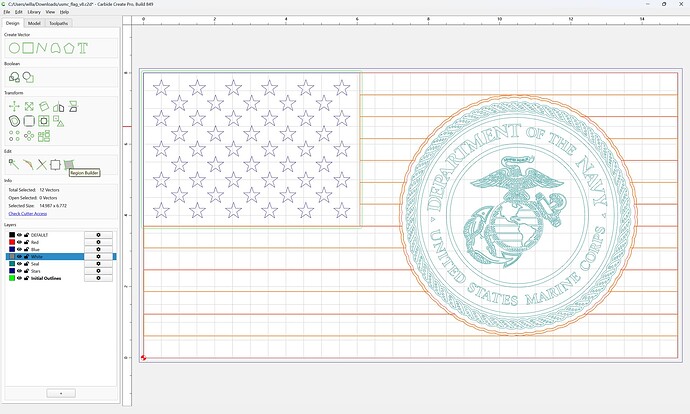

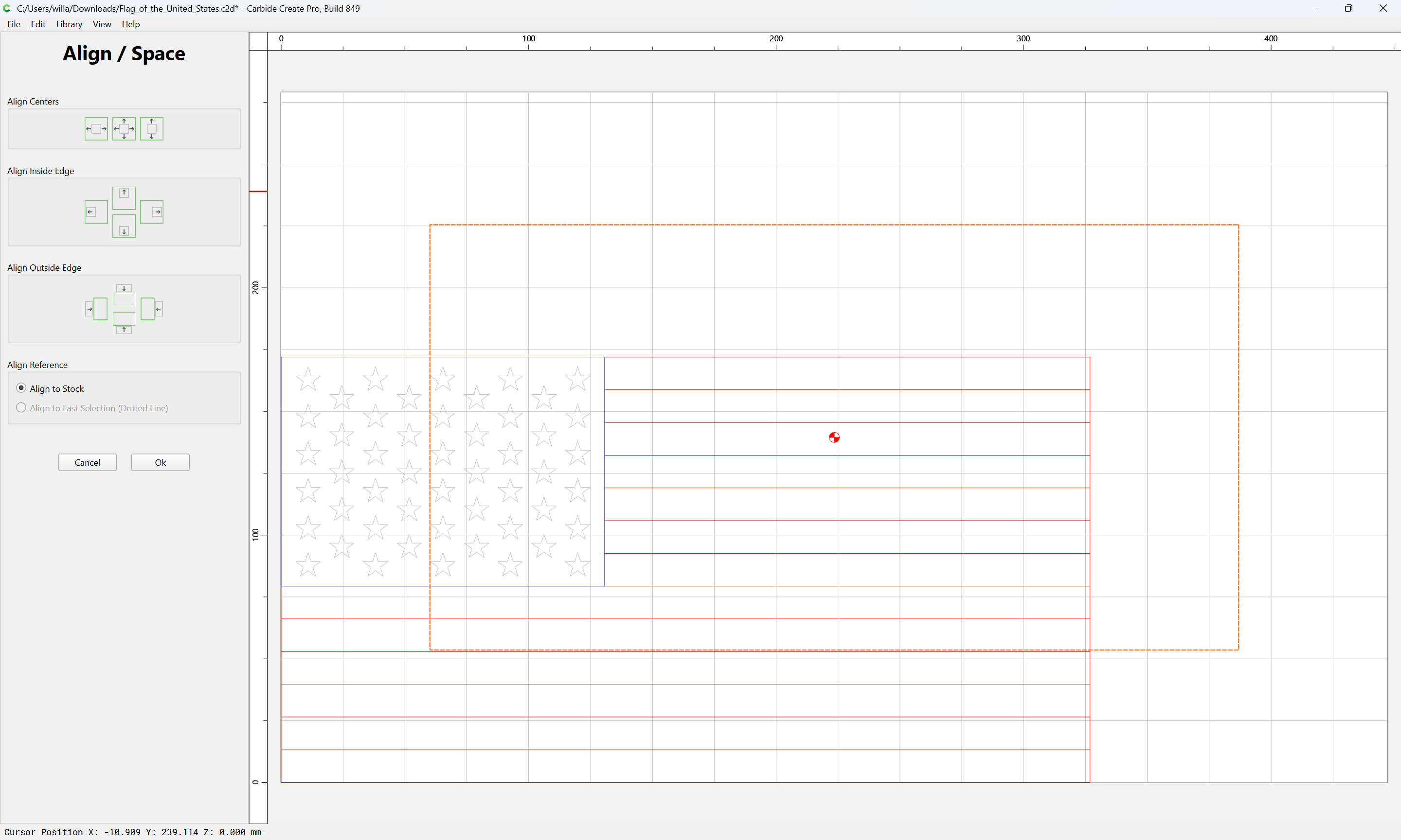

so we measure one in metric and adjust Job Setup to match — note that the top/bottom dimensions are different due to the angled sides — we will use the “bottom” dimensions which is the side where when landscape it is taller top–bottom and narrower left–right. Using center for Origin, so it will be necessary to non-destructively mark the measured center and set zero at that position relative to the board when clamped:
Ok

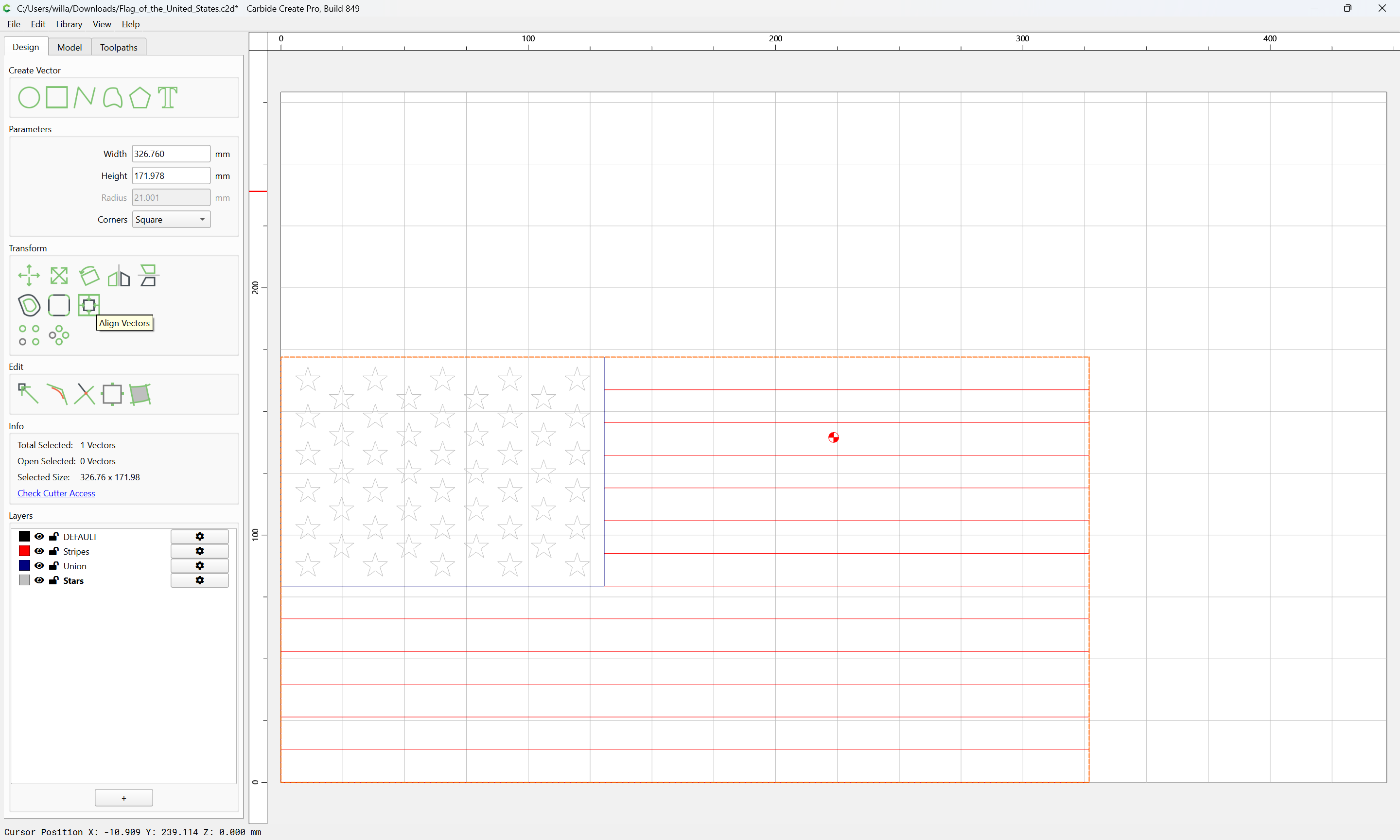

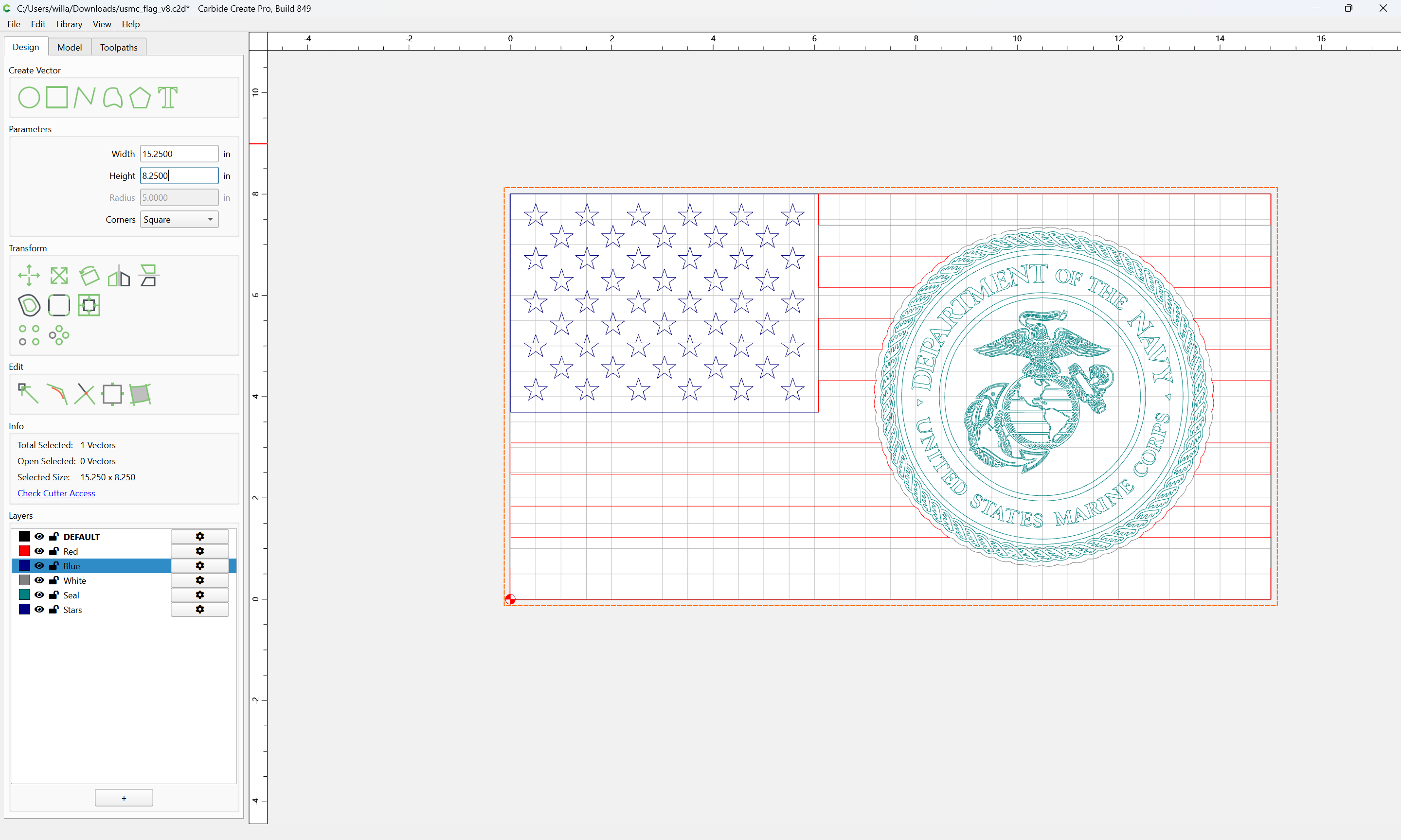

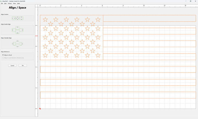

Select the outer geometry:
and align it to the center of the stock:
OK

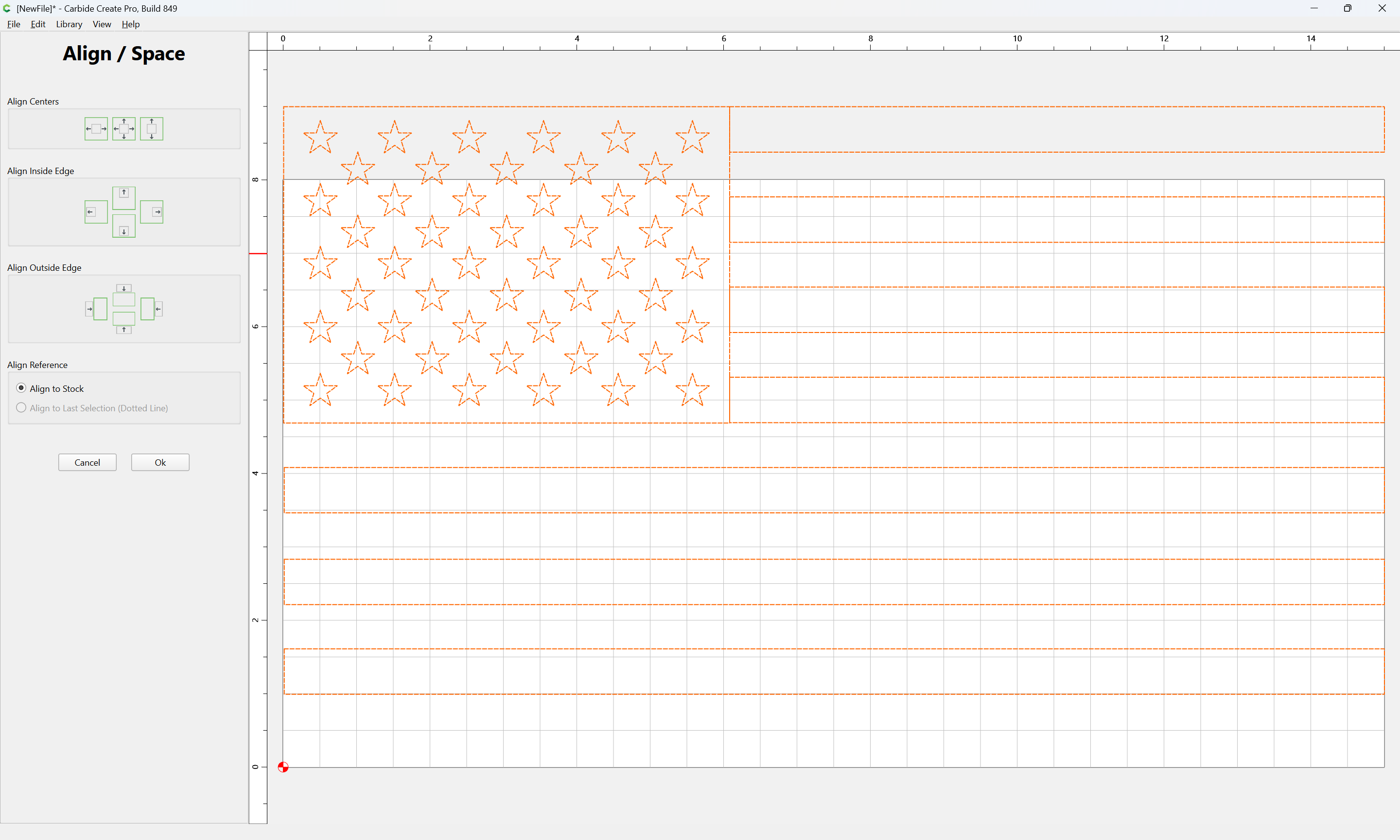

then select everything else:
and move it into register at the center:
(this avoids grouping and disturbing layer assignments)

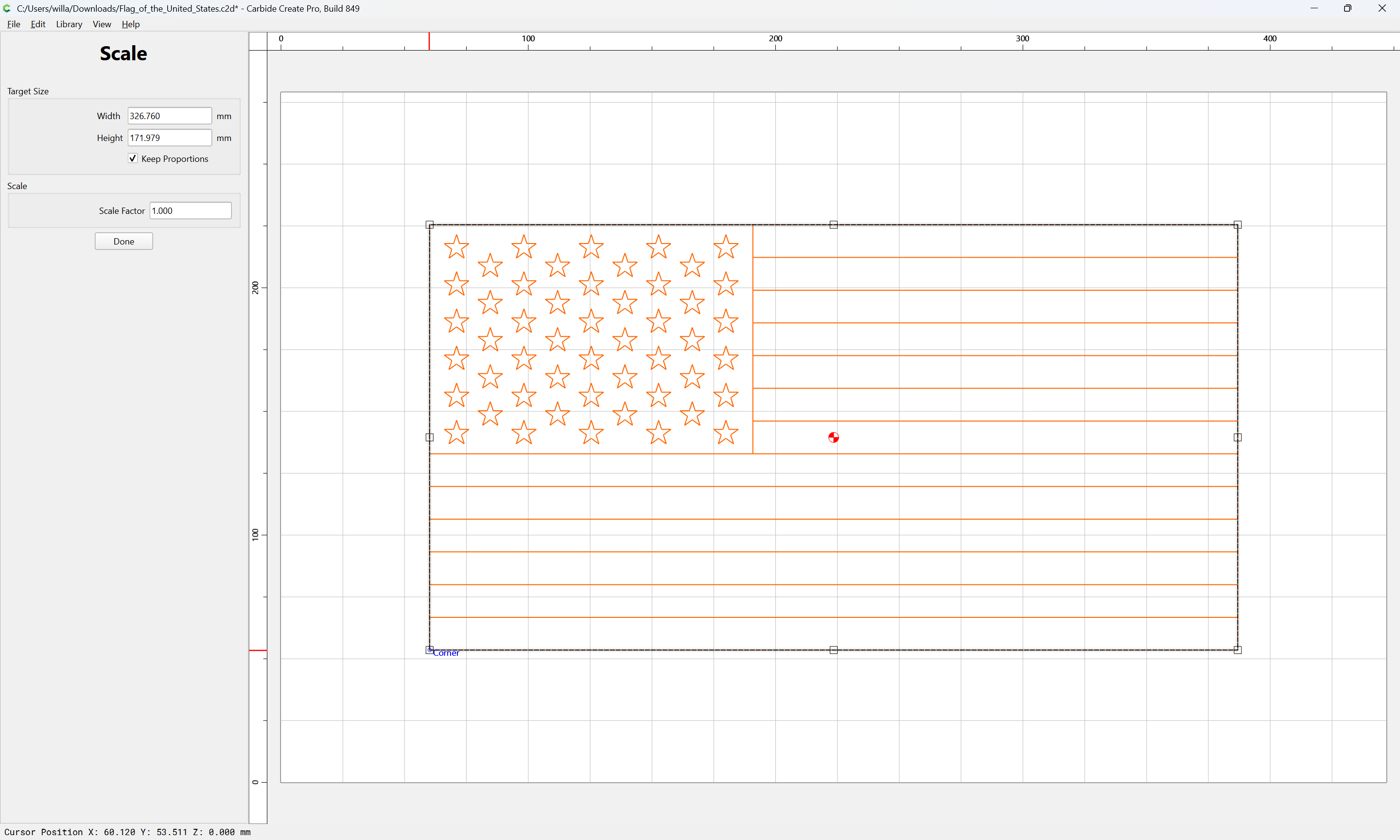

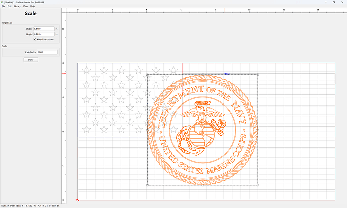

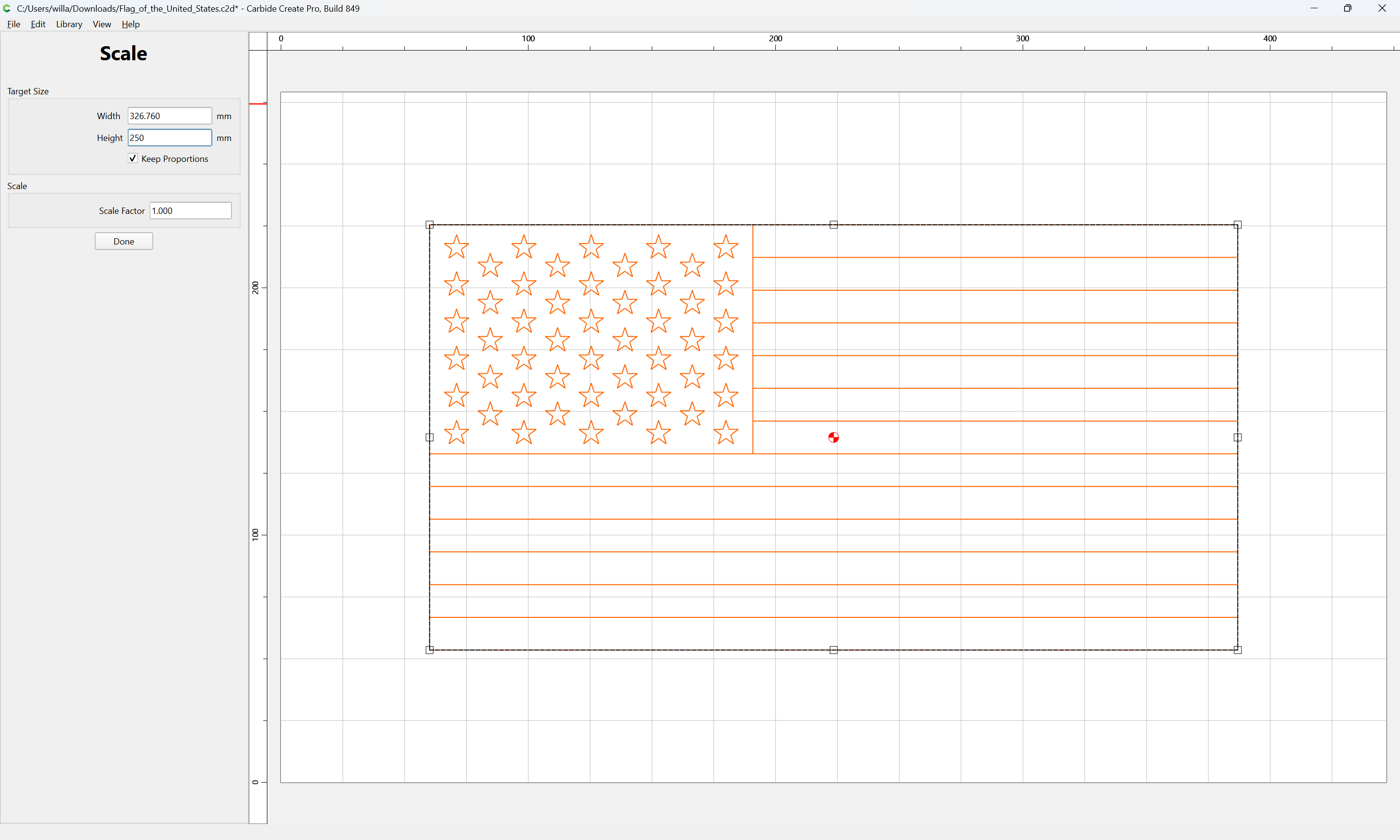

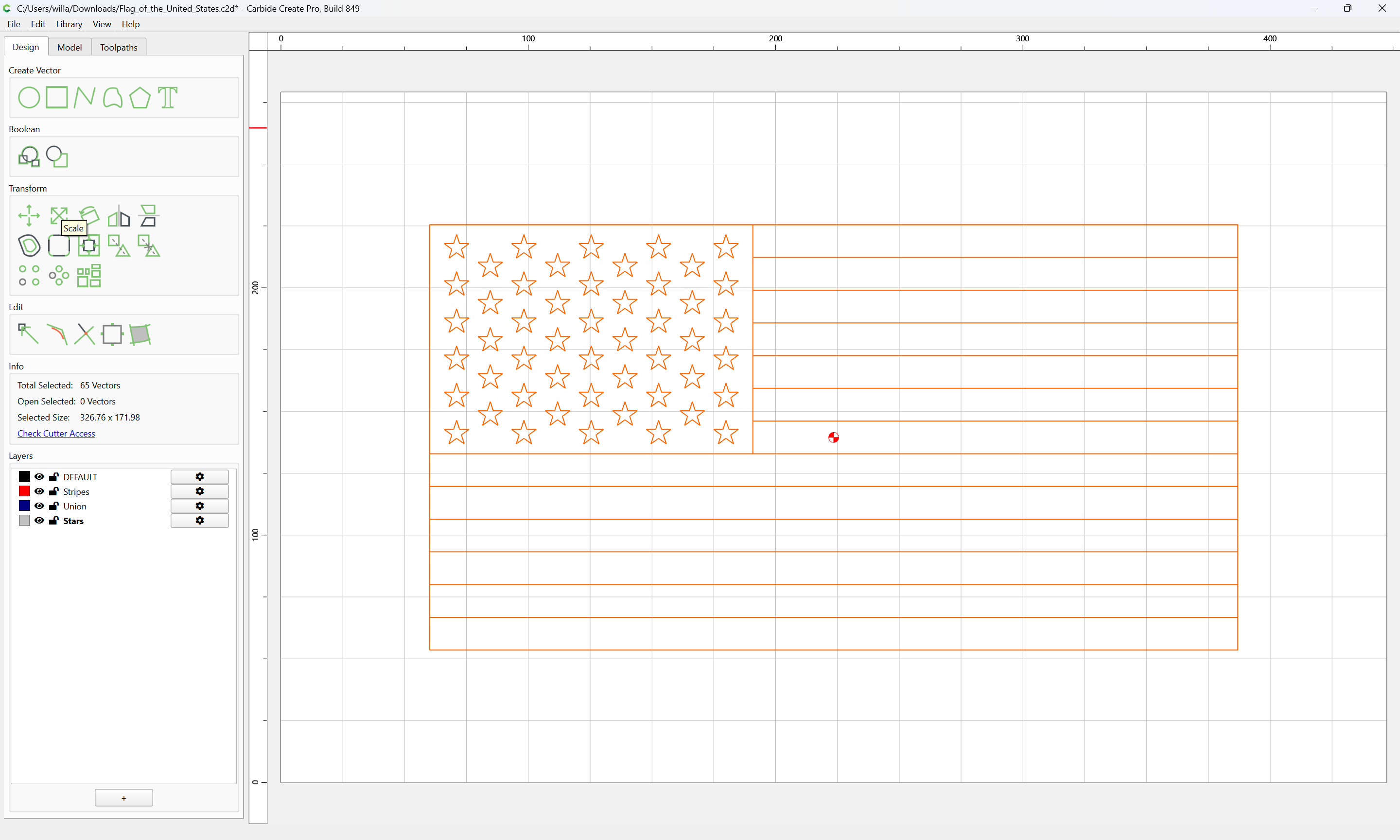

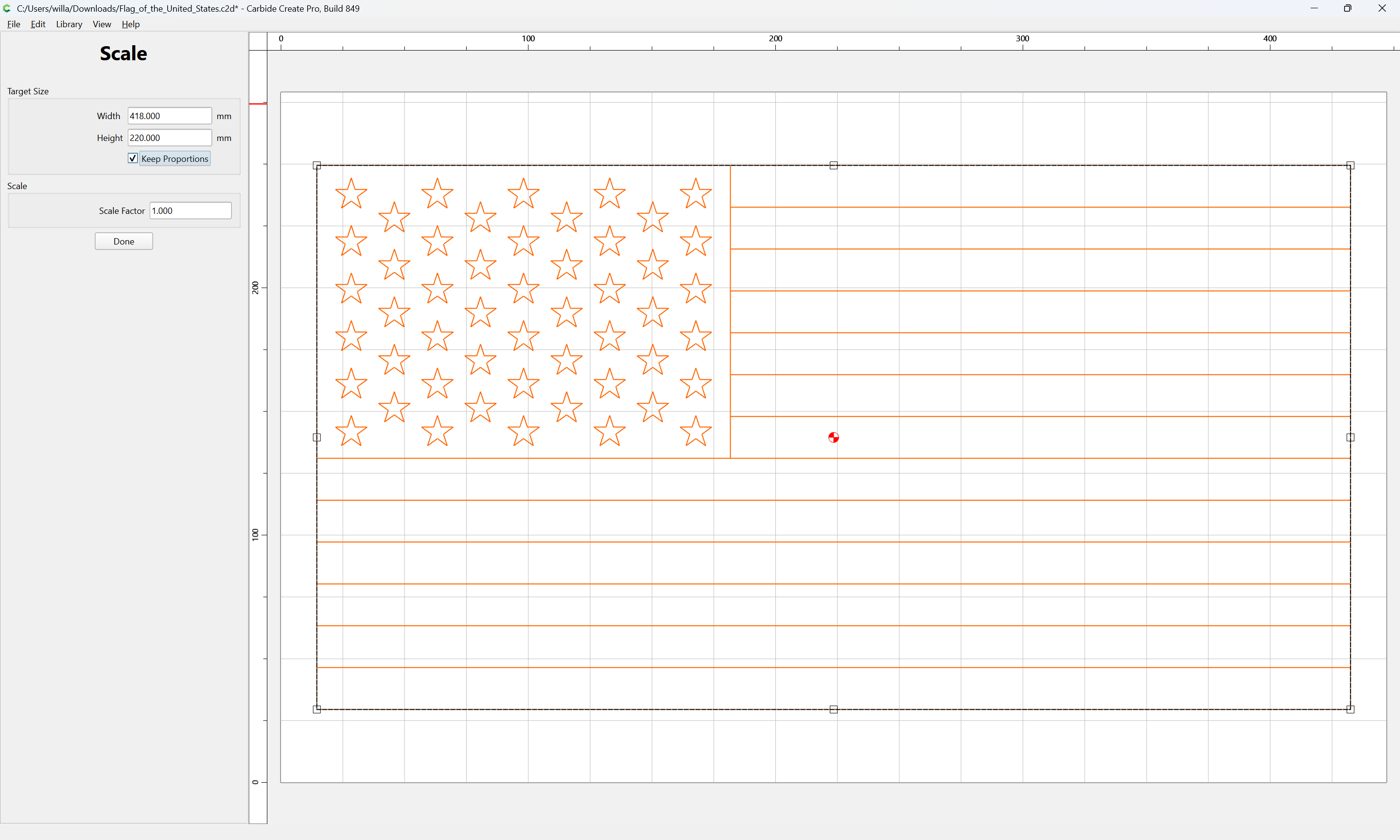

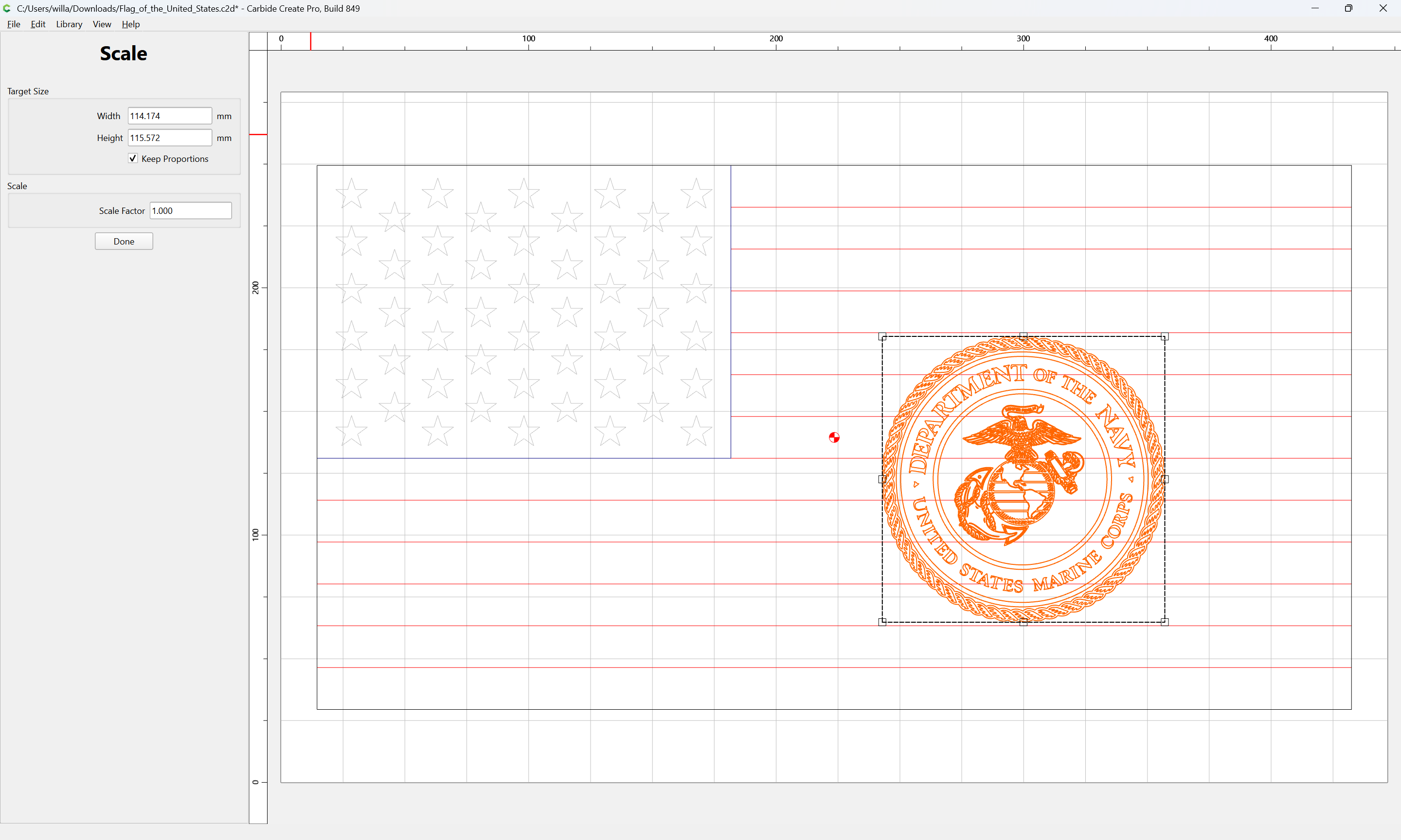

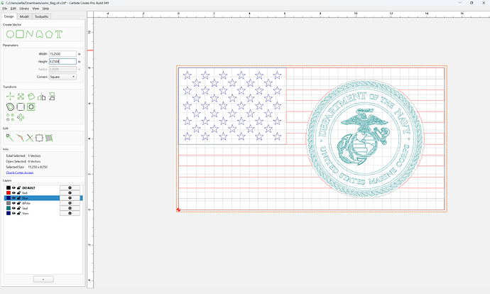

Select everything:
and Scale to suitable dimensions:
(perhaps the “top” would be better?)
Done

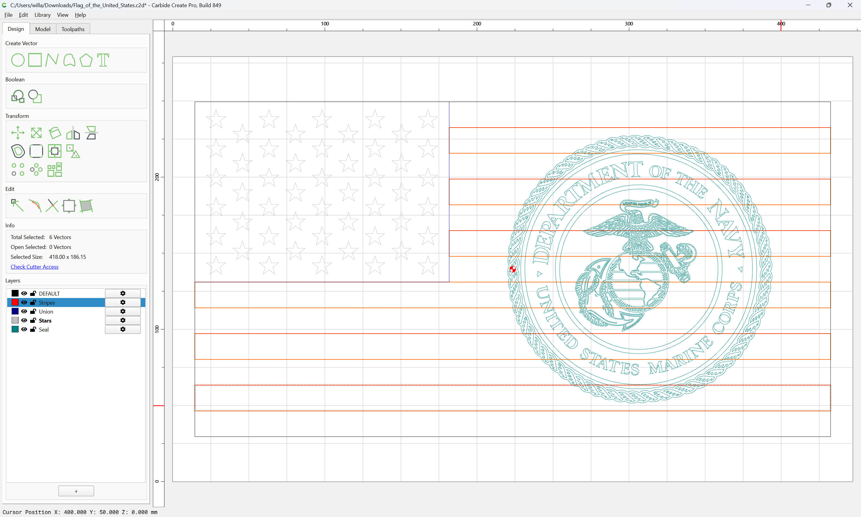

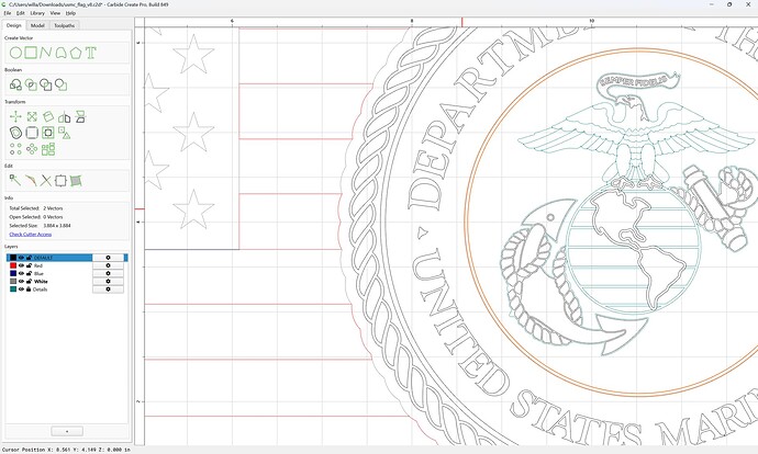

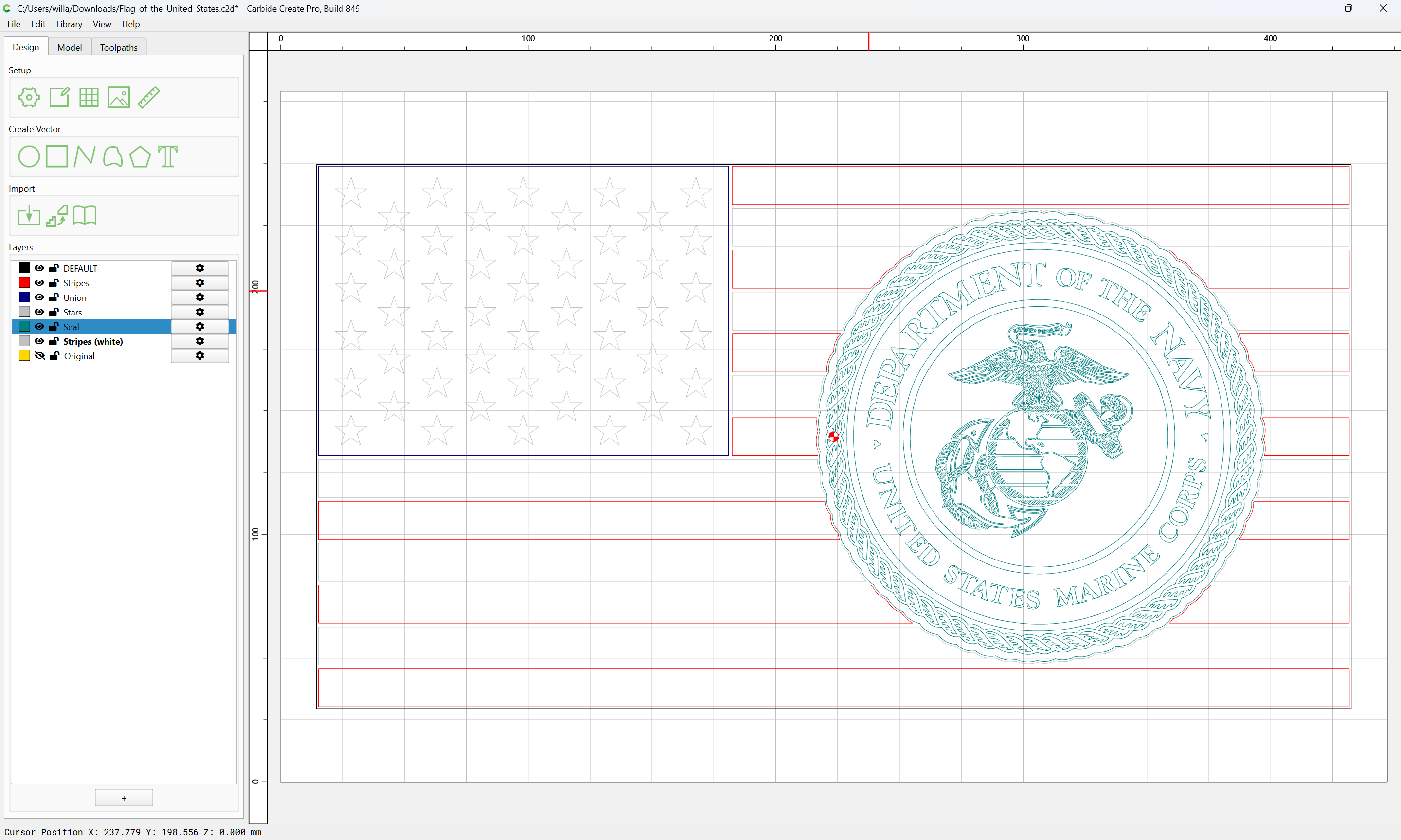

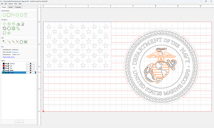

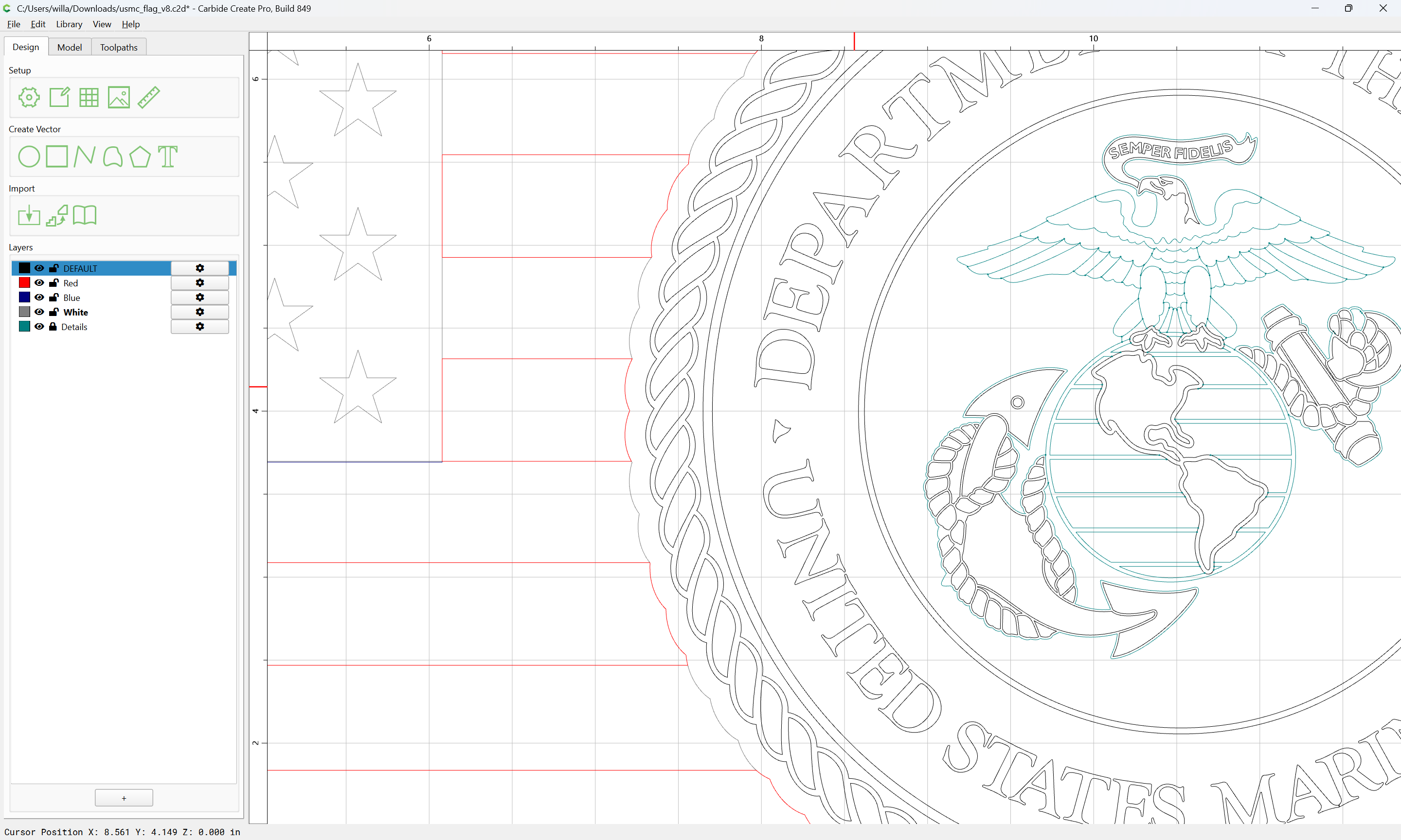

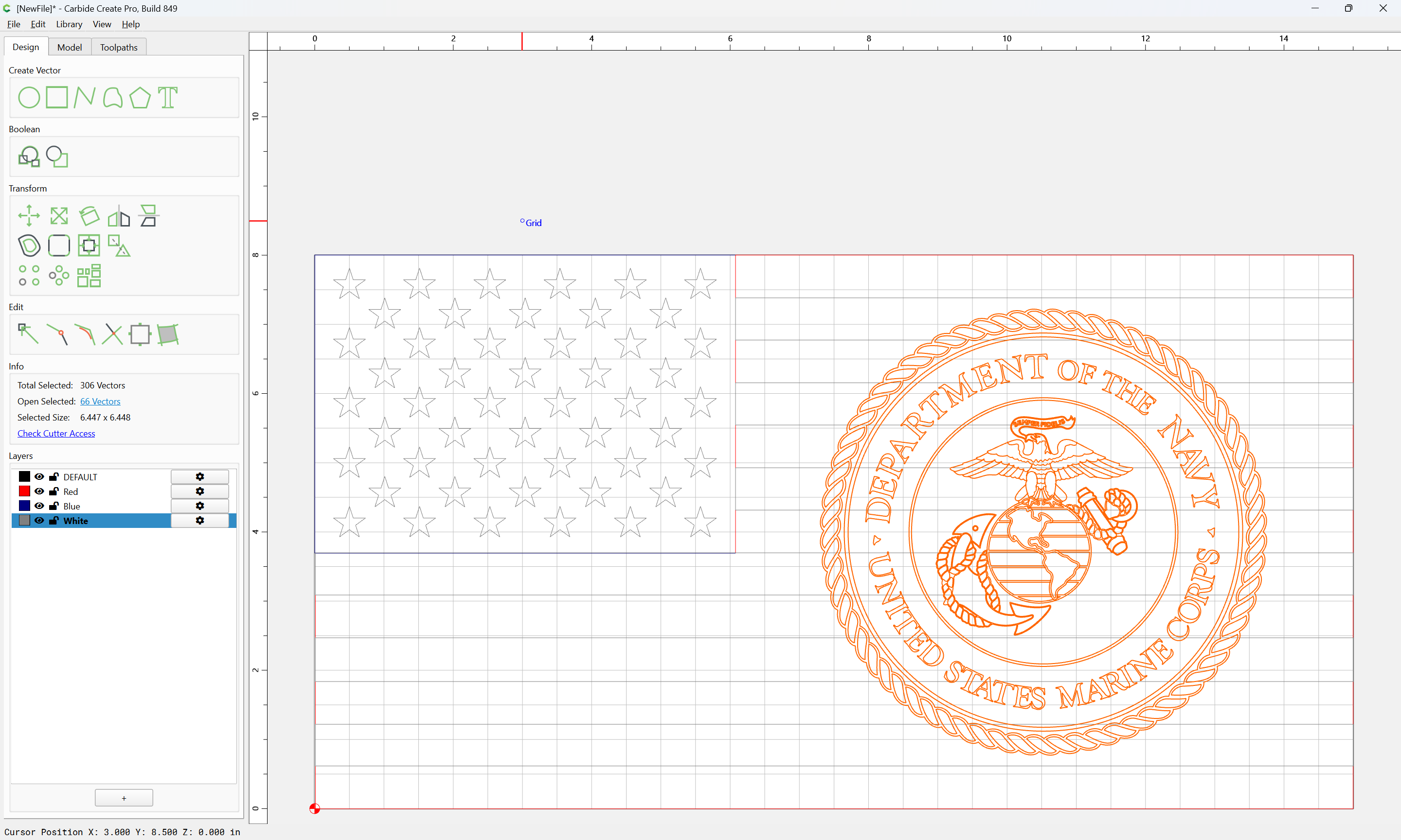

Download the USMC Seal from:
https://upload.wikimedia.org/wikipedia/commons/b/b3/Seal_of_the_United_States_Marine_Corps.svg
and import that as an external file:
Adjust position and dimensions as desired:

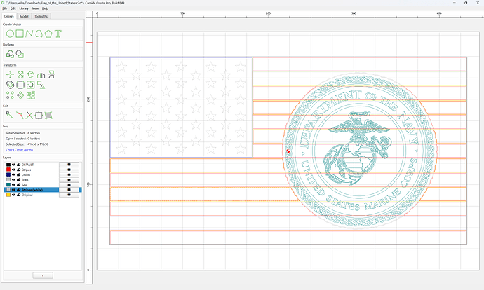

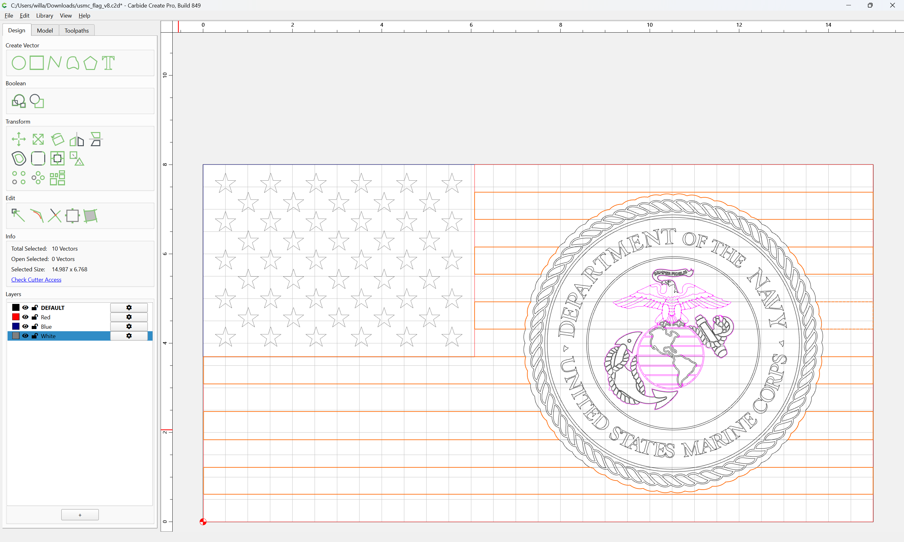

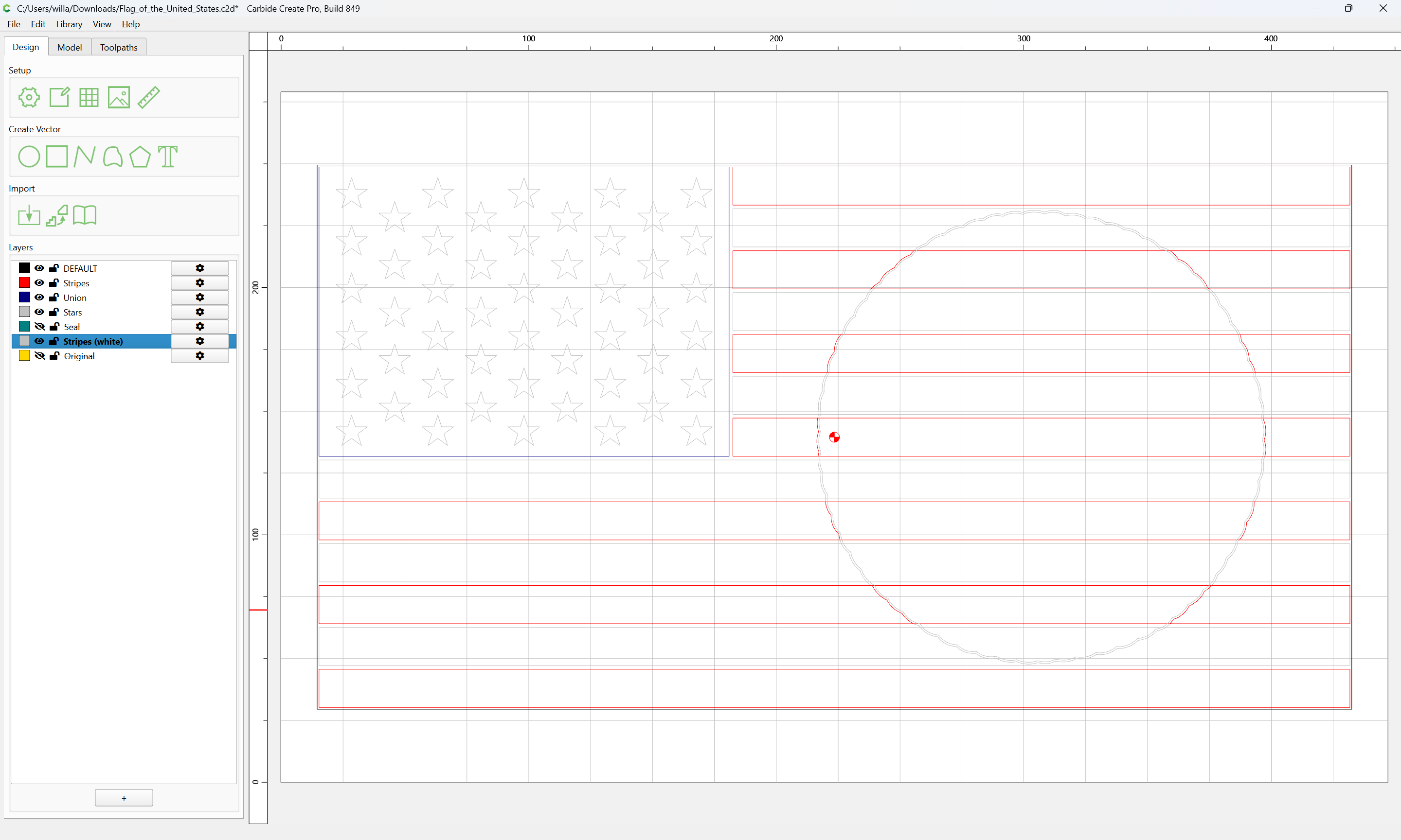

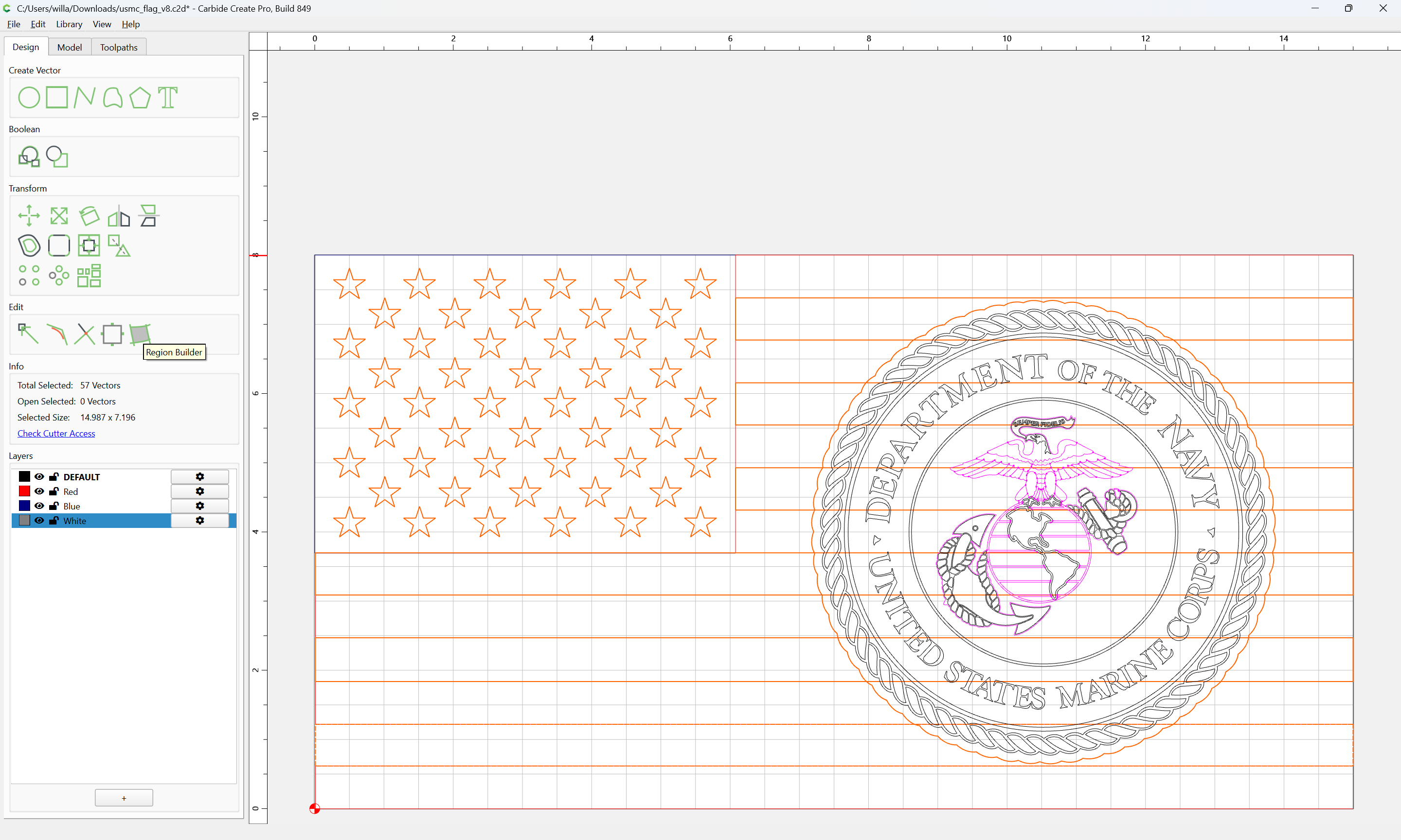

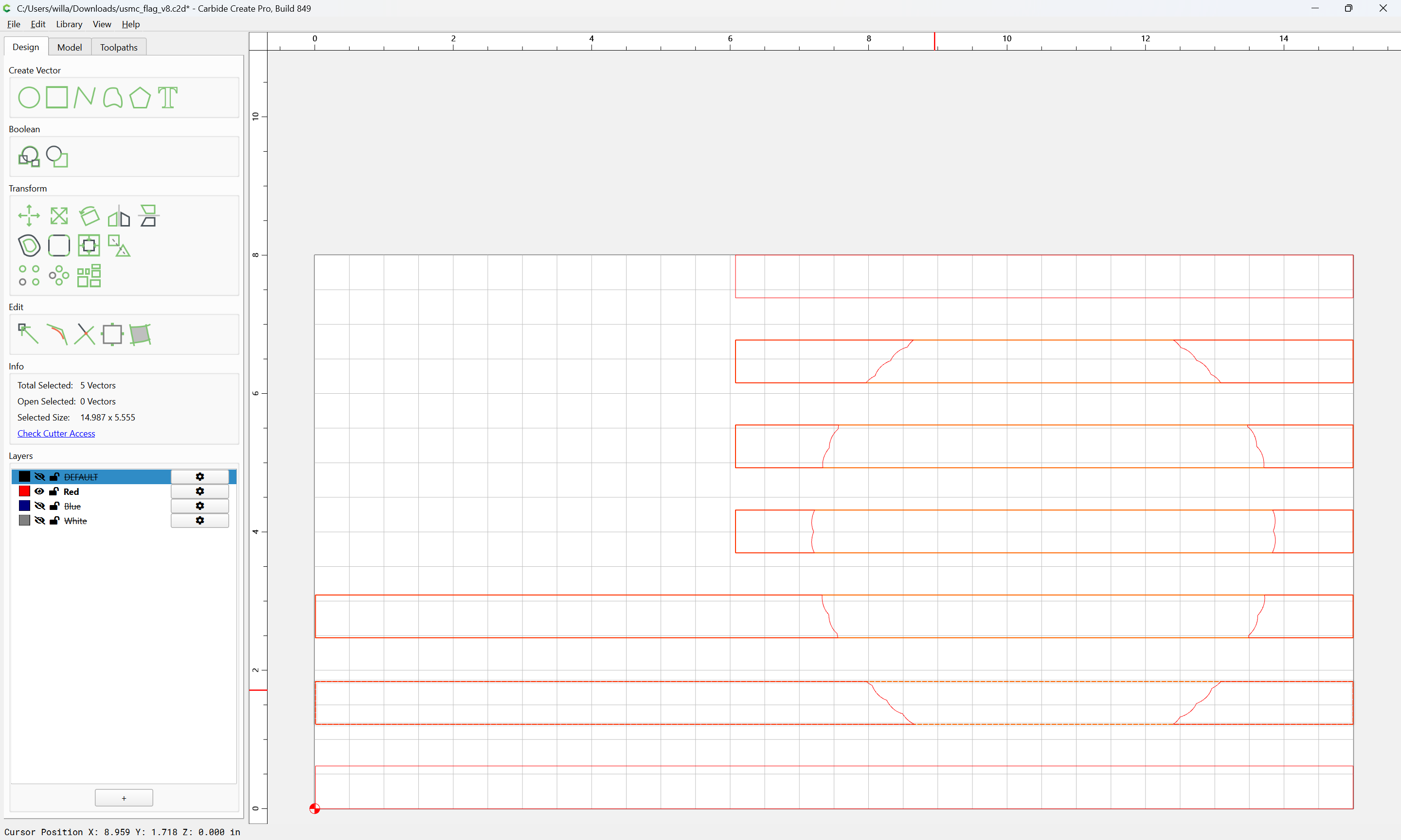

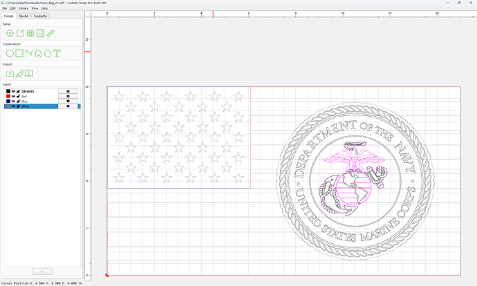

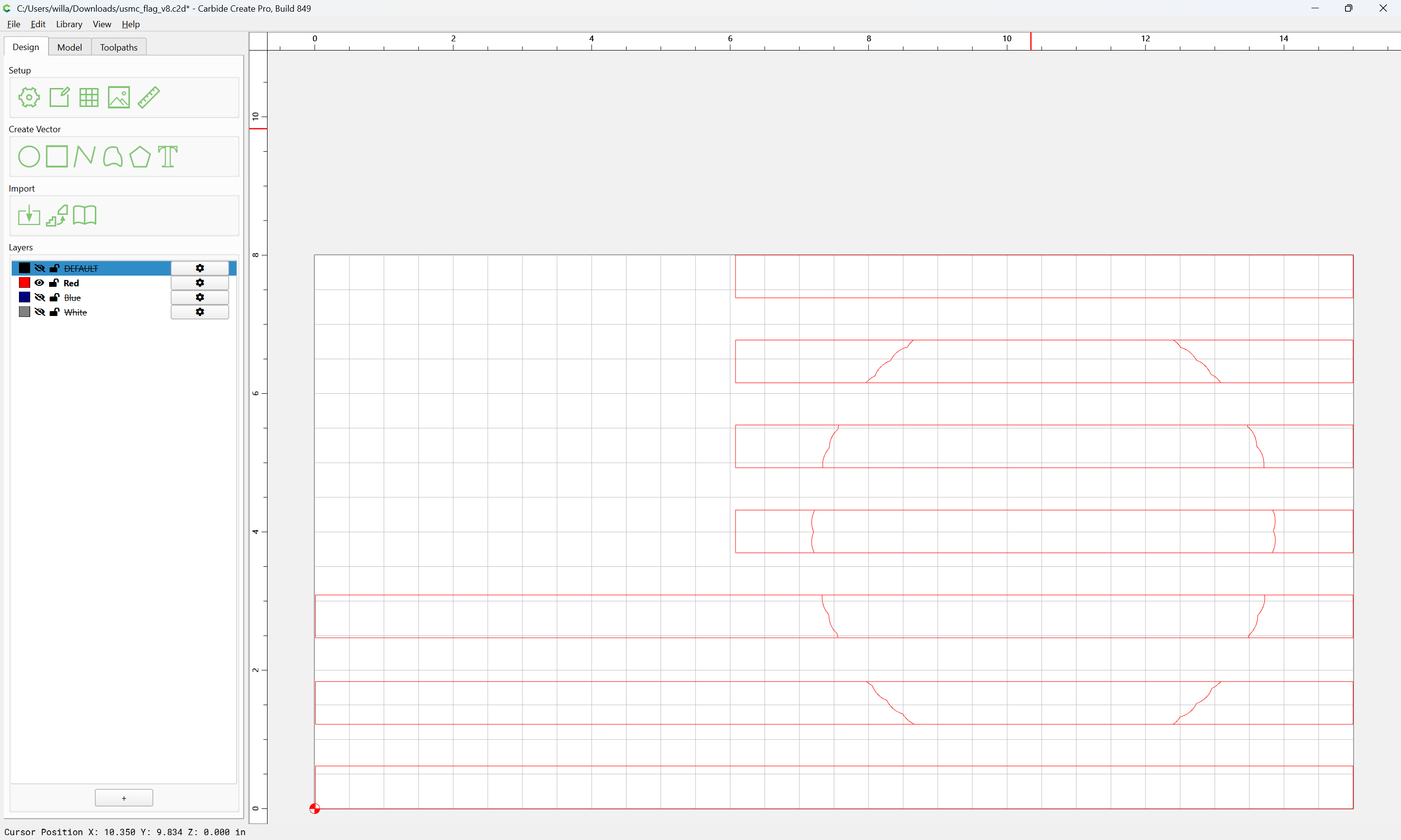

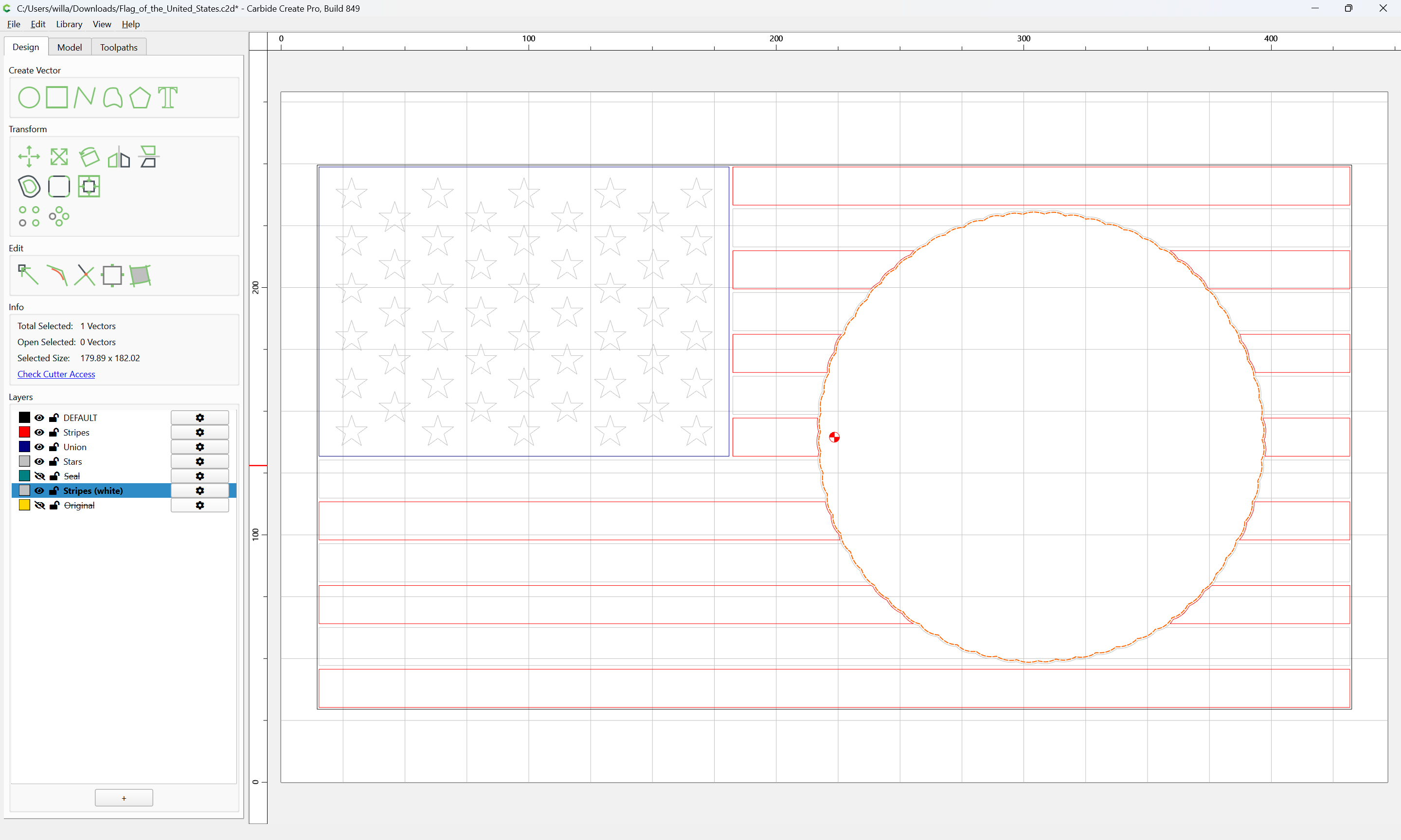

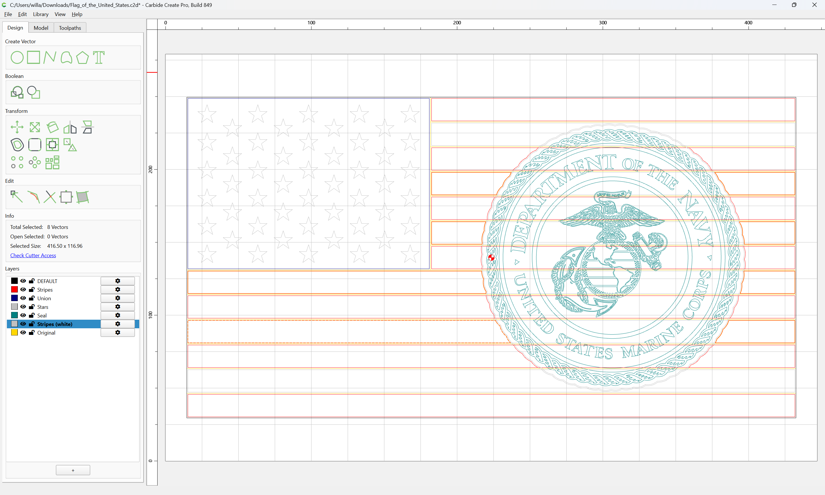

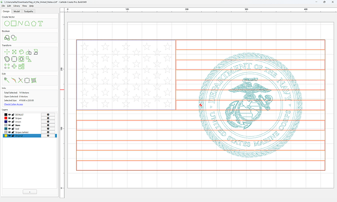

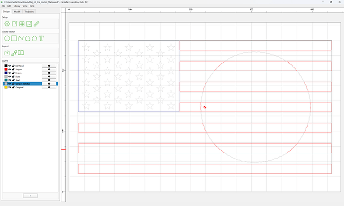

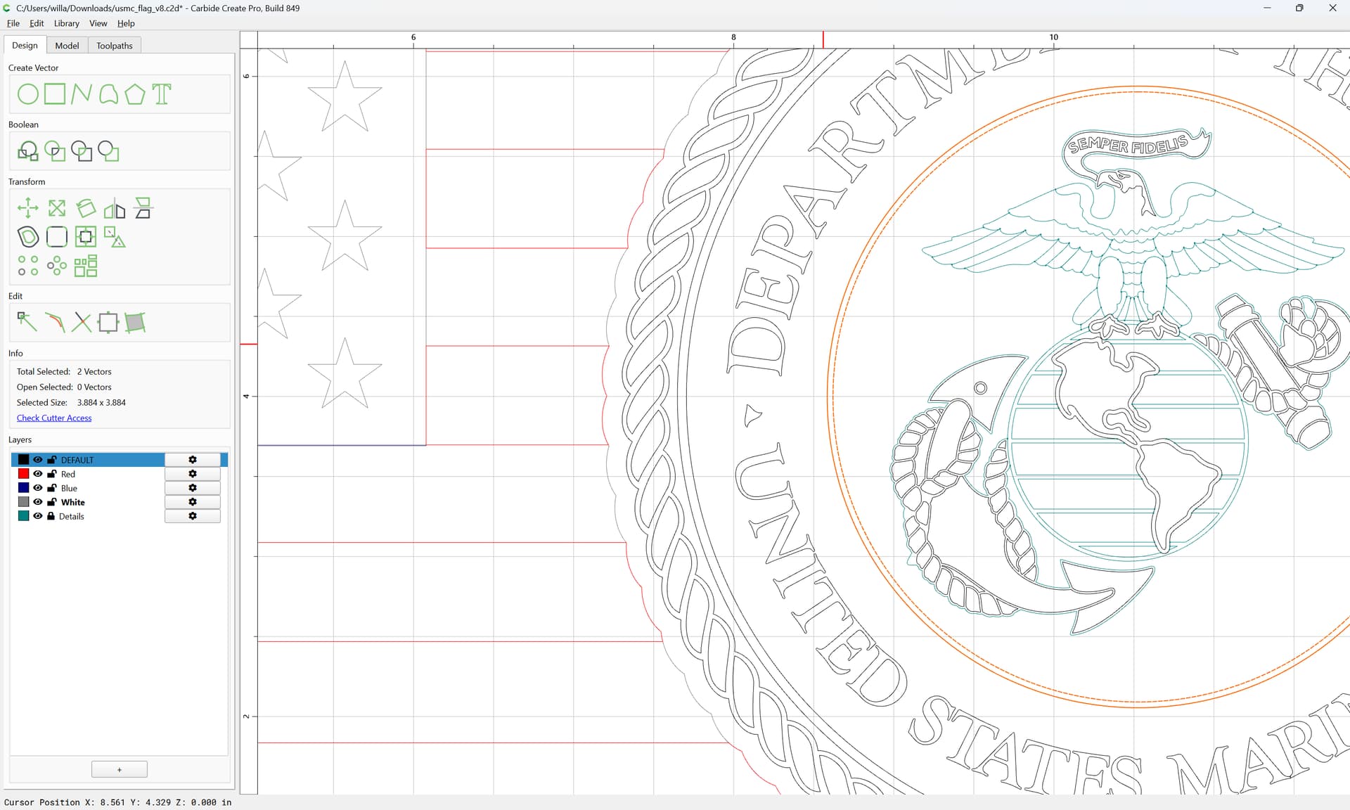

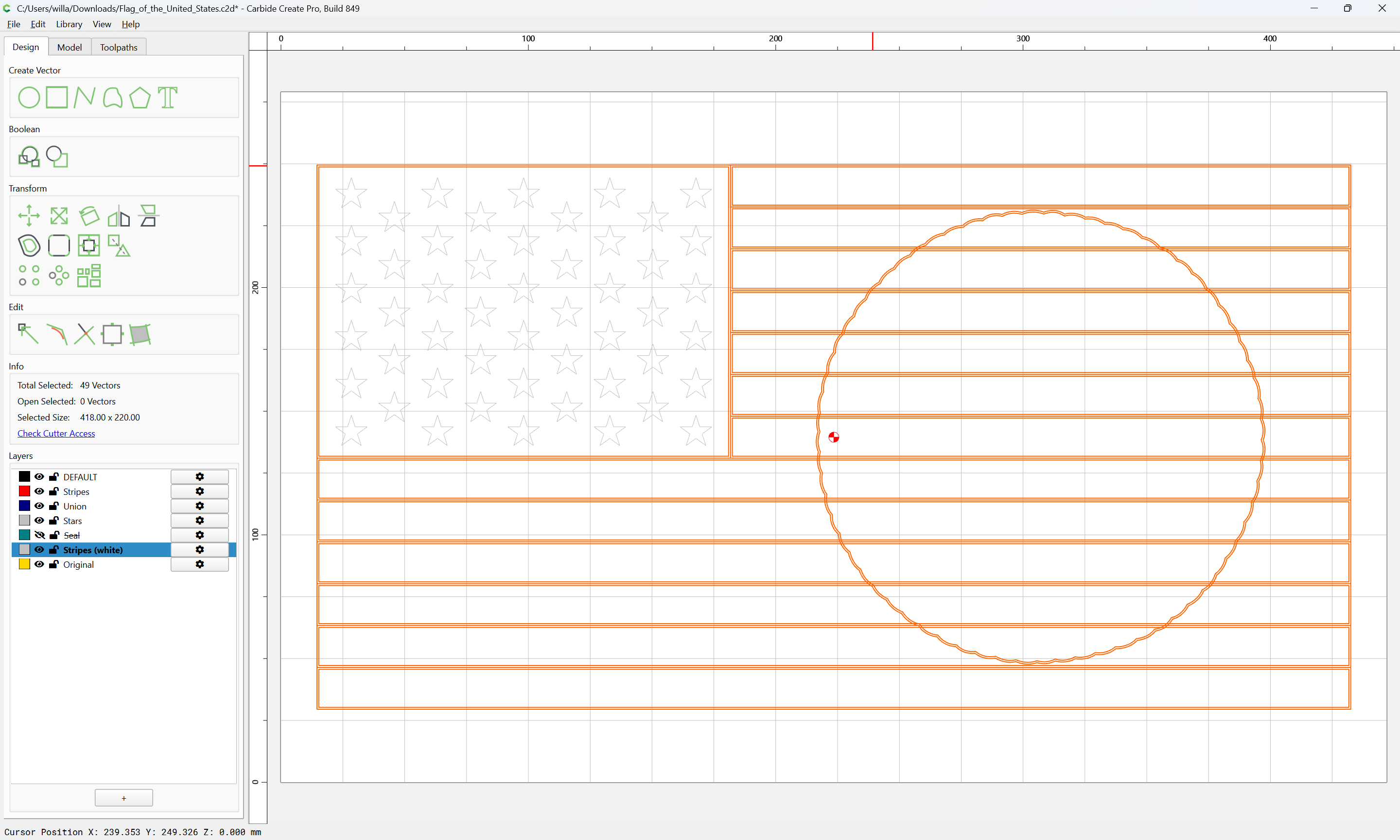

Select the white stripes:
and move them to their own layer:

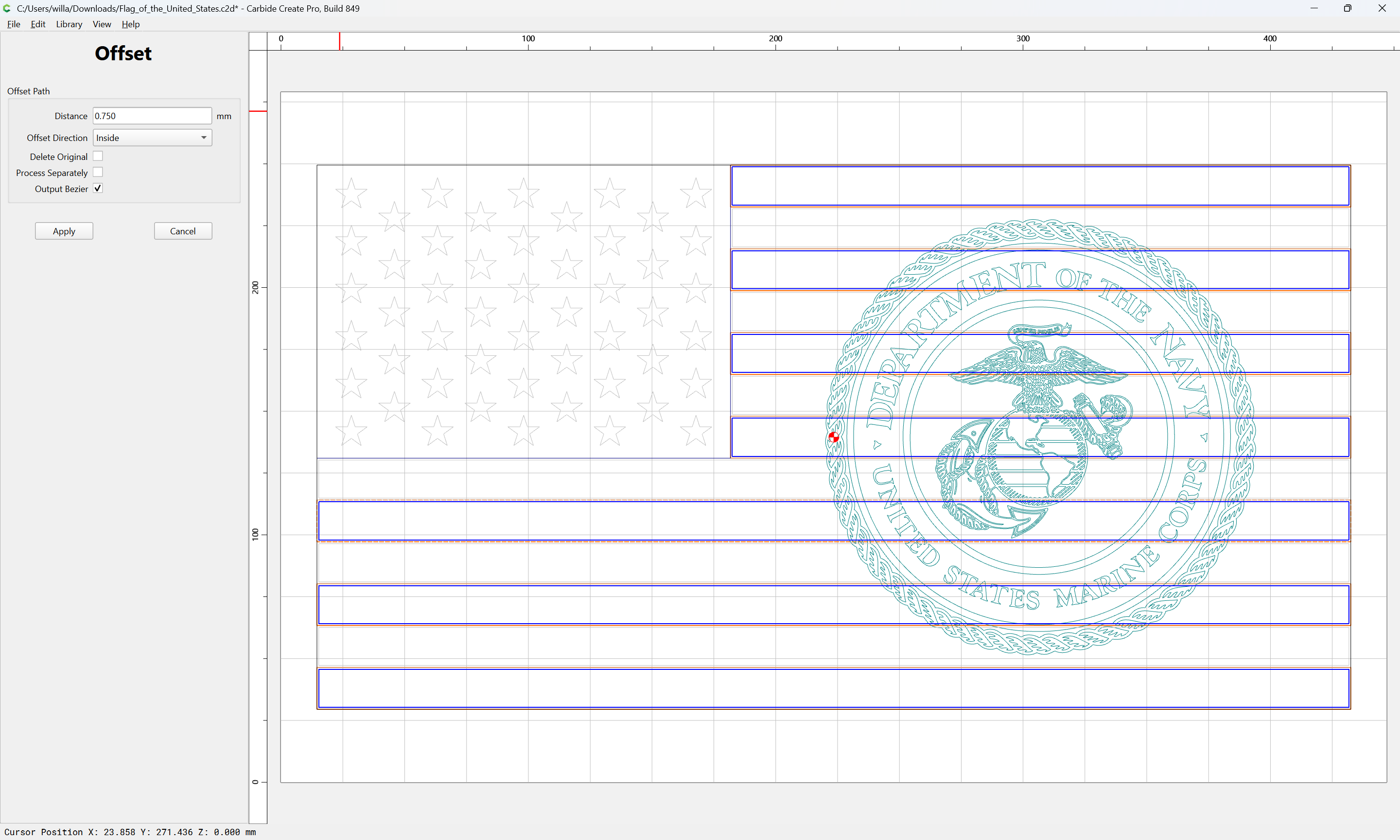

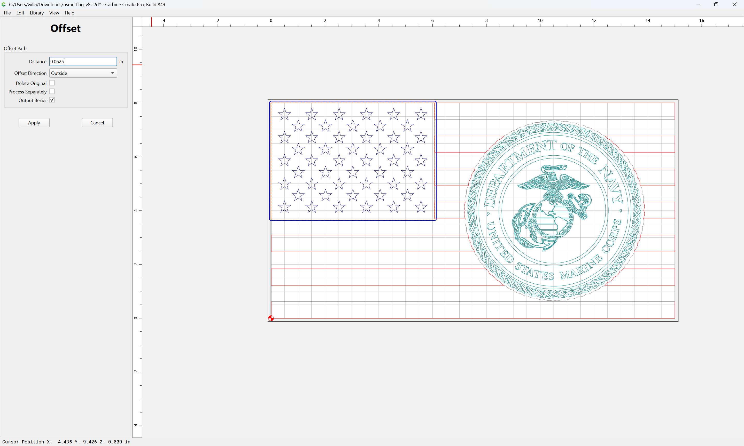

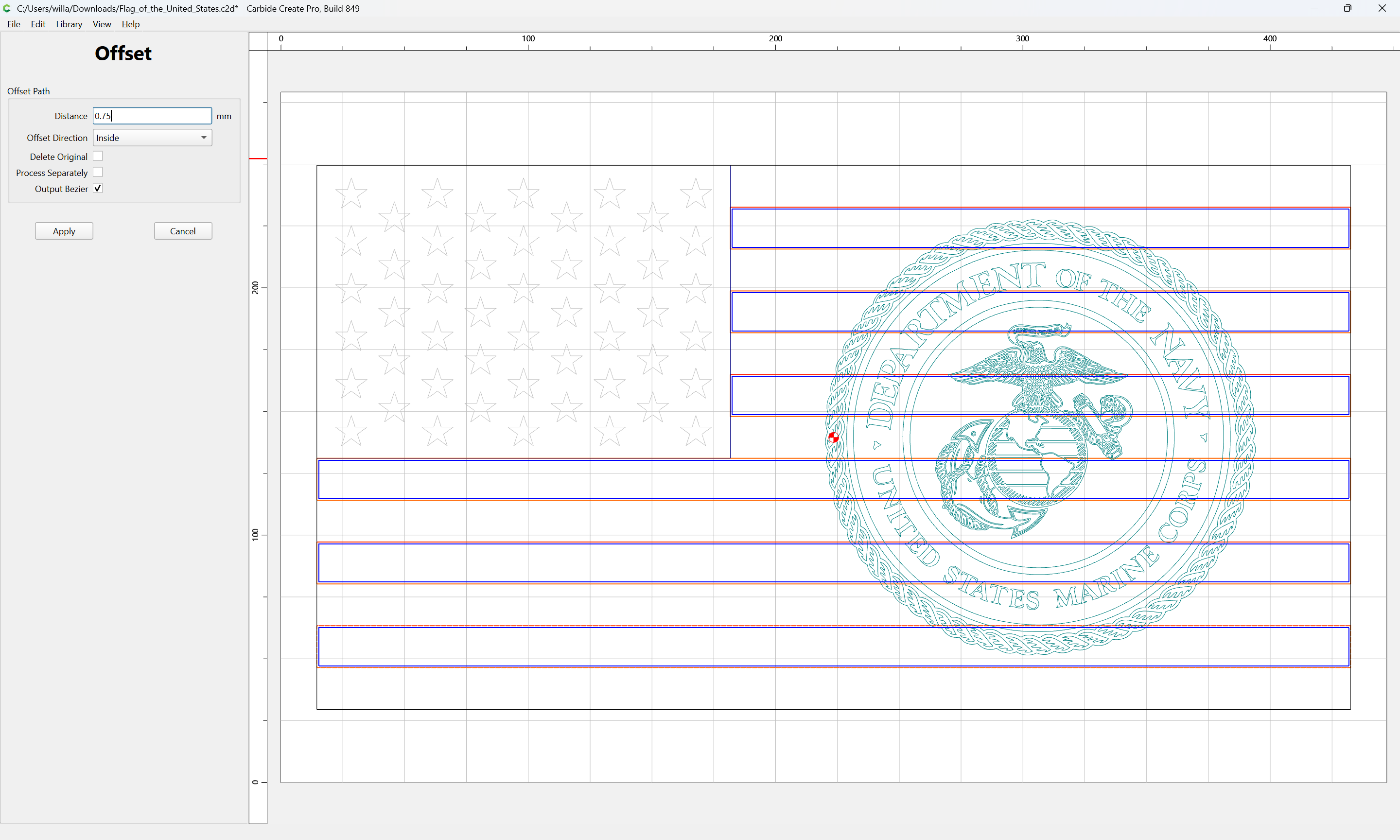

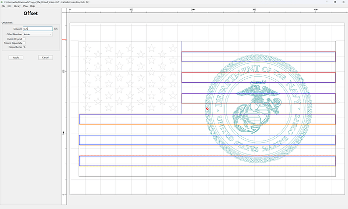

Inset each set of stripes by some suitably small distance:
Repeat this for the Union as well:
Moving all the inset geometries to the appropriate layers and selecting the original geometry and moving it to a separate layer:

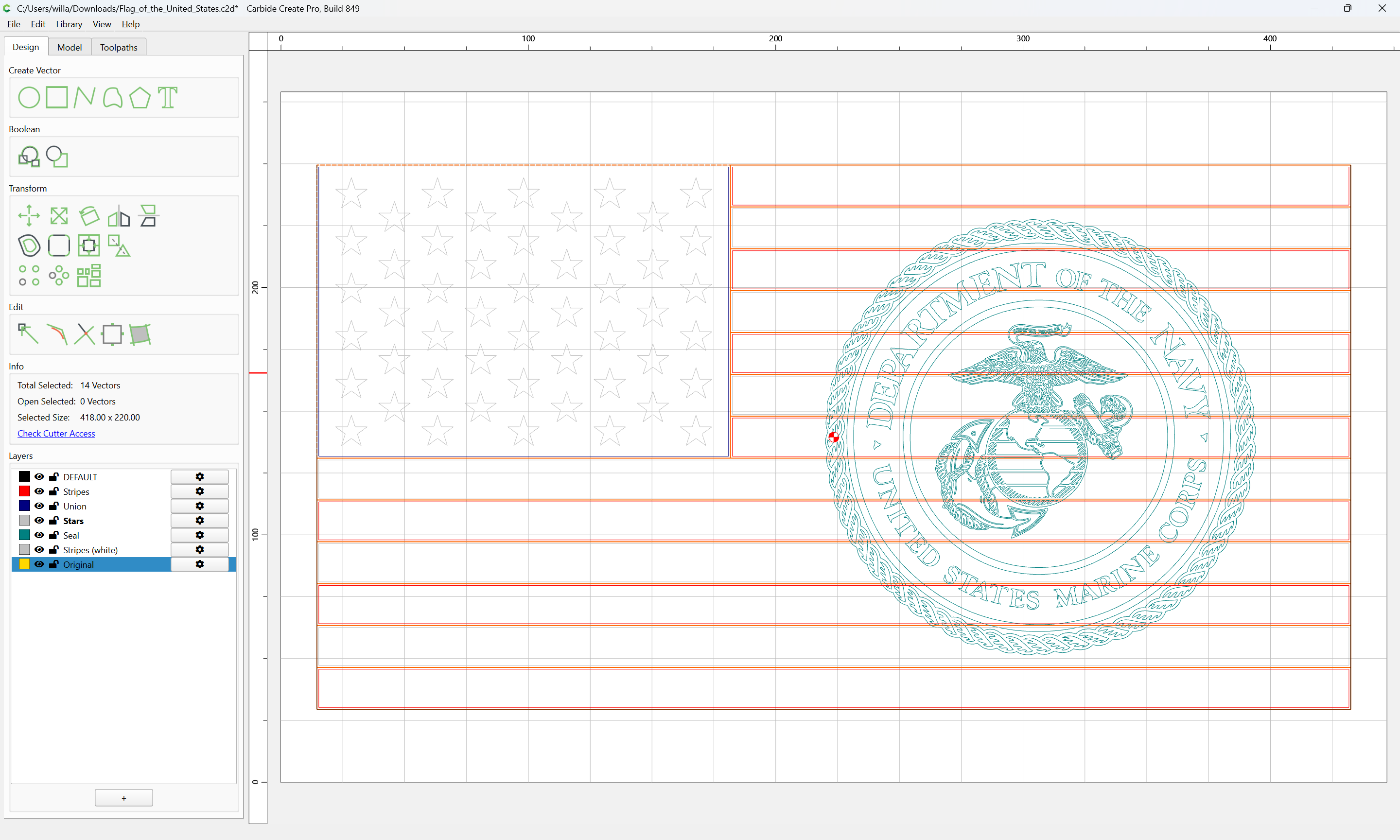

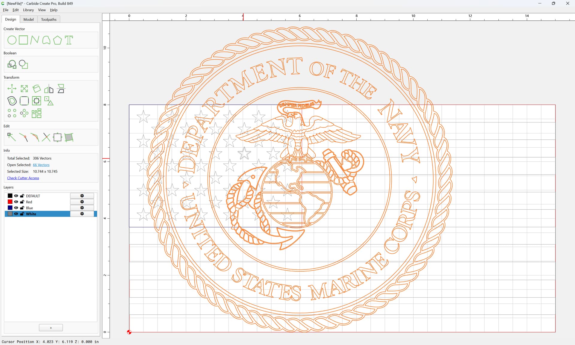

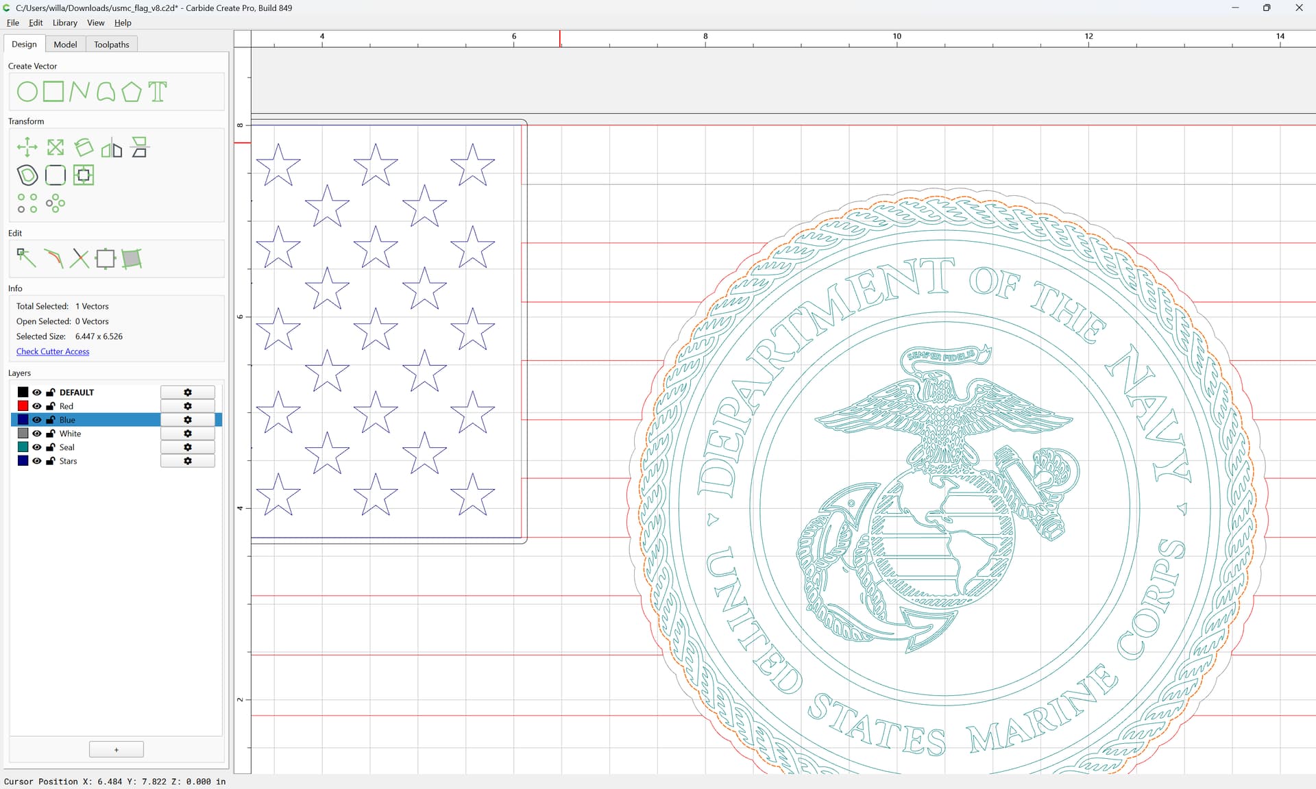

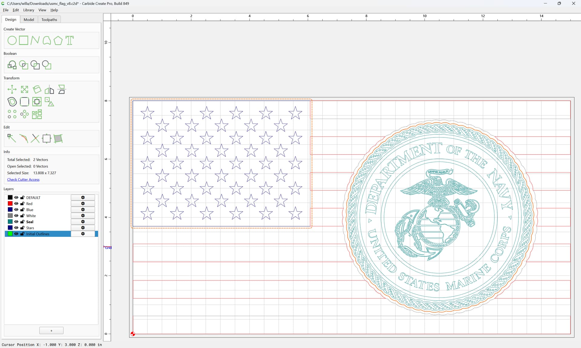

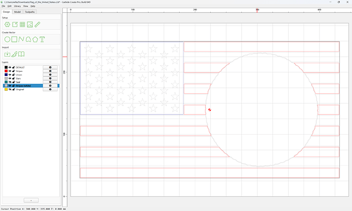

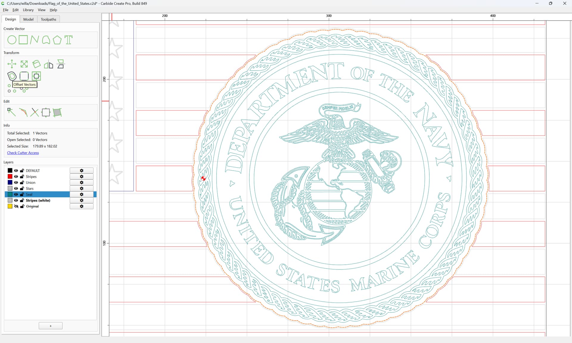

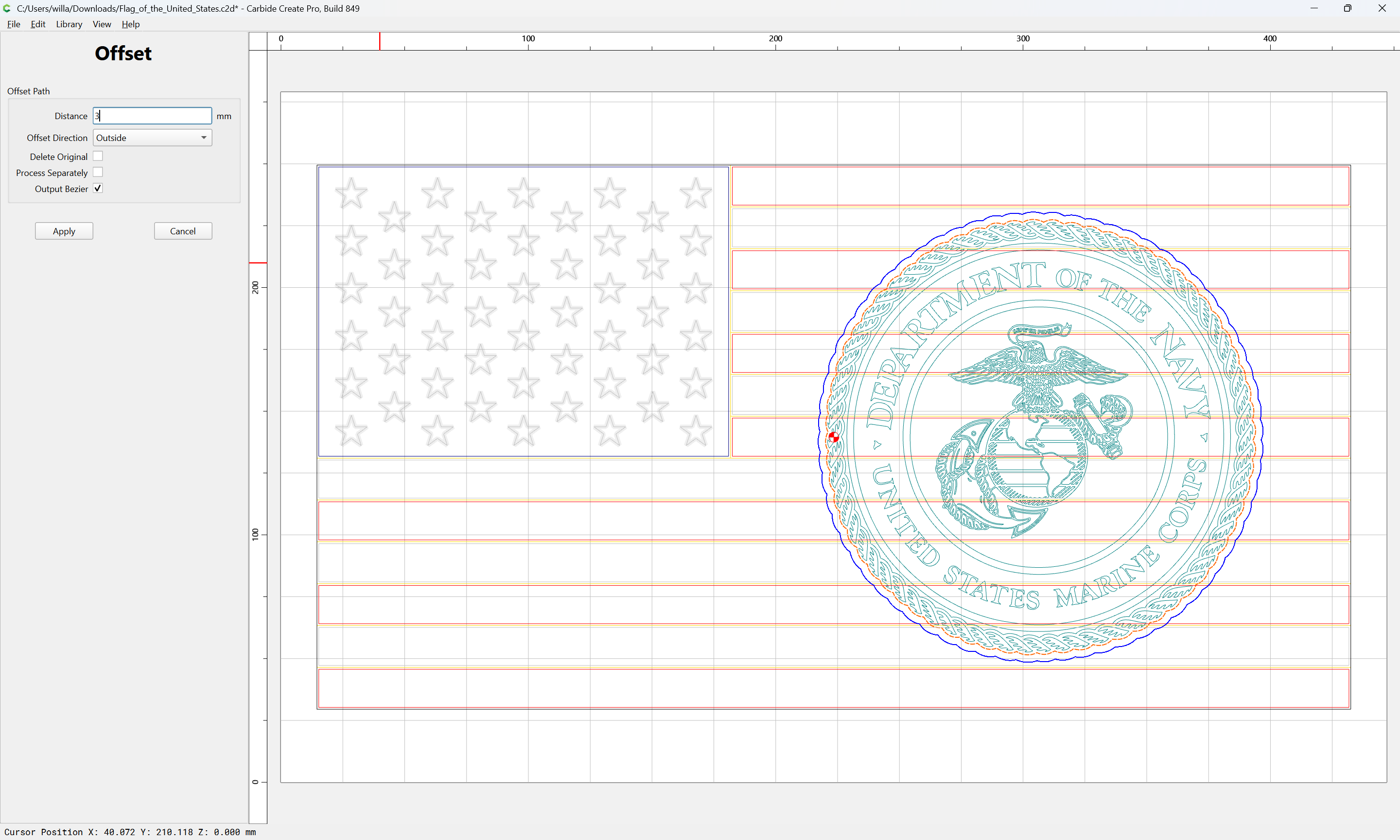

Then select the perimeter of the seal:
and offset twice:
Apply
Apply

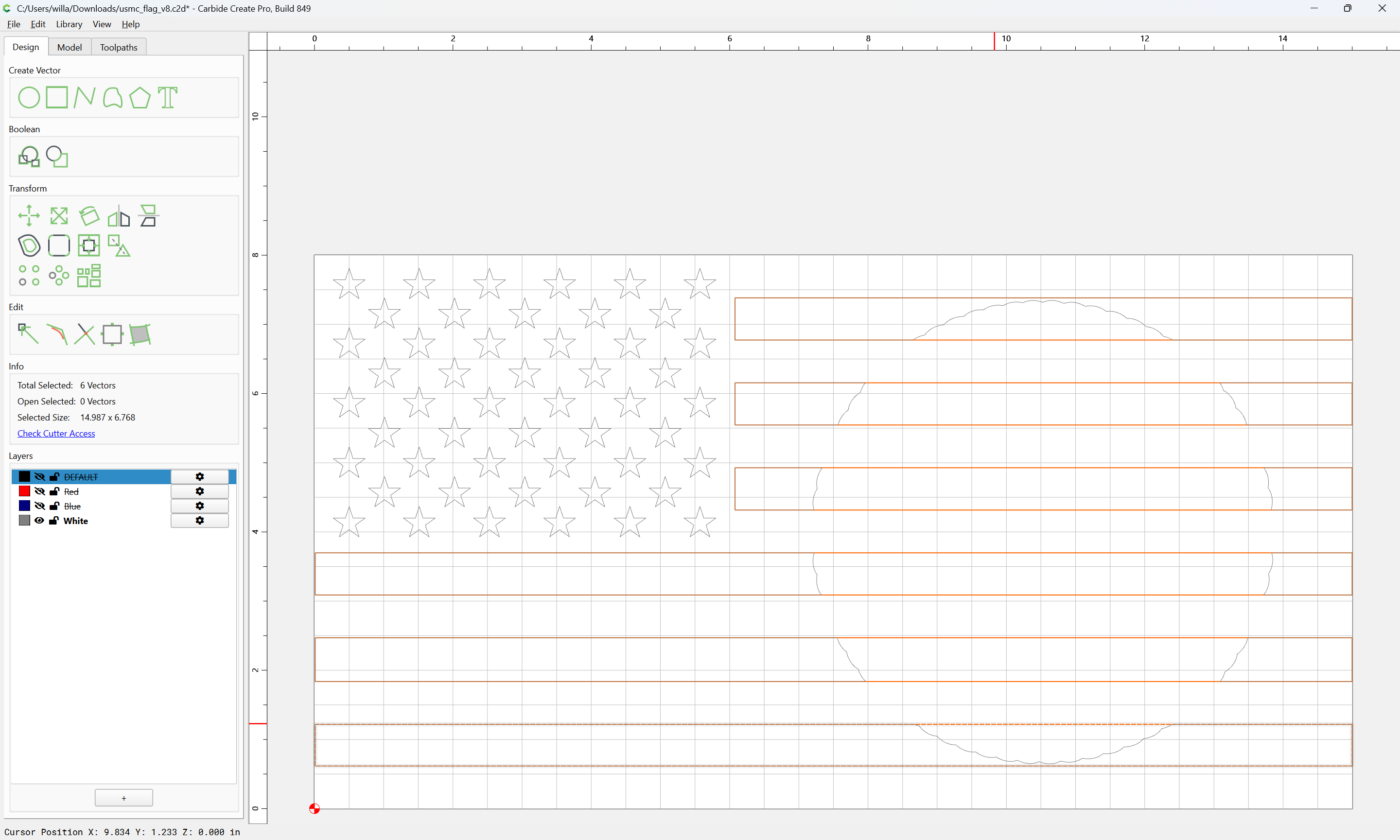

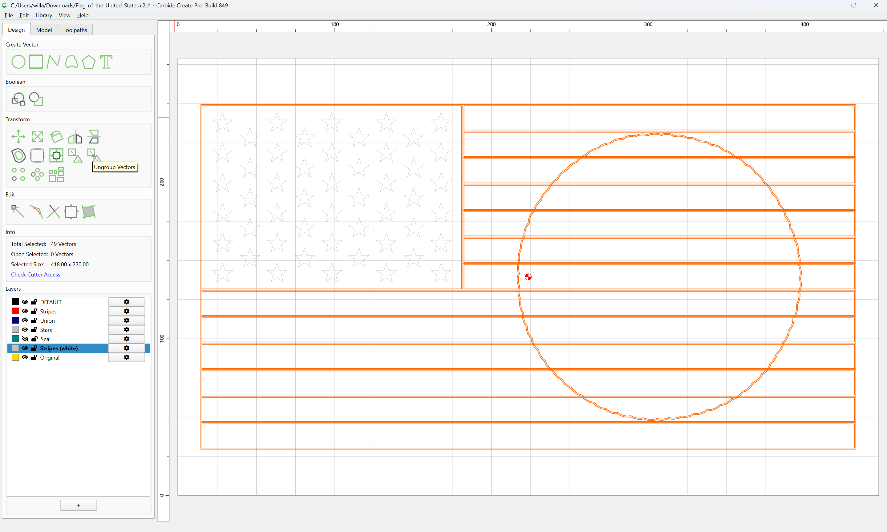

Then use the outer offset to remove from the inset stripes:
Yes
Done
Repeat for the other set of stripes when that layer is active:
Yes
Done

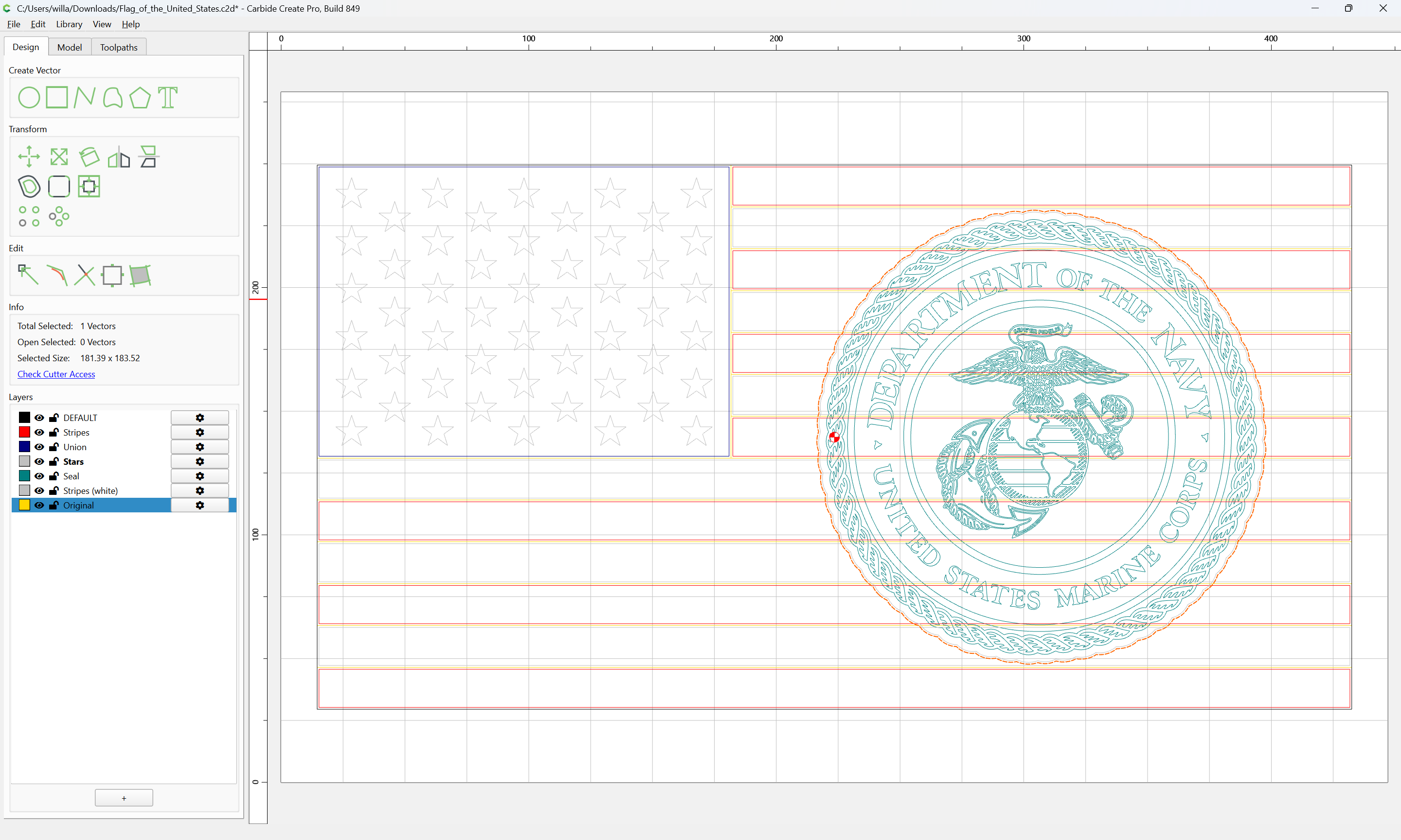

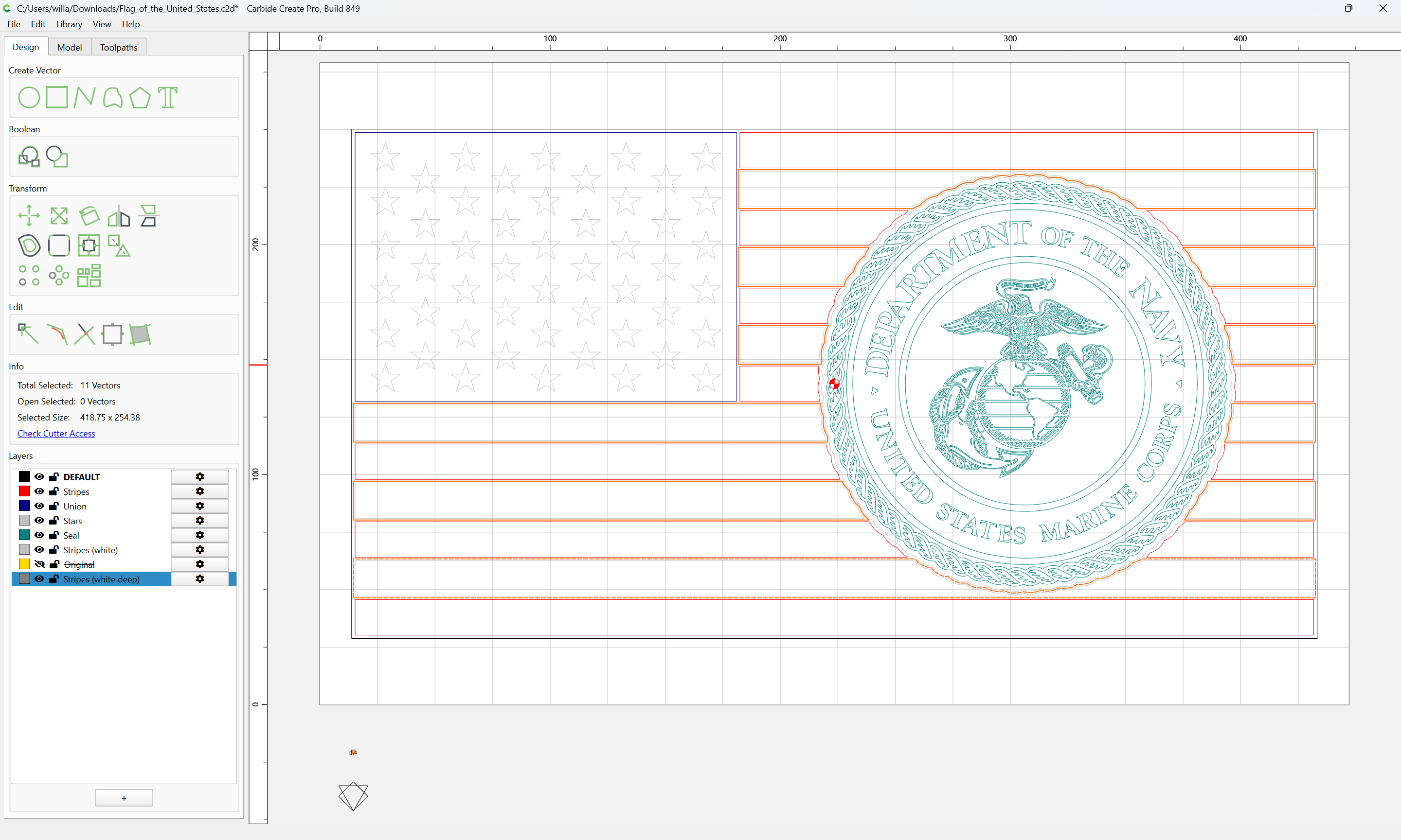

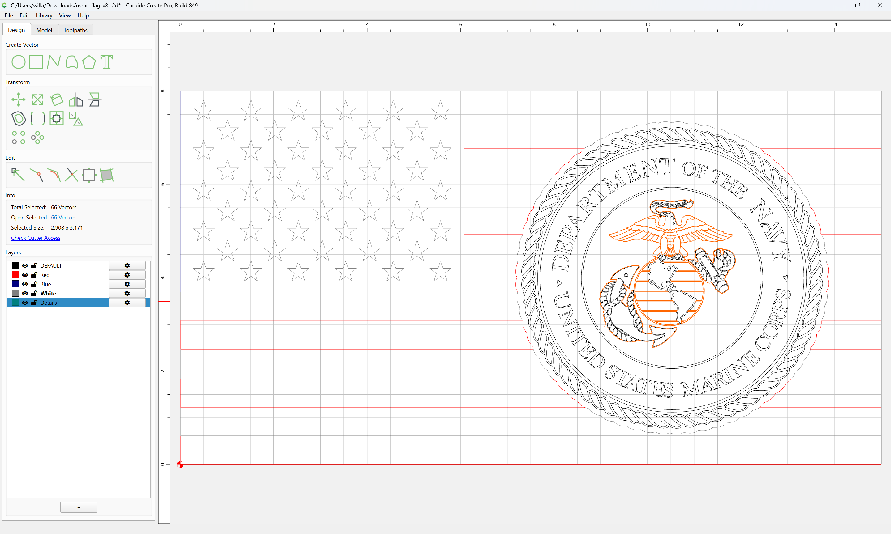

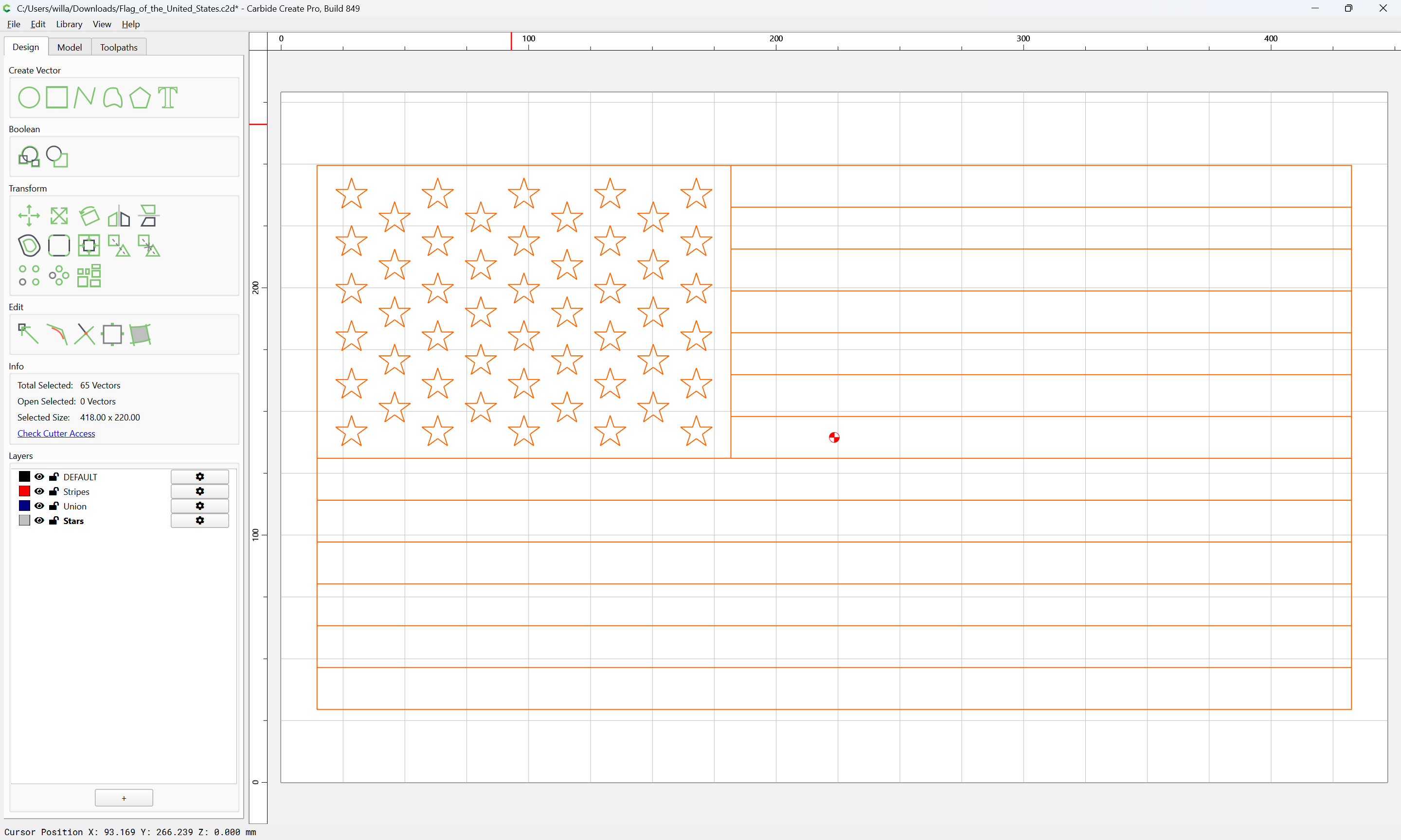

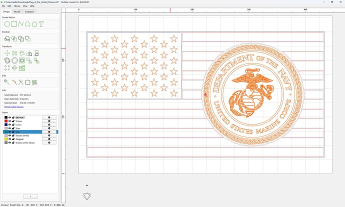

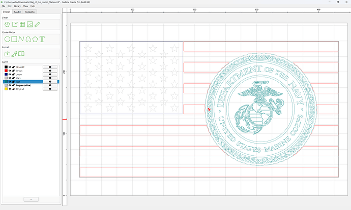

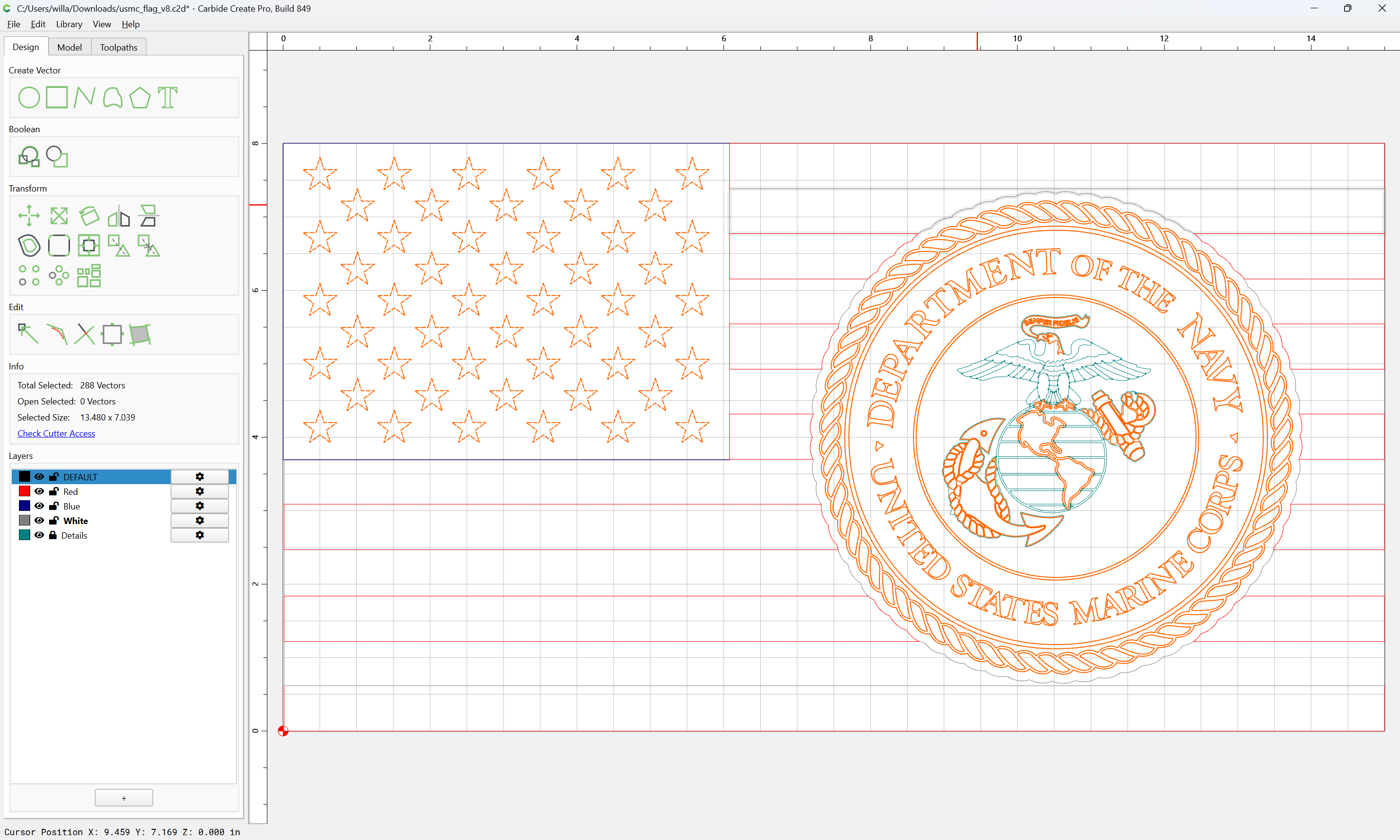

Hide the Seal layer, select everything except for the Stars:
and Ungroup Vectors:
and hide the Original layer:
Then select only the original stripes:
and delete them:

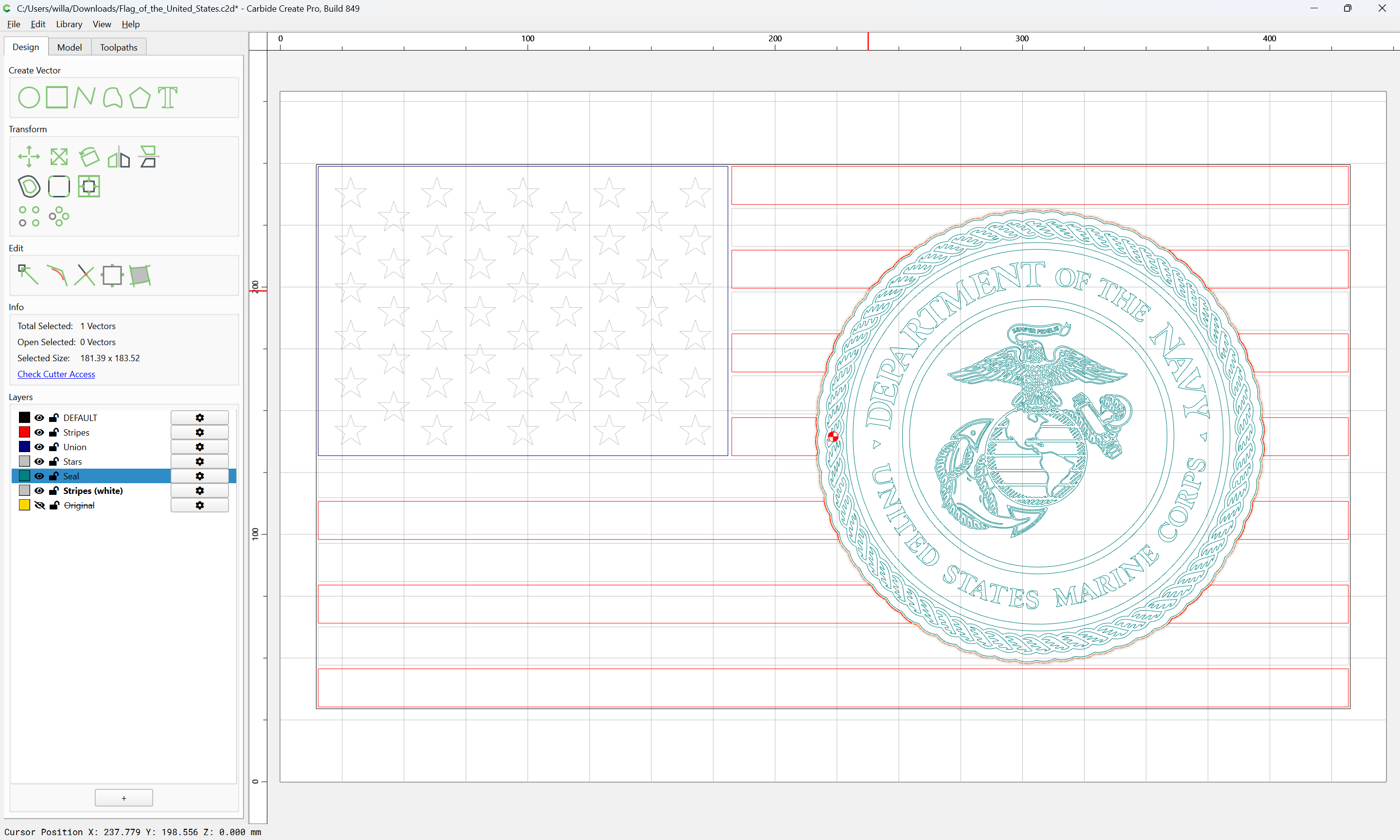

Then select the inner offset:
and move it to the Seal layer:
and delete the second offset:

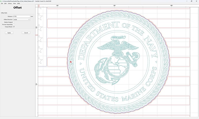

Also offset the offset geometry to the inside:
and move the previous geometry to the Original layer.

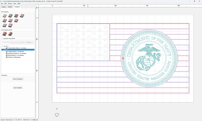

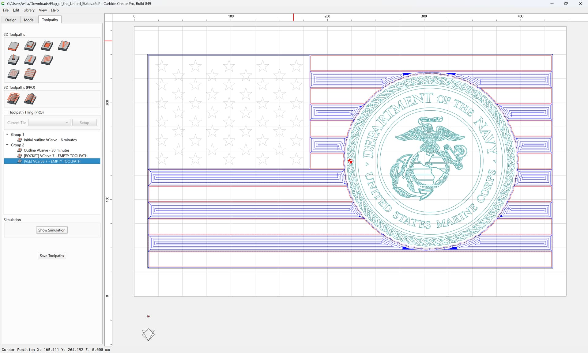

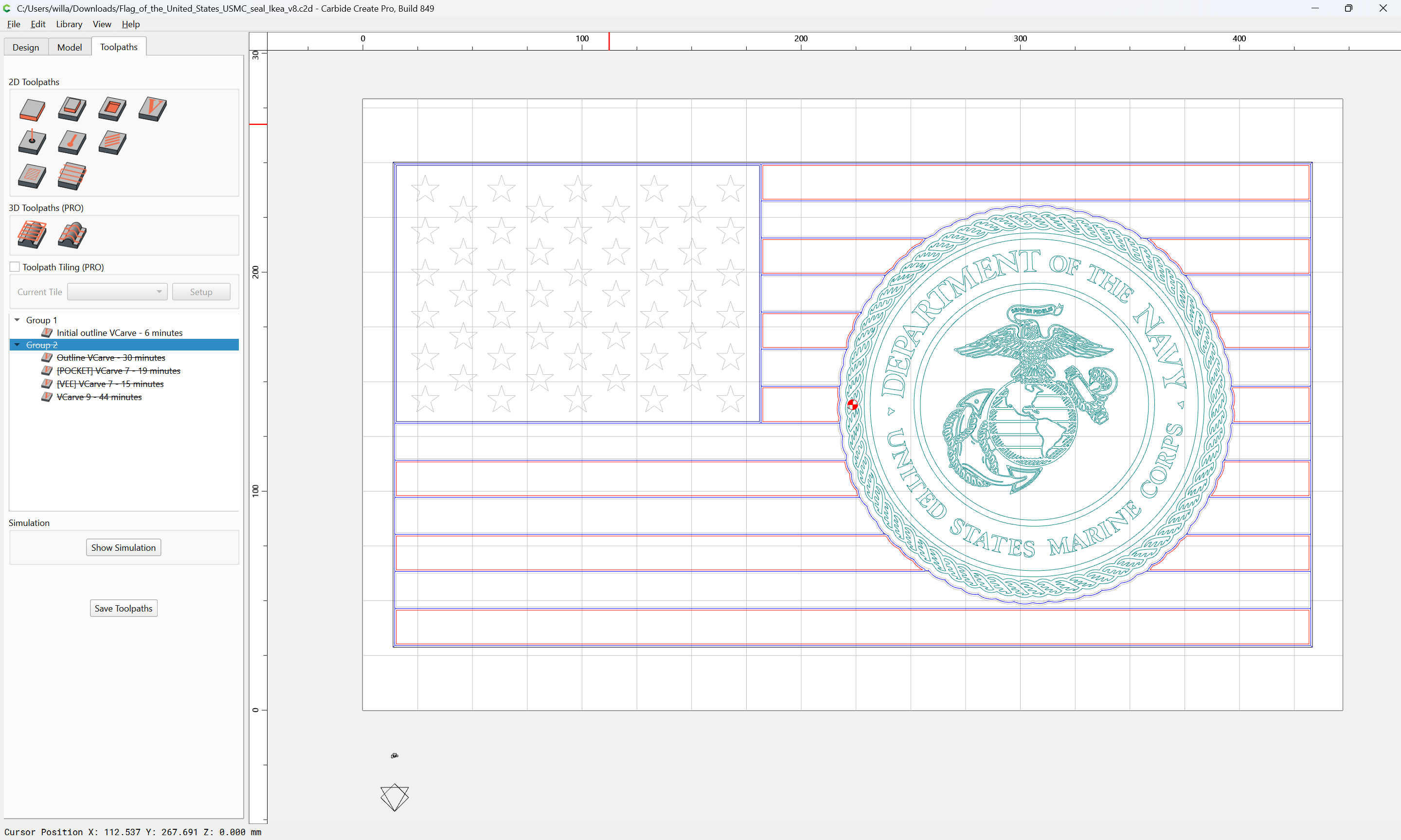

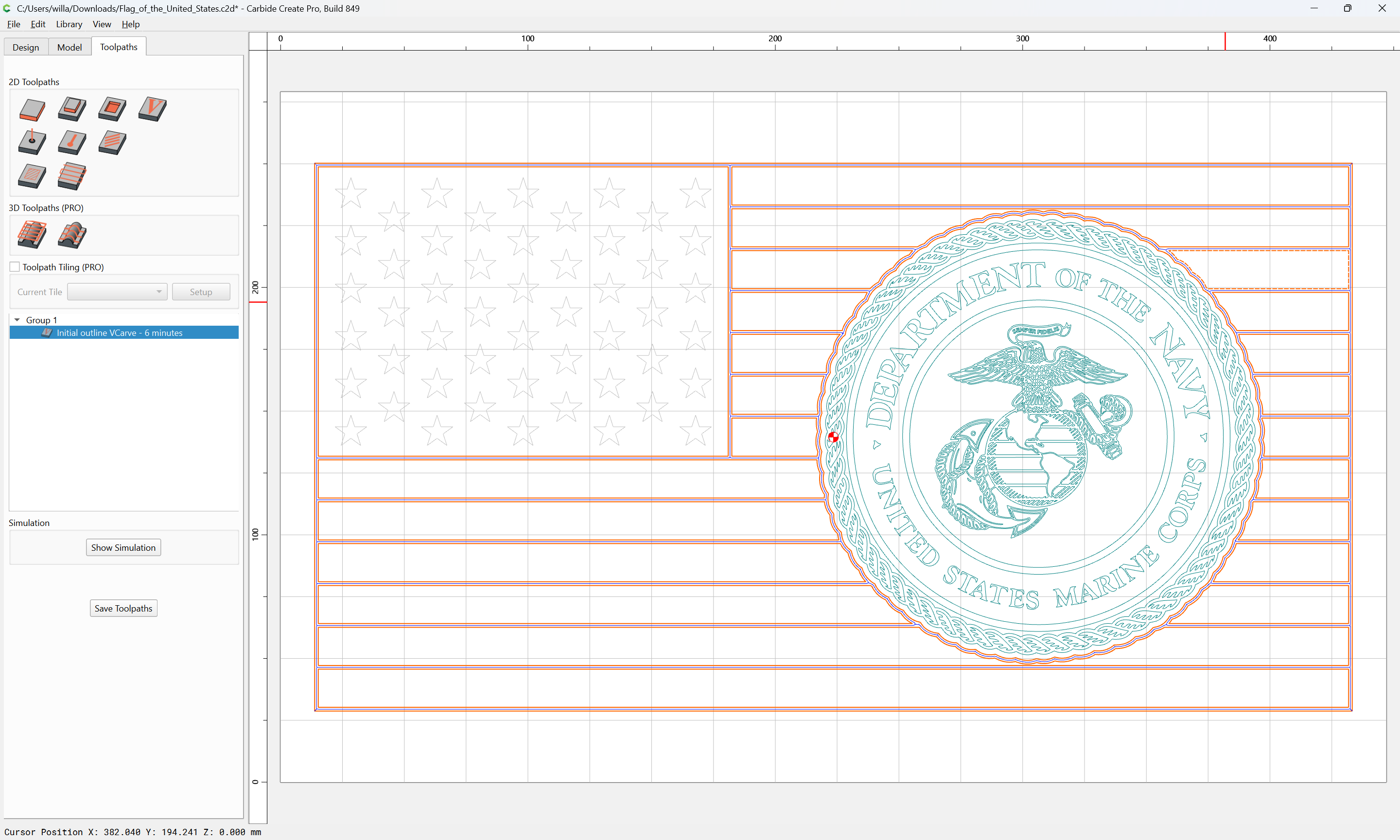

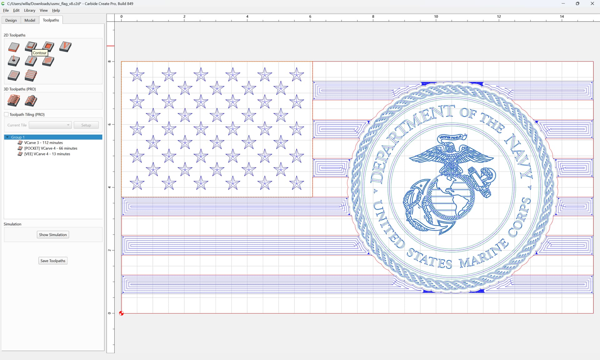

It should now be possible to assign suitable toolpaths.

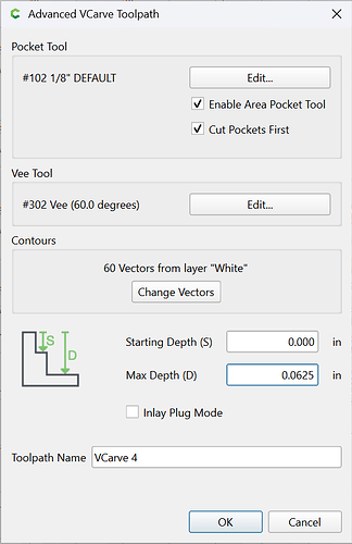

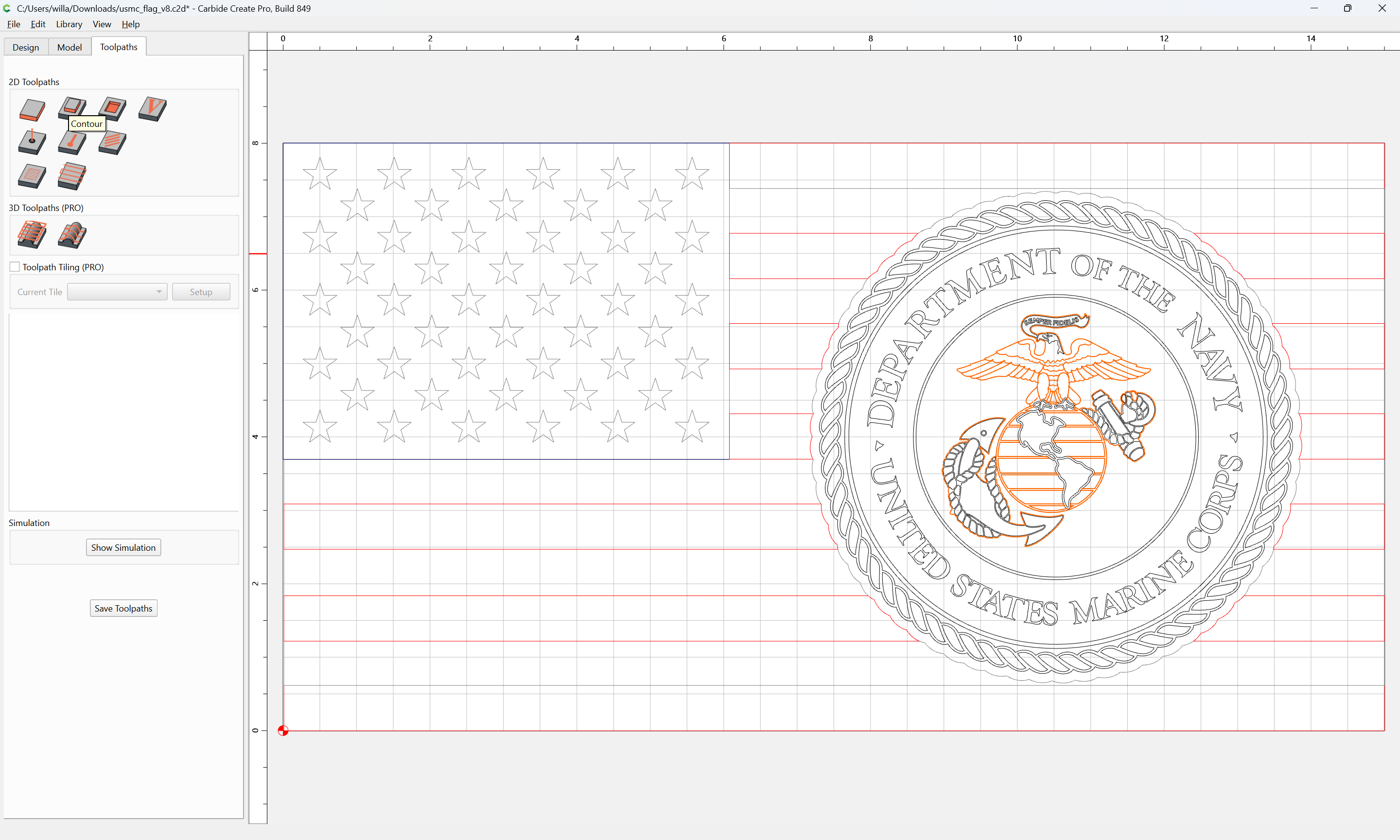

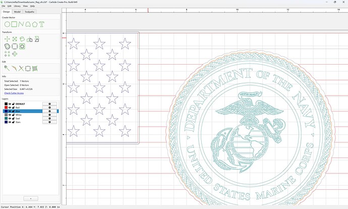

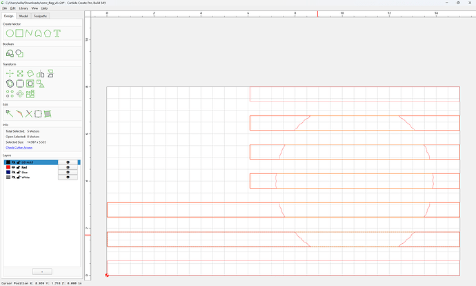

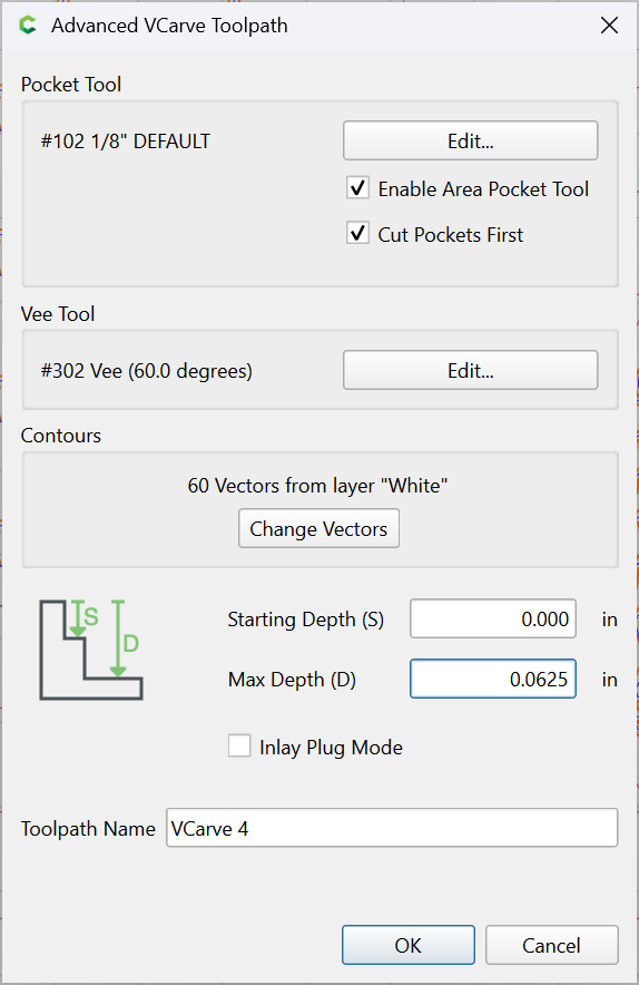

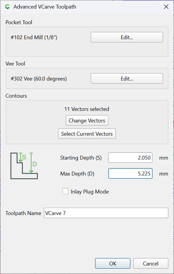

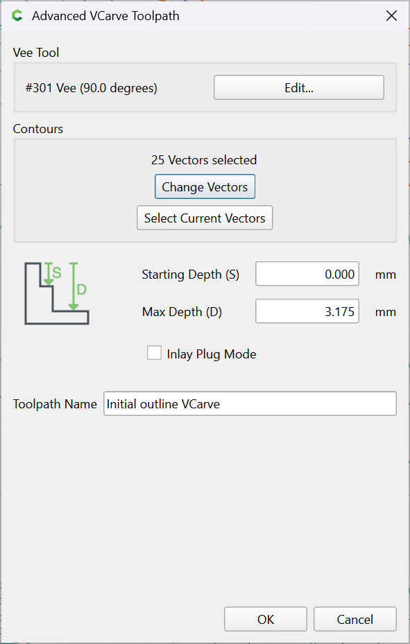

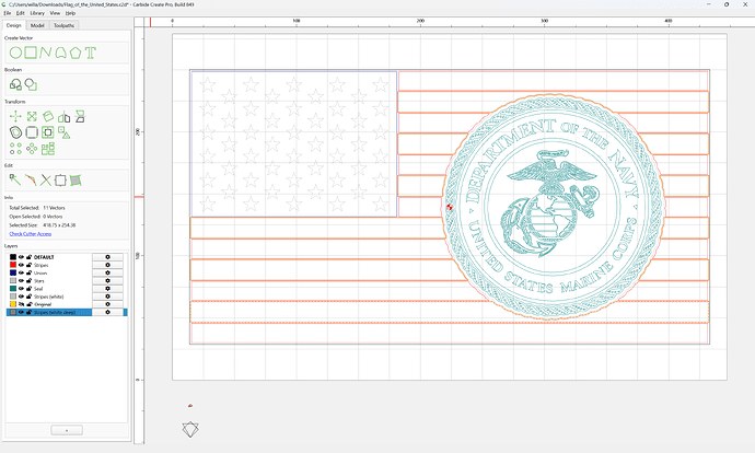

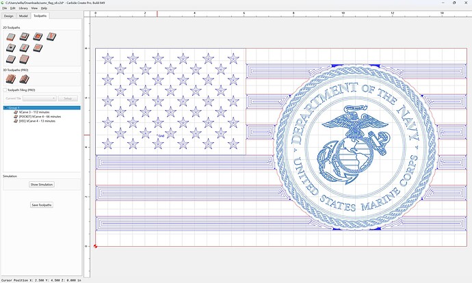

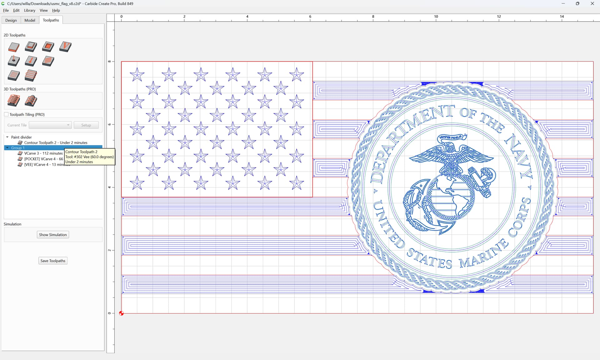

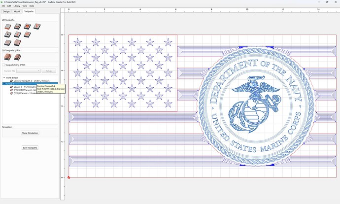

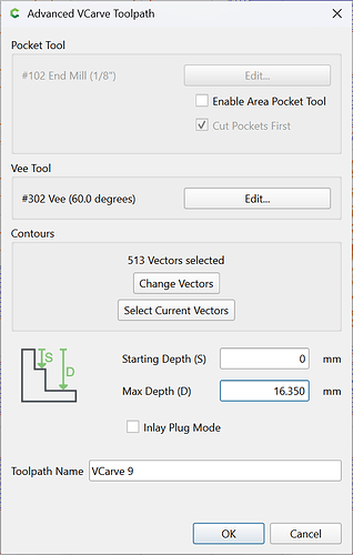

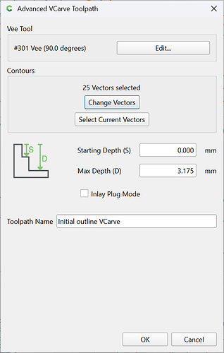

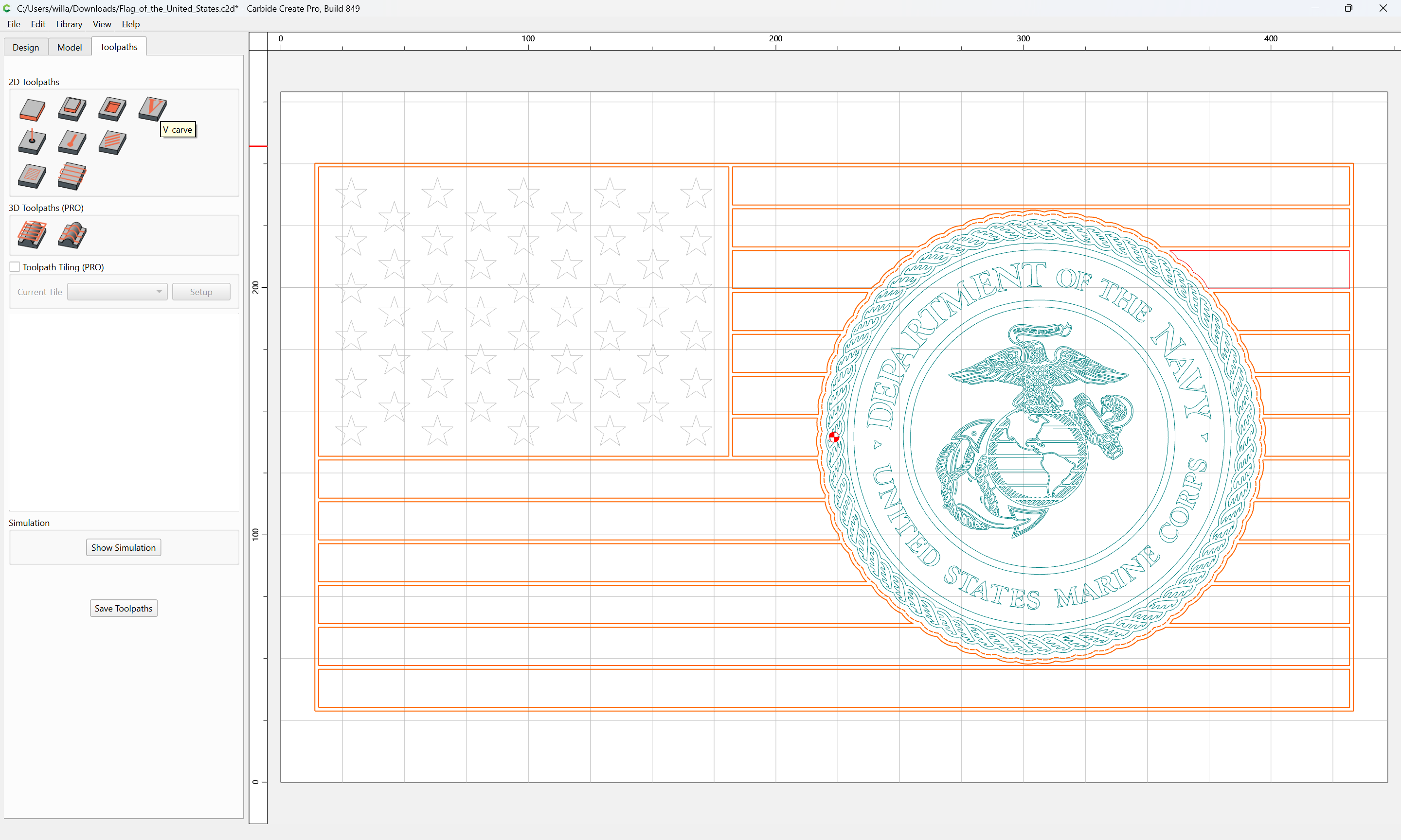

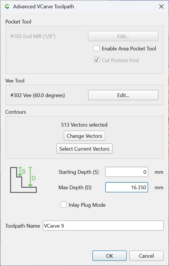

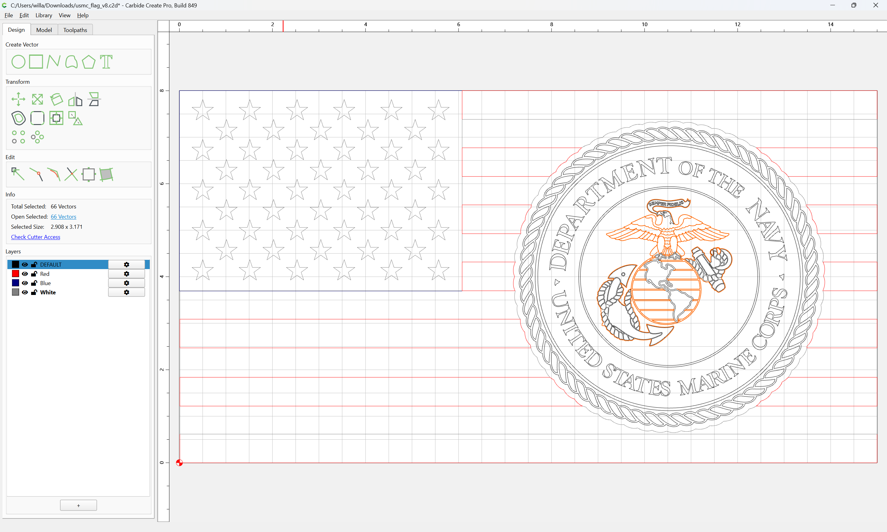

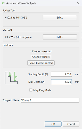

Select the stripes and the Union and the offset geometry:

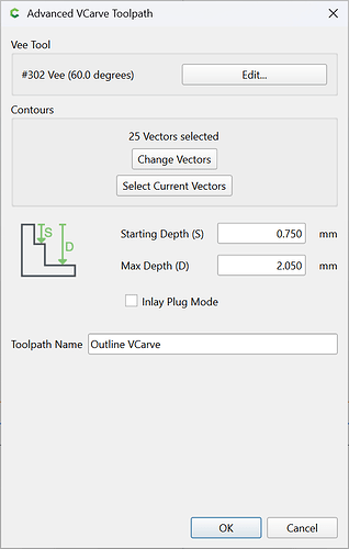

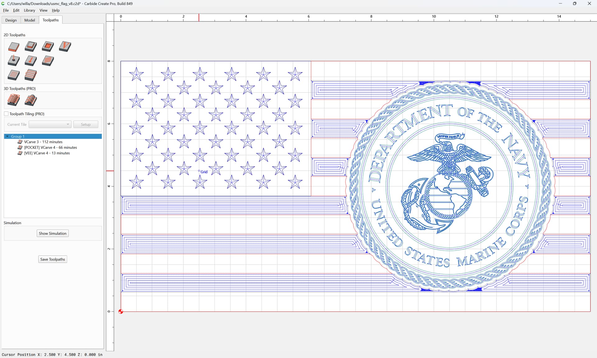

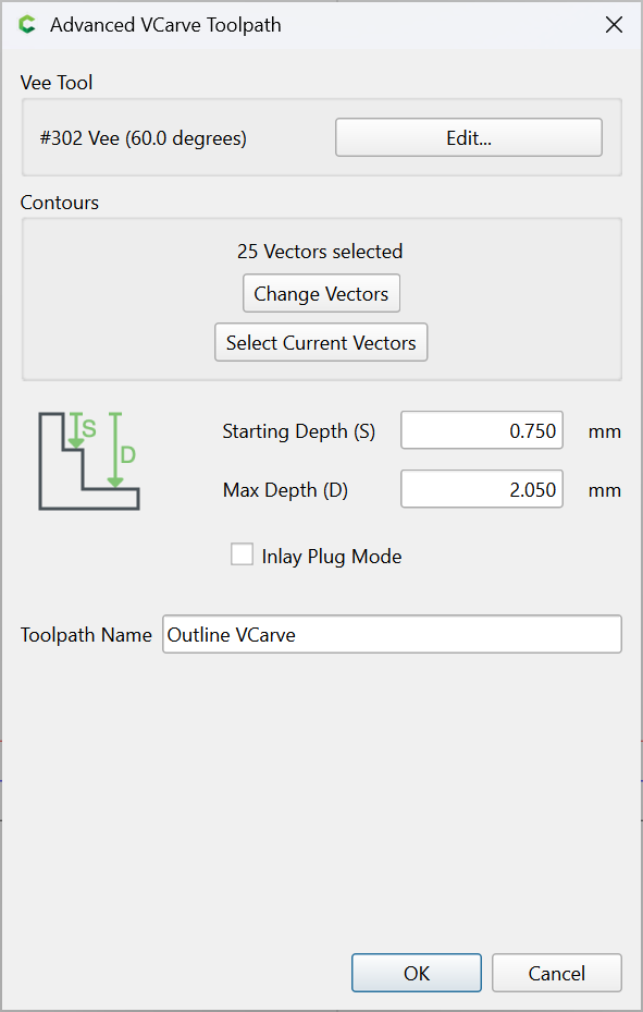

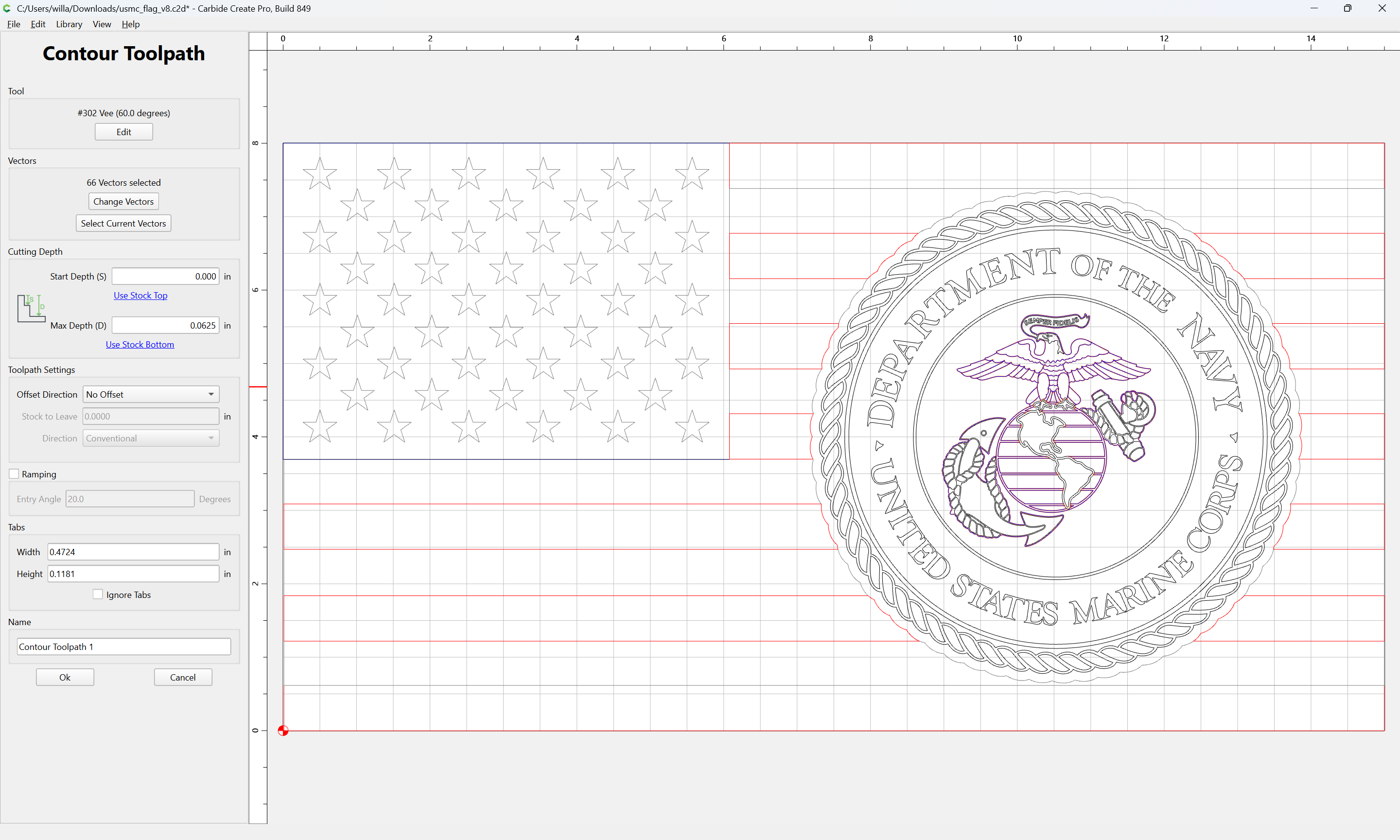

and assign a V-carve toolpath with a V tool which is less acute than the tool which will be used later:
This should be cut first:
and it will then be possible to paint the regions.

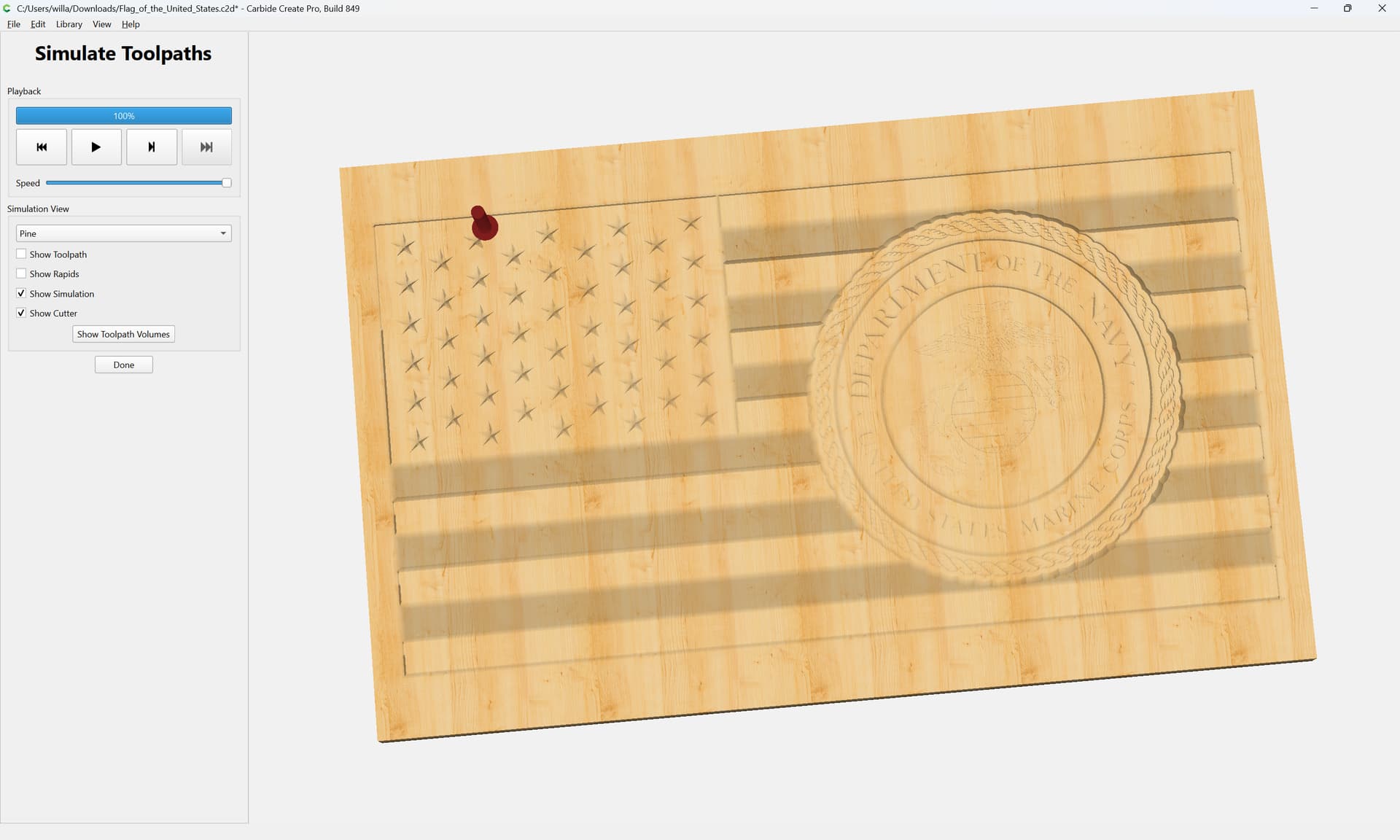

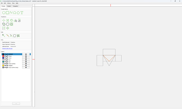

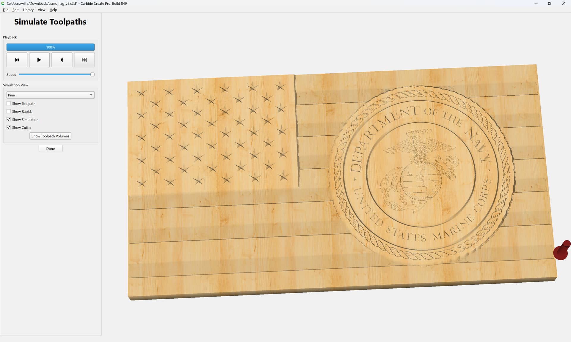

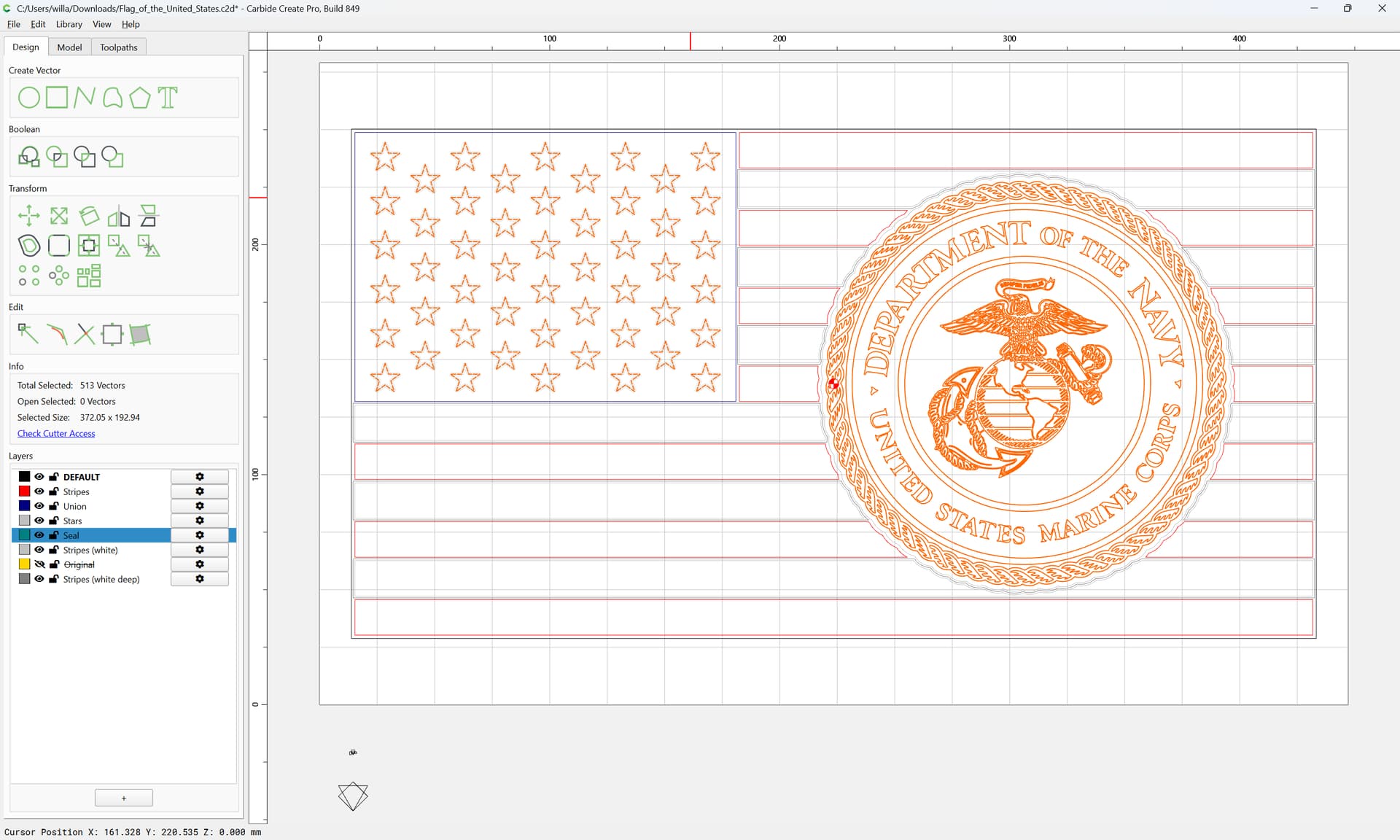

Drawing the cut up in profile we see that the 90 degree tool will cut to a depth of 0.75mm:
Then, a 60 degree V tool can be used to cut from the bottom of that V groove to the greater depth:
Then set up geometry which follows the center of the channel:
and use it for a toolpath which cuts from the bottom of that to the desired depth:

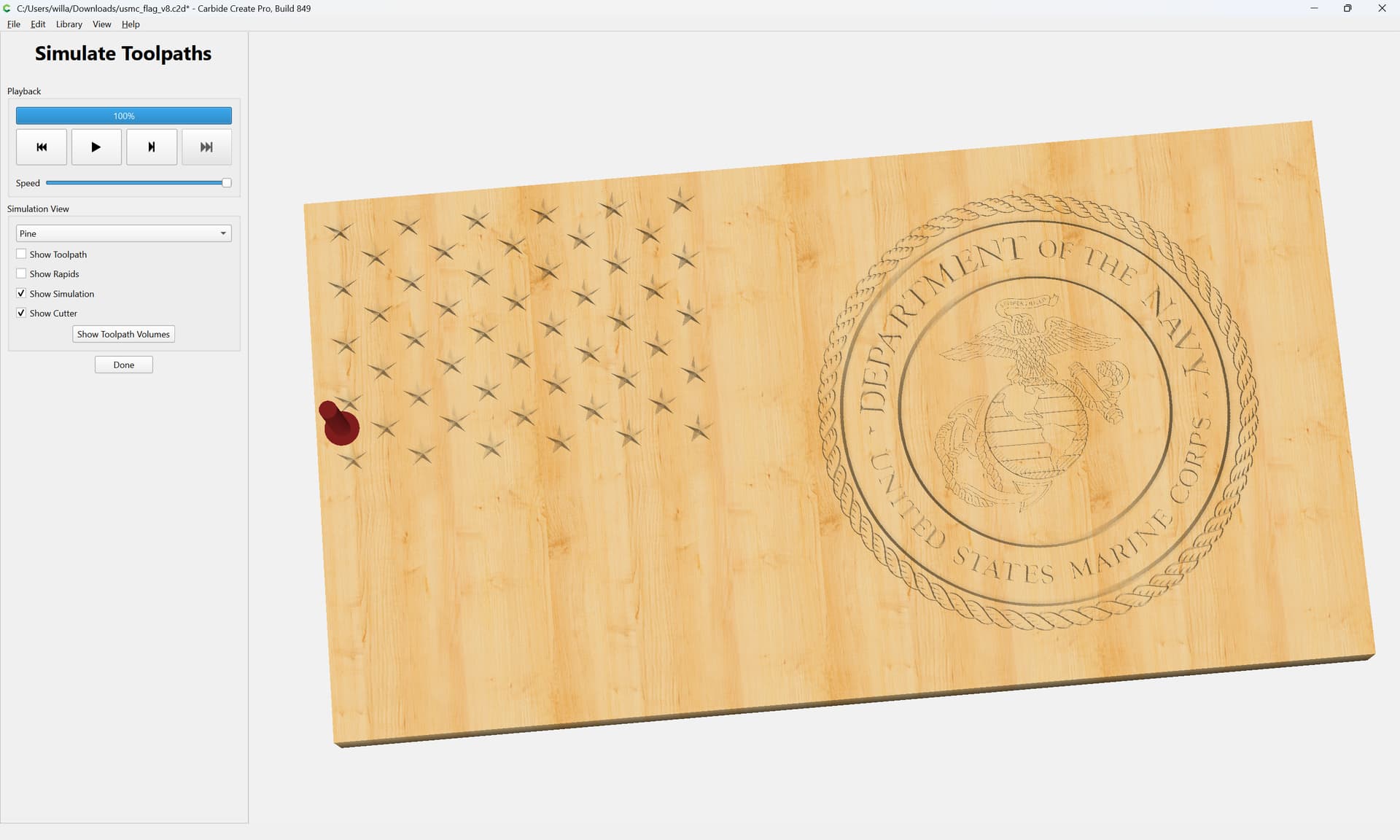

and a V-carving toolpath may be used for the stars and the Seal:

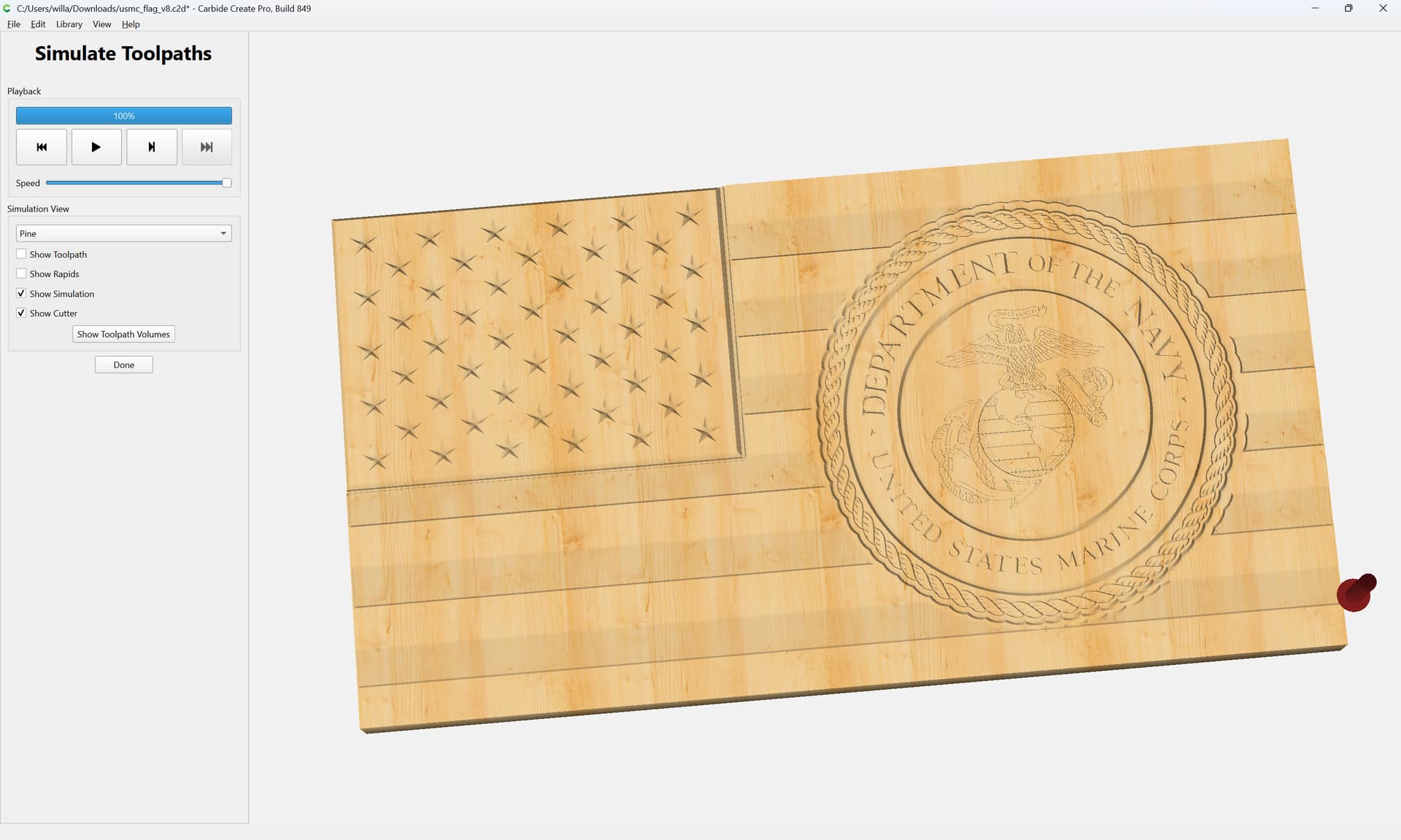

which will cut as:

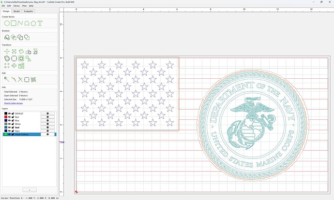

Attached as a v8 file.
Flag_of_the_United_States_USMC_seal_Ikea_v8.c2d (1.2 MB)

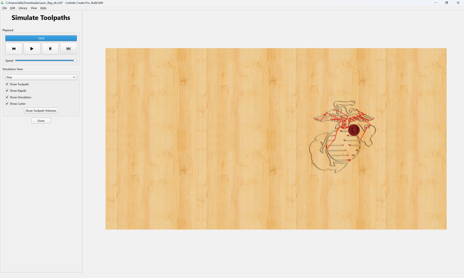

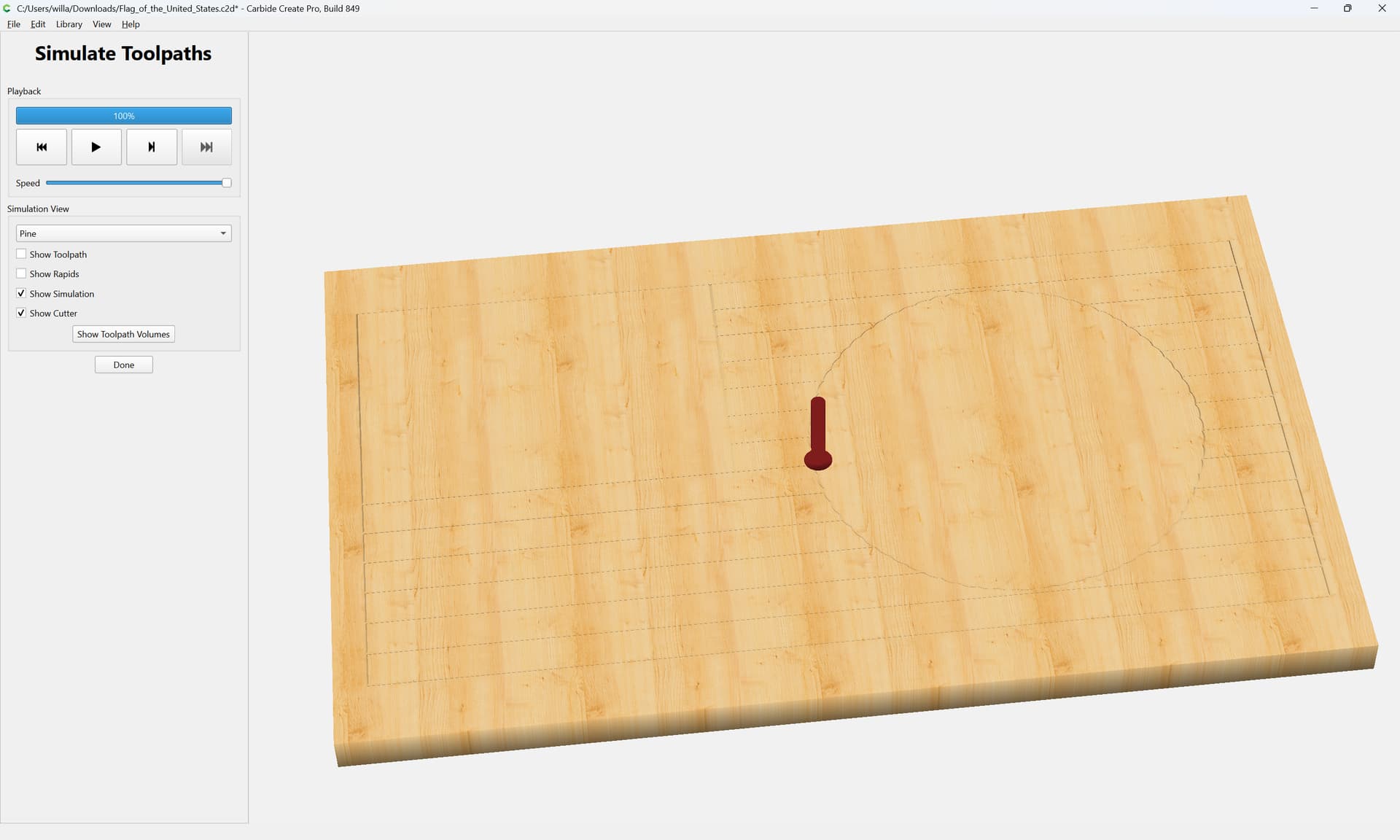

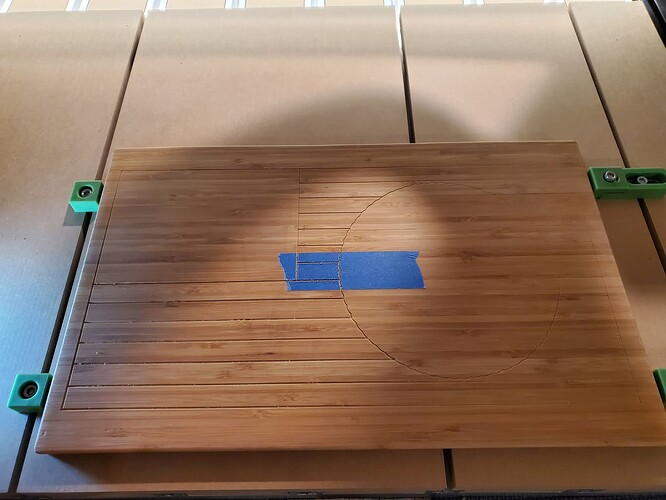

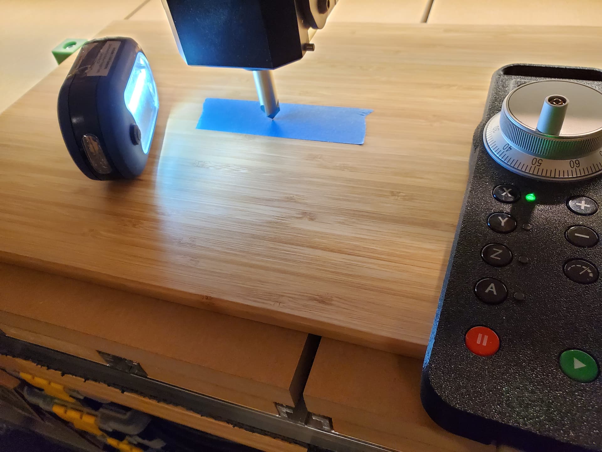

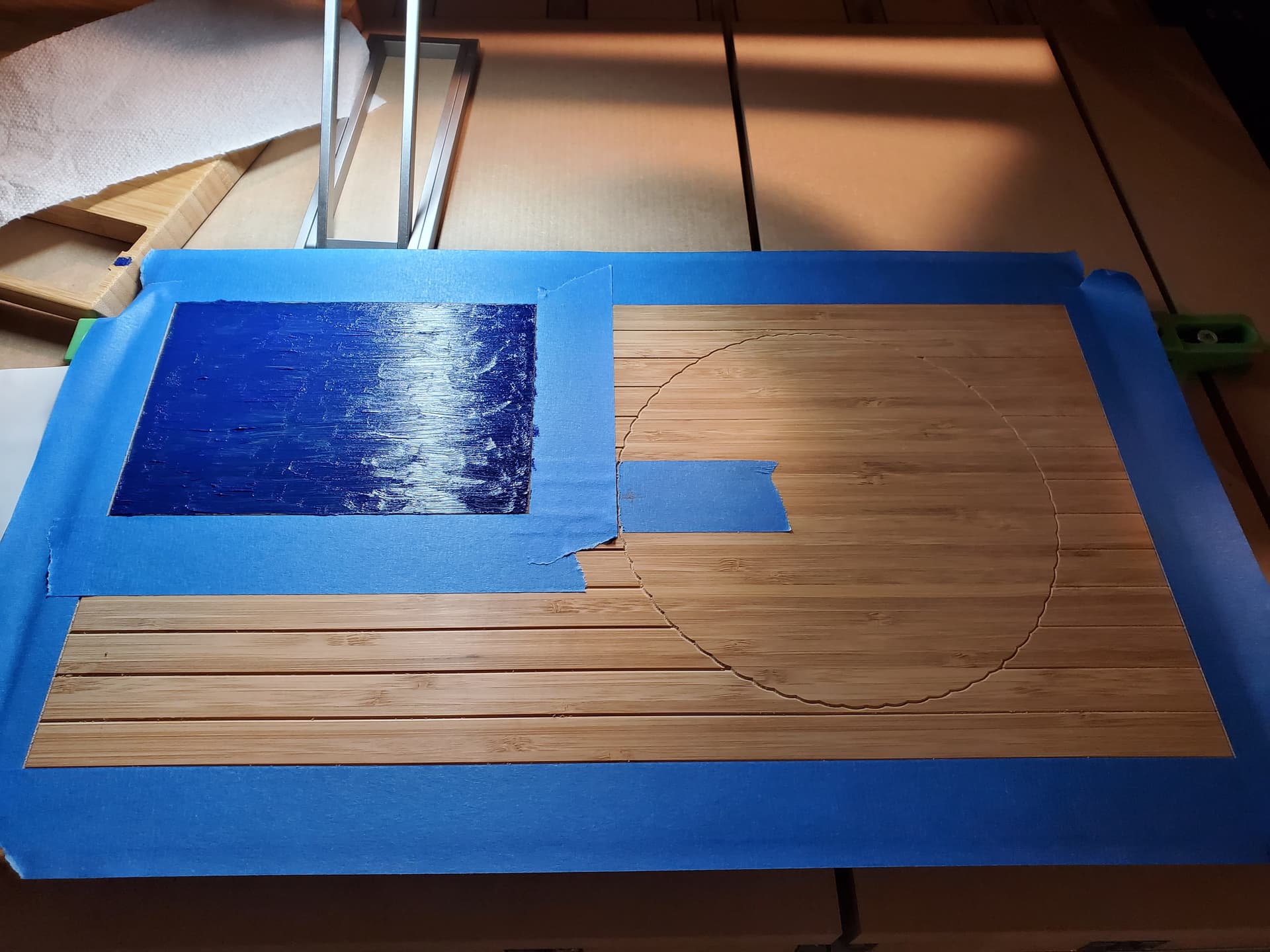

Set zero relative to the stock:

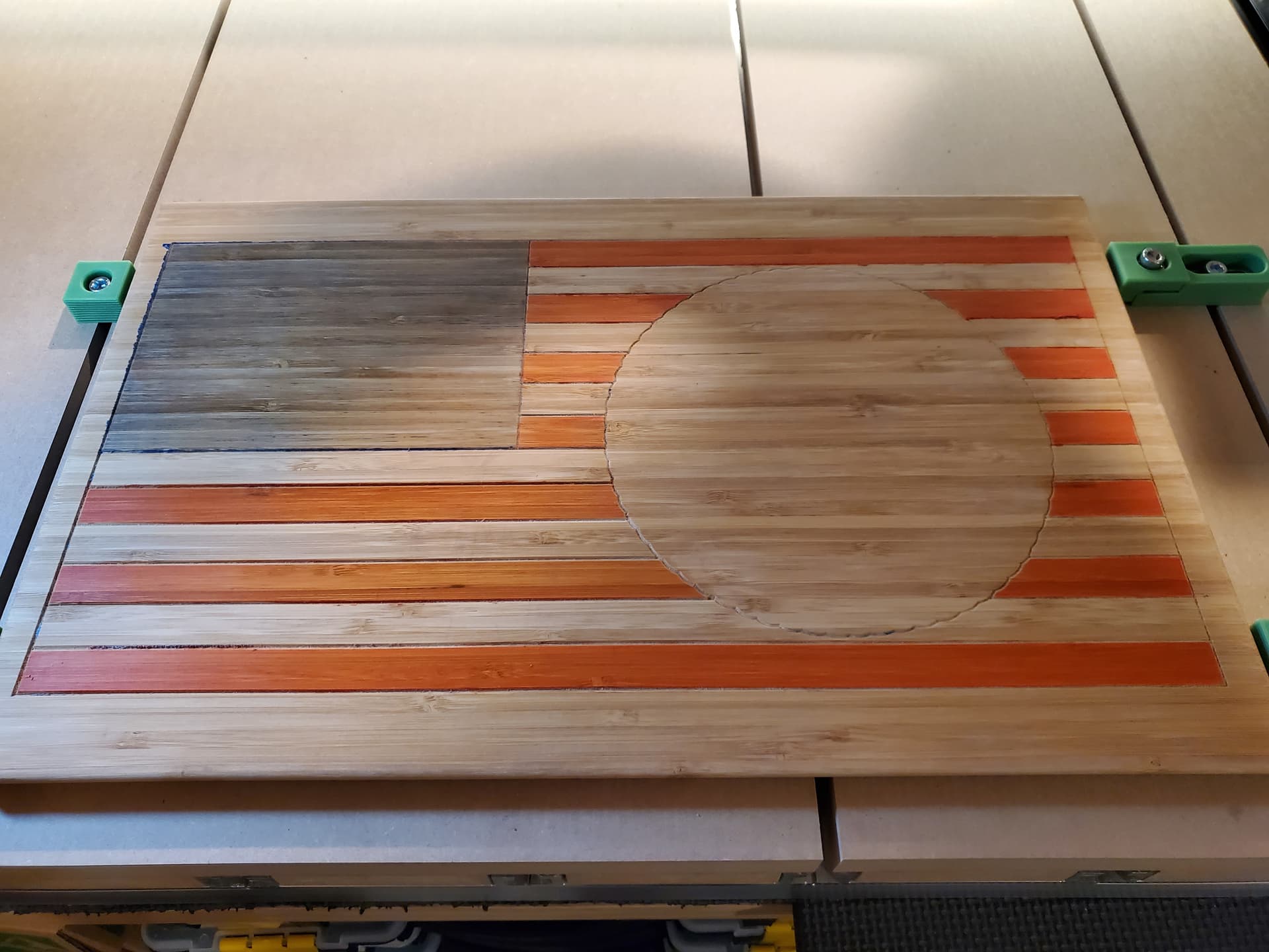

Cut just the first toolpath:

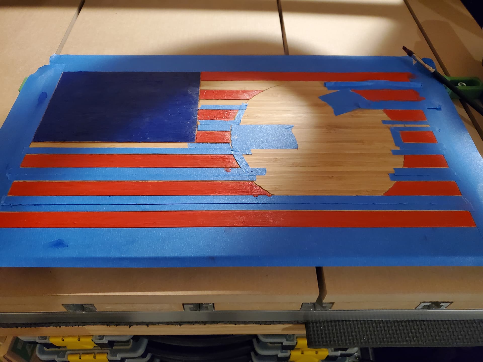

then mask things off and paint:

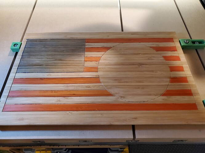

Mental note — check paint for type and consider drying time… using up my daughter’s old paints and didn’t notice that I grabbed a tube of oil rather than acrylic…
Mask if need be and apply the second colour:
And if it doesn’t dry, wipe things off:
and go ahead and cut:
Debating on re-running the Eagle, Globe, and Anchor w/ a more acute V tool (did resort to a 30 degree tool for Semper Fidelis).

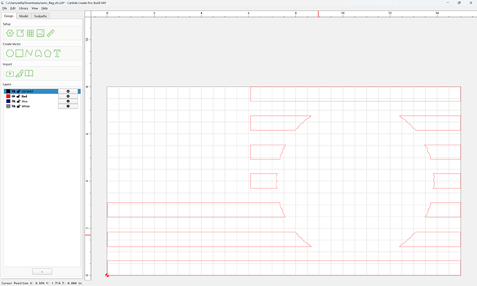

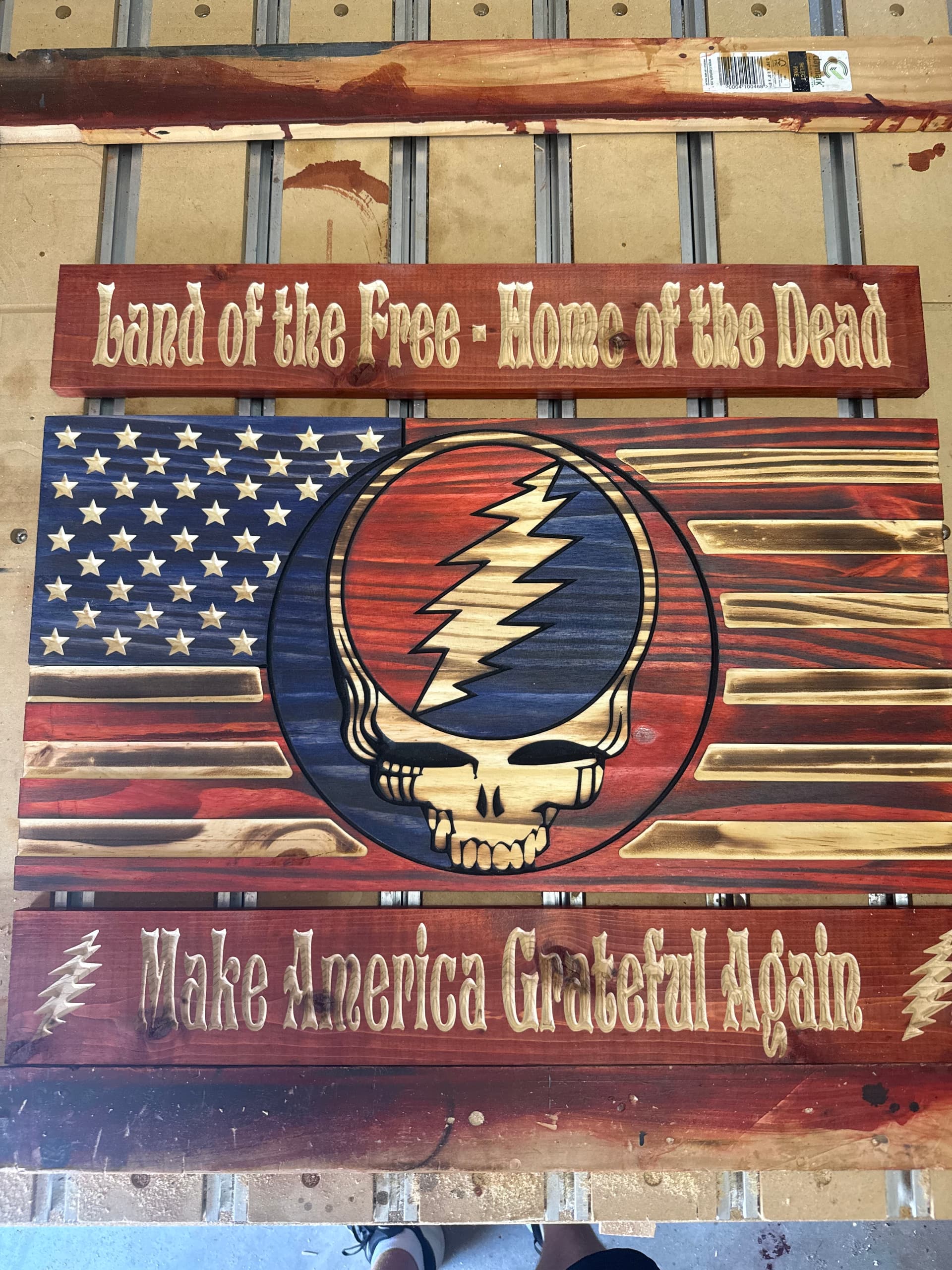

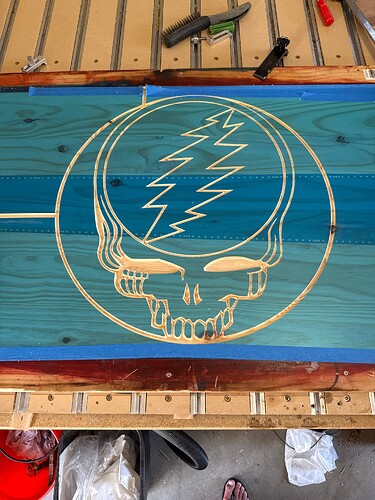

One trick that has really helped my flags is to extend the pocket cuts for the White stripes beyond the edge of the stock.
I really like using the stain-grade panels from Lowe’s; they come in multiple sizes. My favorite and most popular size is 16 x 30.5.
11 x 22 base flagNEW NO FRAME
11-25 x 21 Base Flag No Frame.c2d (256 KB)
Note, I left the Top and Bottom Reference Stripes in the C2D file; this is for resizing only.
Another “trick” I use is to mask the entire flag (best for flags with custom art) and my first carve is a .125 deep v carve along the bottom and side of the union. While not technically correct it really saves a TON of time.
The Black lines make my life easier, and they help make the ART POP!!
Lots of different ways to skin this cat.

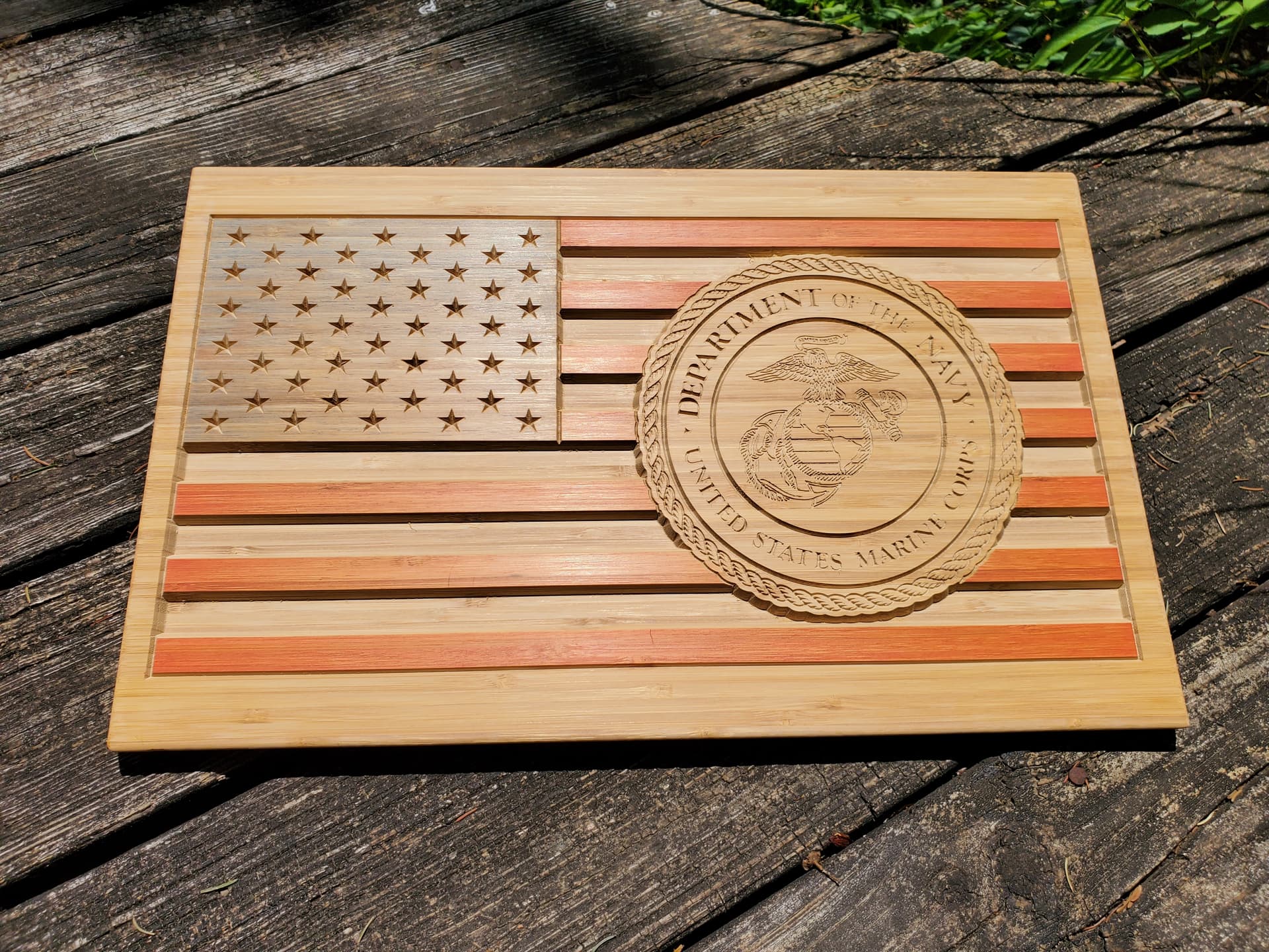

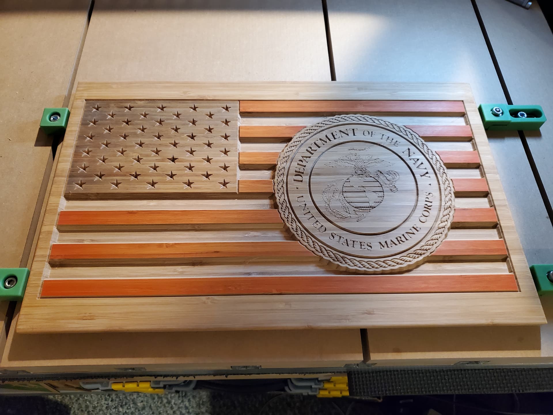

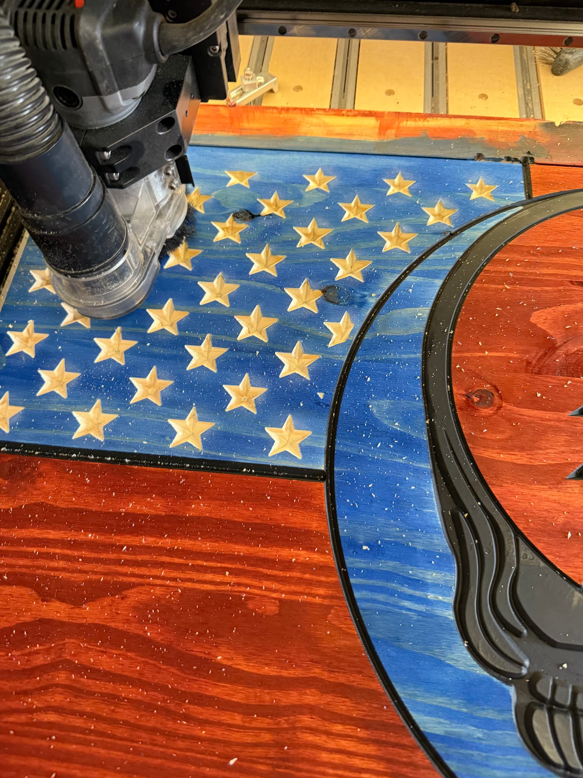

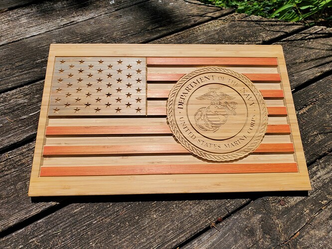

Finished:
Next is putting it up on Cutrocket.
#done
https://cutrocket.com/p/0fspc3zlynhnx
