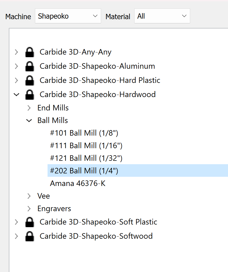

Thank you for your responses! And yes, the roller bits will not be used. I have some students looking to make a juice groove on some cutting boards, and have round-end CNC bit which I would want to use to go in maybe 1/4" - and likely have it make 3 passes to get to the correct depth. I realize the Create V7 will not be all that useful for visualizing with these bits, but, correct me if I’m off - I would likely make a contour toolpath - making sure spacing on the wood will allow for the wider bit.
I will lower the feed rate (I plan to do some testing before if you’re saying it should work.
We currently do have the starter kit, and I’ve already been testing out the Vcarves and the 1/8" endmil. Will look into the ball endmills so see if that might be more practical for making these juice grooves (even if it takes longer). Don’t want to break anything!
Can’t the Juice Groove tool be defined as a “Ball-nose” tool?
https://carbide3d.com/hub/courses/create/tool-library/
You are probably right. I will have to measure (might need to adjust bc the bit is 1/2" and Create only gives me 1/4" for the Shapeoko. AND thank you for those 2 links!
Just create a custom tool database for any 3rd party tools. If a 3rd party tool is pretty much the same as a C3D tool then just pick that tool. For instance a #102 1/8" upcut bit. If you have a 3rd party 1/8" upcut bit then just use the #102. Another alternative is to make a new library and copy the #102 bit and then just modify it as you wish. There are several posts about using bowl bits here on the forum. We have a lot of cutting board makers here that make juice grooves.
