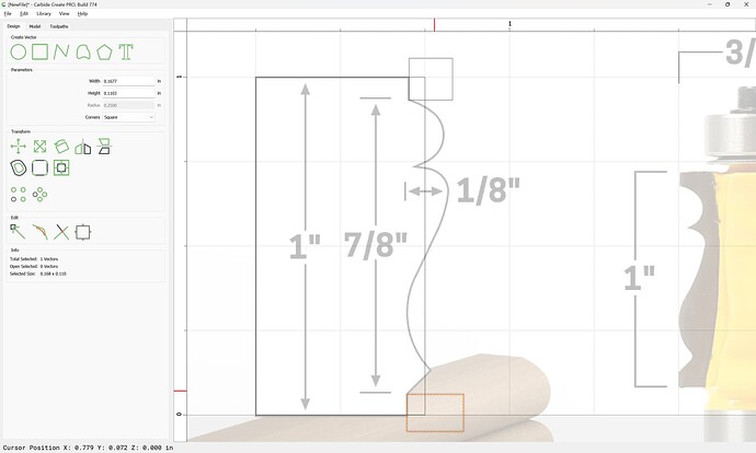

and since the tool with a bearing may not be used on our machines, the profile may be re-created with a bit of patience and some No Offset Contour toolpaths w/ appropriate tooling (and of course, if one has an appropriate radius tool, it could be used as noted above.
First, import the pixel image:
and then re-draw the profile:
Using Node editing to adjust the curves as desired:
(for more on Node Editing see: 2D Drawing | Design into 3D )
If need be, adding a point (say at a point of inflection)
Smooth and adjust until one arrives at:
Then use Node editing and Trim Vectors to reduce the geometry to only what is needed:
(or draw in new geometry using existing nodes)
OK
OK
which may be Joined:
Then use this geometry, and drawn up profiles of tooling to re-create the profile using the techniques from:
If anyone needs assistance with that, post a screen grab showing where the difficulty arises and we will walk through it.

Re-arrange things assuming an 0.25" Stock Thickness:
Draw up the tooling which will be used in profile:
Then position each relative to where it would need to be to cut the profile, duplicating as necessary:
Repeating until one arrives at:
Then one draws in a line of the desired length:
Positions it relative to one of the tool outlines:
Determines the Max Depth:
and assigns a suitable toolpath:
Repeating for each until one arrives at:
Attached as a v7 file.
Molding_profile_v7.c2d (696 KB)

OK, for academic’ sake I came close…
Took a bit of creativity in the adding & subtracting of model components.
And it’s not an exact match, but the best-fit of primitive shapes (arcs & lines) -vs- “B” curves.
moulding.c2d (464 KB)

Can you please explain this step? Where does this tooling come from?
Tooling:
Left → right:
1/4" square endmill, 1/4" ball-nosed endmill, 90 degree V endmill, 60 degree V endmill, 30 degree V endmill
Or:
#201, #202, #301, #302, #45771-K 30 degree engraver (from: Amana AMS-115-K: 2-PC CNC Signmaking - Carbide 3D )
Oh. I think I figured it out. When I first saw it I thought you were using some feature of CC that I didn’t know was there but now I am looking closely at your example file …
You created those vectors in the screenshot just to point out which tool goes where, but they weren’t “functional.” Then when it comes to actually making the cut you use vectors that are just straight lines with contour cuts at various depths with the different tools to re-create the profile of the molding? Interesting. I wouldn’t have thought about that …
