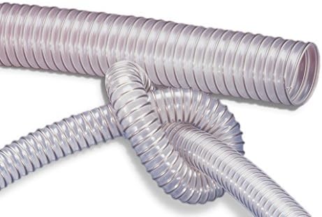

There is cheaper hose available over here, I use this stuff
But the Rockler kit with the hose adapters is nice, they do seem to do good stuff, shame UK prices are so much higher than dollar, I had to print my own to connect my system up
Actually, I’ve got a length of that in my Amazon basket! I just need to know if it’s as flexible as it looks, given the low height of my enclosure. I’ll need to work out how to connect it to the Sweepy, though.

I would suggest sticking to the biggest bore flex hose you can, the reduction in flow as you go to smaller hose diameter is quite significant, especially with this spiral profile type hose. Making the hose longer as you plumb stuff in also adds to flow loss.

The PU antistatic is definitely not going to be sufficient on it’s own between that top port and the sweepy, if there’s enough length to not pull out in the corners there’s enough to get tangled up when sweepy is toward the middle. Mine is hung from a ceiling over a meter above the machine and I still tie the hose back across the Z motor to ensure it can’t get in front of the carriage.
There’s quite a few threads on here where people have made various forms of hinged arm or runner track to support the hose above their machine to assist in keeping the hose out of the way of the machine without creating too much tension. You’d probably end up moving the port to one side or a corner with that sort of setup.
