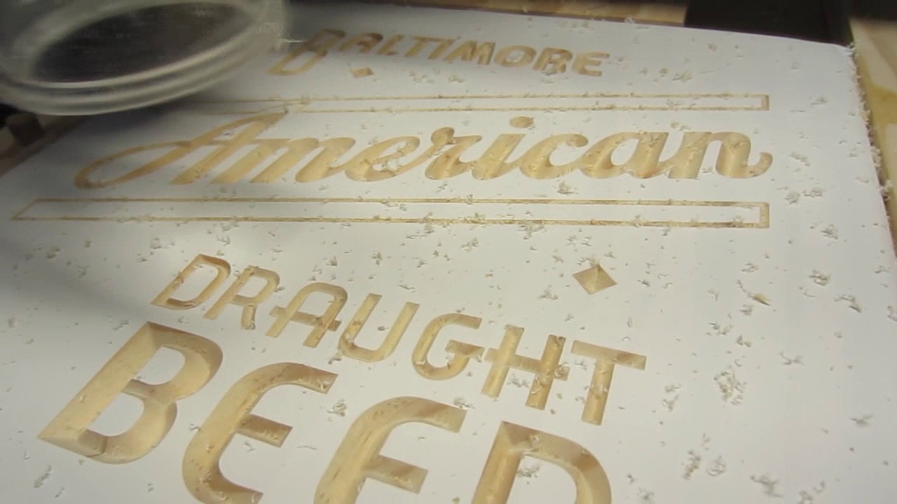

Hi - Question on the Quinn Sign. Did you machine through the blue masking plastic and then spray paint just the machined out areas through the plastic? Does the plastic not um up the bit? Looks a lot easier than painting the wood entirely then sanding it off!
Good morning.
Yes, the blue film is Oramask 813. It comes in a roll (I think it was like 50ft, around $40 on Amazon) I saw the technique on YouTube and it has been working great for me. I’m copying a link to the video, but if for some reason it doesn’t play correctly, I will send a screenshot of where you can find it.
You asked if it gums up. Personally I haven’t had that happen yet, but I suppose if it does you could simply pause the cutting, stop the router, clean it, and then resume.
I didn’t want to paint the object then sand off the paint that I didn’t want. Or, like some do, use a fine brush and hand paint the letters after cutting them. That seems like it would be very time consuming, and I don’t think I would have a steady enough hand for that kind of detail.
I hope this helps. Let me know.
