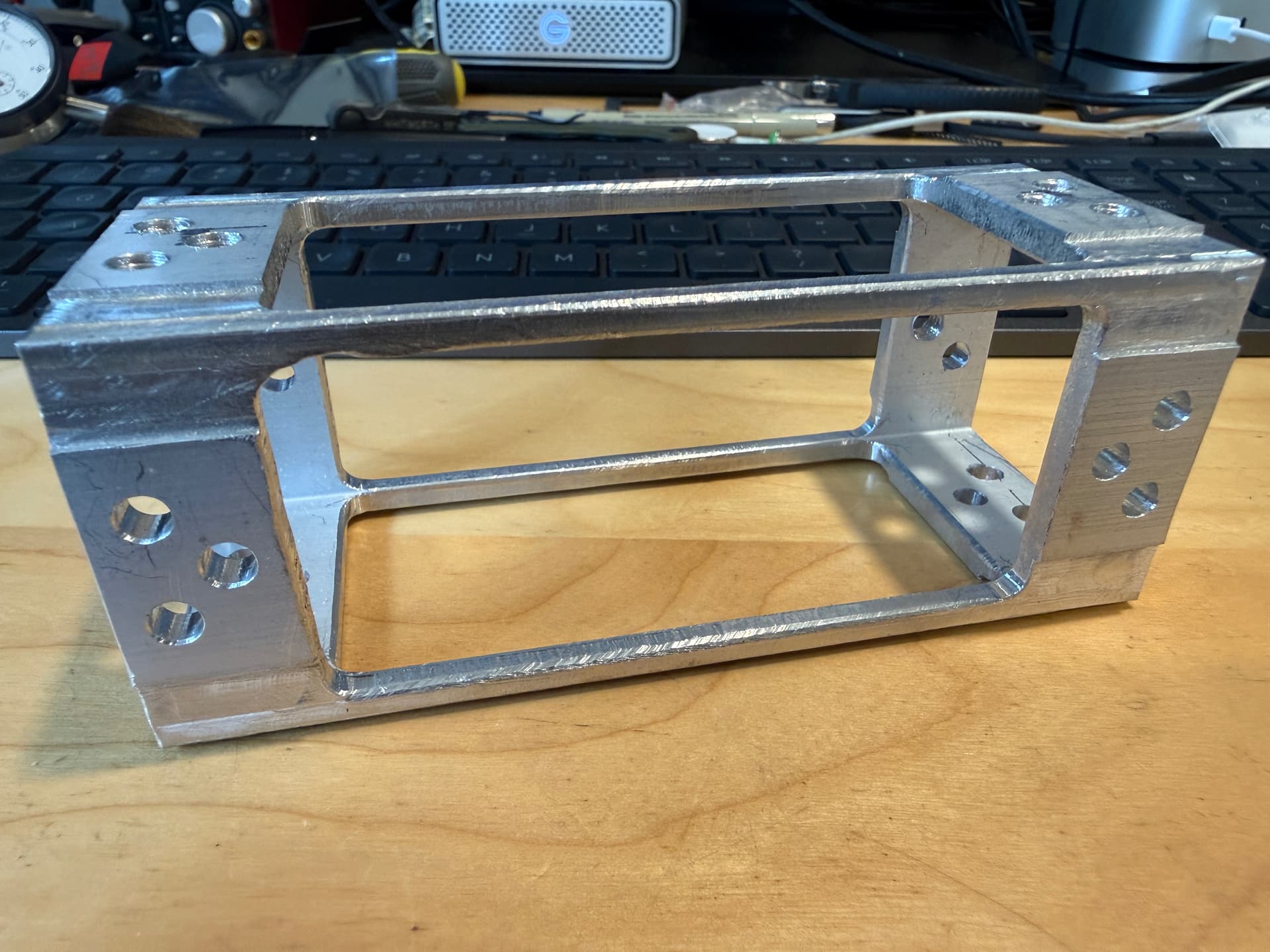

4 Sided Flip Frame Prototype
This is a design I made using Carbide Create for a 4 sided Jig that fits in the Carbide 3D Low profile vise channel, and allows 4 sided rotation.
This design allows for a 3.25" long and 1.6" round part to be machined on 4 sides.
The Set screws that hold the stock conveniently sit inside the middle channel so if they stick out there is clearance.
I have include the Carbide Create file below.
Materials used:
2" x 2"x 5" aluminum tube with 3/16th walls.
M6 Set screws 10mm- 16mm
1/8th end mill
M6 tap
Ideally I would have machined the ends of the Tube perfectly flat as the first step.
For this very first prototype however, I used a file and square to accomplish it by hand, we will see if it was accurate enough when I get to test it.

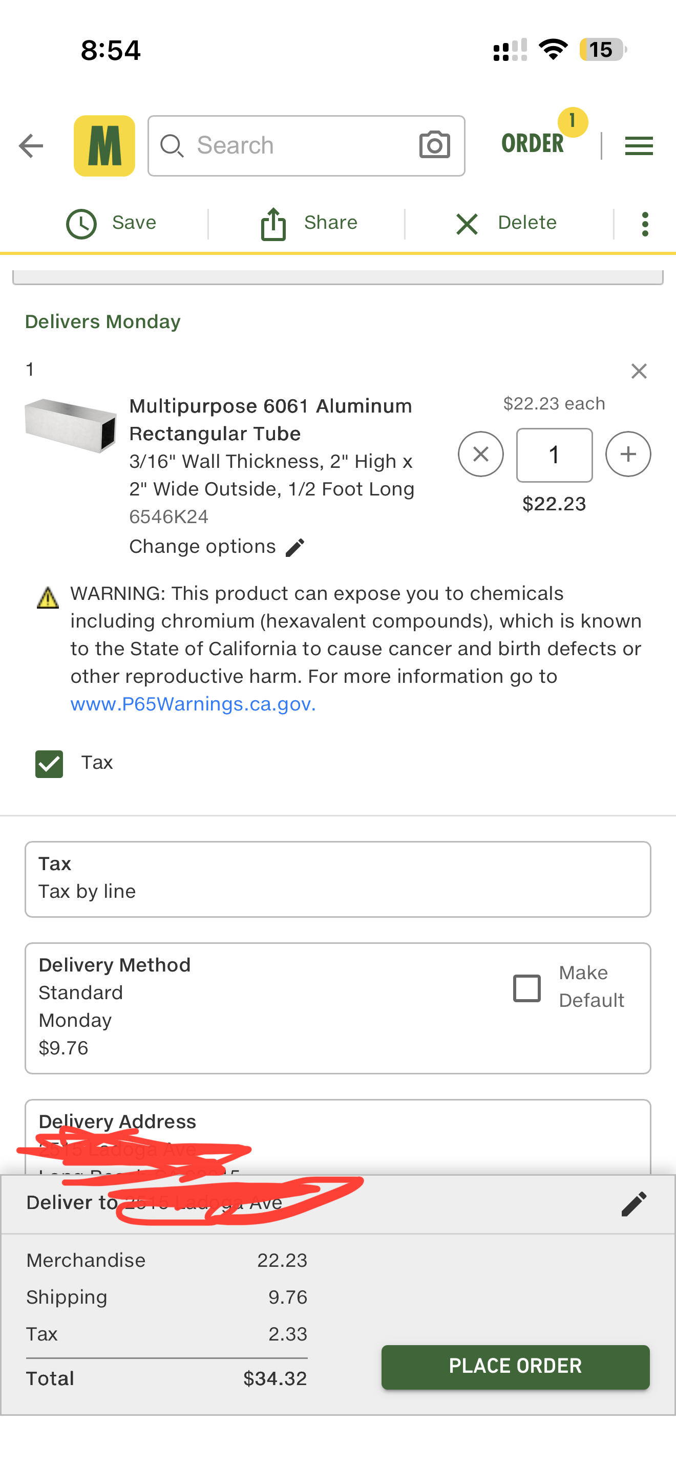

Hey, necro thread time. I’m wondering if anyone actually made one of these? And if so, what their experience was. Before I order tubing from McMaster-Carr… Thanks.
I did! But I didn’t finish tapping the screw holes (got sidetracked waiting for set screws). Looking back, this was one of my first aluminum projects on the Nomad. Maybe I should finish it up…

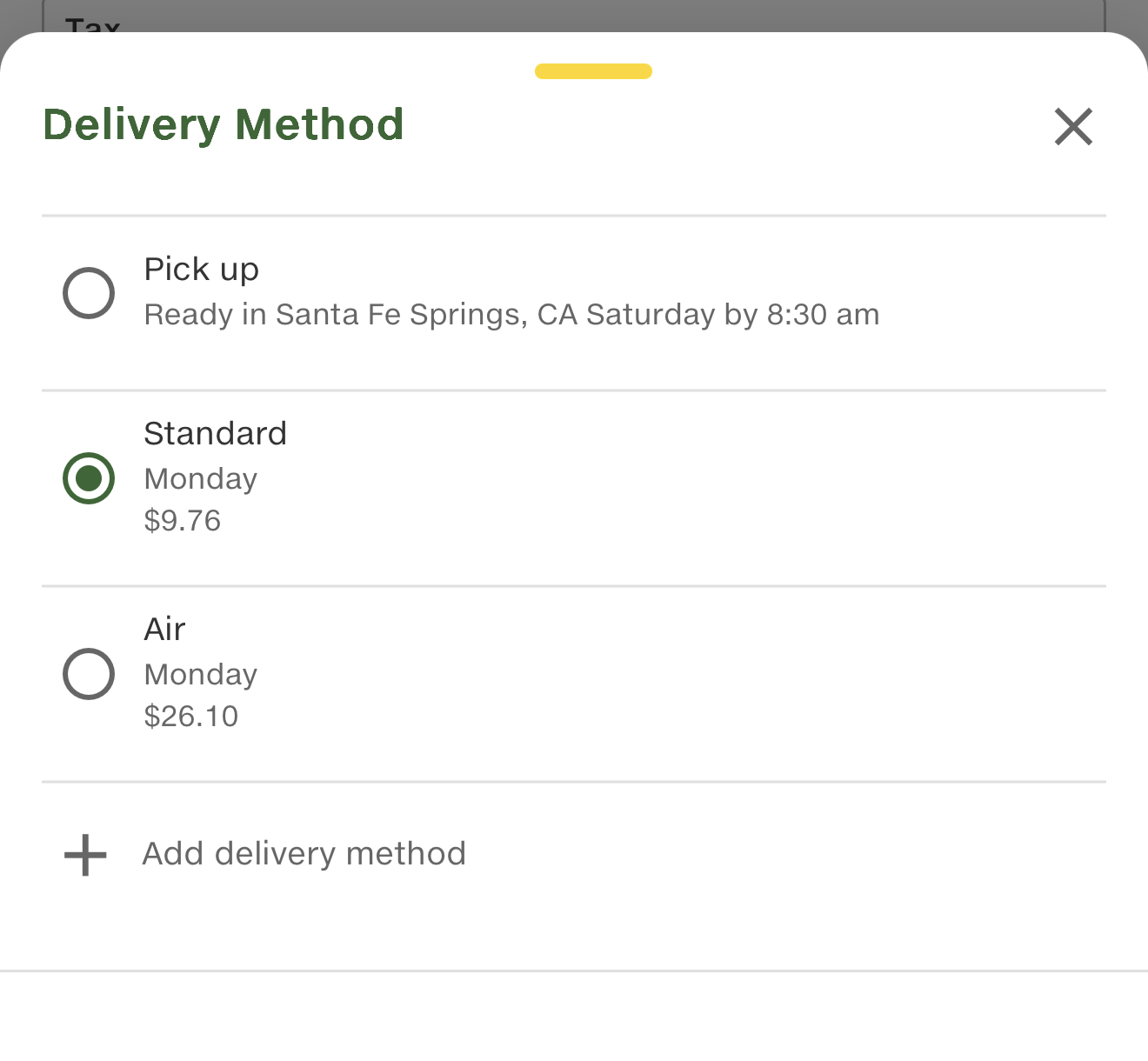

Wow, that looks good, @peteseyeview . So far, you seem to be the only one. I see that the tubing is less than $25 from McMaster (they will apparently not tell me their shipping charge until after I’ve already ordered, even though I’ve already entered my mailing address) so I’ll likely look elsewhere…
Thanks! McMaster is very close to me, so I typically visit their warehouse when I need something. I will say that they have an exceptional supply chain system in place, and my pickup orders are ready within 30 minutes. Also, i believe they have a dedicated truck that takes packages from the warehouse directly to the UPS hub to get it shipped out faster. That said, it’s also a quirk of how they operate, and it doesn’t always show up, but I have never found their shipping to be wildly expensive.
For kicks, try selecting it again outside the UPS cut-off time, and see if the shipping price comes up.
Edit: and make Delivery Method is set to standard, not pickup or next day air
McMaster is great. We use it at work every day, and except in rare cases items are there the next morning.
I did find a good deal on the tubing online at Warrenton Steel in Missouri. It was $20.11 including shipping for a 6" piece
McMaster IS great. But just pay attention to the shipping charges. You can buy two items on one order and get charged shipping twice - if they happen to stock the items in different warehouses. They will charge you for each warehouse’s shipping (at min $9 / warehouse)…when, their stocking strategy shouldn’t really be your problem to think about. Plus warehouse info isn’t available on the items when you’re selecting them.
When I first saw this, I contacted their support and they waived one of the shipping charges. Now, I routinely check and call to get that second fee waived.
