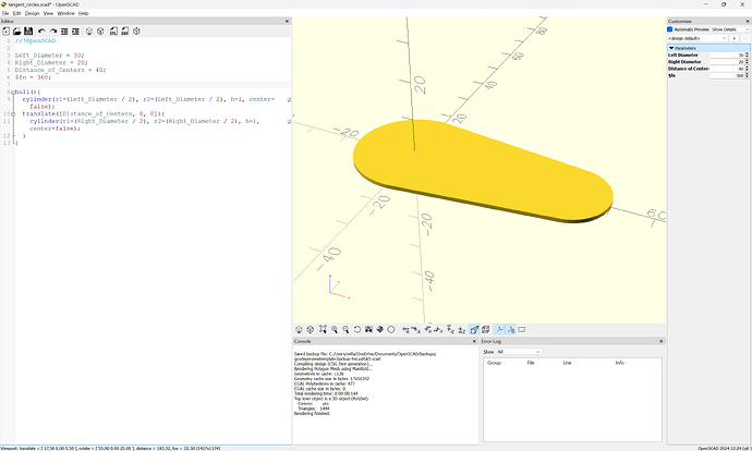

I worked up an example of doing this in BlockSCAD here:
the file could be exported to OpenSCAD and a projection() command added to get a flat version which can be exported to a DXF or SVG.
Alternately, program in a tool such as Nodebox and export an SVG?

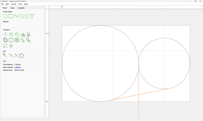

To actually do this by hand so that things line up:
Draw two circles which are positioned as desired:
Draw a line which connects to the larger one and extends past the smaller one:

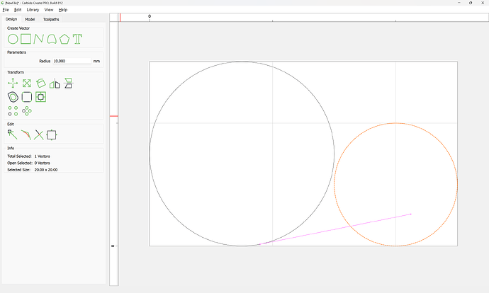

Duplicate the larger circle, drag the duplicate into position w/ the original and then make it larger than the original:
Select that circle and the line and rotate them:
zooming in and adjusting the rotation until things are positioned as exactly as one wishes:
Done

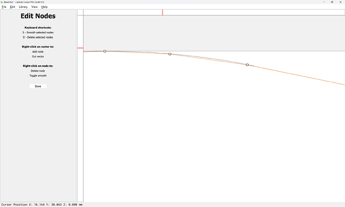

go into Node Edit mode:
and right-click and choose “Cut Vector” — if you’ve zoomed in so much that the position of the cut vector isn’t visible, draw in some geometry which defines the intersection:
and zoom out a bit after clicking away to deselect and clicking again to select only the one line until one sees the end:
Go back into Node Edit:
drag the end of the cut line into position:

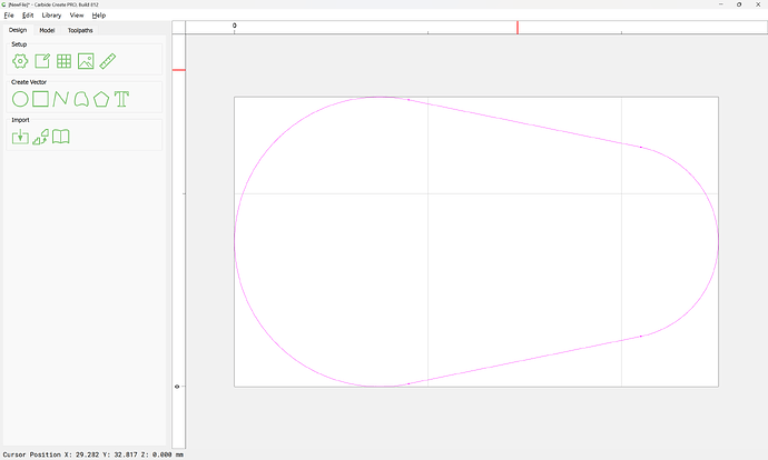

draw in lines which connect to the rotated lines and then join the lines, or draw a polyline which snaps to all 4 points:
Select the original circles and the polyline and Boolean Union them:
and delete everything else to arrive at:

One term for such a command which would work based on drawing two circles is Minkowski or Hull command:
https://wiki.freecadweb.org/OpenSCAD_Minkowski/pl
I don’t believe Minkowski as such would be an option (it’s already covered by the existing behaviour of the Offset command), but a Hull command would be a nice match to “Fillet All”, &c. — put in a feature request, we’ll have to see what folks think.
