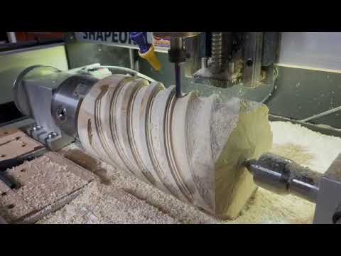

I explored this, but decided to head down a different rabbit hole: I added a stepper-controlled rotary axis to my SO3XL (bed along the X axis) and use Vectric VCarve to generate native rotary gcode using Neil Ferri’s post processor. When in ‘rotary mode’ VCarve doesn’t output Y coordinates, but instead outputs A (rotary) steps and I changed the controller PCB and grbl for a 5-axis capable setup (keyeStudio PCB and gerbl-MEGA-5X) so I didn’t have to keep swapping stepper cables etc.
Somewhere on here is a post showing what I did. It’s more involved than introducing a lathe, but I was concerned at synchronising lathe to CNC, permanent rotation to stepper controlled movements, and rigidity of the cutter… So I have a 4-axis machine, rather than a CNC bed-fed lathe - different outcomes for different reasons/choices.

@samsongli Yes, I am using the TMC2209 drivers with the NEMA-23 motors standard on the SO3, and spent some time adjusting the peak current to cope with acceleration/stress maxima along with trying to keep current (mostly heat) down. I am not at the max current setting available, although I will admit that this is from observational experiments rather than science fact.
I have the proximity sensor upgrade on my SO3XL (on X, Y and Z) and these are connected to the controller PCB and enabled. I also run ‘soft limits’ too, not a standard Carbide setting, as I prefer to hit a soft limit rather than find I have hit the end-stops and the motors are ‘rumbling’.
Were I starting over, I would be taking a very close look at the new GRBL HAL software and the processor/carrier platforms it can run on - in fact I have just bought a processor/carrier (Teensy 4.1 processor, Phil Barrett Carrier/Break-out Board), and some Digital Drivers Modules (DM3230) to experiment a possible re-update of my controller. Undecided as yet - some of the fun is in the ‘chase’…
This processor/carrier/driver setup will be better for 4-axis control, but the missing link remains solid support for 4-axis control (jogging, zeroing and visualisation) in the sender applications. The best options to date are UGS (with some custom code I wrote to help) and gSender which can pass through 4-axis GRBL but cannot (yet) control the rotary axis jogging etc.
